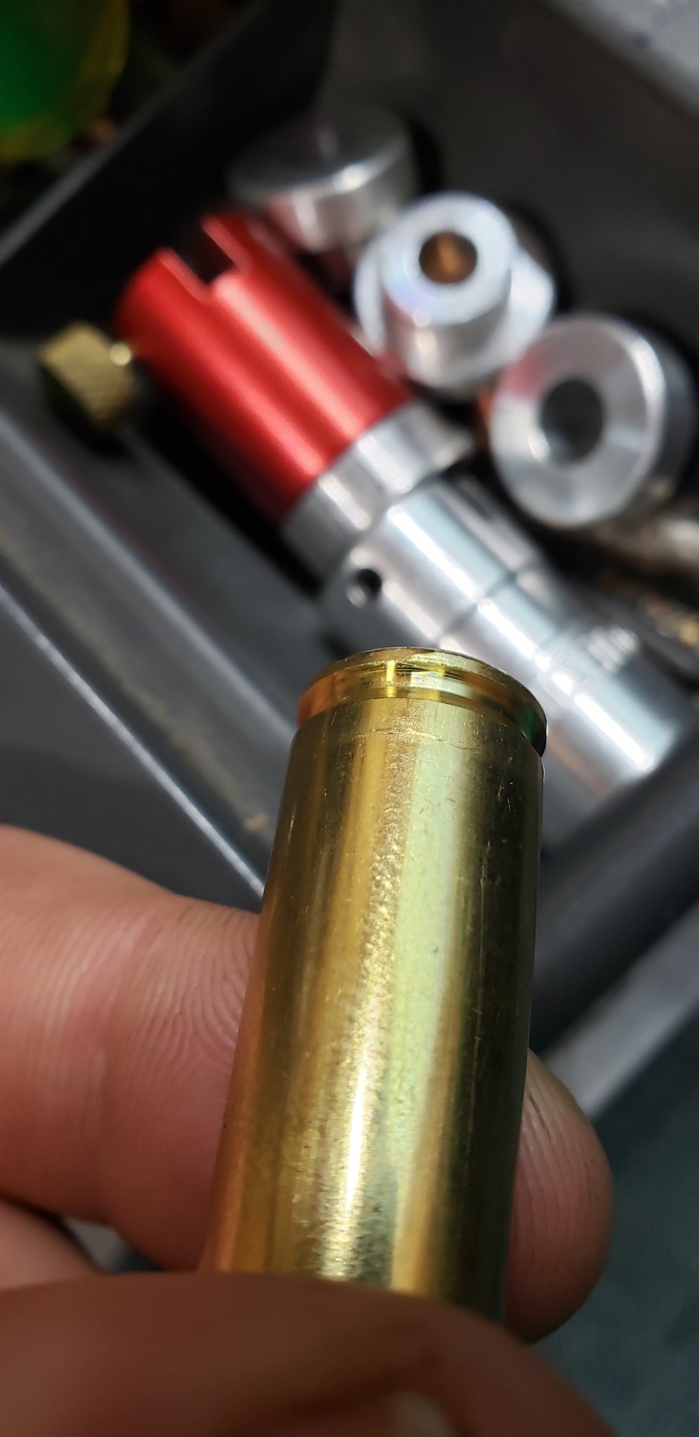

I bought some virgin 6.5 prc brass yesterday from a guy who had ran it through his die and primed it. I took a glance at it and could tell it was virgin so I gave him the cash for it.
Once I got home I looked at it and noticed that almost all of it has small cracks around the web that you can just catch your nail on. I did some measurements vs my adg virgin brass and it doesnt appear to be over worked or anything. Shoulders are not bumped to far. Web is within .0005 of my virgin brass. The guy has since ordered me new brass so that part is not an issue but can this be the result of anything other than bad brass or is there something else I should be looking at?

Could be a cosmetic artifact of the drawing process. I’ve seen that before and shot it without any case head separation.
That's possible, did they kind of seal up or could you always see a crack after you fired them?

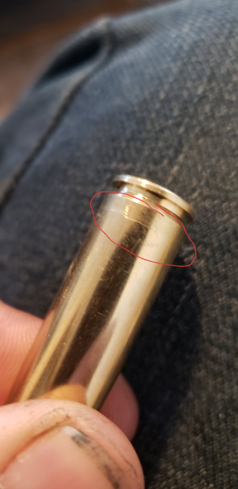

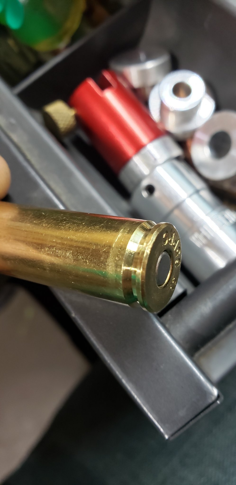

here is a few pics of different pieces
Pic

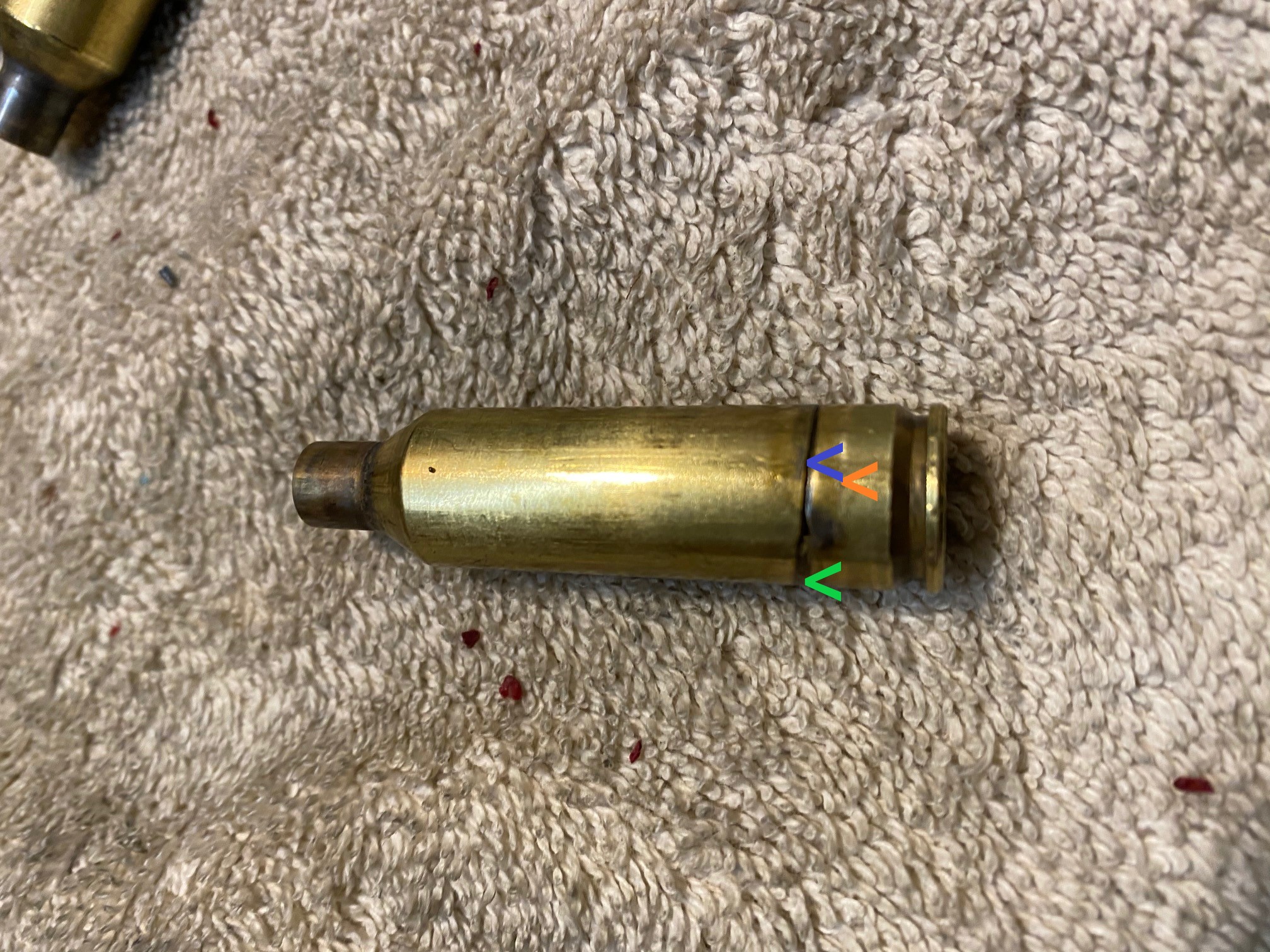

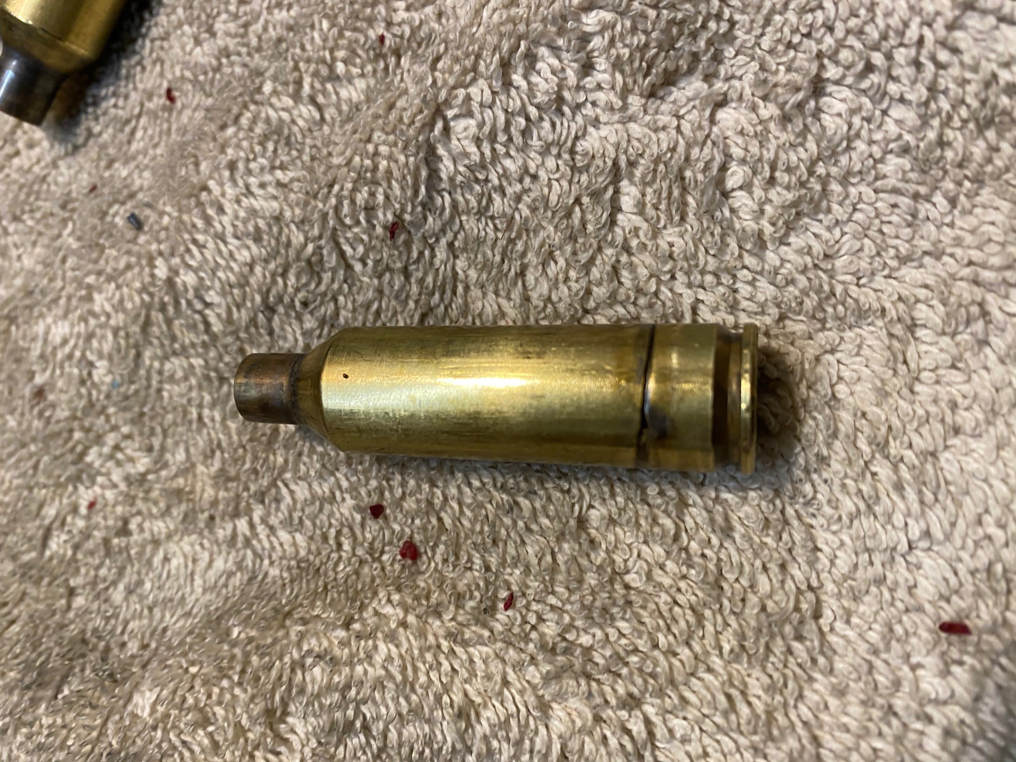

I see that sometimes with brass after 9-10 firings. This is what comes next after 12 firings at higher end loads.
Have you tried a dental pick or paper clip on the inside to see if you can actually feel a crack from the inside?

Notice where you see the "artifact" or whatever is not actually where it separates. I had one separate completely in the chamber. Yikes.
I toss them now when I see the early stress signs after around 10 loads.

In my case it wasn’t a crack. It was a shingle layer of sorts. Like the die that formed the case shaved brass from on high and smeared it down low.
Orange Arrow: "Artifact line" that shows up after 6-10 firings probably rather than 9-10
Blue Arrow: Actual separation crack
Green Arrow: Dark, early sign separation is coming next time fired. This was noticable to me often after 10-11 firings.

These are more than likely what your referring to, some arnt straight and in the shape of a half circle.
