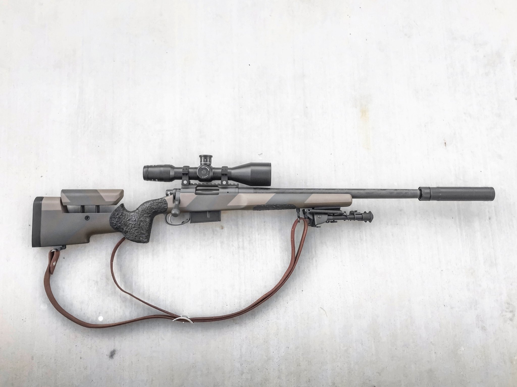

I have a 20” Proof coming, and have considered doing a PRC or SAUM instead of a creed. That said TBAC lists 20” as the min length for their 7 Ultra for 6.5 SAUM due to pressure. Is there any concern about this? 20” is the recommended minimum and I am assuming they have done a cycle fatigue analysis at this pressure, but I’m wondering is it nothing to worry about, or is my suppressor going to get beat up over time? The other question is 20” giving up too much velocity for 60 gr of powder vs going Creed.
I favor shorter barrels and suppressors as a general rule, especially since my state allows hunting with one. My 6.5 CM is 18” and pushing 140’s at 2,700 fps. My goal for the 6.5 SAUM was 3k fps with a 140 and 21” barrel. The SAUM ended up managing 3,052 fps with suppressor. I hope the PRC can flirt with 3k handloading (with suppressor) and have my fingers crossed the Precision Hunter ammo with 143 ELD-X will flirt with 2,900 fps.

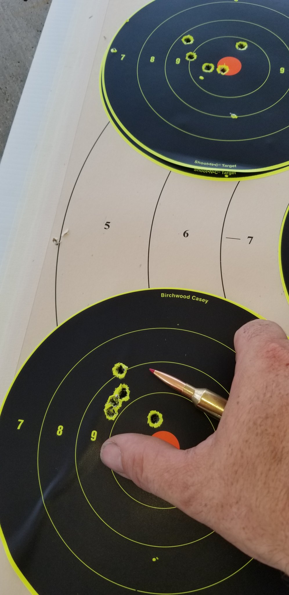

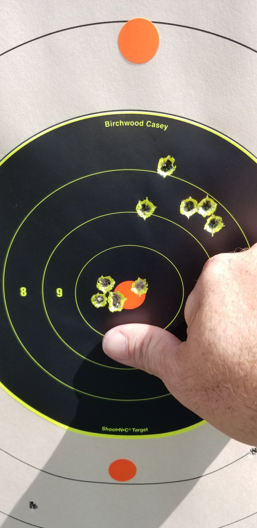

Factory velocity was a little slow for my 28 1-7 twist but that was expected. Accuracy was .818 for 5 shots w factory 147 at 300 yards.. Im going to try that same load at 1K this weekend hopefully before i start loading as a baseline.
Tried factory 147 ammo at a mile yesterday. Load showed promise w consistent hits in the dirt but ran out of adjustment on my scope and couldn't get it on target due to wet ground conditions and fog. That was my first attempt at 1 mile which by the way is no joke. lol

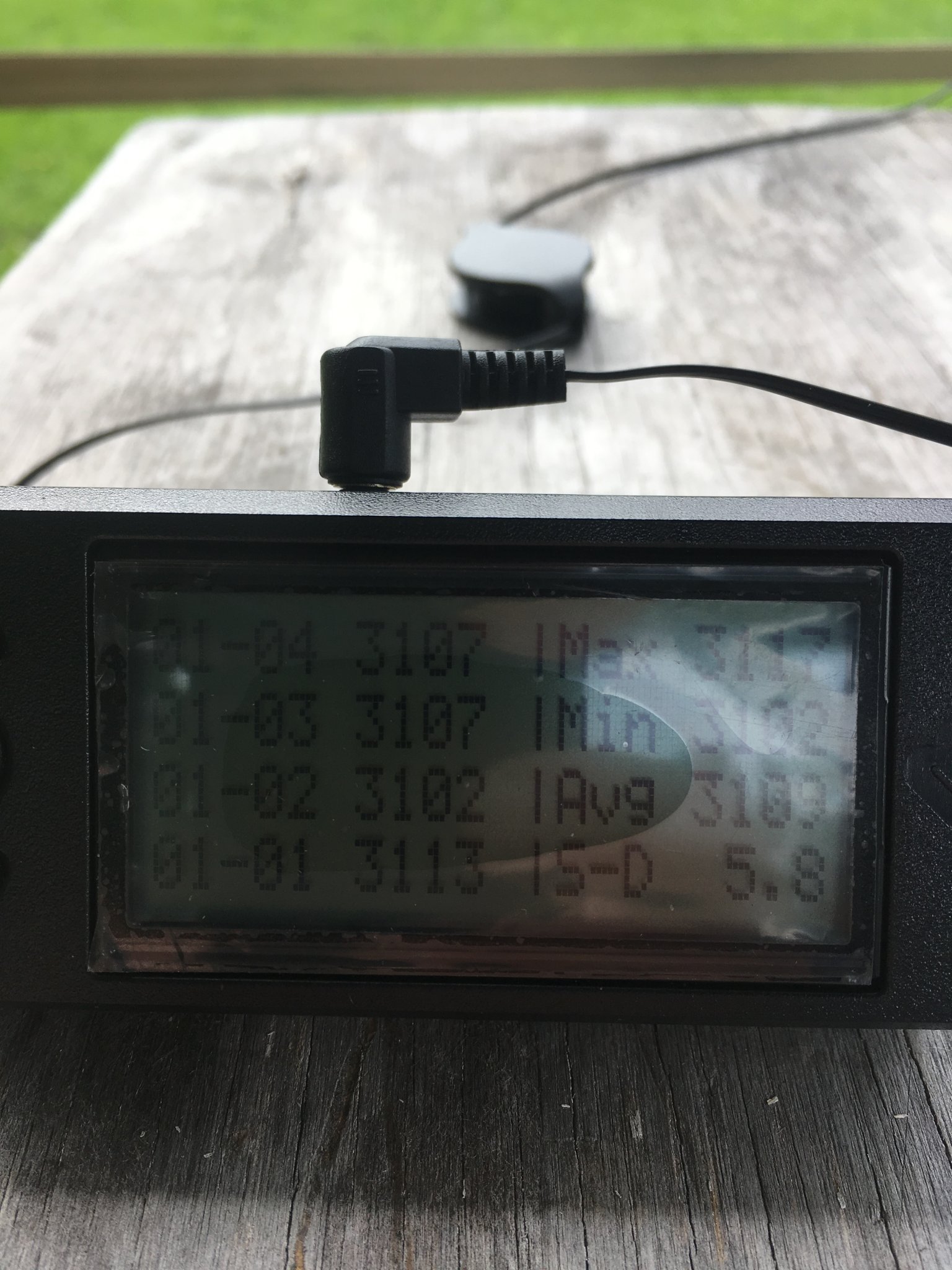

My barrel now has 120 rounds and has sped up w factory 147. Fresh barrel velocity averaged 2890 and tonight averaged 2990 20 degrees cooler temps. All velocity measured from a Magnetospeed V-3 in my Bartlein 1-7.
I started loading the 147 ELD-m best load was the hottest so far. Average velocity was 3060.. I will have no problem seeing 3100 plus as long as the accuracy stays. First attempt w the 150 Sierra wasn't good at all but it was only one charge weight.

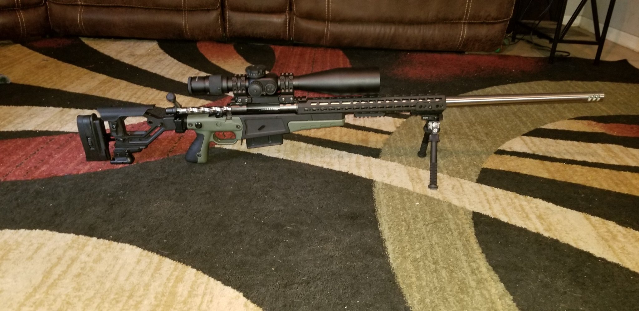

Bartlein 28 inch Marksman contour 1-7 twist JGS reamer .188 freebore. All handholds running at 2.950 from Alpha and Accurate mags.

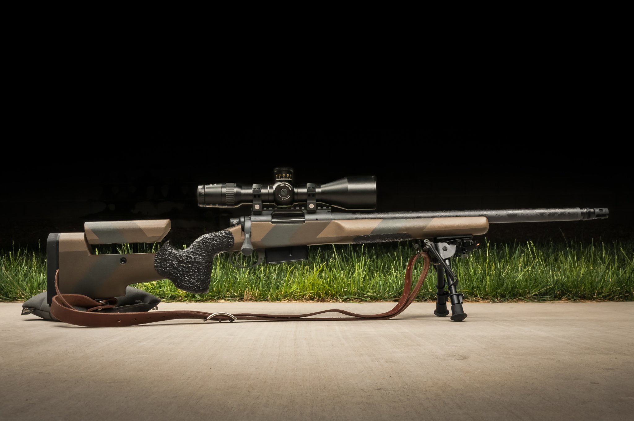

Hey guys want to get a 6.5 prc done. 22” CF proof barrel will be shooting cutting edge bullets 130 or 140 gr. The 140’s are really long so single feed only.
Was wondering what freebore you guys might suggest going with? No interest in shooting the 150’s or anything. Thanks
