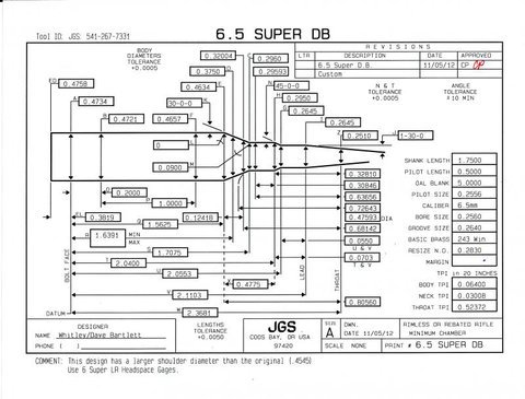

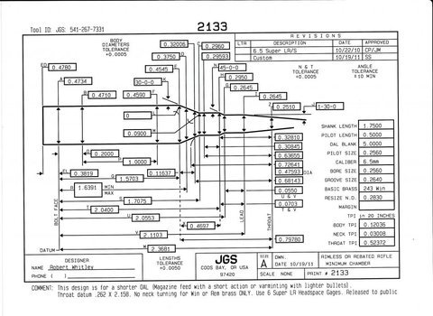

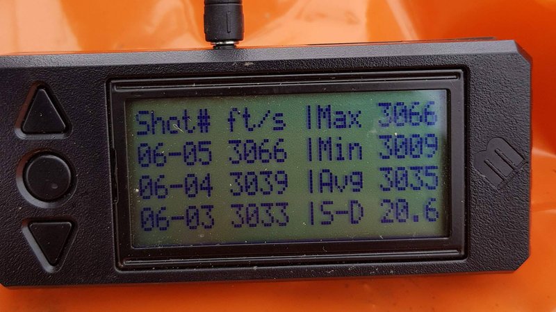

Pulled my reamer print, standard SLR-S reamer print and the velocities from a new adopter previously mentioned as attached images.
