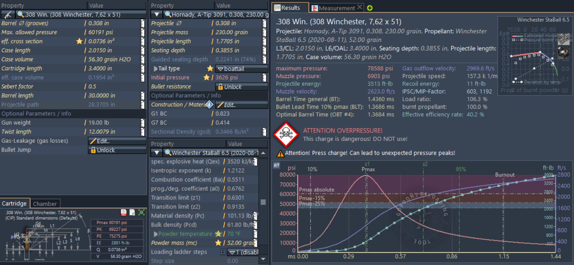

Pictured 308 Win max effort load test is for a long throated, long action, 30" 8 twist 5 R heavy palma...with my chamber reamer and throating reamer... utilizing hybrid cases.
I did all the machining on this rifle so it's one of a kind...could be easily duplicated by a competent gunsmith or machinist.
Definitely not safe on any other 308, way over max...the cartridges won't even fit standard 308 chambers...don't even consider it.

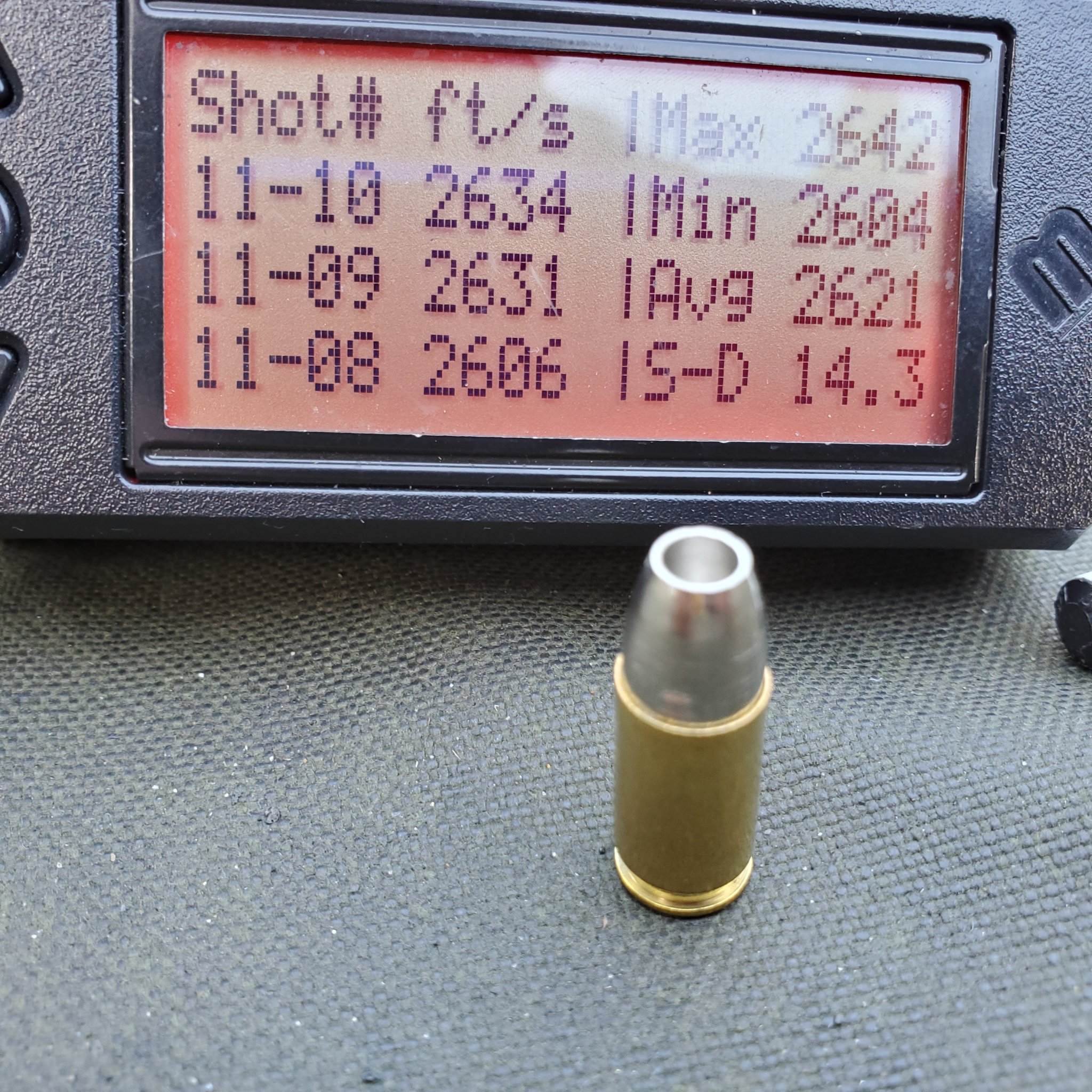

Always checking into how high one can get the velocity of a certain cartridge. What is possible, with certain changes...in everything, that can be changed?
Like a 9 mm Luger at over 2600 fps in a 9mm carbine..some might be interested, some not...but it can be handloaded. Probably a good home defense round...
Who cares? Some might be interested in such things. It's just sharing information on improving cartridges mostly with respect to velocity. Including subsonic loadings like the .510 Whisper or 8.6 blackout...

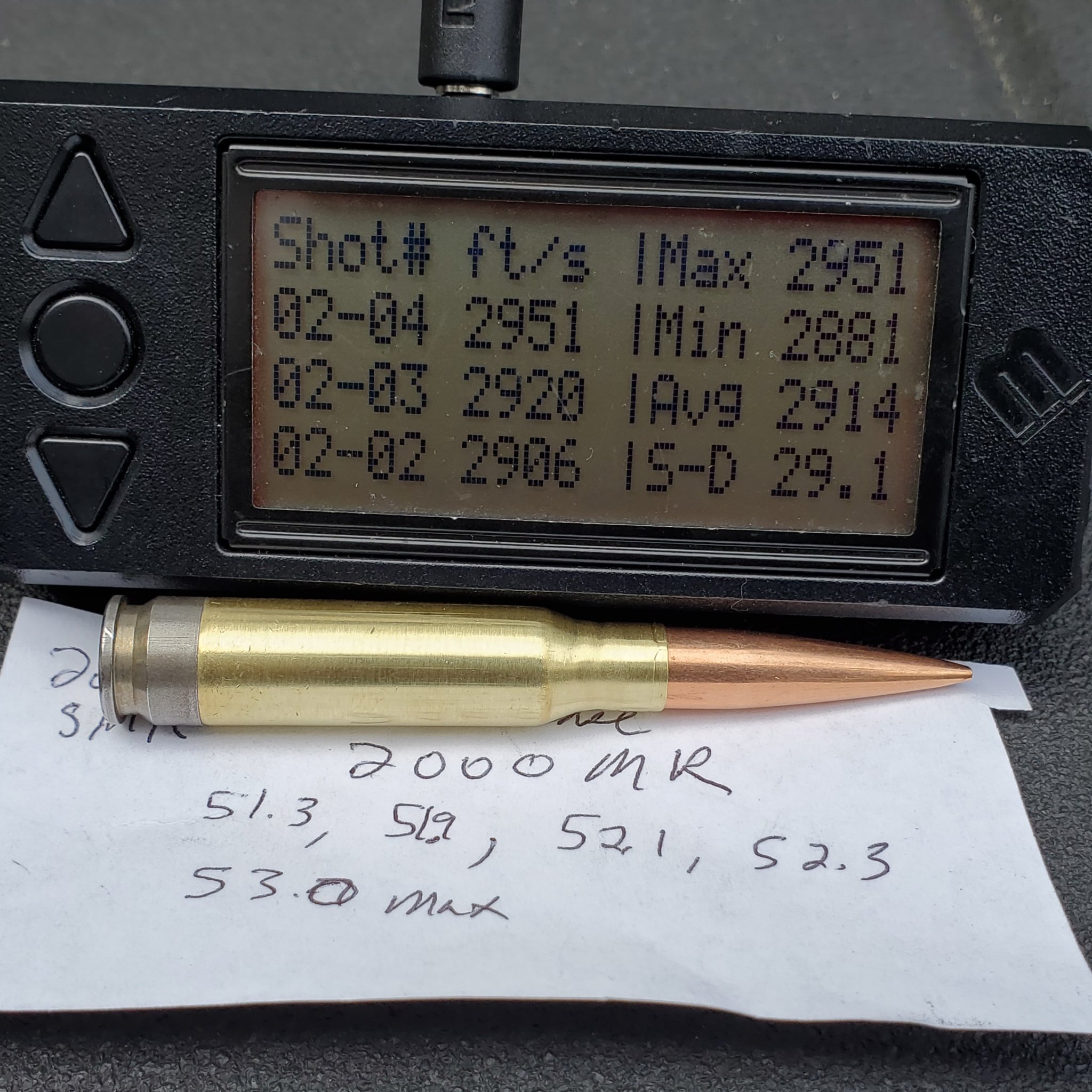

I've been doing this long before the video, as soon as hybrid cases were available.
I use a similar process as the video but with more caution. One can tell the brass guy and action manufacturer had experience with this.
A Bat action is not necessary to get the performance at my level...but it would be prudent to use a Bat action...because of its extra strength.
Those guys went beyond where I go with the action, and accuracy and velocity S/D fell apart, at those super high pressure levels.
Gun powder seems to work well at a certain pressure level, depending on the powder...there is a too low and a too high with today's propellants.
One can keep the action together and velocity/ accuracy S/Ds at lower pressures, and still have a huge improvement in performance.
Notice I backed off the 2951 fps load because of that...and 2900 fps was where it was at with my rifle, for the 200 gr SMK in 308.
Few of todays powders will get the job done...Varget is not one of them...the one they used in the video...it gets erratic, I trued it... 56 fps S/Ds as the pressure builds.
The military had over 60 different blends to get the burn rate right at 80,000 psi.
That powder was top secret and not available to the public...it is a fine ball powder.

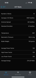

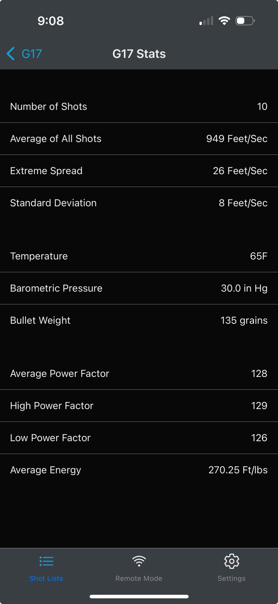

9mm @2600fps is bananas lol, but that's cool, different strokes for different folks.
I might just be into going really slow, my bunny-fart 9mm shit runs ~949fps and barely makes power factor!
View attachment 8437740View attachment 8437744

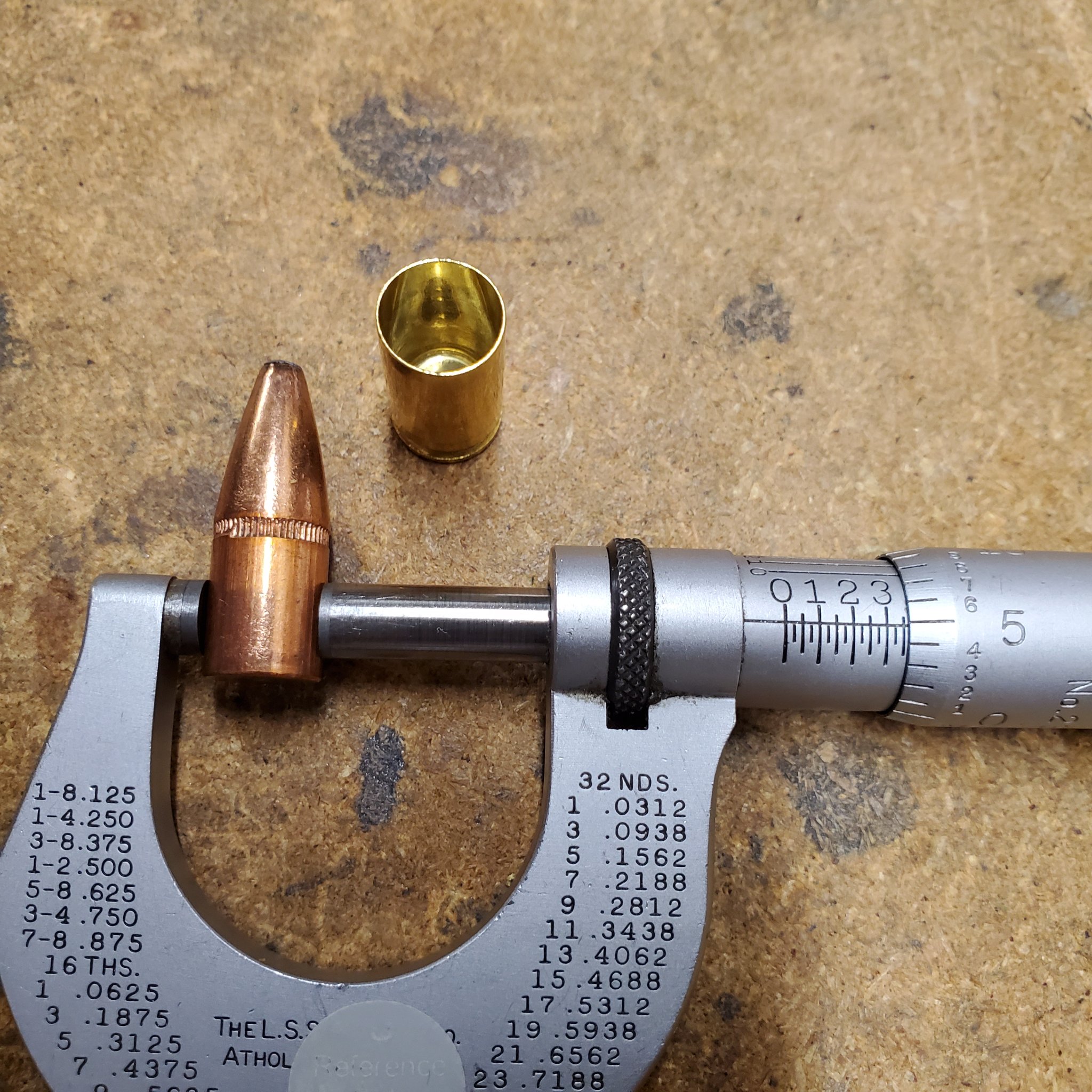

Could 200 gr 9mm be possible? I had to find out..
