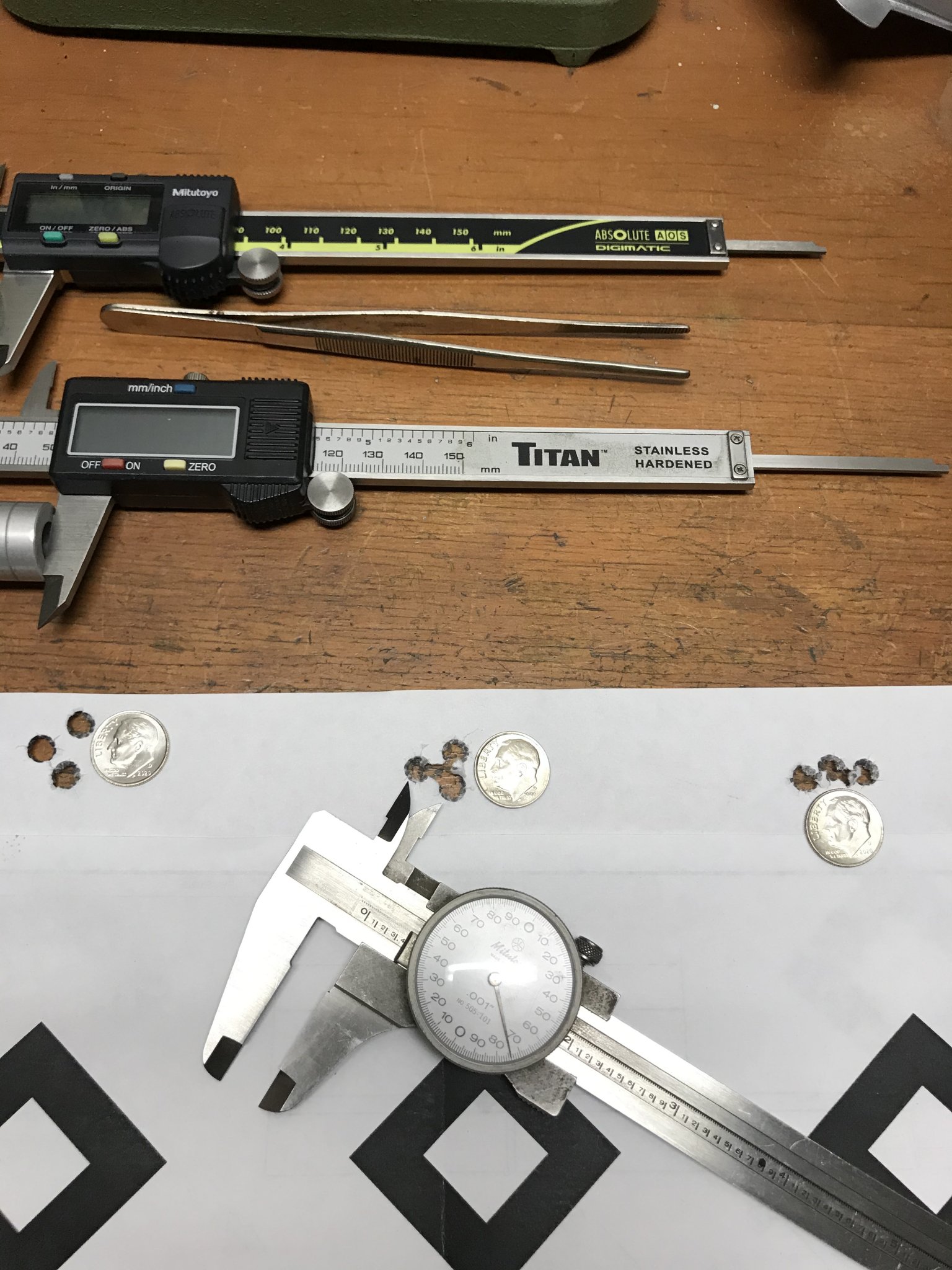

    sboone, I've tried both H4350 and Varget - 39.6 of varget got me 2845 fps with sd: 6.4. 43.5 of H4350 got me more speed (2888 fps with SD: 3.3). Work up both powders. COAL: 2.765 for varget and 2.760 with H4380.

    Thanks, I settled on 43.4 grains of H4350, ran a couple loads above that up to 44 and they started to fall apart and heavy bolt lift. 2.17" CTO still. Have shot about 50 rounds if this load so far, MV 2740 fps, SD is usually in the 5fps range, with federal brass and CCI 200. I was head shottinf a ground hog sillouhette at 350yds pretty easily, and at 600yds a head shot on 2/3 sillouhette was easy day too. 100 yd zero, drop dialed in was 3.7 mils for 600yds. Im happy with this load for sure.
