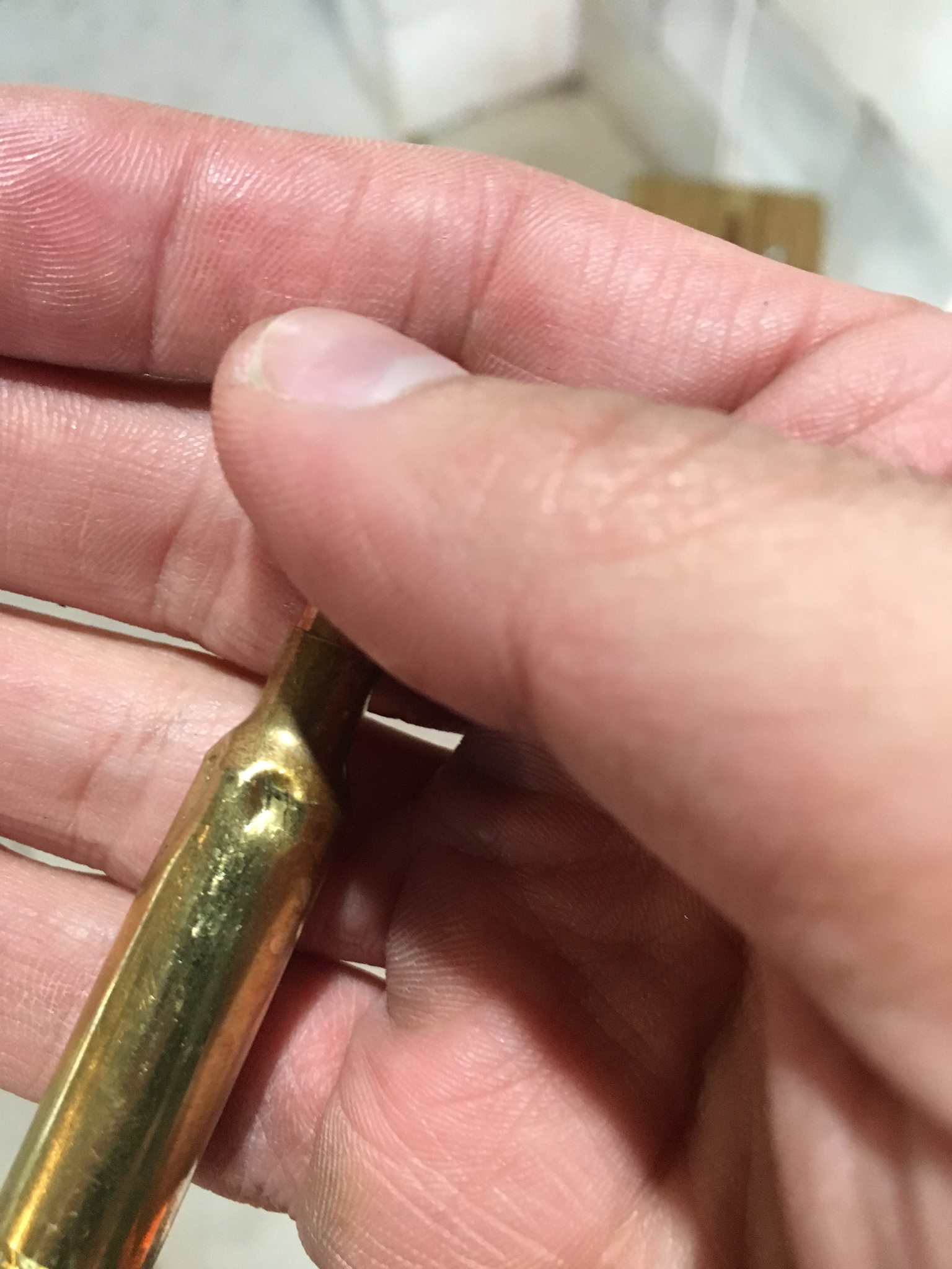

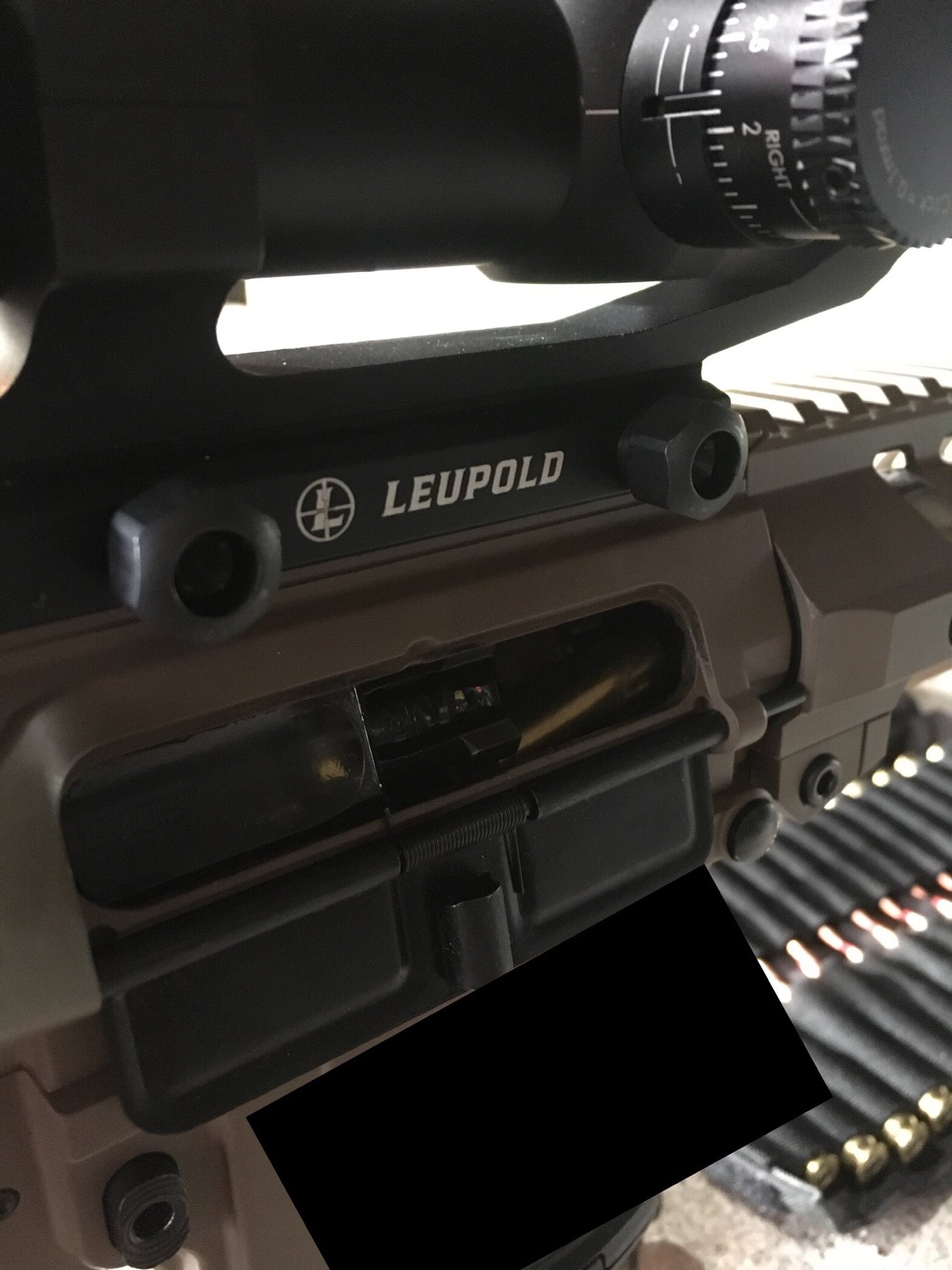

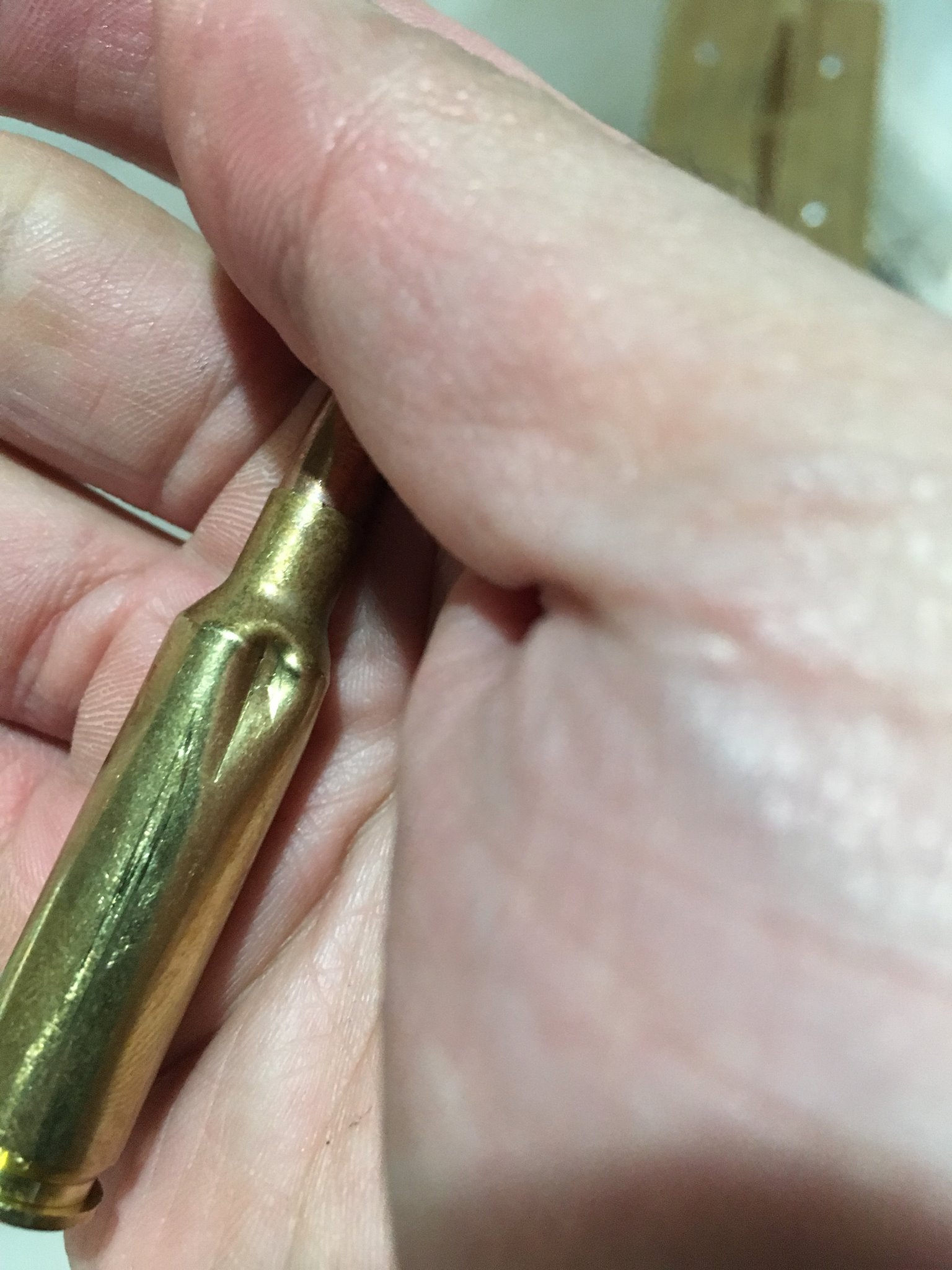

Ok need some input.
Set up is Aero M5 receivers, 22” proof 6.5 CM, rifle+2 gas tube, superlative arms adjustable gas block, rifle buffer tube with rifle Ar10 buffer and spring, and JP BCG.
So the main issue is with the weapon not cycling. The bolt will not lock after firing the last round on a mag even when the SA gas block is open all the way. Also when opening the gas block I experience double feed malfunctions and he weapon not re cocking. A round will be ejected however when pulling the trigger back after reset the hammer will not fall. Shooting Hornady ELD 140gr and Prime 130gr.
Any input is appreciated.
