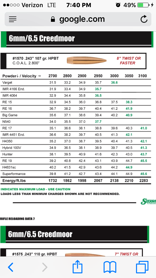

    Anyone using Varget in 6 creed with 105’s?
    I have a 19” 6 creed and I’m currently running H4350 at about 2900fps and I’m noticing my can becoming extremely hotter than usual while shooting 42.7gr of H4350 through it.
    To my question. Is anyone running this combo? I’m interested to see if I can achieve similar velocity and more of a powder burn inside the barrel.
    Any ideas where to start as far as load work up with 105’s.
    The graphic is probably for a 24 inch barrel
    Running a can and H4350 at 19 inches, your more than likely getting some
    incomplete burning of powder.
    It would make sense to run a "faster" burning powder
    or a lighter bullet. Less powder cooler can
    It's all relative, a can is going to get hot
    after 5 rounds or 20. No magic will fix that
