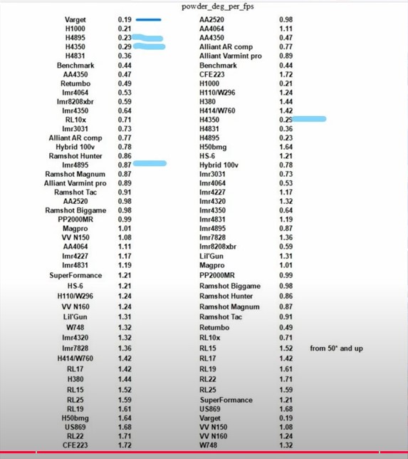

Powder temp stability chart from the internet.
Of the handful I've tested, the data seems to be correct.
