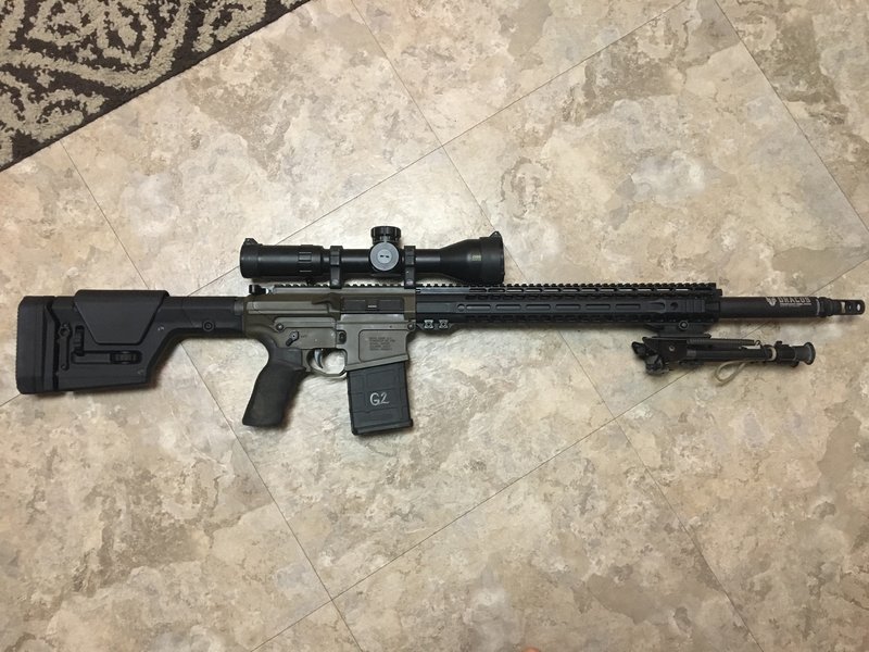

    Got my Dracos barrel in and installed it. I'm running a JP Gen 1 SCS and LMOS BCG w/High Pressure bolt. I also installed a Rubber City Armory gas key. I was shooting suppressed. Took it out today and just loaded up about 50 rounds of the following, for sight in and gas system tuning:
    105gr Nosler RDF
    Converted, 1x fired 6.5 creed brass
    41.3gr H4350
    2.780" COAL
    Avg 2935
    SD 24.5
    Seemed to shoot good. I took it out to 750 and had no problems. Brass came out looking really good after tuning, minimal ejector marks and primers looked ok. Based off of the primers, I don't think I'd venture north of 41.8 out of this gun. I still need to play with the "dwell time" adjustment, and plan on shooting over the chrono again after the barrel breaks in. I expect it should speed up some. This cartridge feels like cheating.

    The gas block on the Dracos barrel doesn't adjust how much gas is going to your BCG like a typical gas block, so the adjustable gas key is absolutely necessary, especially when running a can. It took me a while to wrap my head around the "dwell time adjustment" until I played around with it and it made sense. You'll note that the adjustment screw on the gas block is fully screwed in when you get your barrel. My theory is, as you back out the adjustment screw, it increases the volume of the gas system; fully screwed in and you have a +2 gas system, fully out and you probably have something akin to a +3 (if such a thing existed).
    I was running my 762-SDN-6, and the extraction was pretty violent until I turned the gas way down on the gas key. I believe I'm at about 1.25 turns out from full closed, and it piles up the brass nicely at the 2:30-3:00.
    I still need to do some work to get the SD's down and do a ladder test, but even now, this dog will hunt.
