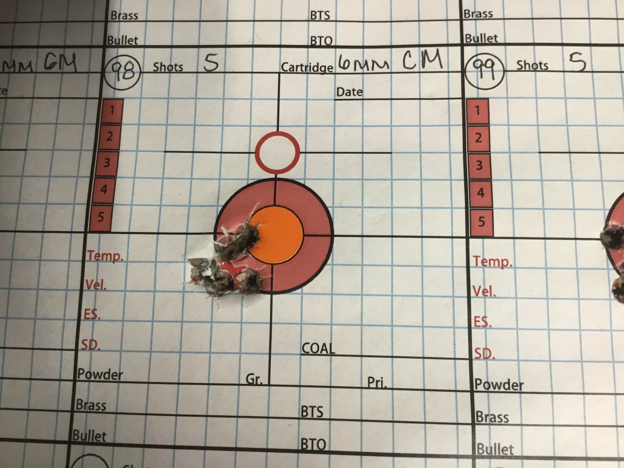

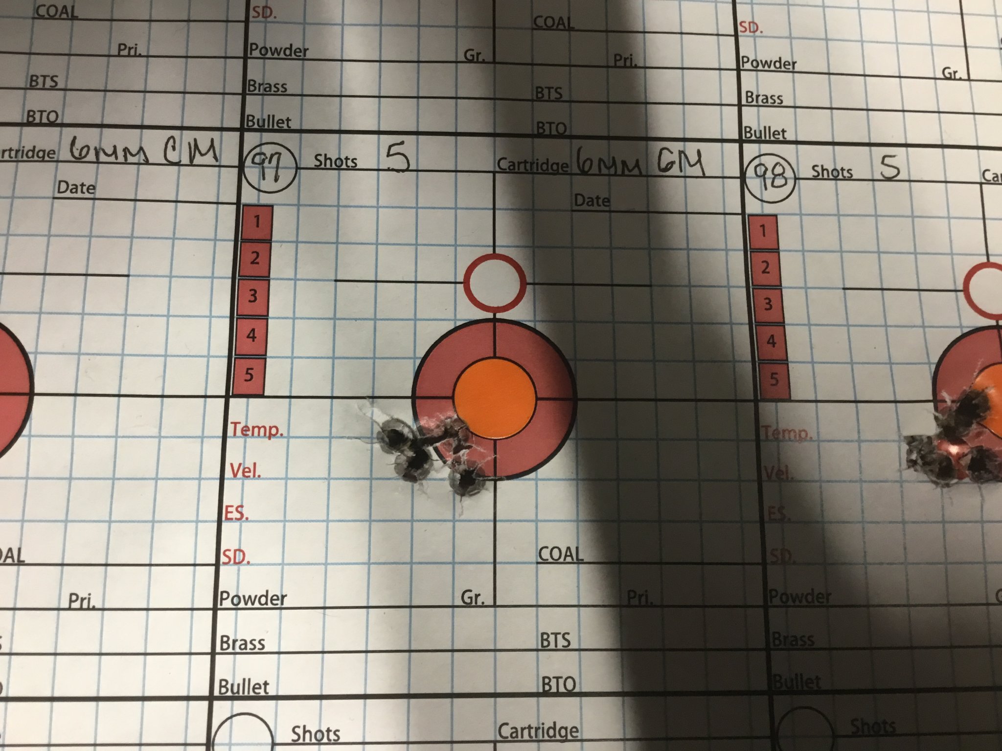

Running an AI AXSA 6mm Creedmoor with a 26” 1-7 twist Bart 5R - .183 FB.
5, 5 shot groups @ 100 yards, cold clean bore to start.
New Lapua brass: neck tension .002, ran mandrel die with Holland’s .2415 mandrel
Load: 40.38grn RL-16
Primer: CCI 450’s
Bullet: 115 DTAC RBT Bare @ .0475 off the lands
COAL: 2.8065
BTO: 2.2240
Vel: 2995 FPS
SD: 5 FPS best 5 shot group was 1.3 FPS
Group opened up a little at the end of the session so I am wondering if this was due to the new brass ?
POI was basically in the same location across all targets.
It could be shooter fatigue, or perhaps a mental thing.... If I'm shooting groups like this, the "pressure" gets on to keep it going till the end. Its all in my head, but the groups open just a bit.
good shooting, BTW. And it looks like this is a good load too ! Congrats.
Reactions: OneShot63
Yes, could potentially be shooter induced ? I have 2 other comp rifles in 6mm SST and 6.5 SST and they shoot pretty much 1/4” MOA across the board. Yes this load is really close, I may try a little less neck tension for the next round and see what affect it has on the consistency.
Thanks for the feedback I really appreciate you responding for sure, good or bad !

From closely analizing the targets in @OneShot63 post, I don't think what we see can be blamed on bullets. All the groups appear to be w/in approx. 5/8 MOA, so not really anything to complain about for the type of shooting we do. The first target is solid for sure. As the targets progress, there is an extremely small shift in POI (assuming POA was same). Also I see the groups have a bit of horizontal dispersion, then tighten up in horizontal but have a bit of vertical. So leads me to ask the question is shooter breaking position and coming back to rifle each shot? Raising head? Perhaps nothing shooter induced, but eye fatigue (my astigmatism does this very thing to me).
Another consistent thing I see is the Berger Fanclub (and I shoot Berger bullets too) jump all over the DTAC every time it is mentioned. It is known there are differing BCs with these bullets depending on the lot you get. Lot to Lot consistency has not been consistent. Within lots, I haven't noticed any inconsistencies... you get the high BC lot, or the lower BC lot. Honest question here - Have you guys seen a single lot of DTAC bullets so inconsistent it would account for the aprox. 5/8" vertical dispersion at 100 yards demonstrated in Target #99 above (post #64)?
I'm not questioning the excellent quality of Berger bullets, nor the identified BC differences among the various lots of DTACs. I'm not convinced its the big deal made out to be by the Berger fanclub or the answer to every question asked by Berger haters.

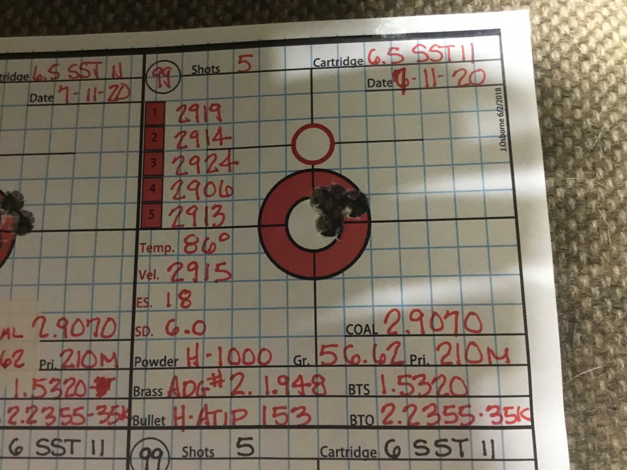

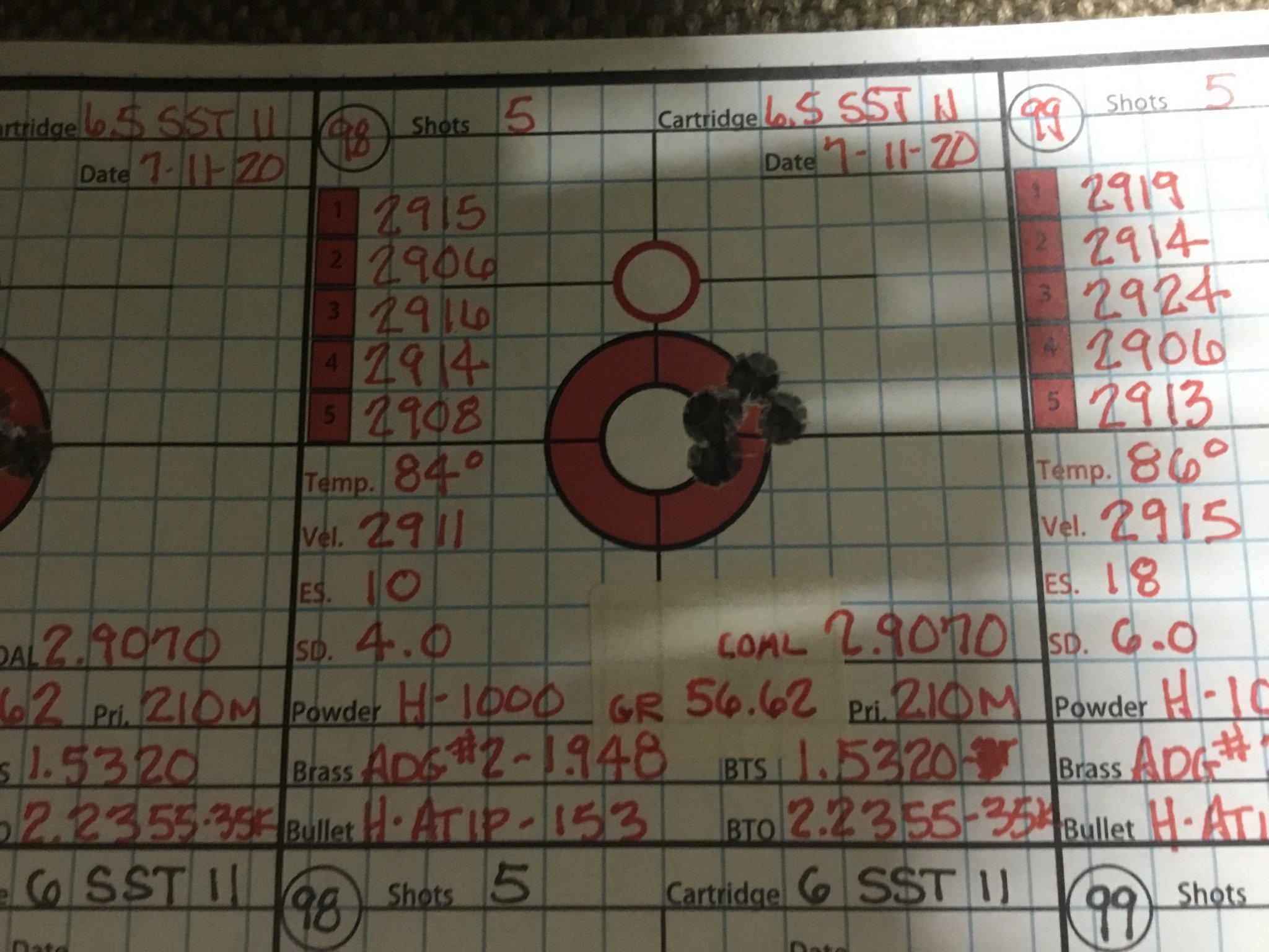

That was certainly a very good analogy of the targets and the string of fire. Yes I did break position after each shot, I also wear glasses so eye fatigue may play into the equation. I appreciate your evaluation and respect your comments, as they do make perfect sense.
I do shoot 2 other short magnums that have very good results across all 5 targets using the same method during load development. These can be seen in the attached photos. 6.5 SST II.
This is the first time shooting the 6mm Creedmoor and I wanted to get some feedback in case I was missing something.
Thanks again for your post.
