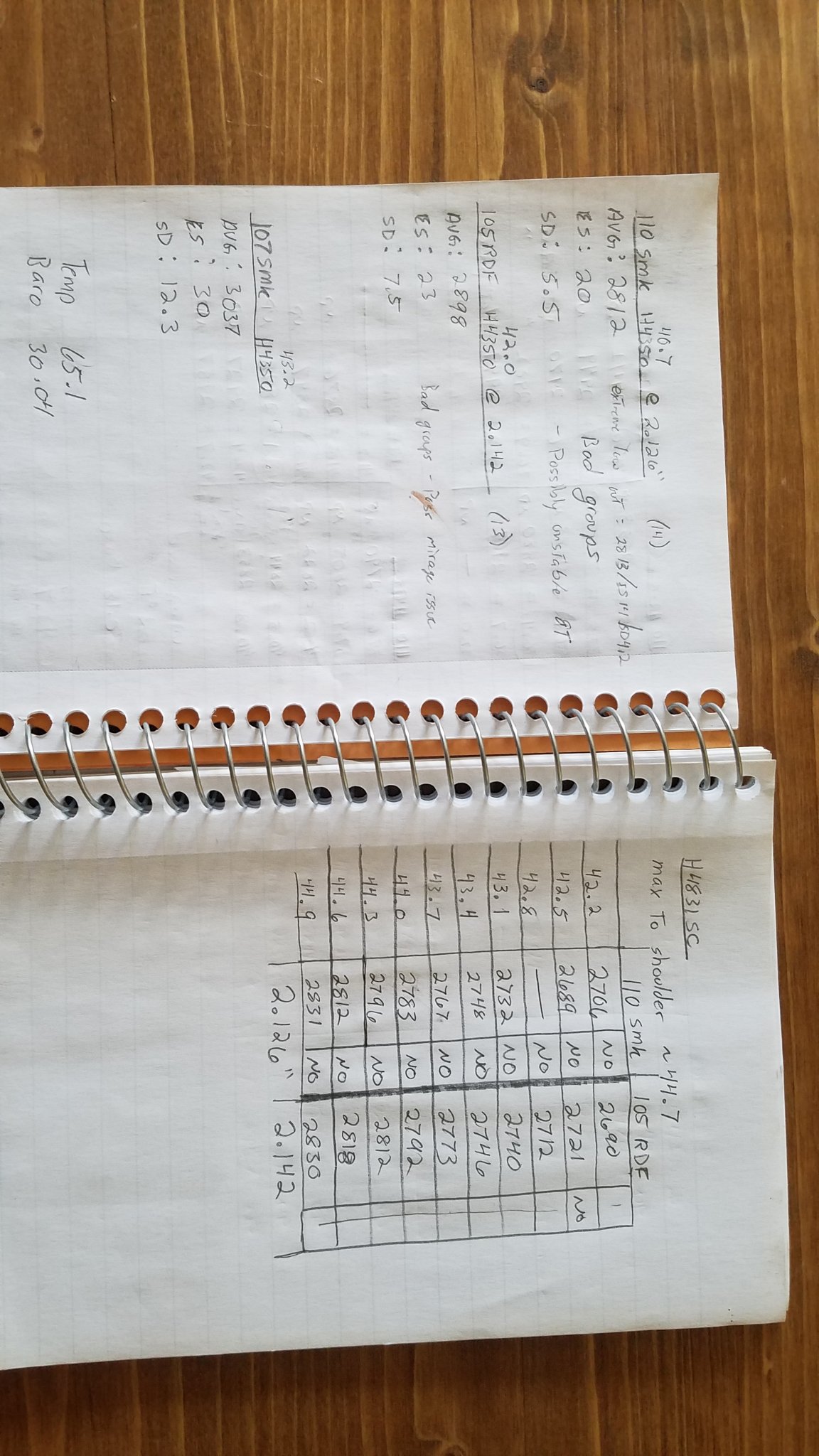

    Here is the velocity results for h4831sc (right page). Will have to test higher, no crunching at 44.9. Left is the h4350 test for sd/es where i had flat spots. With my reamer the 110smks are jumping .110 just to fit in the mag. Smks have really done best for me in the .020 jump range so im thinking at this point either get a reamer more appropriate or use an XC reamer made for 110/115 i have. Xc would help my case fill issue a bit and id just run h4350 since its a bit more appropriate in this application.
    Rl16 will most likely be the best powder for what you are trying to do. Little slower burning than h4350 but faster than 4831
    It is super fluffy and will fill the case ,and it will give great speed. If your barrel was a little longer then I would say rl23 would be best. Both are top notch though
    After crunching some numbers for lengths ive opted to go 6XC. The reamer I have is more suited for 110s in an AICS mag. The Creedmoor reamer i have is .183 freebore and worked better in my AW mag setups.
    6xc will also help me with this case fill issue. Going to try rl16, h4350, rl17 and this AR Comp i have 21#s of.
