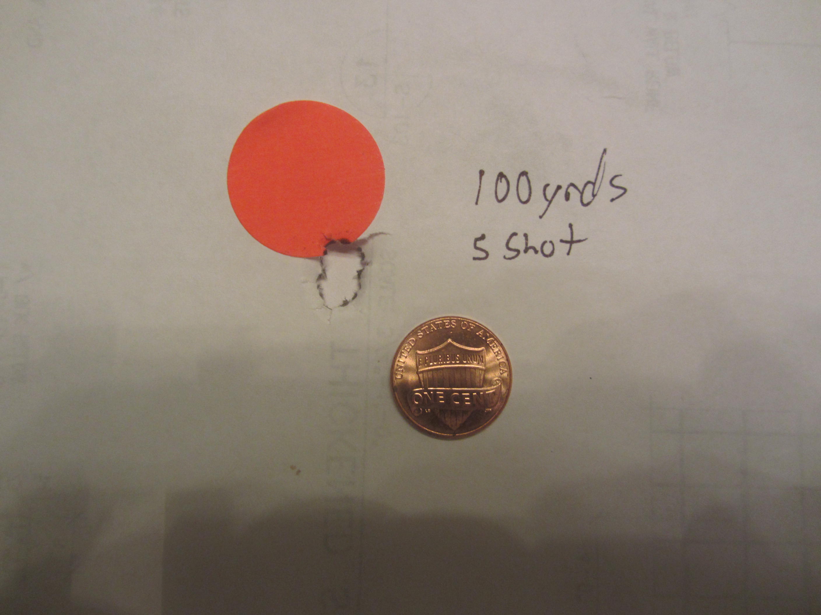

Man I hope my 6.5X47 doesnt ever figure out that it has too much powder for that SRP. I know these are probably not quite as tight as a benchrest rifle but you will have to forgive me, I left my farley rest at home along with my rear bag and shot these out of the back of a pickup prone with a harris bipod and makeshift sand bag filled with cat litter with factory ammo. And whatever you do don't tell the palma guys that shoot .308's with SRP's that they have too much powder either. Seriously though the SRP does give a more consistent burn in certain calibers and I would say a 6X47 lapua has the simple advantage of Lapua brass which is made way better and more consistent than other brass...this is a fact. I have read alot about primers and it seems to be an argument that will never end but there are tons and tons of articles that have been written about it over the years. German Salazar stated " “accuracy is more easily found when the influence of the primer on the overall pressure of the load is minimized.” I believe the combination is with primer, powder, case design and bullet choice everything has to work together. To say that that is too much powder for a small rifle primer to ignite is totally an incorrect statement, and has no basis of fact. Fill a 300 win mag size case with bullseye and touch off a small rifle primer behind it and see if it goes off...lol.
Wow. You posted some 1 hole 100 yard groups. If you want to whip them out and compare I can do the same. I would hope with a match rifle you can shoot one hole groups at 100 yards.

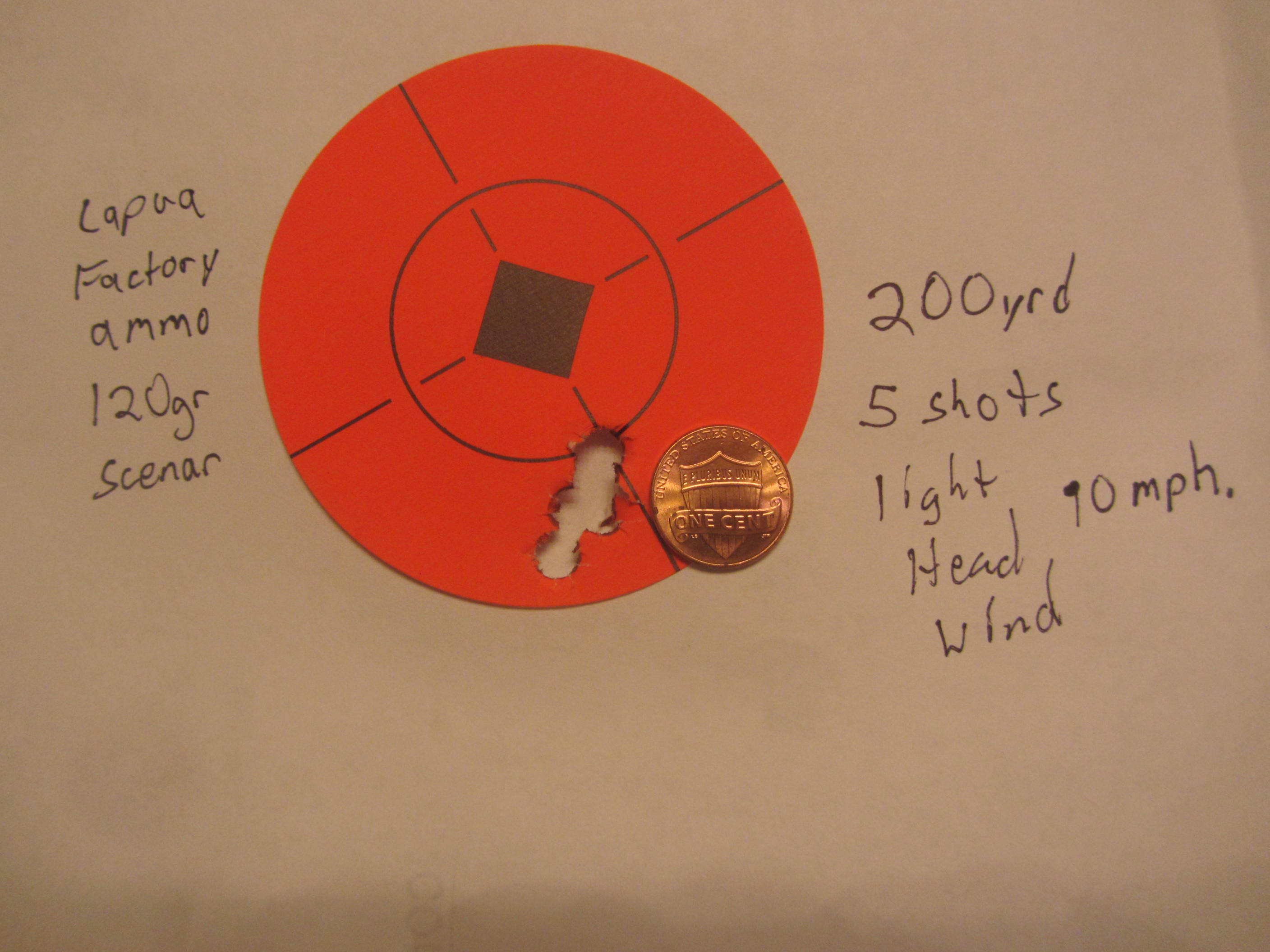

200 yard group shot last week:

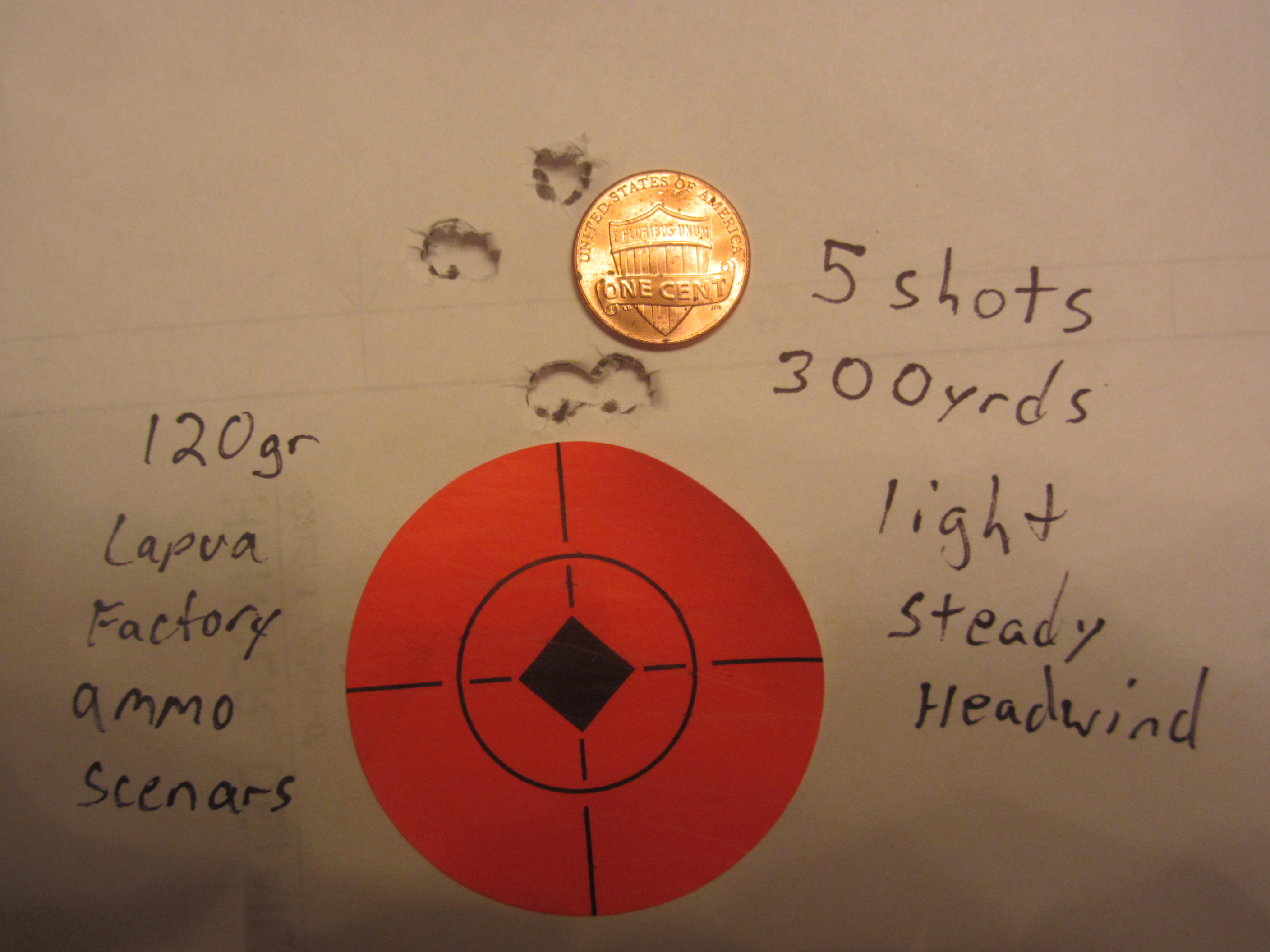

300 yard shot with my 6.5
You however were missing my point. There is a balance between the amount of powder and the proper ignition to light it all off in a good manner. Of course a small primer will light off a 300wm but how's that ES gonna be? I'm saying when you get in the 40gr range it's getting to be borderline to much for a SRP if you want the most accuracy. You can post your groups all day long and argue but when someone who's in the hall of fame for benchrest shooting says so, I listen. I don't argu that my match rifle shoots one hole groups at 100 yards.
