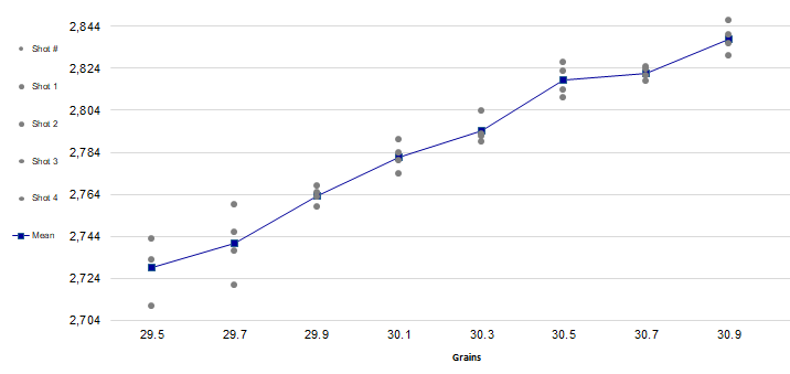

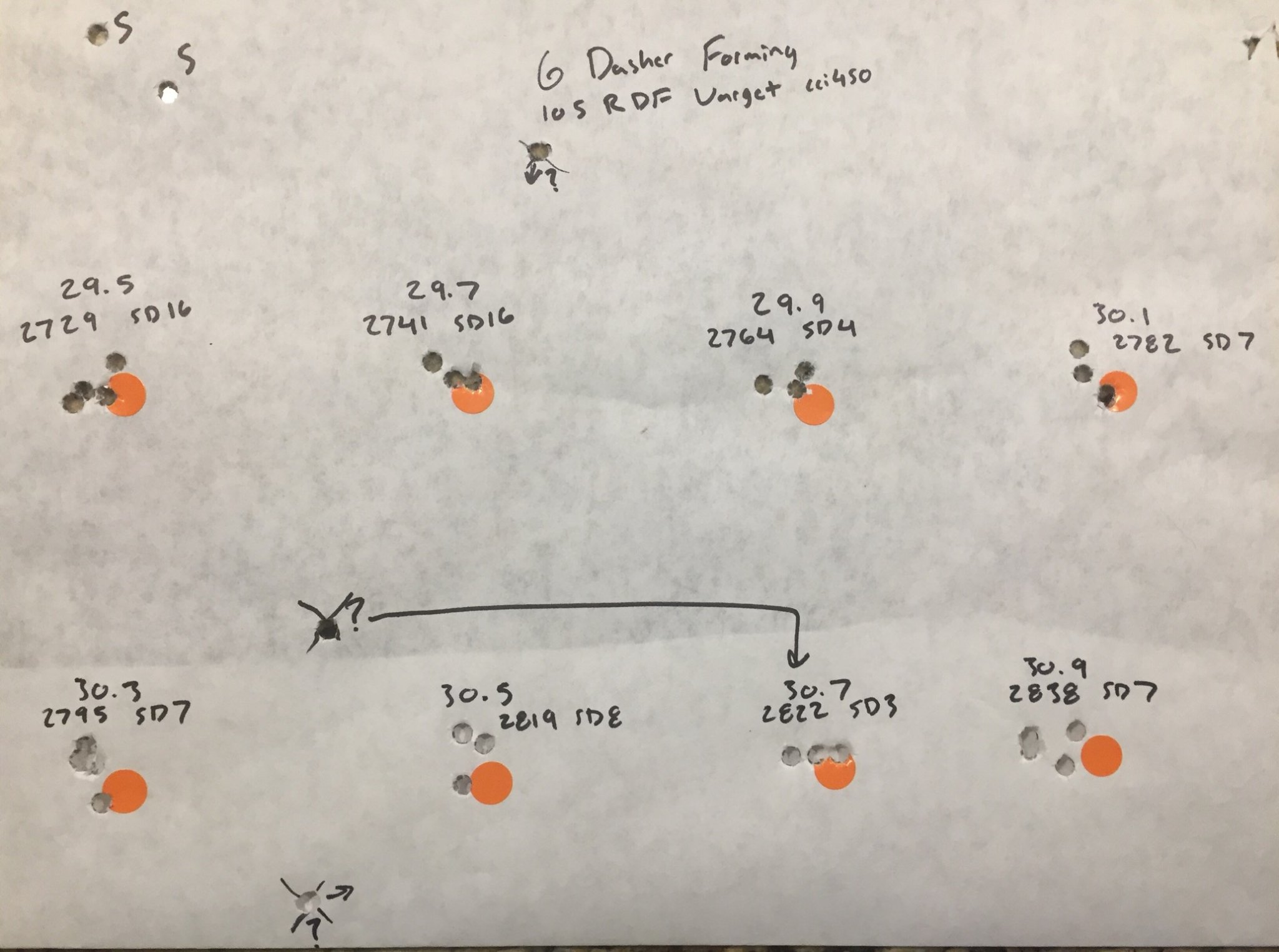

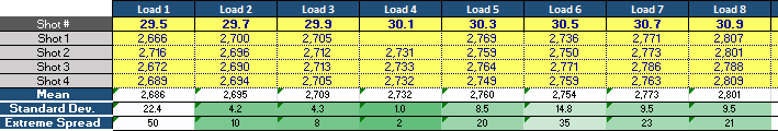

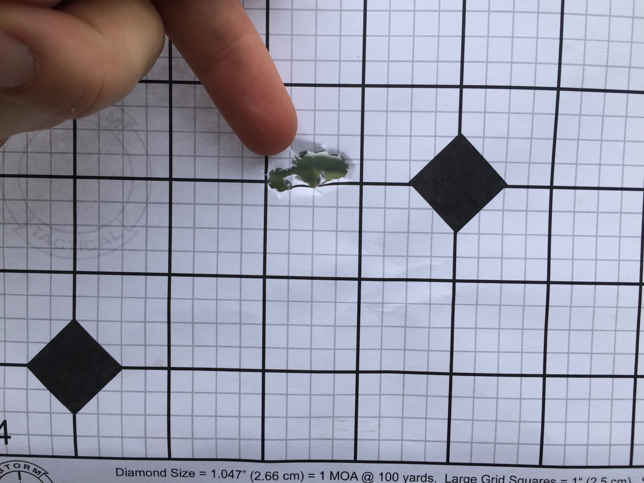

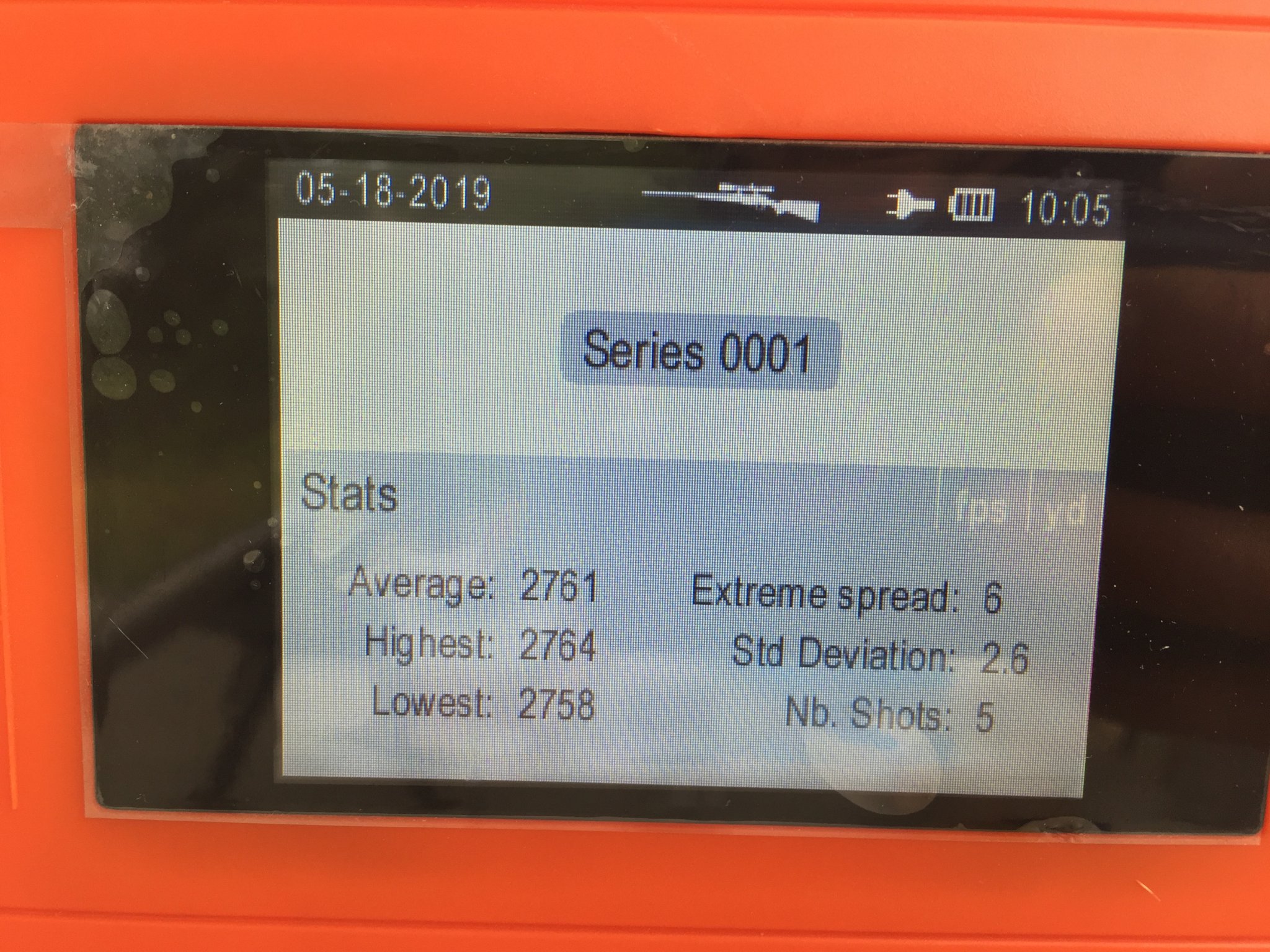

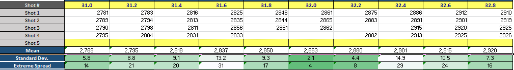

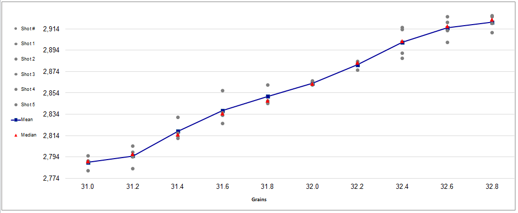

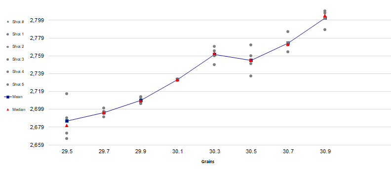

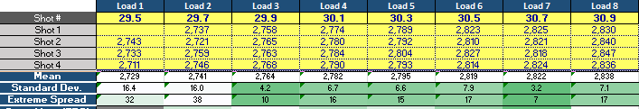

So I know this is basically pointless since Im only forming brass for another 120 rounds with this but still gives me my entertainment. False shoulder plus a healthy bullet jam. Even the lowest loads are giving me brass to the same blow length so Im not too concerned about that issue.
Lapua, cci 450, 105 ref, varget
Im blaming the fliers on the brass forming, I never had fliers 2 mils out with them jumping in my xc. That said there are a handful of crazy bad fliers.
It had 100 rounds on the barrel before I started and last weekend it was around 80 degrees and I got these results at 100 yards
7075867
7075872
7075879

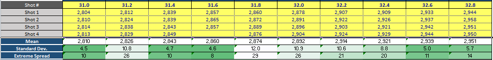

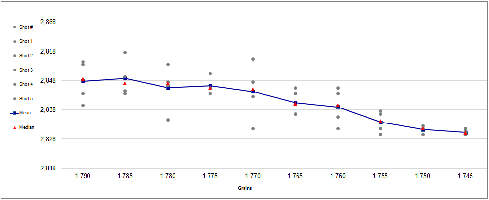

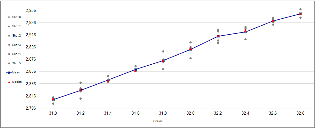

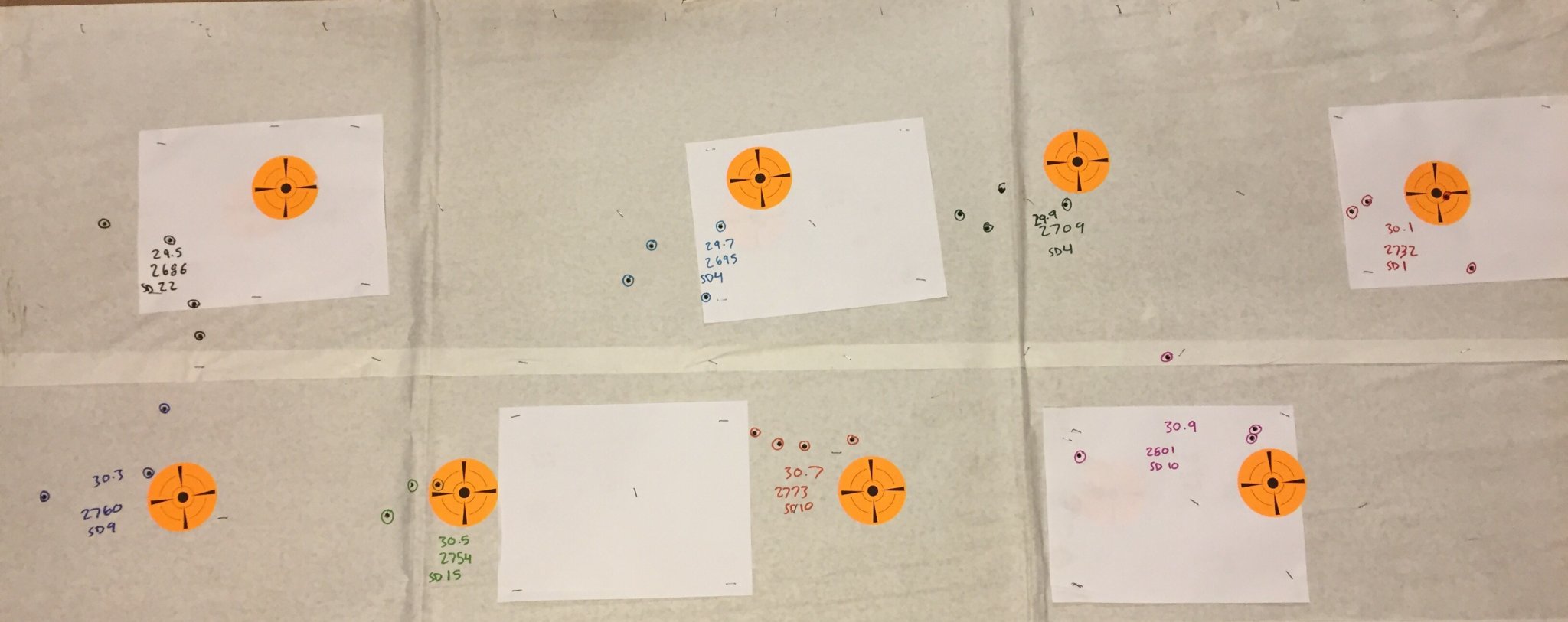

And this weekend it was around 65 and I got these results at 500
7075873
7075866
7075880
Its interesting that the velocities dropped that much with just a few degrees.
I think Im going to go with 29.9 for the rest of my 300.

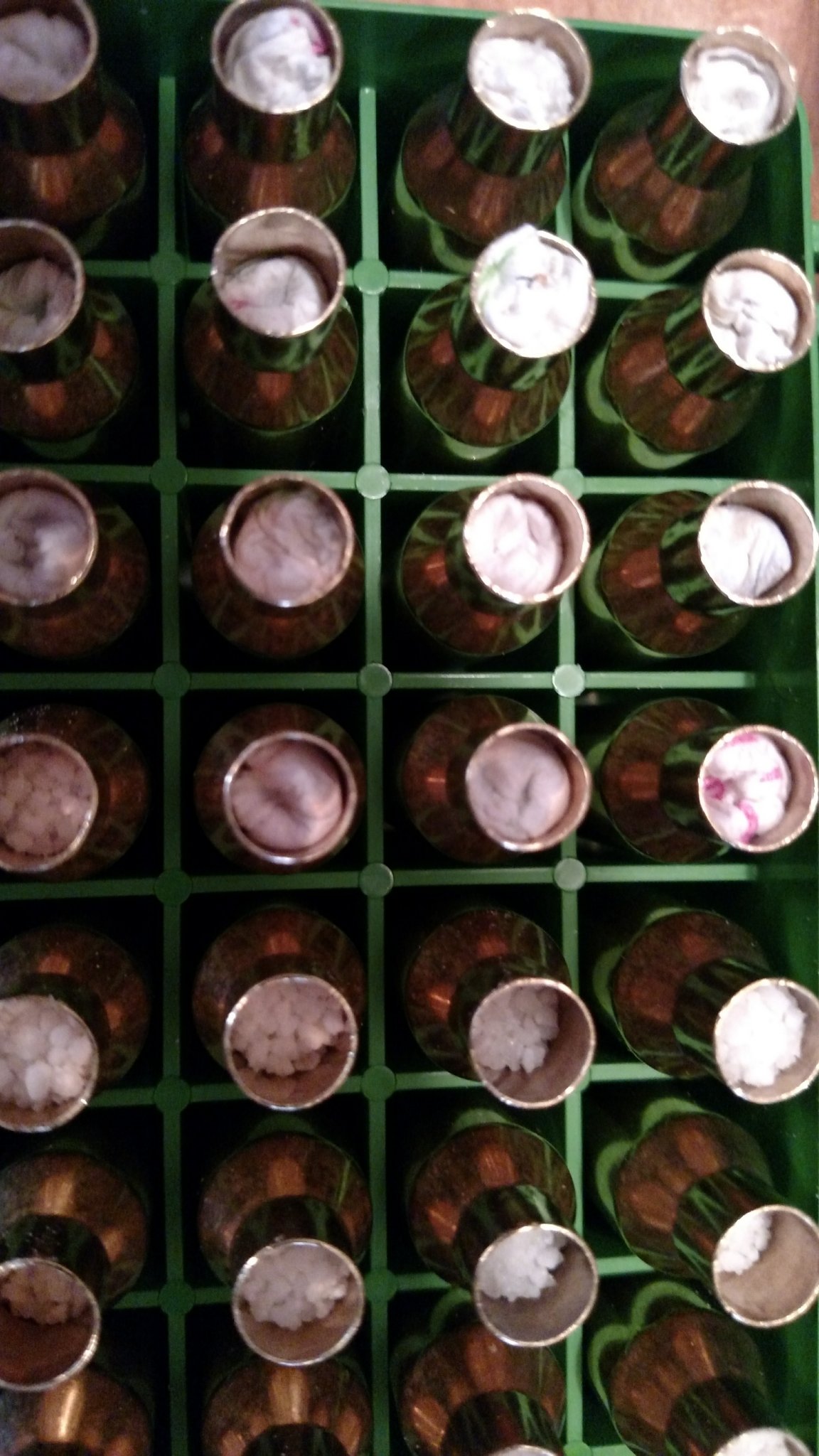

You want the false shoulder snug enough that it requires a good palming of the bolt to close it in the action.
You want to use a soft primer when fireforming and a hard primer once the brass is ready to go.
A Fed 205 primer in Lapua brass with 15 grains of red dot or unique or 700X works well.
Fill the rest of the case 100% to the top of the neck with cream of wheat or tapioca pudding mix.
Tap on the outside of the case with the spoon you used to fill the case until the breakfast cereal settles to the neck shoulder junction.
Add a piece of toilet paper or paper towel to the top of the breakfast cereal as a wadding agent.
Some guys will use a light coating of imperial sizing die wax on the brass to keep the brass from sticking to the chamber walls.
To see how affective jamming a bullet is jam one without any powder and dry fire the gun. The force of the firing pin will drive the case forward untril it is stopped by the extractor. This is what leads to early case head separations.
Try it and measure your OAL.

My experience.....
Fireforming w/30gr of Varget, CCI 450, whatever .243 projectile you have, jam it 0.030 into the lands.
Practice positional shooting at 400-450yds. Simple, Effective.

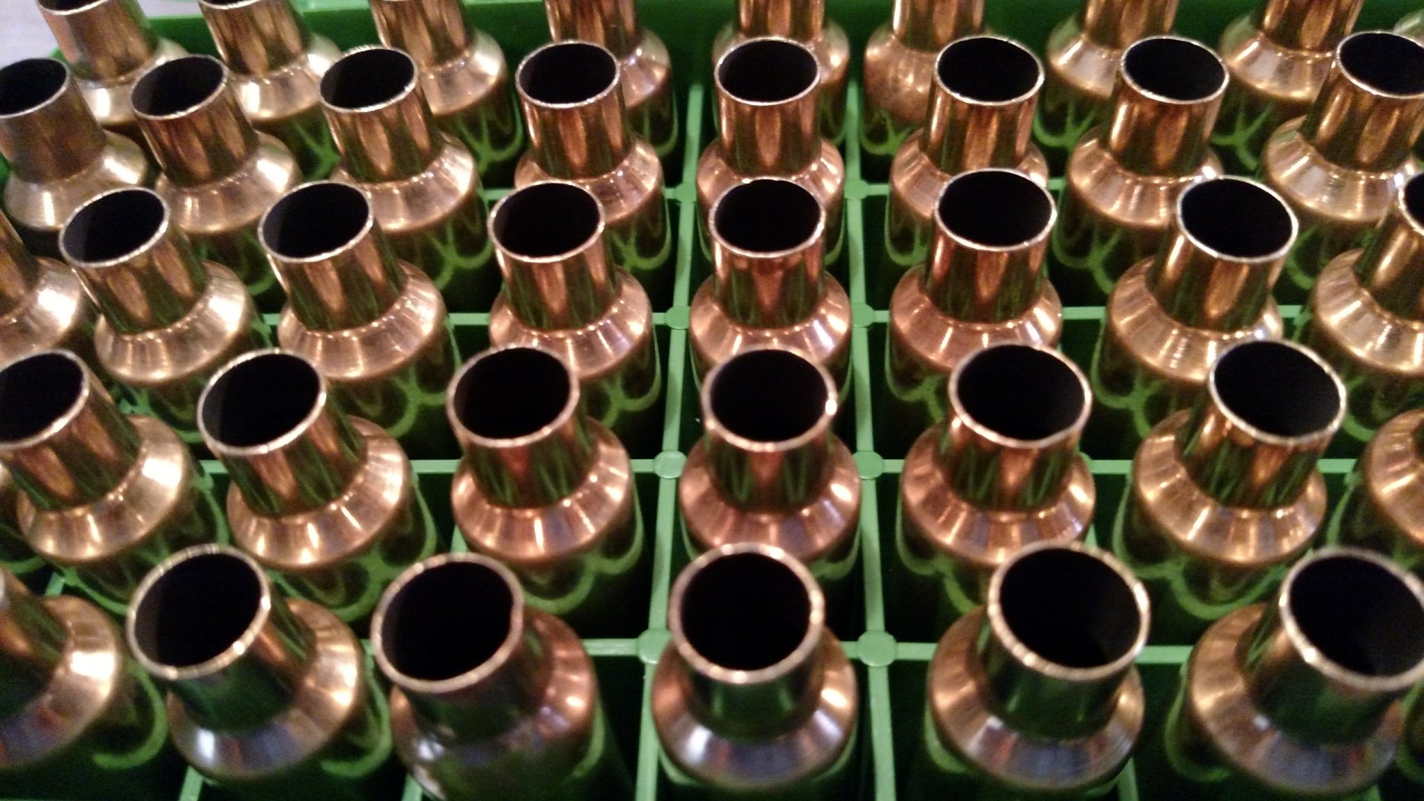

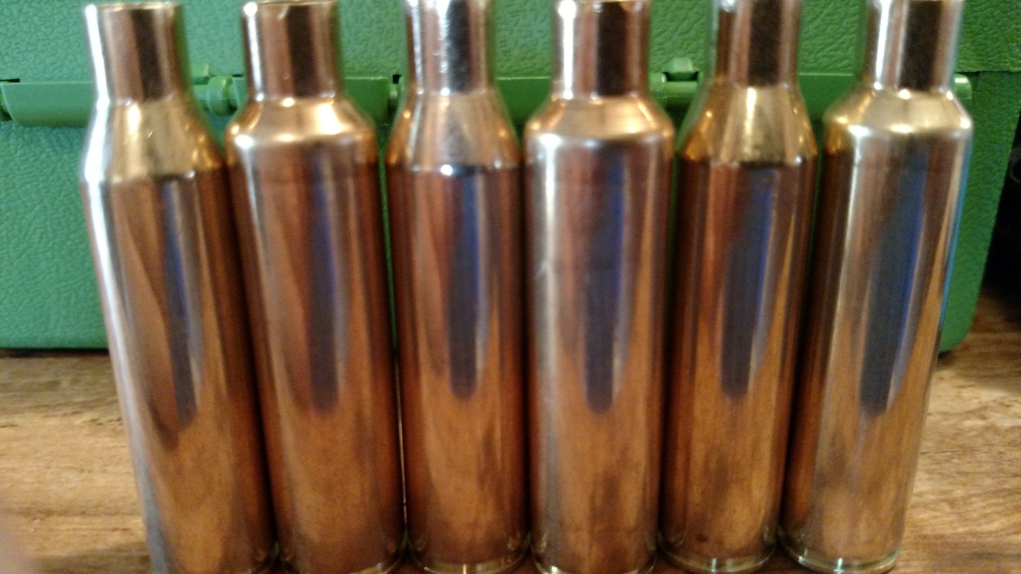

My first 2 dashers I bought hydro formed, the 2 newest I fireformed, way longer necks on FF cases.
I used false shoulder only, 29gr of varget with a 105 hybrid, and 29.5gr with a 110. The 110 load was really good to 1K, where the 105 load petered out quite a bit at 800 yards.
After fireforming....
Headspace 1.241"
Lands 1.685", Seating to ogive 1.675"
COAL - 2.282
Current Load
32.8gr Varget
CCI 450 Primer
Berger 105gr Hybrid
2935fps

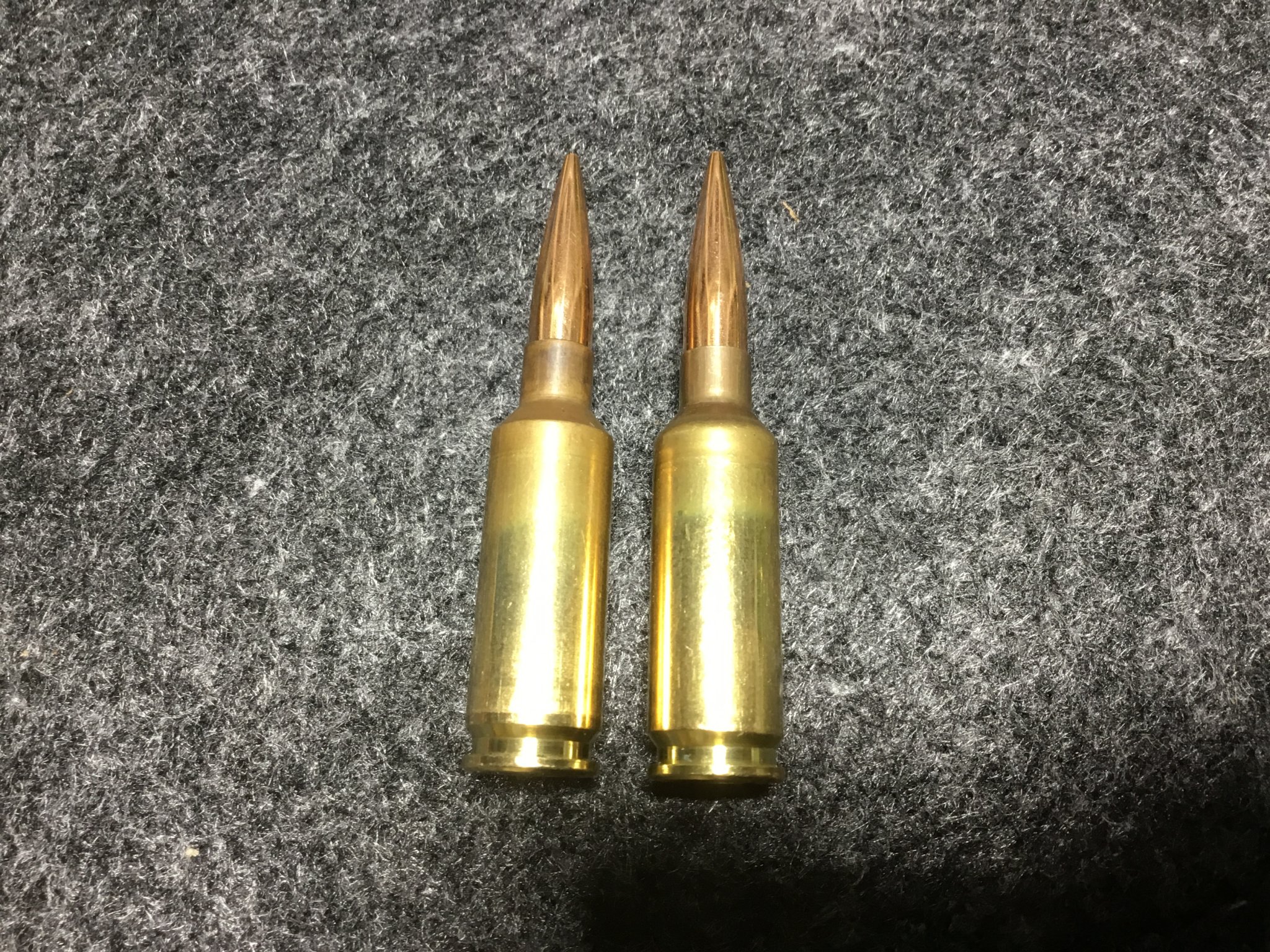

I was more referring to neck length, 1.545" etc...
Case length / Trim Length - 1.540"
I have my reamer diagram, plus all kinds of measuring tools, I asked a guy what OAL he was getting during his FF. My hydro formed brass I bought came to at 1.528 and has maybe grown .010" in 4 firings, where my FF brass is mostly coming out at 1.548". I'll take the longer neck any day as long as they are consistent.
Out of my check of 25 pieces I had one that was 1.553 and 2 that were 1.540. Other than that they were 1.542-1.544 with most of them being 1.544.

Where is that 0.020 of growth coming from?
The difference between the hydro formed brass and the fireformed brass.
My hydro brass from DJ’s and Hunts is significantly shorter than my fireform.
My fireform is 1.541-1.543
Hydro from DJ’s is 1.528-1.530
Similar base to neck datum but shorter neck on the hydro
No problem. Why do you think your hydro is so short? Did you trim it or it just is?
DITTO, my FF is slightly longer though, 1.548" avg
The hydro formed brass is shorter because you are not stretching the area around the web when forming it like you do when fireforming with a bullet.

I hydro form all my dasher brass a little long and then resize the shoulders back. This makes the brass appear almost fire form. I can pretty much shoot a match with this brass without any POI difference from 2 or 3 times fired brass. Here is a picture of a hydro form loaded round, take guess which one.

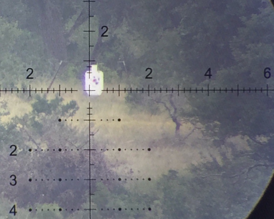

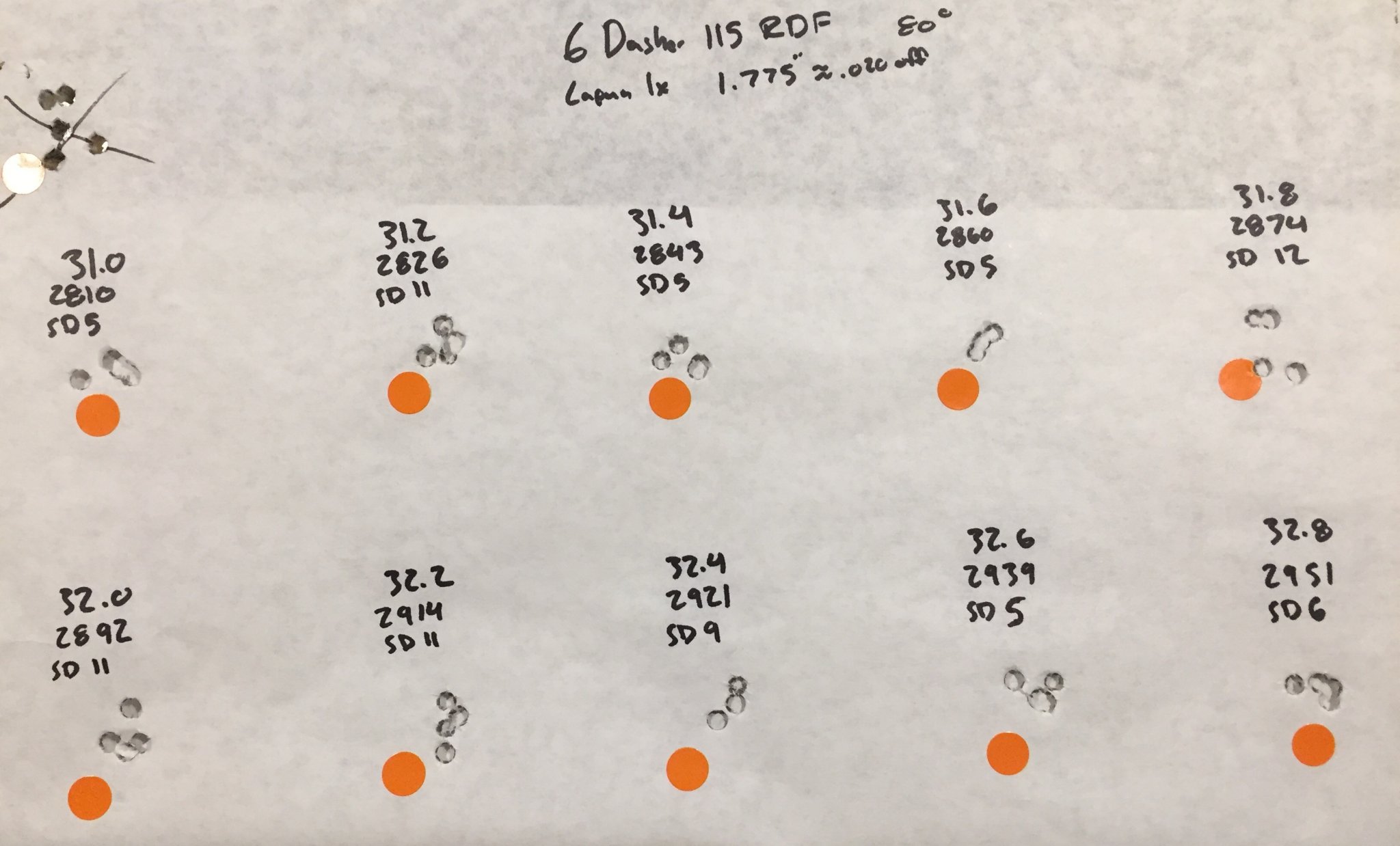

500 yards painted a pretty good waterline while I figure out the wind on the 66% ipsc
7079634
800 group on fill size ipsc
7079635
And then after some practice on the barricade messing the targets up for close pics it started raining in the wind so I called it quits

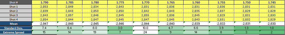

So I have formed it all, last weekend I did a round of 105 stuff because thats what I had but then after they were loaded I found my 115s so I figured I would run a 500 yard ocw for them and abandon the 105s for now.
These 115s are some long SOBs. Base of the bullet is located about even with the body/shoulder transition, taking up more case capacity than I would like, makes me think maybe the 105s are better situated for this chambering.
.104 free bore means touching is 1.798 ogive, 2.340 oal, seated at 1.778 so ~.020 off the lands.
7088194
7088193
7088195
There was some slight wind but for the most part they were fairly consistent, does make me wonder if the stretching was due to that or just funky harmonics.
Give me some suggestions but Ill probably run this back at 100 next weekend to compare.

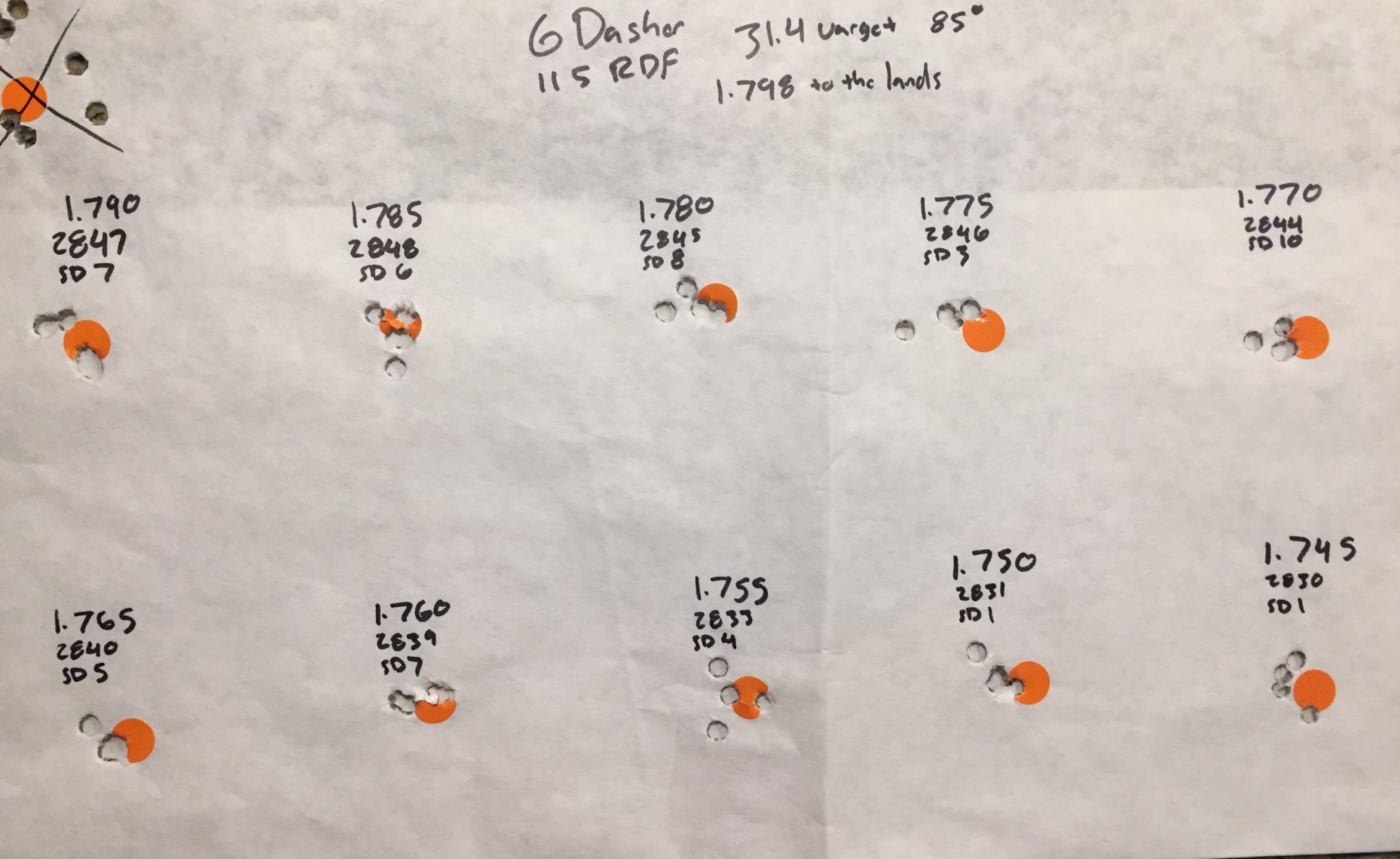

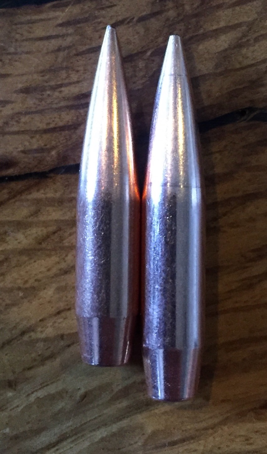

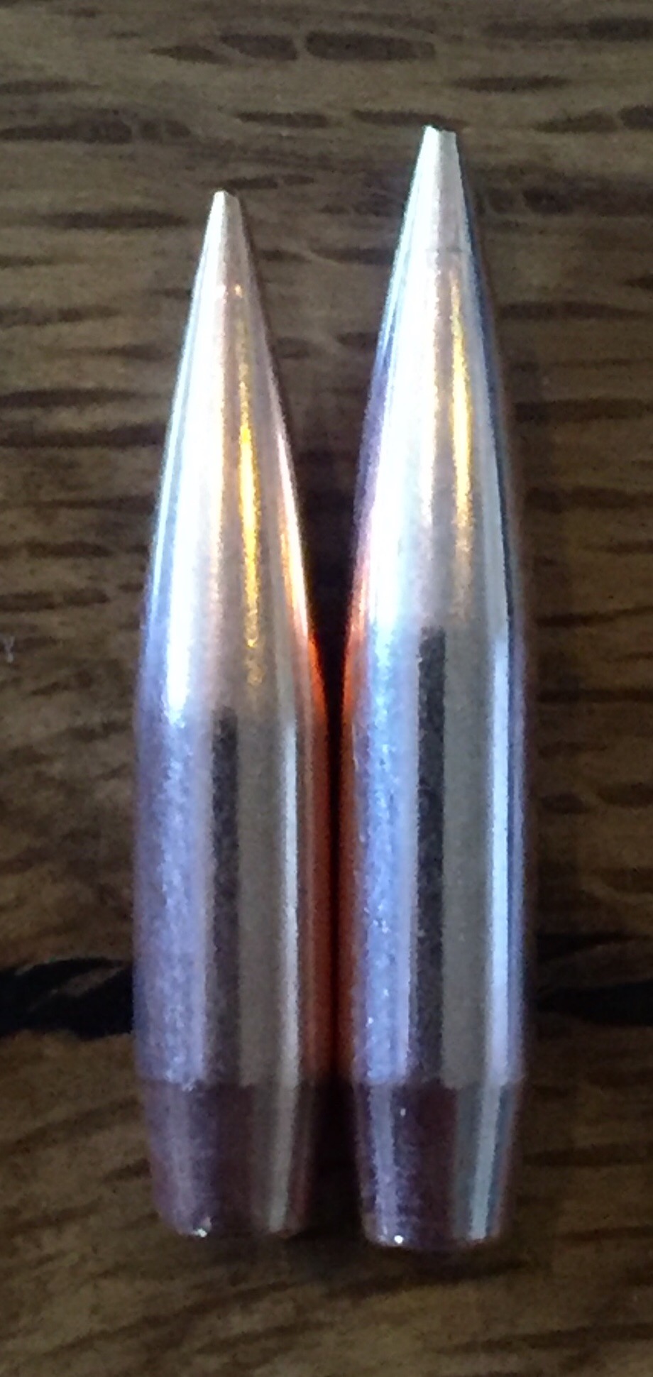

105 vs 115 rdf
1.259 vs 1.345 oal
.663 vs .777 bto via hornady comps
Bottom of the bearing surface even
7088340
The hornady comparator line even
7088342
My wheeer touch measurements with 300 rounds on the .104 free bore barrel
105 is 1.798 ogive, 2.395 coal
115 is 1.793 ogive, 2.340 coal

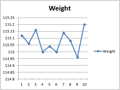

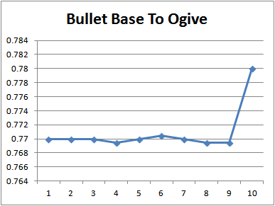

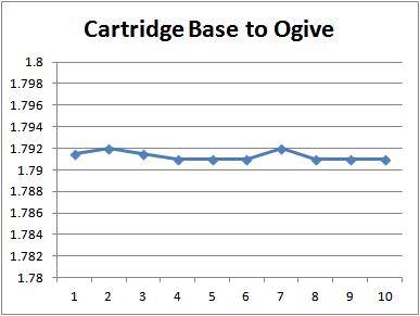

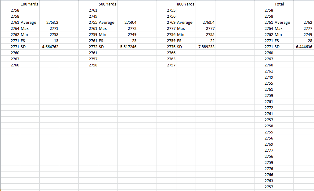

Edit to this just to keep the RDF measurements in one place

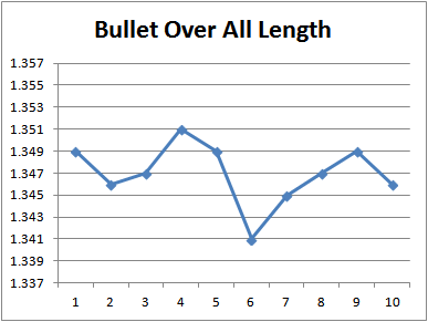

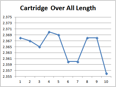

I took a random sample of 10 out of the bag and got these results when seated.
Bullet #Bullet Over All LengthBullet Base To OgiveCartridge Over All LengthCartridge Base to OgiveWeight
11.3490.772.3681.7915115.12
21.3460.772.3671.792115.06
31.3470.772.3651.7915115.16
41.3510.76952.371.791115
51.3490.772.3691.791115.04
61.3410.77052.361.791115
71.3450.772.361.792115.14
81.3470.76952.3681.791115.08
91.3490.76952.3681.791114.96
101.3460.782.3561.791115.2
Average1.3470.77092.36511.7913115.076
Max1.3510.782.371.792115.2
Min1.3410.76952.3561.791114.96
ES0.010.01050.0140.0010.24
SD0.002650.003050.004500.000400.07419

@MDT_Josh in response to your question about the 115 RDFs. See above
Much appreciated and it seems like @spife7980 is seeing similar results. I am inclined to agree that it worries me how far I have to push the bullet back into my brass with a .104 FB, and that to run these efficiently, you'd probably want to change out your reamer spec.
