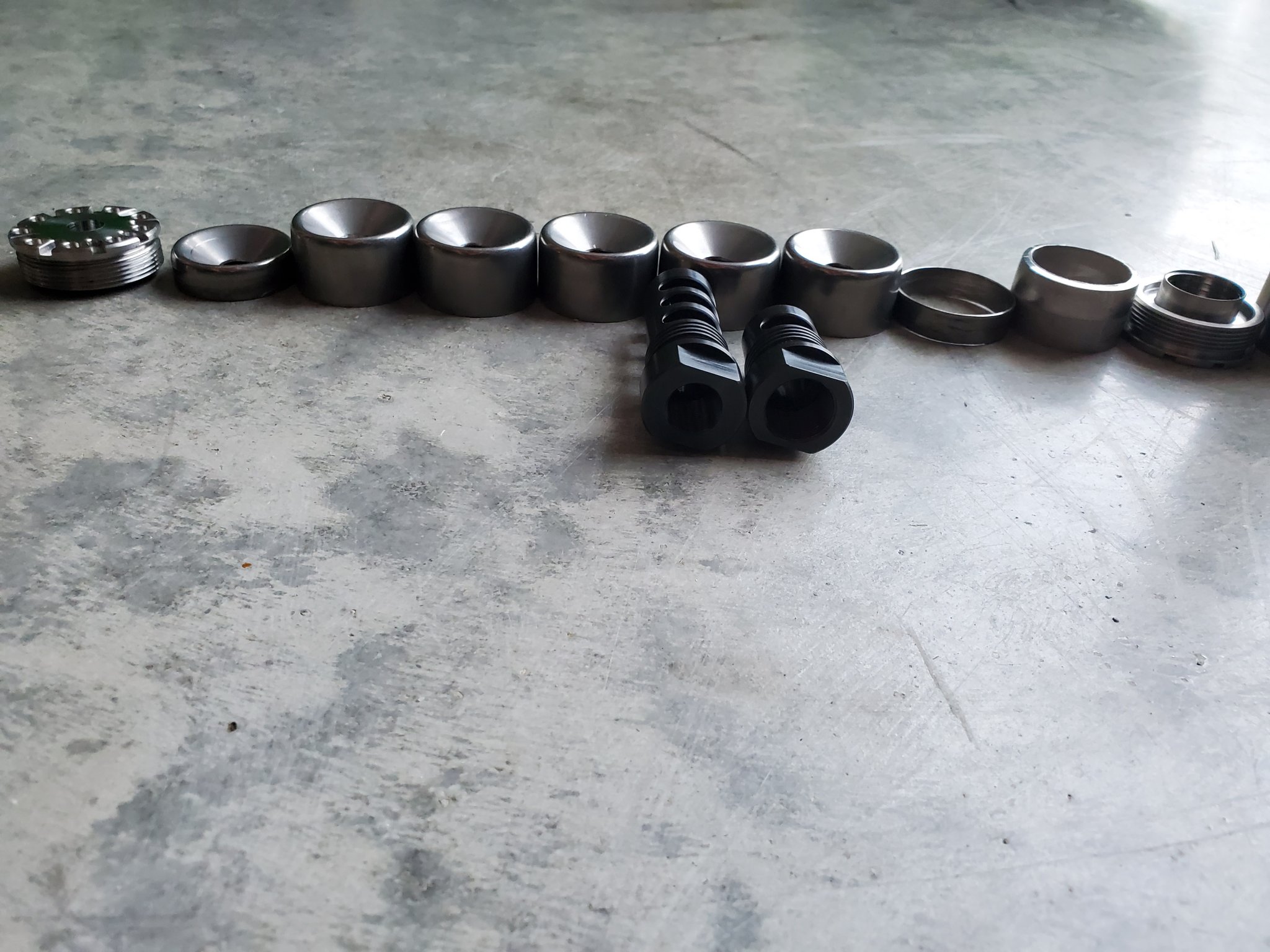

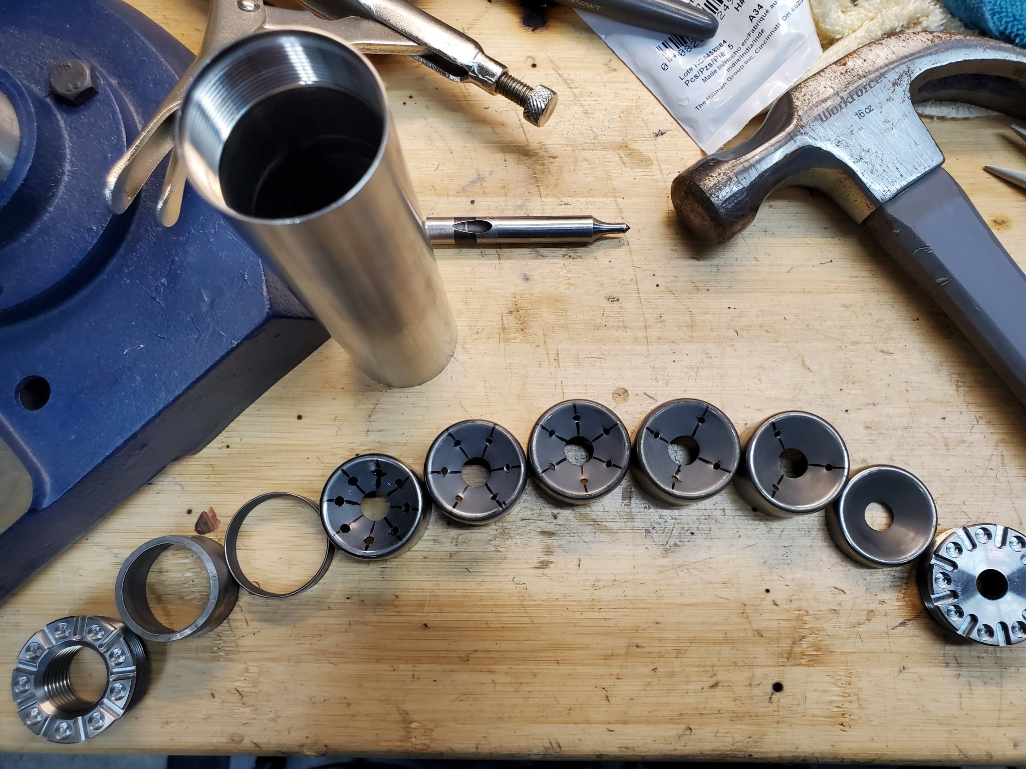

I have since gone back and added some ports on the baffles ( 8 holes on blast baffle....then 6 holes for next 2 baffles, then 4 holes, 3 holes, then none on last baffle).

After ports added, muzzle on right
Before ports added (muzzle left)

No, your 220 grain OTMs are not supersonic.
I’m very interested to know if the ports make a difference.
Clipped or DHC (double hybrid clip) baffles have worked very well in my form 1 cans, but anything to disrupt the flow of gas moving thru the bore should have a positive effect. A straight hole thru 50 or 60 degree cones isn’t gonna do much.

I agree that simple bore holes are prolly not going to be very effective. I hadn't finished up with adding the ports yet but a chance to test came up so I jumped.
I have another 9 inch form 1 can and it has simple cone baffles with ports pretty much identical to what I showed on this new 6 inch. That 9 inch can works GREAT on sound suppression and accuracy is fantastic.
I will update on change ports have when I have a chance to test again.

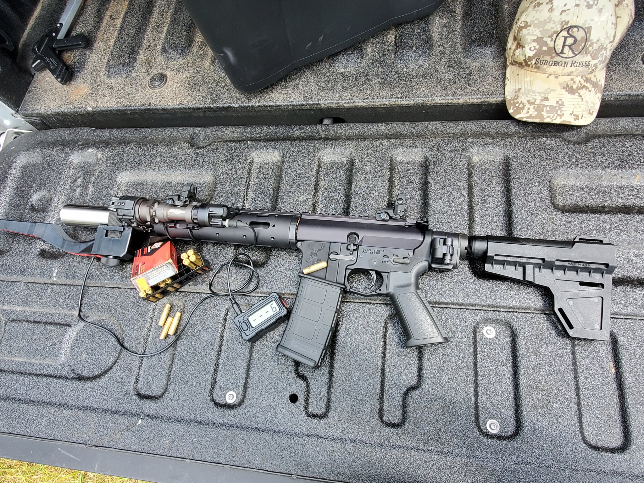

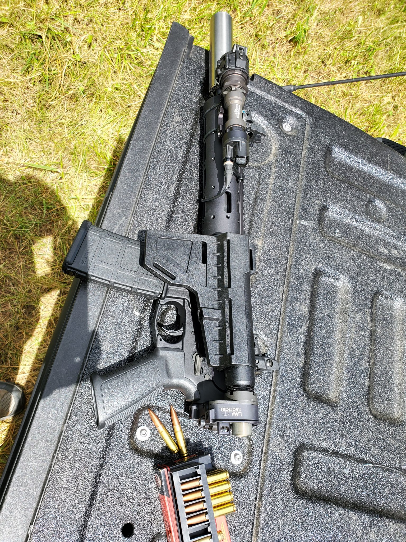

Well I tested today, gathered data and had a few revelations.
1. When fired, it goes bang appropriately and ejects brass......but will NOT strip the next round out of the magazine. The bolt does go into battery after ejecting the brass but does not strip next round.....and I tested a PMAG and old scholl metal mag.
A good friend with a lot of knowledge recommended getting a lighter buffer spring. For me that means reaching out to JP for their spring tuning kit since I have a SCS.

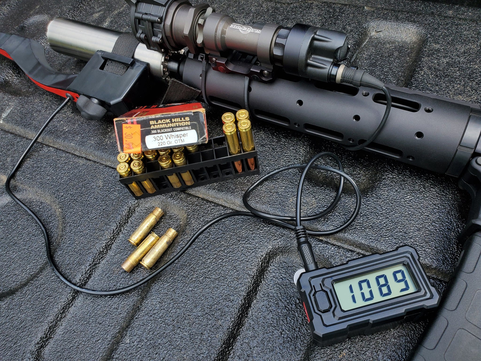

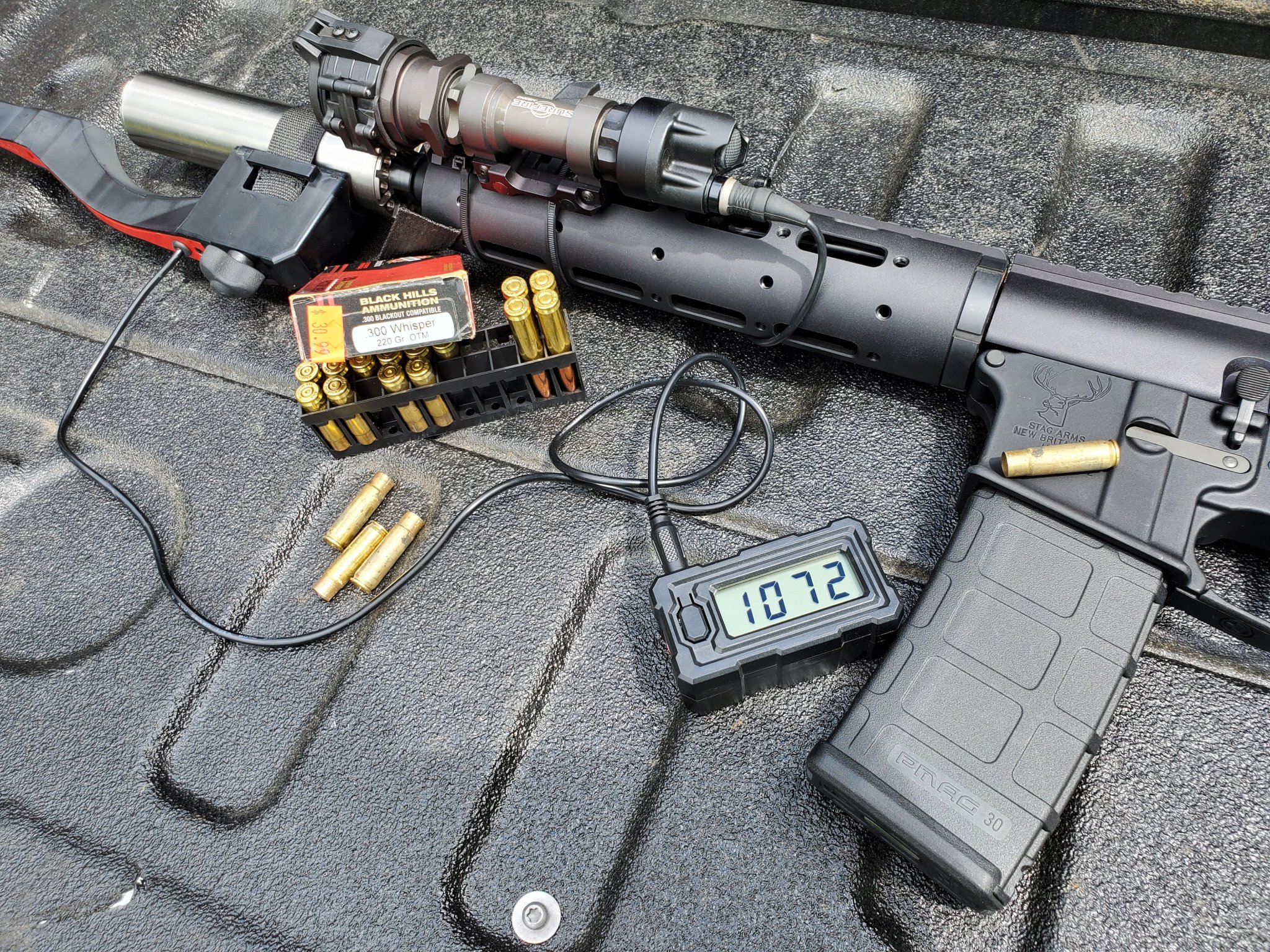

2. I am at 476 feet above sea level and temp was 80F. I brought the magneetospeed today to verify velocity.
I tested 5 shots: 1072,1073, 1041, 1089 and another that was right in the same area of speed.
Looking at facts about speed of sound I don't see how it could be .......but it sure sounded like I was still getting sonic crack......please chime in
I'll throw in some pics

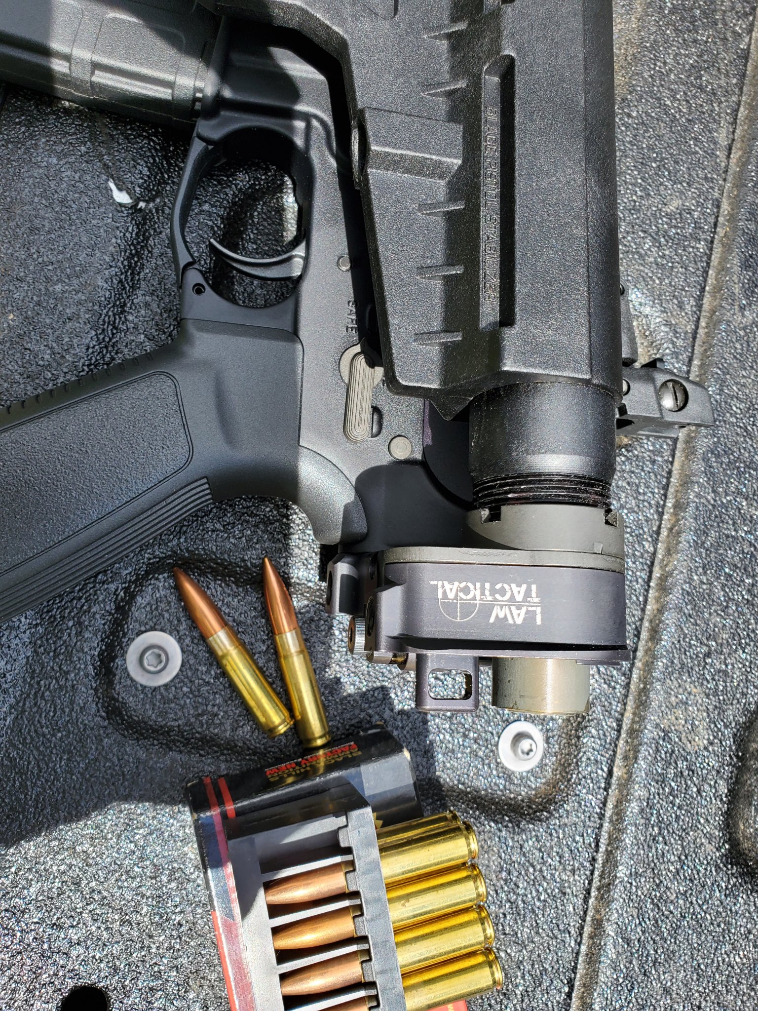

The ports did help but it still sounds like I'm getting the crack 20200822_140356.jpg20200822_140528.jpg20200822_140441.jpg
I'm loving the Law Gen 3 folder and JP SCS law kit

    Seems like a no brainer but make sure you put the plunger back in the Law Tac. I accidentally left it out one time and had the same issue.

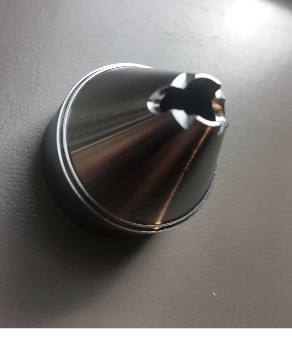

    Maybe try a DHC in addition to the ports? Can’t see how it would hurt anything?
    You made me paranoid since I did fire it folded ....I went and checked safe and all law parts are there now so therefore present during testing. Thanks for suggestion though.

    Can you please provide an example just to make sure I'm on the same page

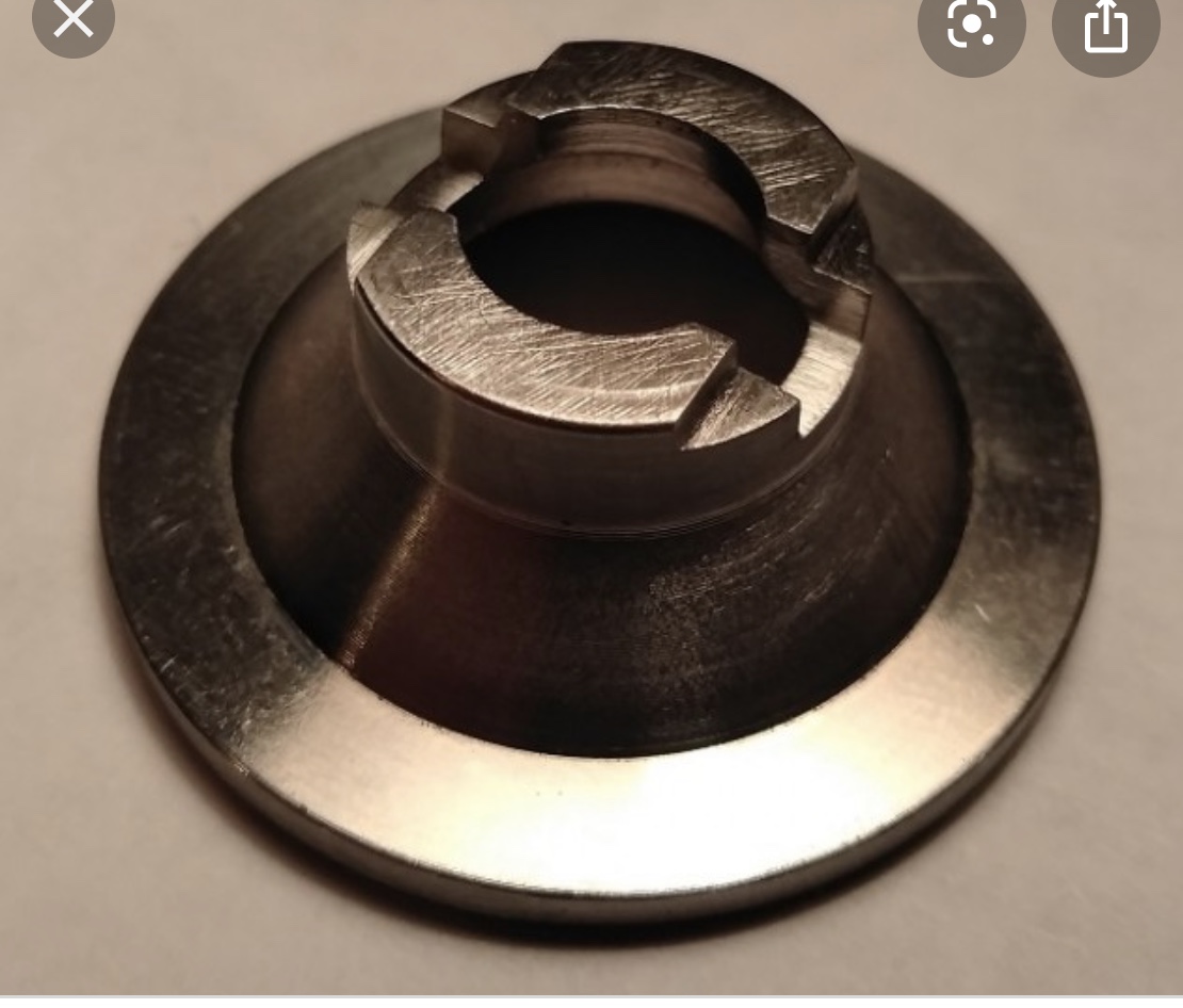

    Here’s some picture examples, not my actual pictures or cones though. Basically clip in a + pattern similar to as shown, one set of sides being deeper than the perpendicular sides.
    I did both of mine this way, and got almost no POI shift.

    Ah yes, exactly what I was thinking of
    There's one main issue holding me back from doing that and it's the fact I used thinner walled stainless cups for baffles vs thicker stock like those in the pic. I could double clip my baffles with either a drill press or dremel but I don't know if the material would be strong enough not to become weakened and compromised/fail. What I mean by that is if I double clip them it would leave relatively small corner left of thinner material that would be much more prone to becoming damaged enough that they end up breaking off and getting blown down the bore themselves.
    I'm not metallurgist or structural engineer so maybe someone smarter can tell me if there's any real risk of that or if they will hold.

    Per the mfg website they are 304 stainless and 112 degree cones
