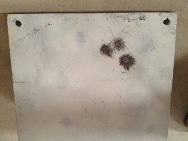

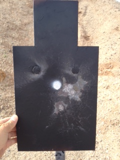

I love my 6 Creedmoor! First target is 760 yards and the next is at 600 yards. This rifle is just fun to shoot, no recoil!

Here are some typical groups with a crosswind with my 6 Creedmoor shooting the 105 Hornady HPs, as you can see the vertical is pretty decent, once I learn to deal with the wind and or shoot faster it should all come together a bit tighter, can't wait to try the DTACs at this range next year. My best 600yd group was this past Aug, 3.5". Won't have that target til the first match of the season.
