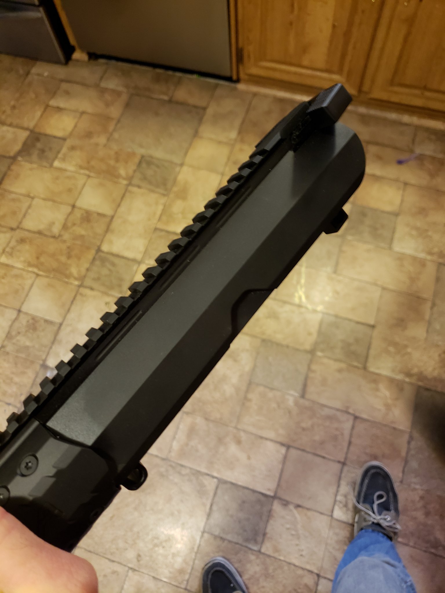

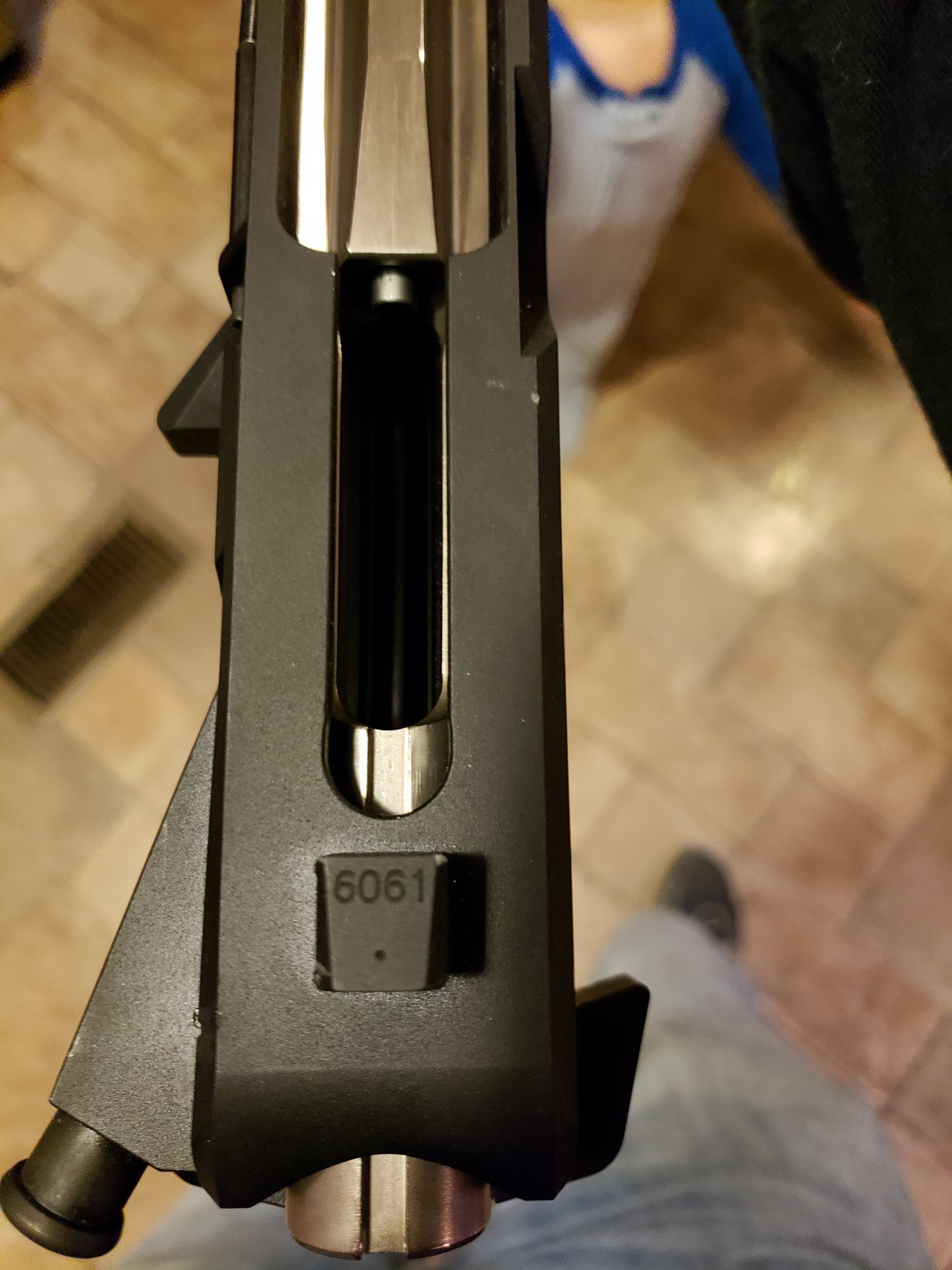

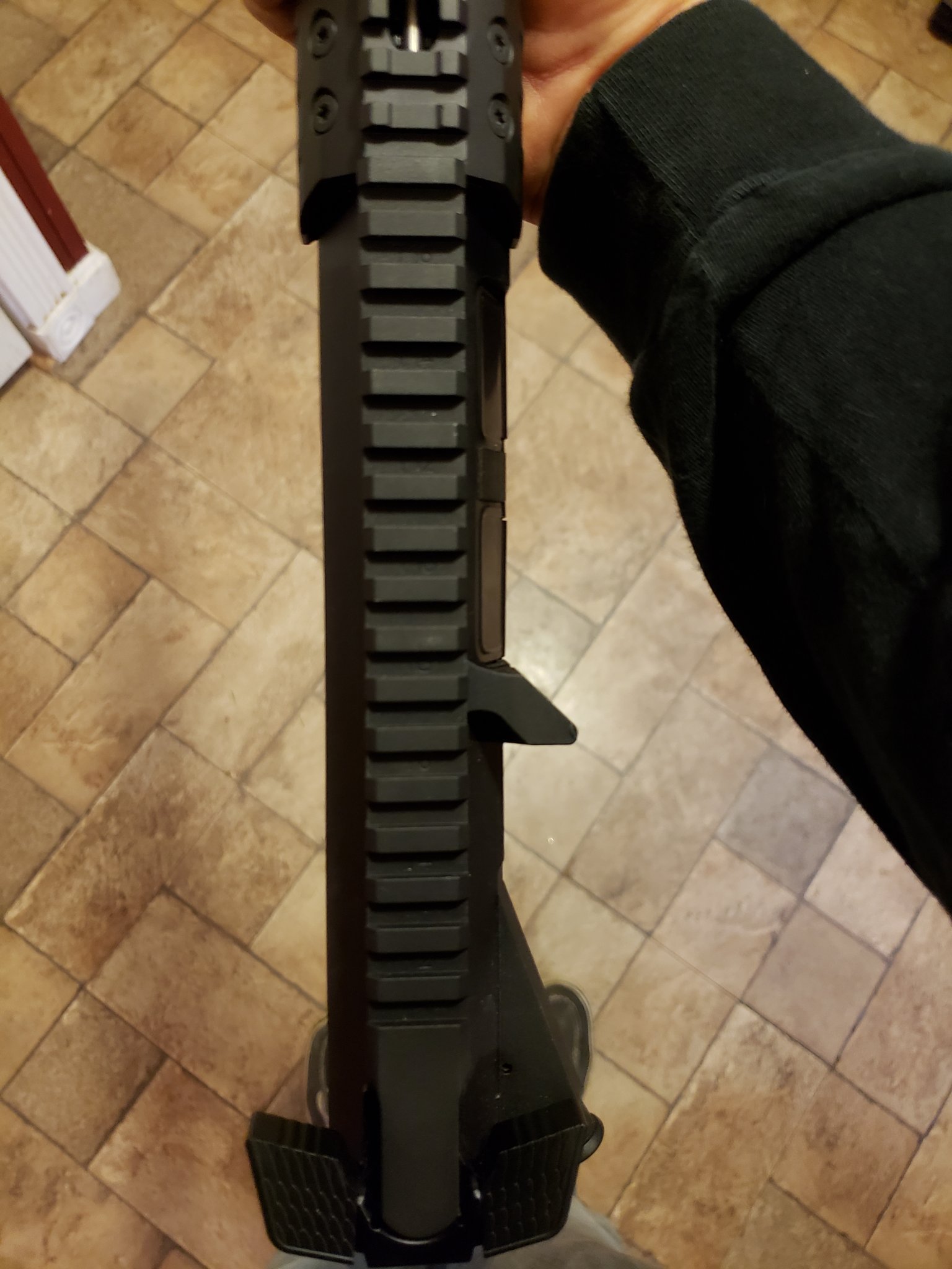

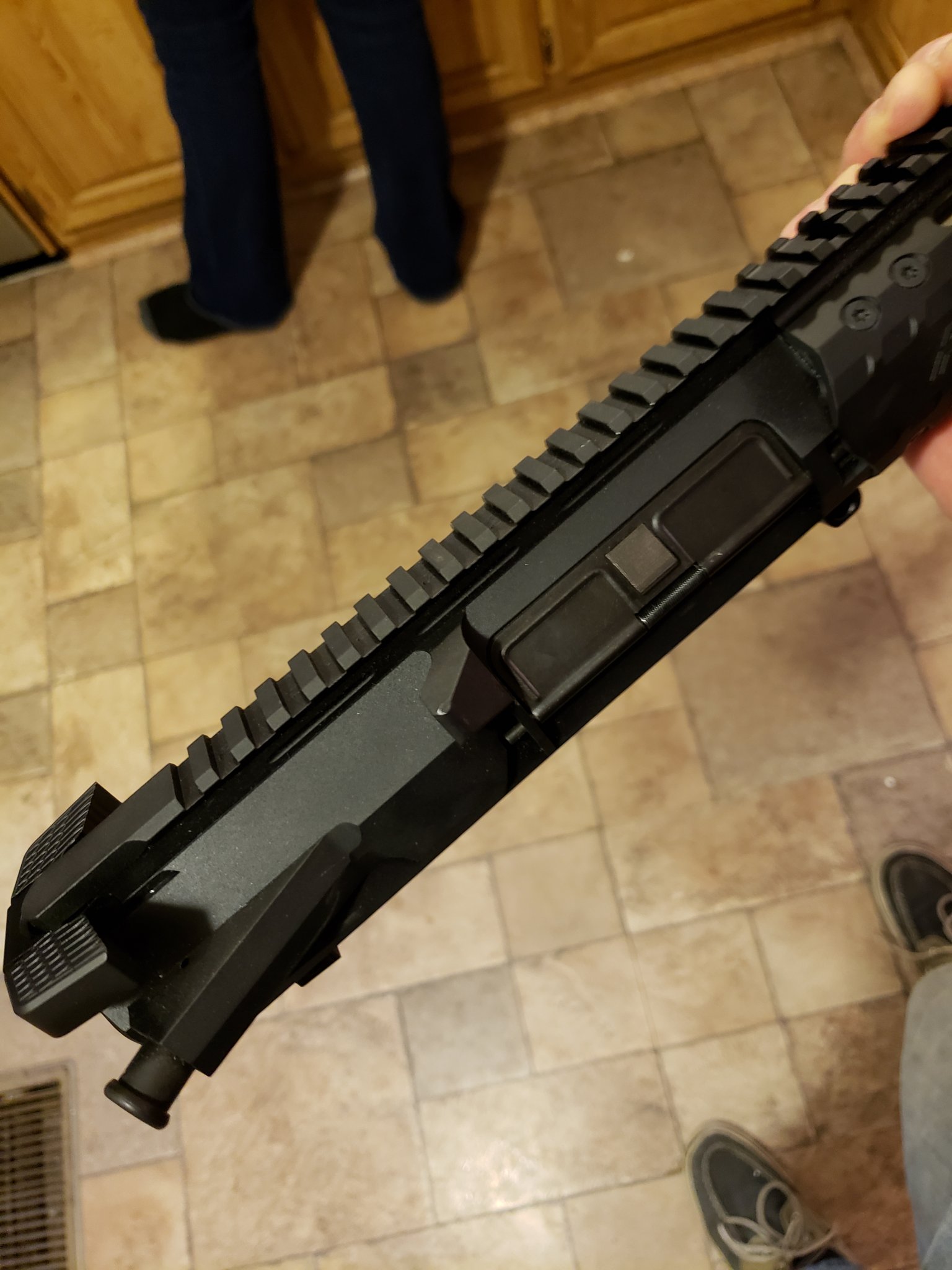

Got my hands on a large frame upper. Was told it was Aero, but I have a couple aero lowers, an aero small frame upper, and a few hand guards, and I know they are forged pieces. Did Aero ever run 6061 or a billet set? Anyone know of billet uppers being used/successful? It looks to resemble the AWC billet upper, with all of its interesting lines. Any input appreciated.

I understand that. A billet upper has been milled from one piece of stock. I believe that's what I have, as it has many sharp lines and edges that are not commonly seen in forged or cast type materials. My question still stands, did Aero Precision ever make uppers with 6061? (Instead of 7075) or did they ever produce a run of billet sets (not forged)
