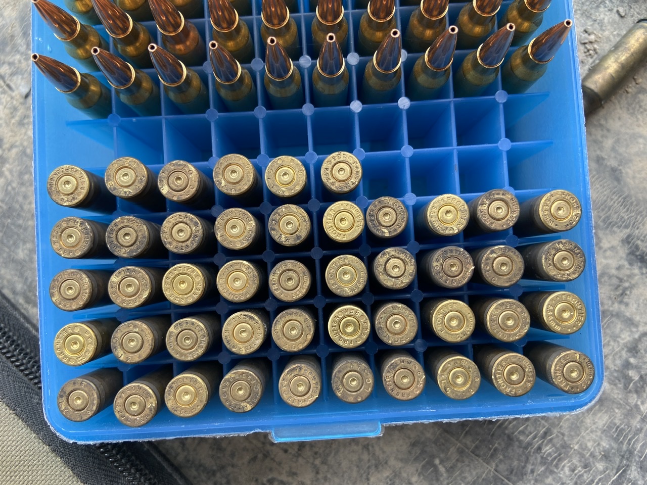

Playing with cfe223 and 75s out of my 18” AR 2 weeks ago.
25.6gn of cfe In LC brass.
View attachment 7665254View attachment 7665255
I have a pound of CFE thats on my list to try next with the 75s in my 18" AR. Best Ive done is 2714 with 24.3gr of RL15, SD of 7, I dont want anything close to pressure in my AR. Id rather have longer brass life. Varget is accurate but much slower. What altitude and temp were those shots taken? Velocity data looks real good on that load. I also have a bunch of Frontier brass but I havent tried reloading it yet. The newer Frontier ammo Ive bought has actual LC brass now which is nice. How does that load group?
Didn’t shoot for groups but had zero issue putting them all in the same impact mark on steel at 250, and no problems hitting out to 600.
90f at 700’ ASL roughly.
these loads were definitely on the hot side given the ejector marks but nothing that was scary based on the brass.
that is 150fps faster than I can get out of 8208 and 2520 with the same marks on the brass.
going out again tomorrow, I’m going to back down to 25.4 and see what that does, maybe it’ll clear up some of those ejector marks.
curious to see what your results are with the CFE, I wasn’t expecting it to be such a speed demon out of my rifle when 8208 and 2520 gave me at most 2750.
brass life isn’t super important to me, 223 LC brass isn’t too hard to come by. Ended up bringing 100 pieces back with me from the range last weekend. If I get 4-5 firings out of it I’m pretty happy.

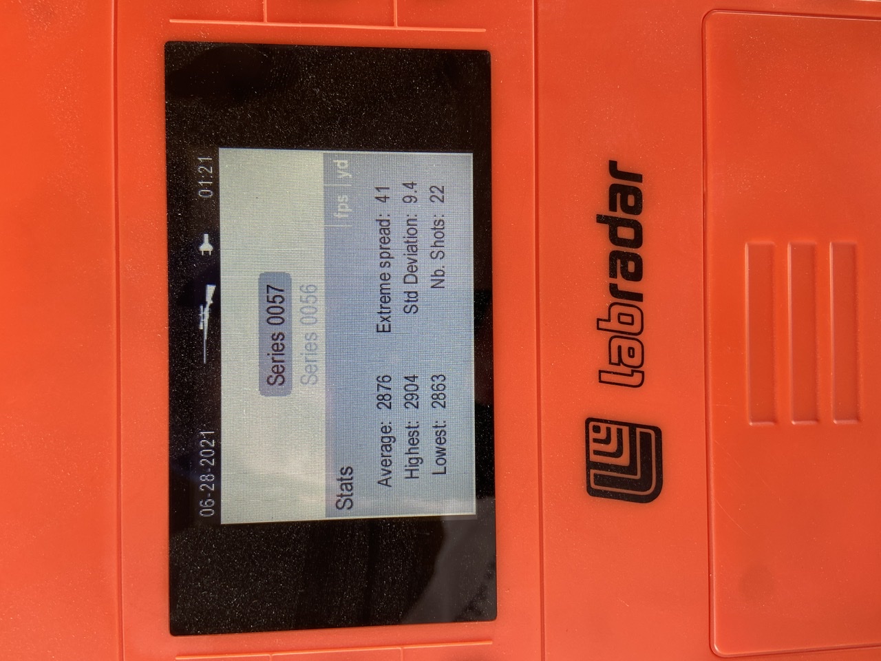

Following up on this, went out yesterday in similar conditions with 25.3gn of cfe223 under a 75gn hpbt and got 2820 FPS out of my 18” stainless proof barrel
