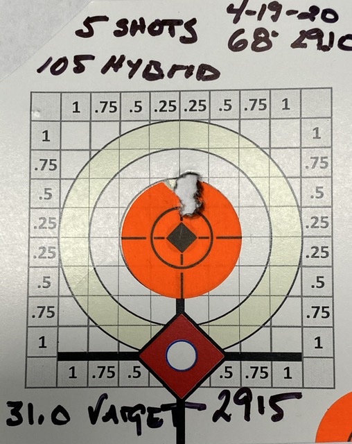

26“ Bartlein 8tw, 31.0 Varget , 105 Hybrids = 2915, Dallas 68ish degrees.
(Actual target from initial OCW, so every 5th shot landed here. 30.0-31.5, the other 4 were pretty good too. Love the BRA)
