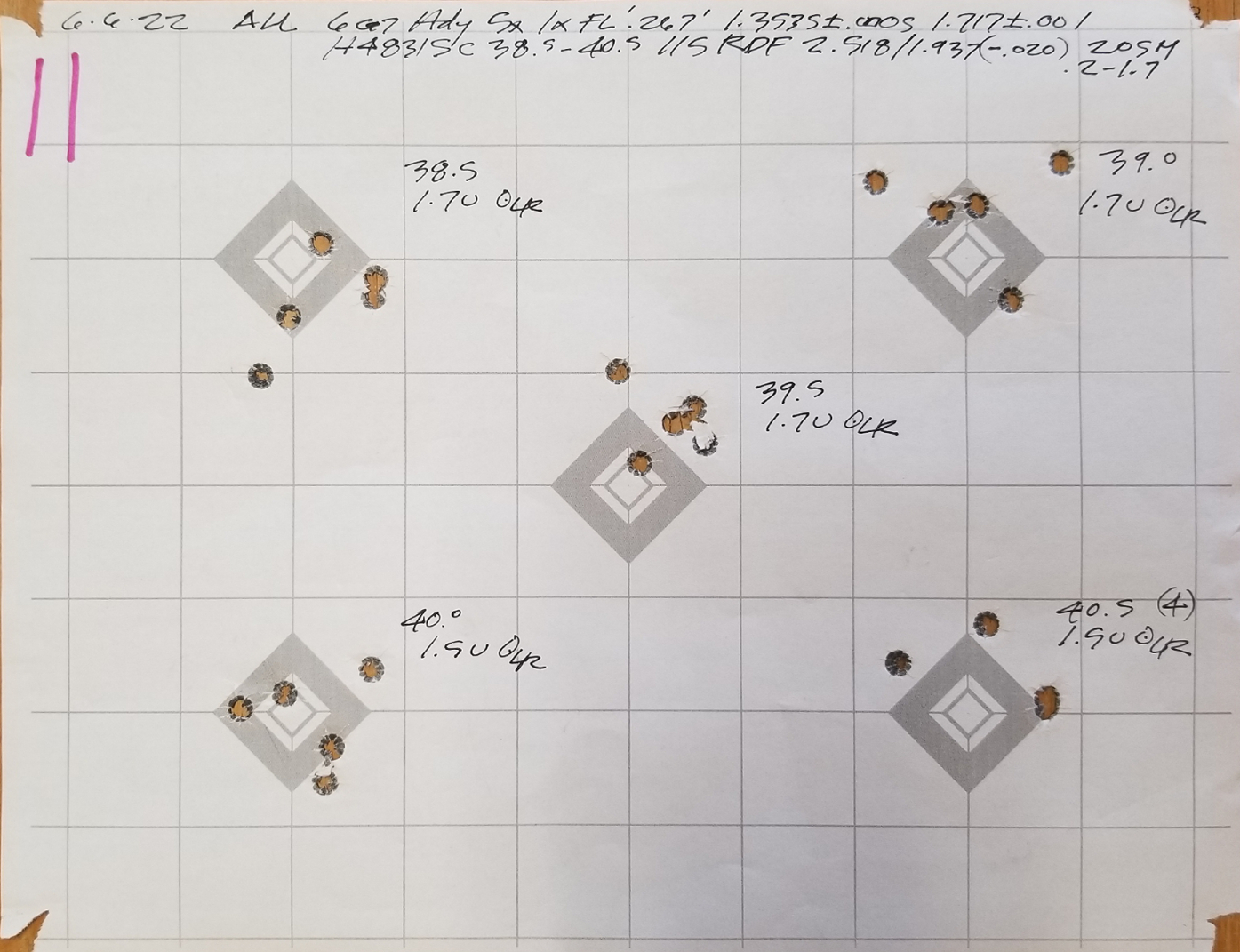

If anyone is interested in using H4831SC in the GT, here are some of my results with 115 RDFs (I have more of the 4831 powders than anything else, so I thought I would try it).
.020" jump
26" 7.5 twist Bartlein 5R HV (~850 rounds so far)
Hornady brass
Fed 205M
Rear bag and bipod off a bench. 3 mph 7 o'clock wind. 86 degrees F.
Did a 200 yard test of 38.5-40.5 grains if H4831SC (basing the loads on Hodgdon's 41.3 max. of Superformance for 110 grain A-Tip).
38.5, 39.0, and 39.5 were slightly crunchy; 40.0 and 40.5 were crunchy, but no pressure signs on any of these.

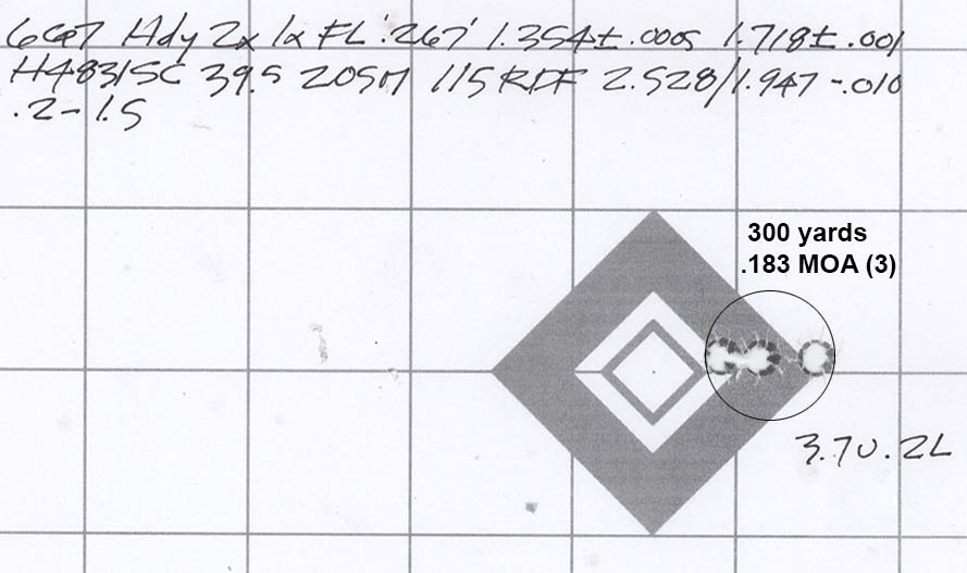

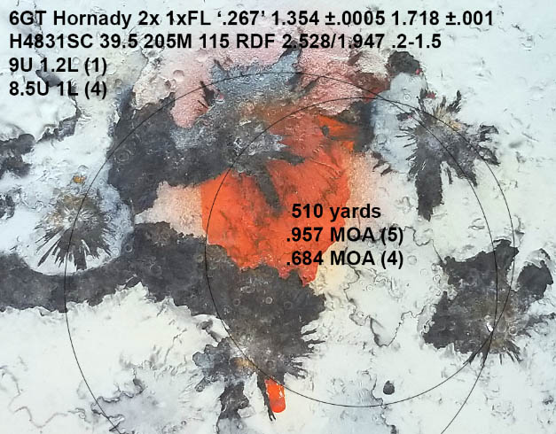

39.5 looked good, so I loaded more of that and tried it at 200, 300, and 510 yards.
200 still looking good, 300 was so awesome I stopped after 3 shots (knowing the Random Damn Flyers were coming ;), and it opened up a bit at 510. I didn't chrono it, but based on the come-ups the velocity looks to be 2875-ish.
