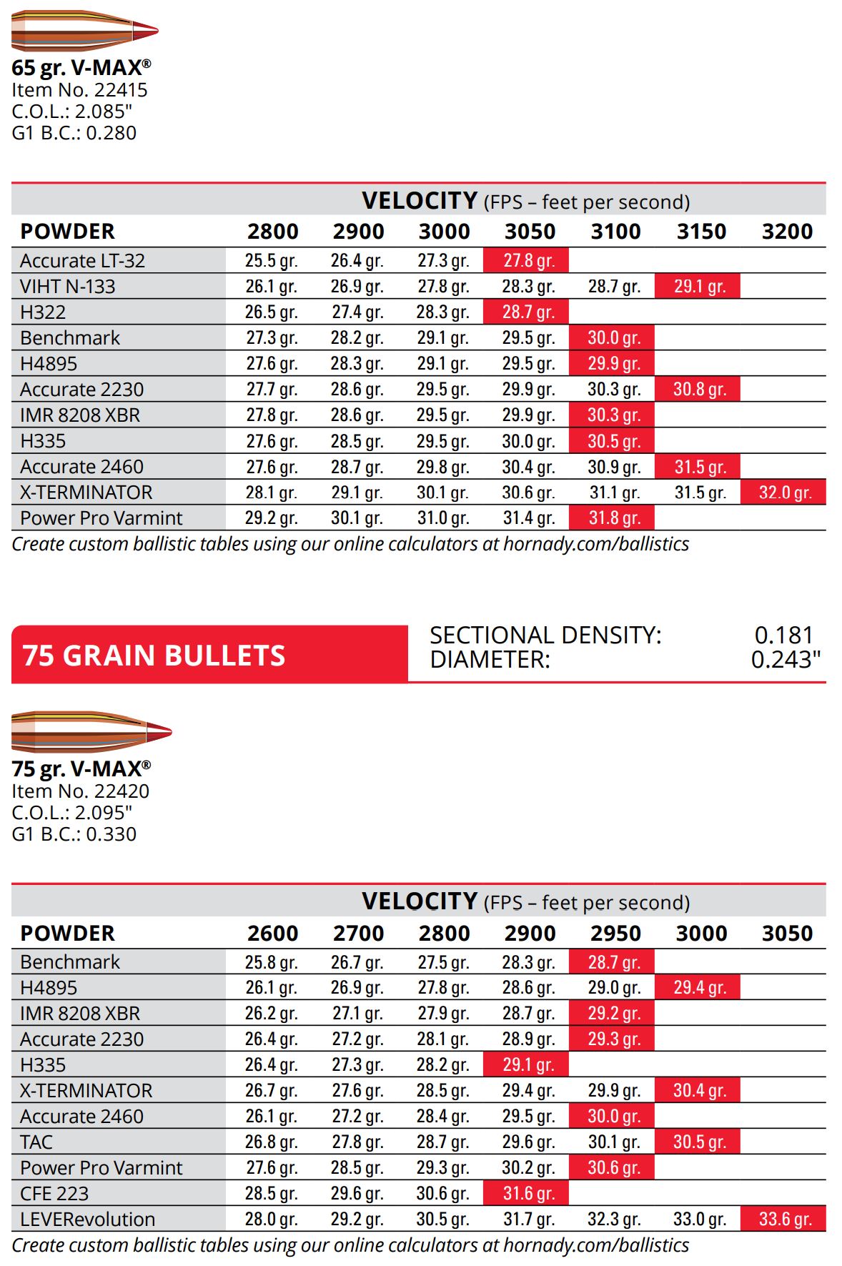

Wondering if anyone happens to be running an Ar in 6mm arc shooting nosler 70gr varmageddon pushed by cfe223?
Looking for a safe starting point.
Called nosler they have no data for the arc and Hogdon has no data for nosler…
Thanks
Not exactly 70 grains but it should give you a rough idea.
Reactions: Dave__th3__ss
Somewhere in between 65 and 75 grains Hornady didn't see fit to include CFE 223 with the lighter bullets.
This was my thinking…. Plus I’m not sure if a Flat base bullet will cause more pressure. Never fired an FB bullets and just starting to dive down the rabbit hole of coyote/predator hunting.
Guess I’ll start low with charge then
