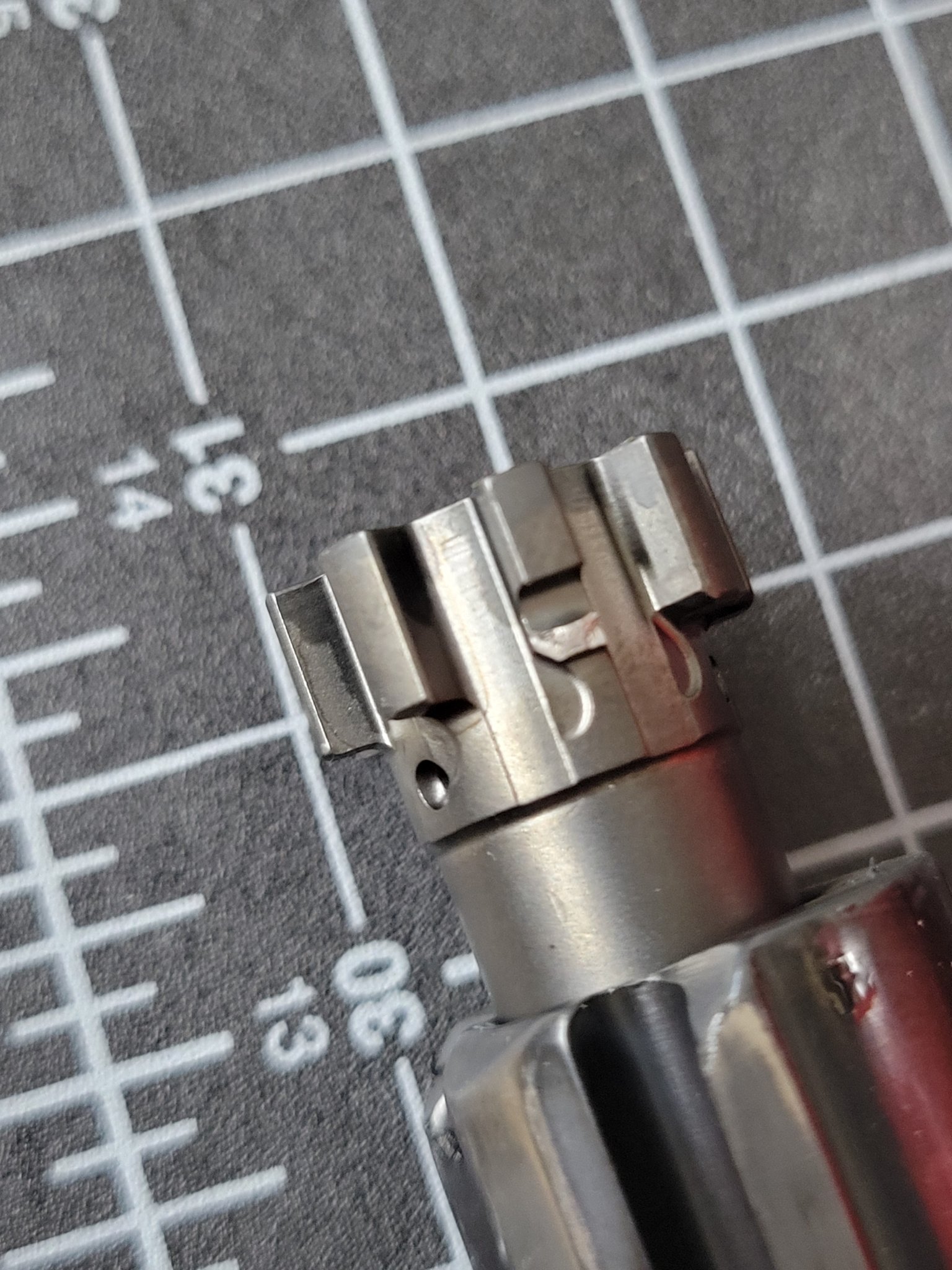

Really surprised to hear this, have any pics of these failures?
I'm interested in seeing the broken bolts and extractors too. I'm using Rexus Ultrabolts, 1400+ rounds on a 6 Arc shooting Hornady Black 105gr and maybe 300 rounds through a 22 arc, shooting Hornady ammo as well. The bolt and extractors look perfect after a thorough cleaning I did after my last range trip before xmas.
I haven't seen dozens of broken Grendel bolts but I have seen a few over the years. There are plenty that come up with a search Google. The Grendel forum has no shortage of broken bolt reports too. I have an AA bolt that the undercut lug has broken off of but I believe it doesn't add support and it is still serviceable.
Rexus has Grendel bolts in inventory at this time. Their bolts are probably better designed than JP.

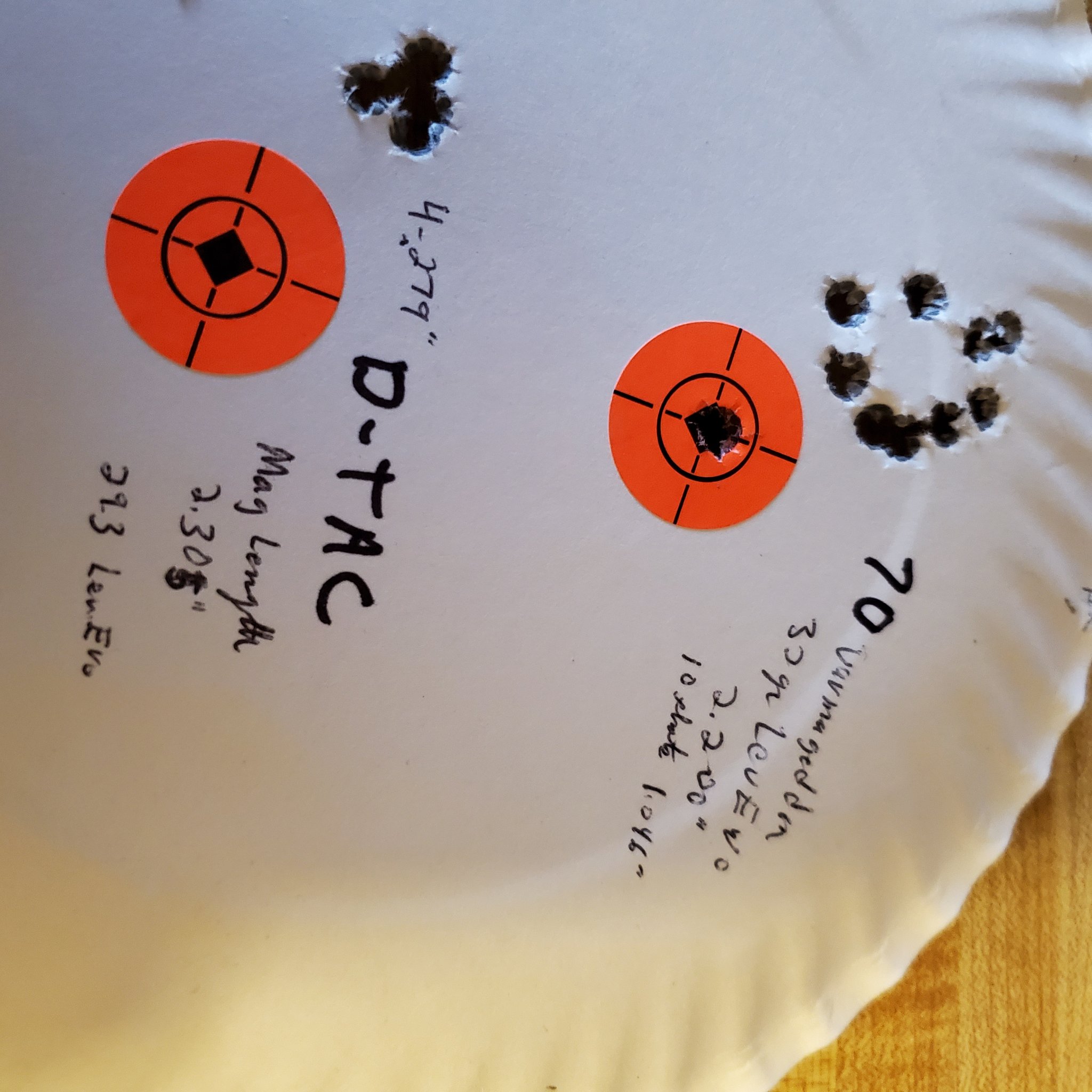

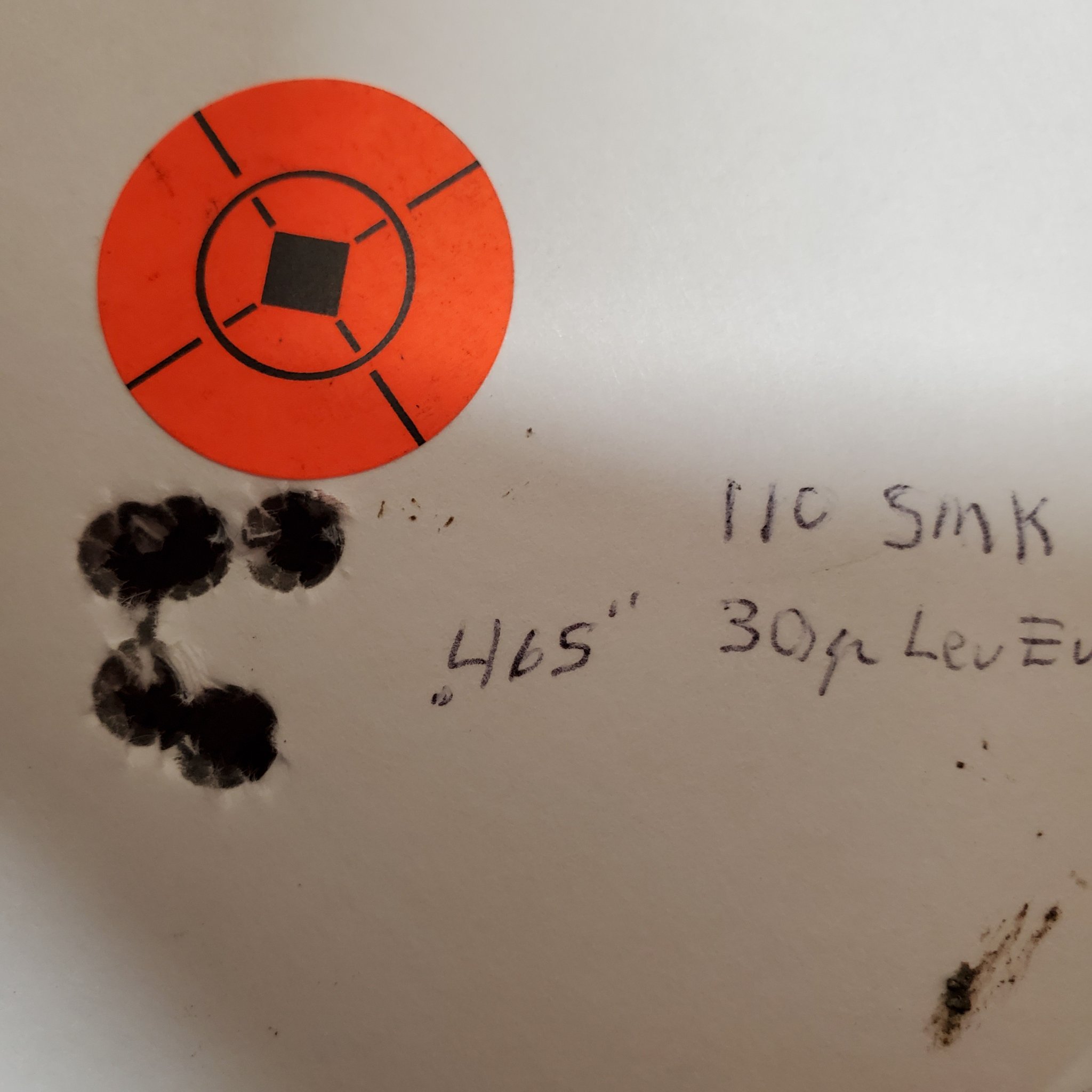

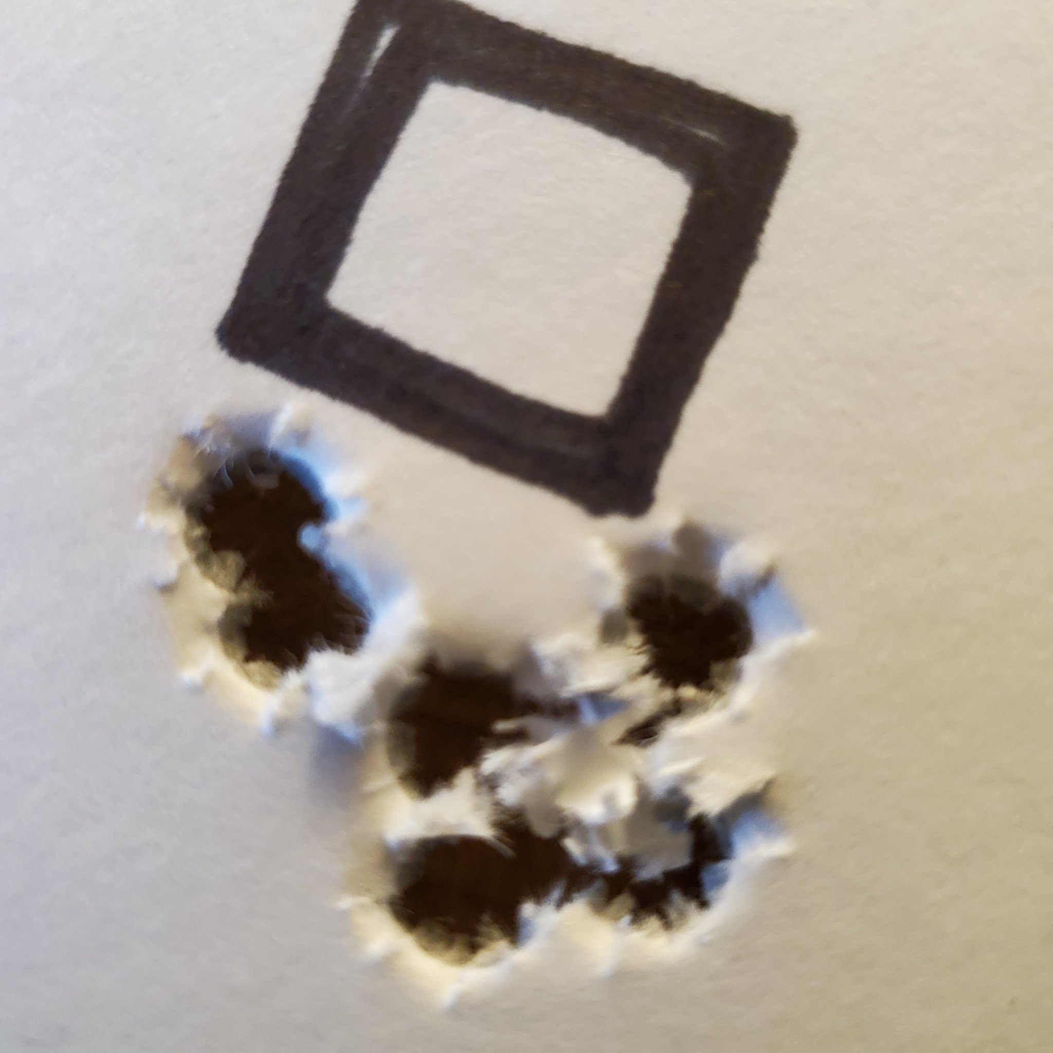

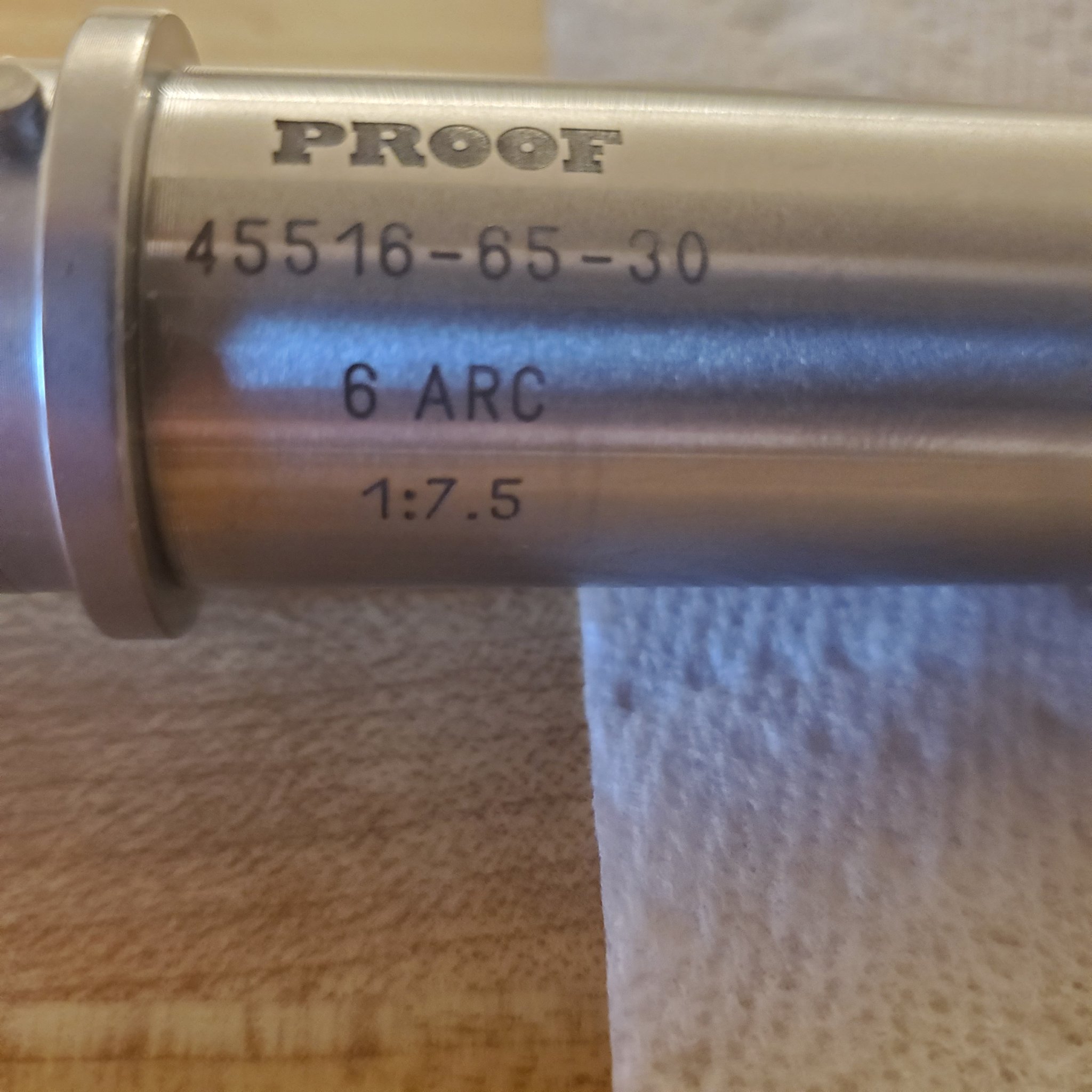

I love the Proof 6ARC barrels with the heavies (103-108) but I can't get them to group better than 2" with the 80's and it seems to be a pretty common issue not just with Proof barrels but in general.
Not at all...at least for me, I have 2 Proof SS barrels, not carbon fiber, both are excellent 1/2" 5 shot shooters.
The reason I have 2 Proof barrels is because the BA barrel top and the Proof barrel bottom, both with 108 gr eldm.
On the range the same day, same match ammo, the first 5 shot group ever fired out of the Proof barrel was 1/2" compared to the BA barrels 2.5" group...
So I scrapped the BA barrel and bought another 6mm ARC proof barrel. It too shoots 1/2" groups with heavies including 110 SMK.

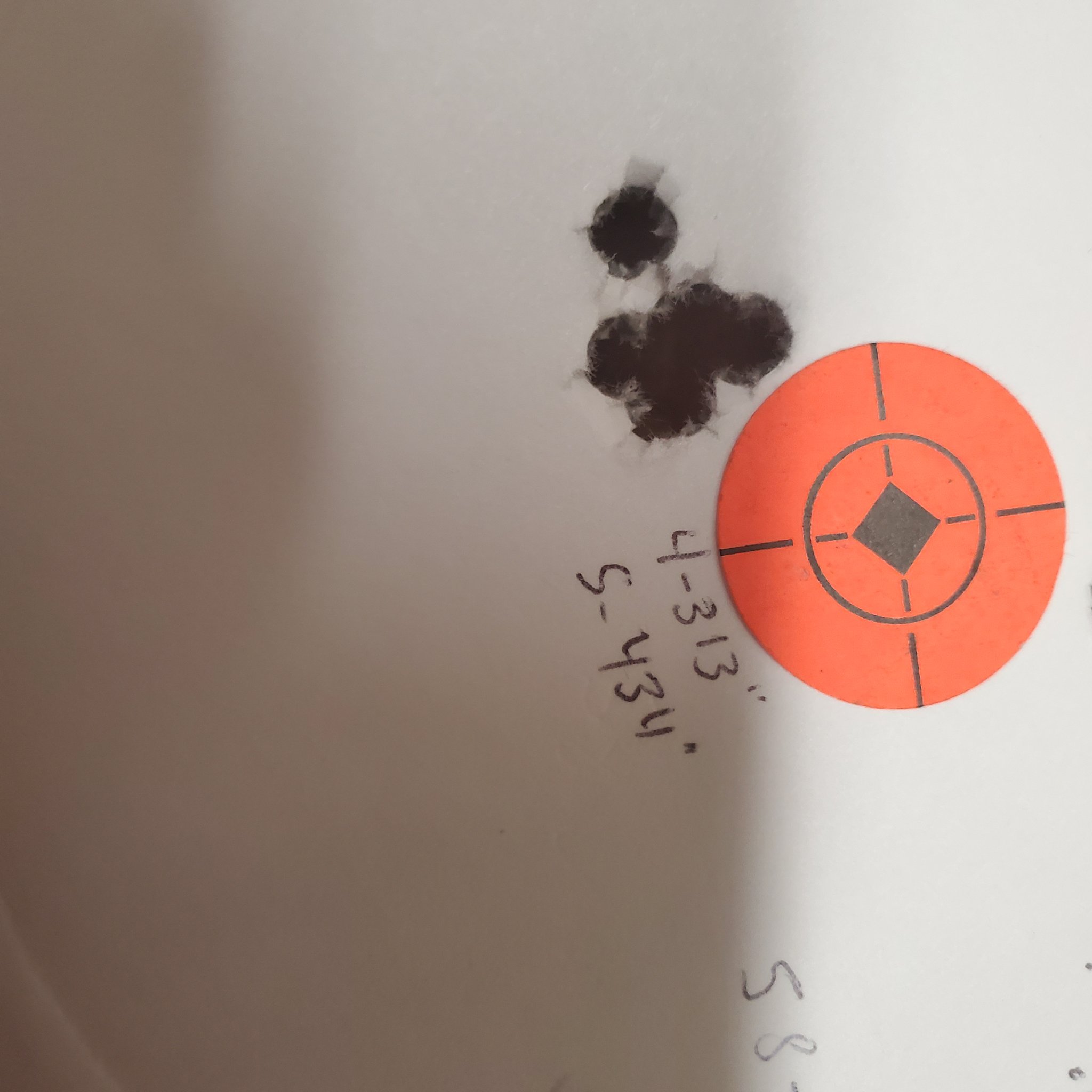

You just reiterated what I said about the Proof barrels being great with the 103+ heavy projectiles. You didn't show them being equally as accurate with lighter projectiles so I am failing to see how your experience is any different than mine?
Mine has shot better than 2" groups that you say is a "common issue", with lighter bullets in your earlier statement...didnt say anything about being equally accurate, as you are stating now.
My problem is the velocity is low and they aren't worth messing with over a 223.
So I didn't pursue the light bullets, to find an accuracy load, but this random 70 gr load is capable of 1 MOA for 10 shots. The 58 grs were similar groups were similar but velocity nothing special.
Never shot 80 gr bullets but did try the 87 gr. With 30 gr of CFE223 at 2650 fps my notes say ..."SLOW."
That's just not interesting accuracy or not.
With the velocity the same as the 108 grs with better accuracy and higher BC why bother with light bullets. It was designed around heavy bullets with its fast twist rate, so it's likely not to be as accurate with the light bullets...as shown on target, but its acceptable with the few I've tried and will hit half to 3/4 moa with just 5 shot groups in my Proof barrels.
Which have done less than 2" 5 shot groups with every bullet I've tried...so I do not know of others experiences or if that's the consensus...just my experience.
If you're gonna shoot light bullets just shoot a 223...was my take, after testing a few light bullets in the 6 ARC.
