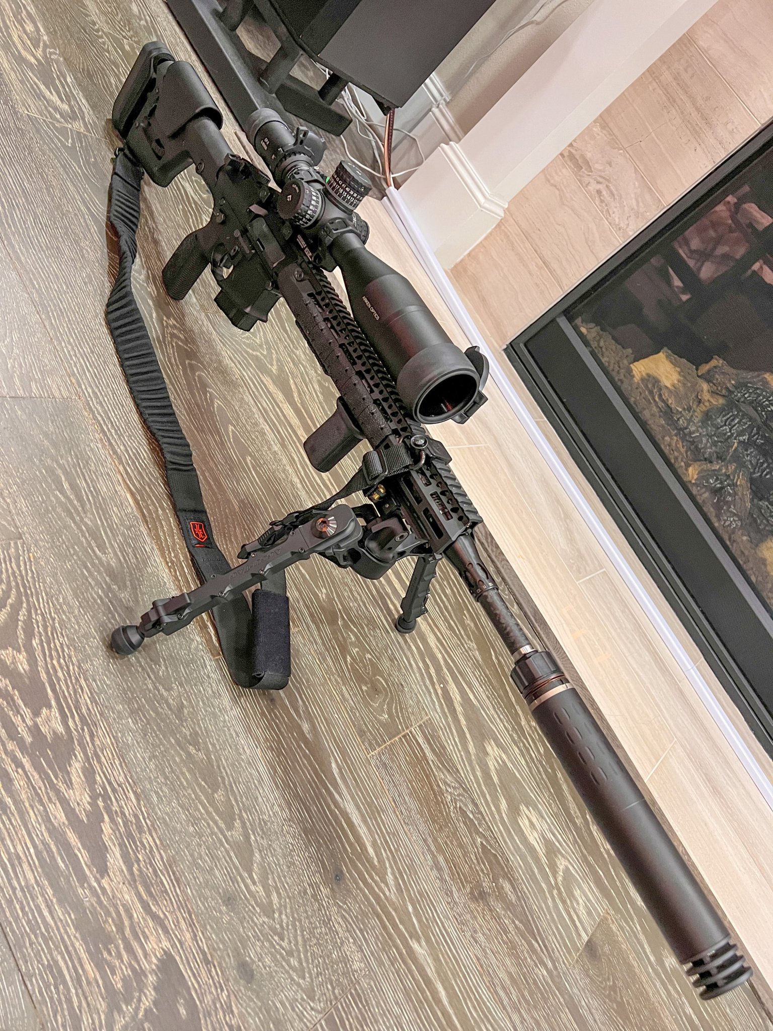

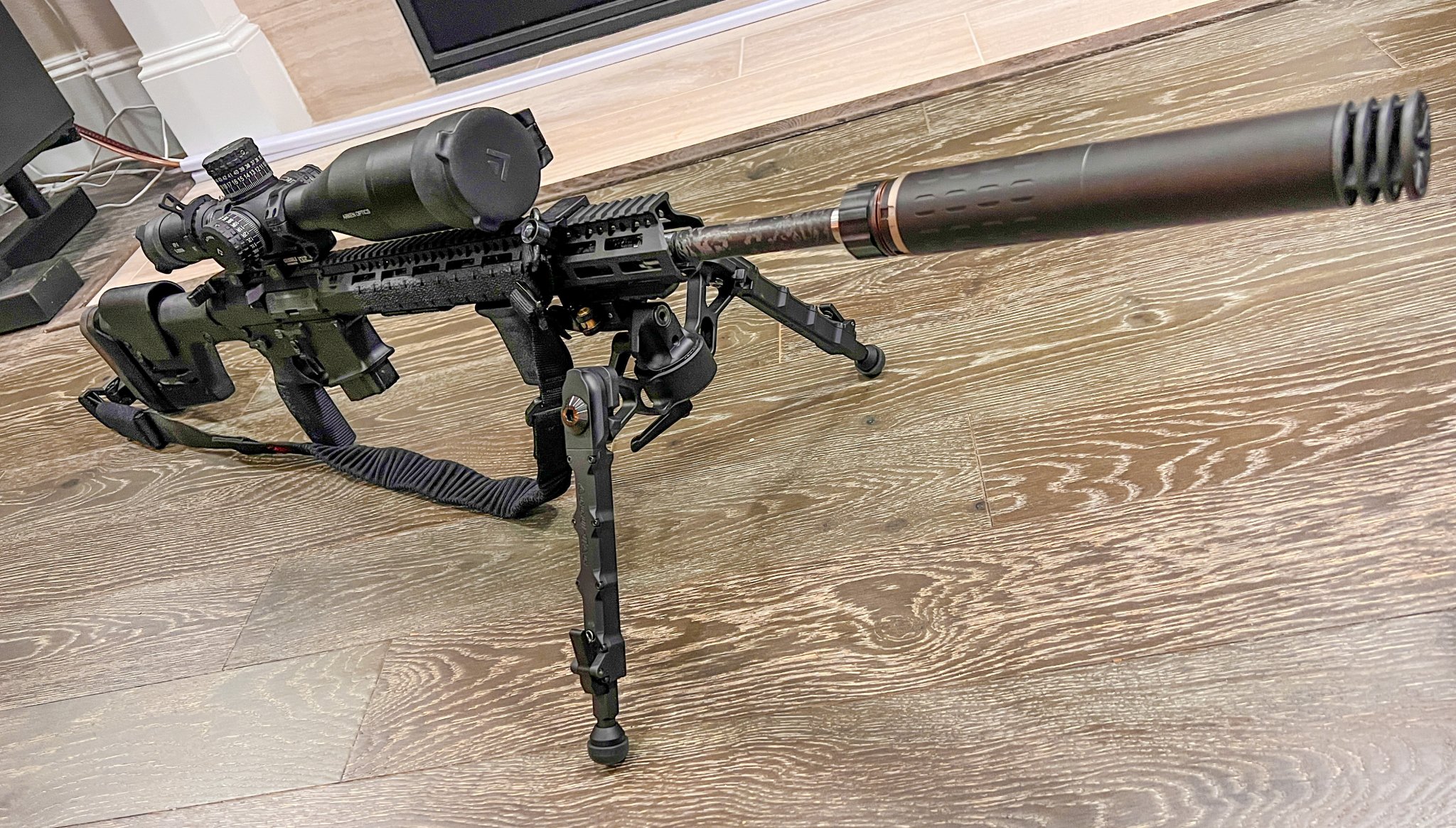

I finally got to stretch the legs on my BadRock 6mm ARC last weekend. The plan was to start at 100 yards to recheck zero, then go to 200 – 300 and 600. Unfortunately, I could not test it past 300 yards because the range had a match going at the 600-yard line. :mad:
