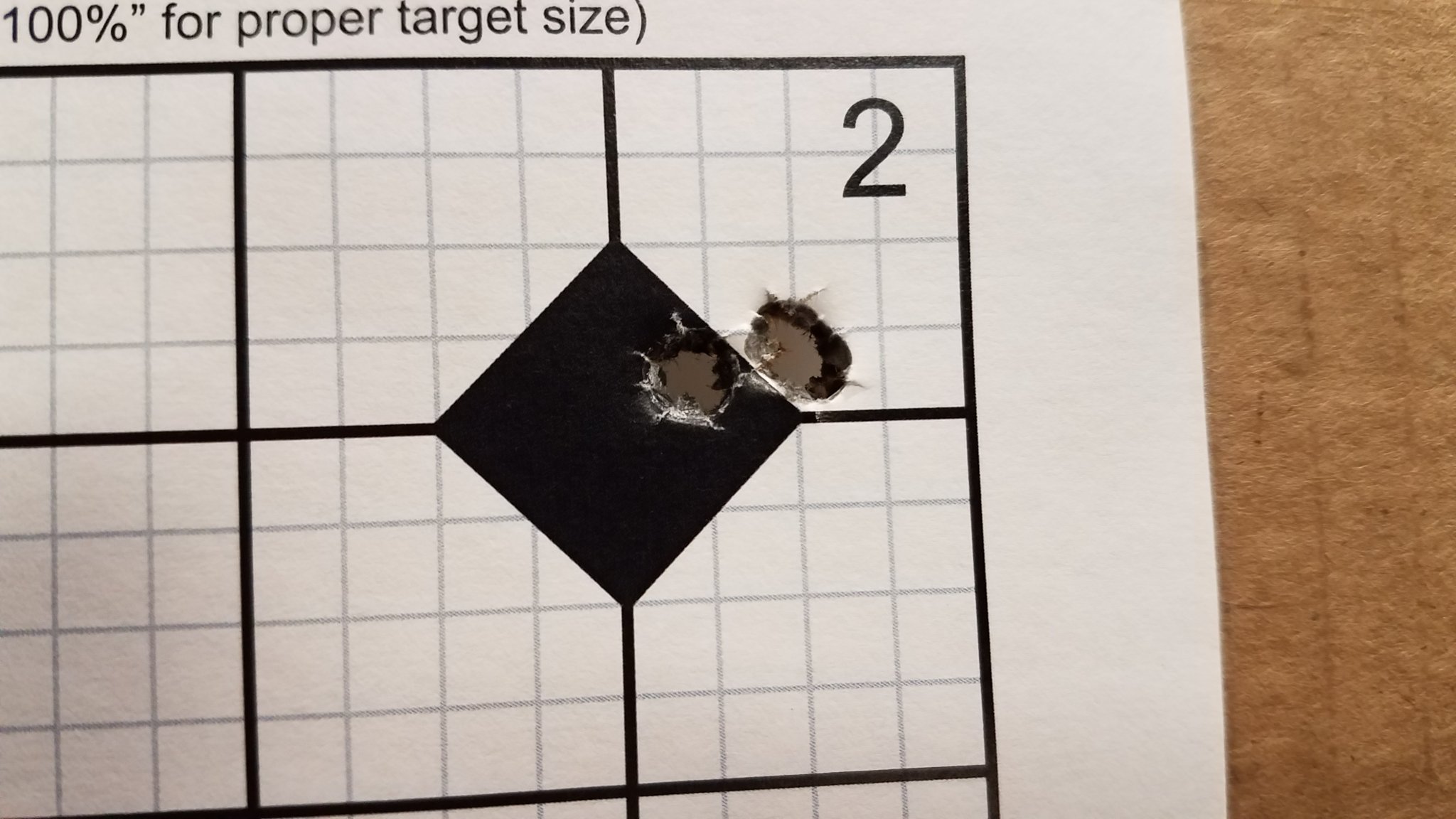

I also have Criterion MT. 7 twist ( . 183 FB) I was loading them to hot. 41g......41.5g horrible accuracy 1 " @ 100yds
But 39g. Looks like 3/8" could be possible.

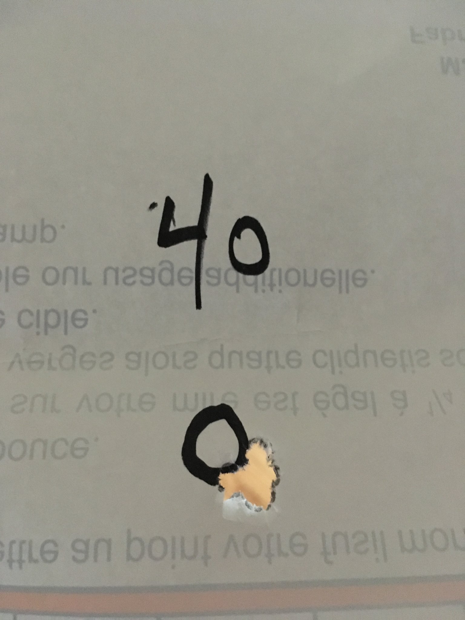

I’m getting right around 3000 fps with a 26” benchmark, 40 gn of H4350, Hornady brass, CCI 250.

Yes I love the dtacs now shot a 1 inch group at 433 yards there is 3 mile per hour wind 9 to 3.
I was definitely running them too hot two days ago everybody told me 3050 muzzle velocity is The Sweet Spot but not for this Barrel evidently
Well just went and looked at 433 yards it's 1 and 1/2 inches my bad... still very very impressed I was upset at first cuz I couldn't get to the thing to shoot 115's thanks for all your help
