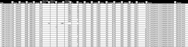

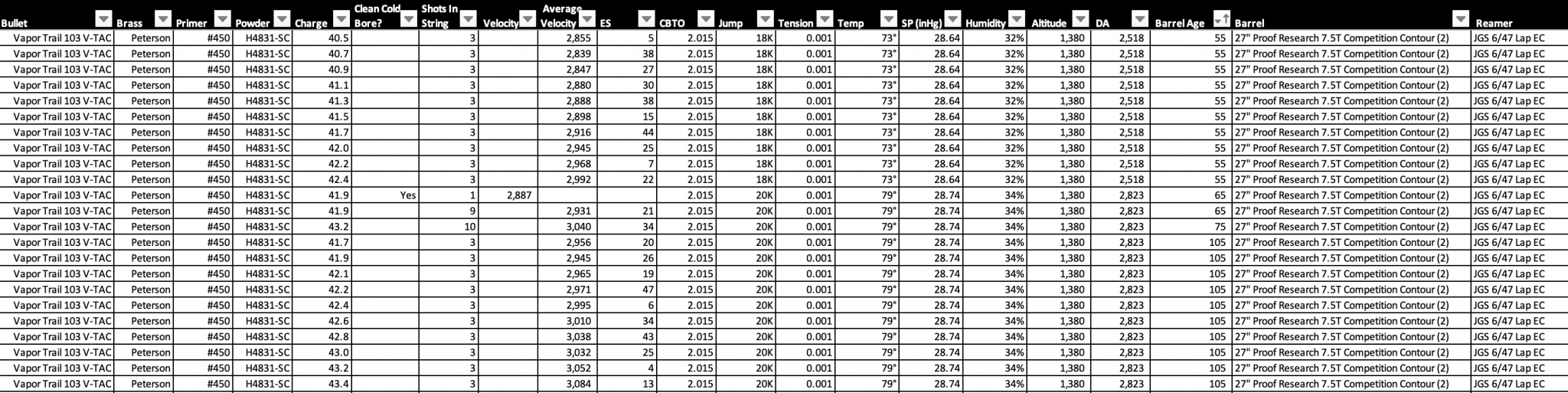

A decade late here, but posting incase anyone else comes across this thread.
