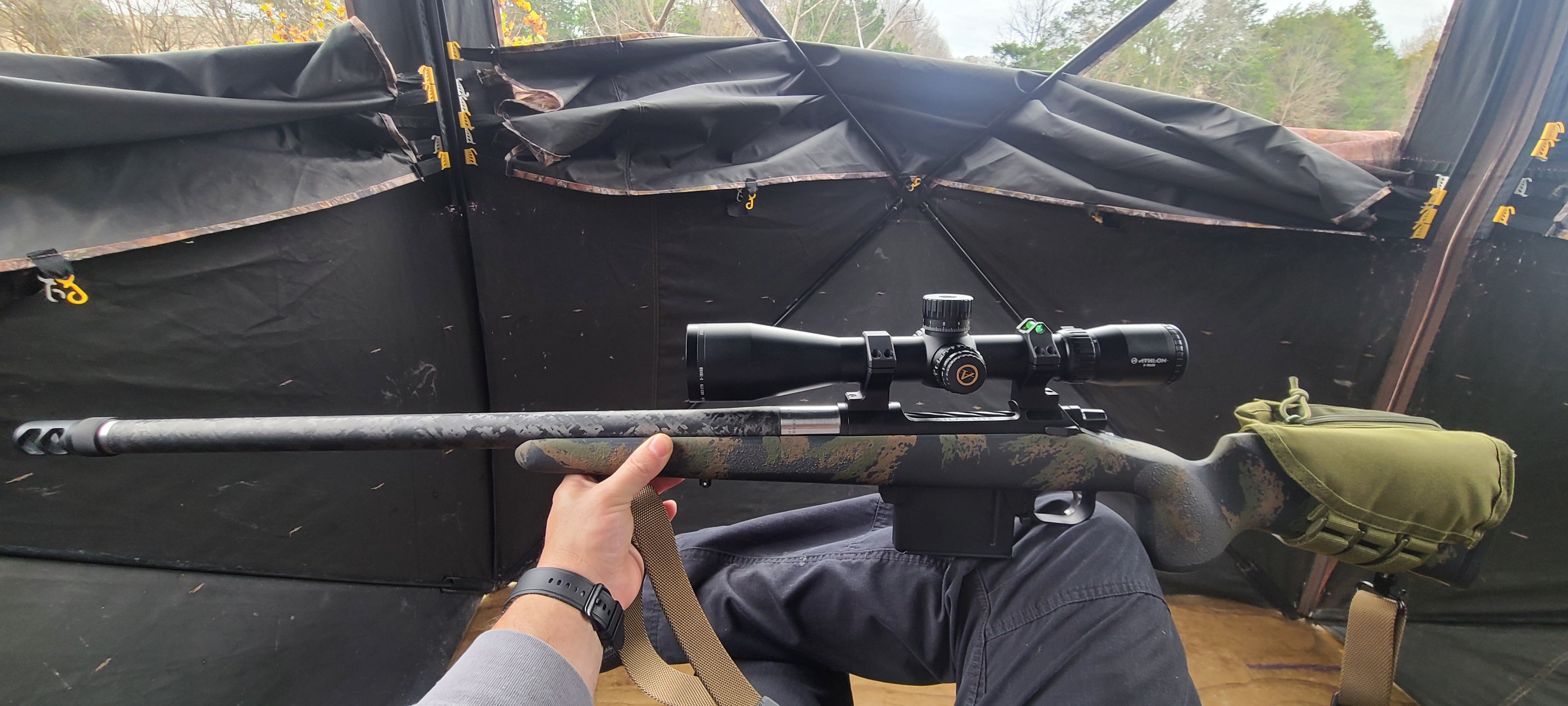

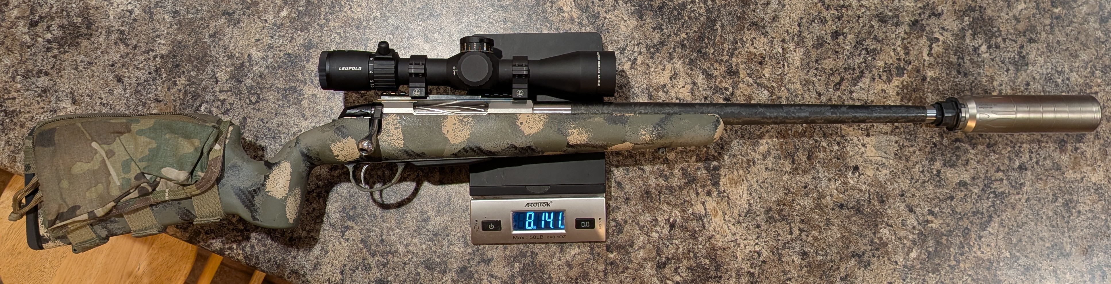

Barrel seems long and a bit heavy for hunting use, especially if you plan to use a suppressor. Truck hunting it would be fine, but any decent amount of hiking and it could start to feel heavy in the hand. A sling or pack will help a lot with carrying it over distance. I originally built a 15.3 pound 7PRC for hunting and ended up making it a light weight dedicated hunting rifle by moving to; lighter stock, lighters scope, lighter rings, switched to titanium suppressor and switched to carbon fiber barrel. Later I used my old parts to put together another heavier target rig, both are built with Kelbly actions. 7PRC is great on elk with a well placed shot. I took a nice bull with mine last year at 200 yards using Berger 168 VLDH. He took about 5 steps and that was it. Good luck with the build.

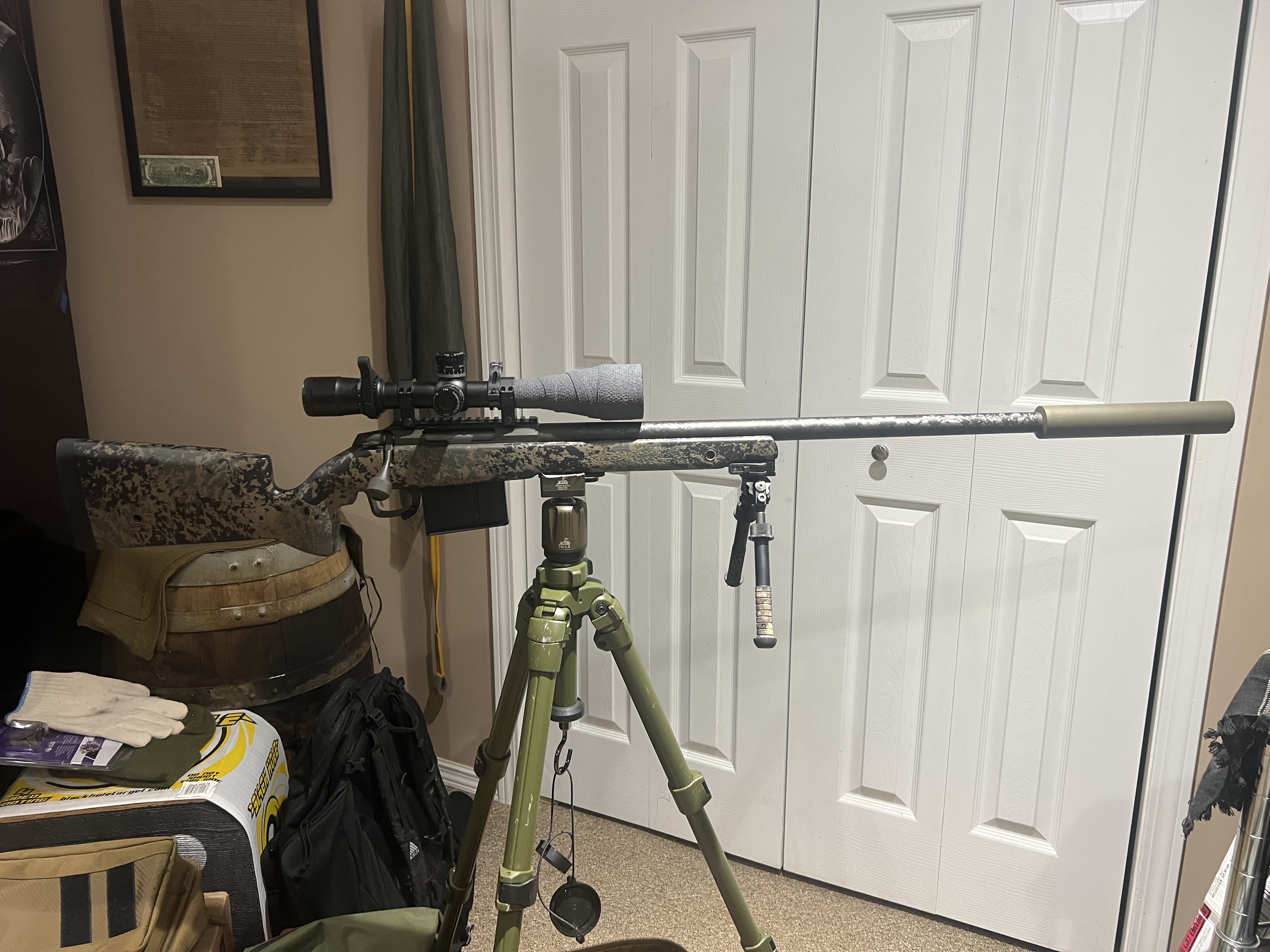

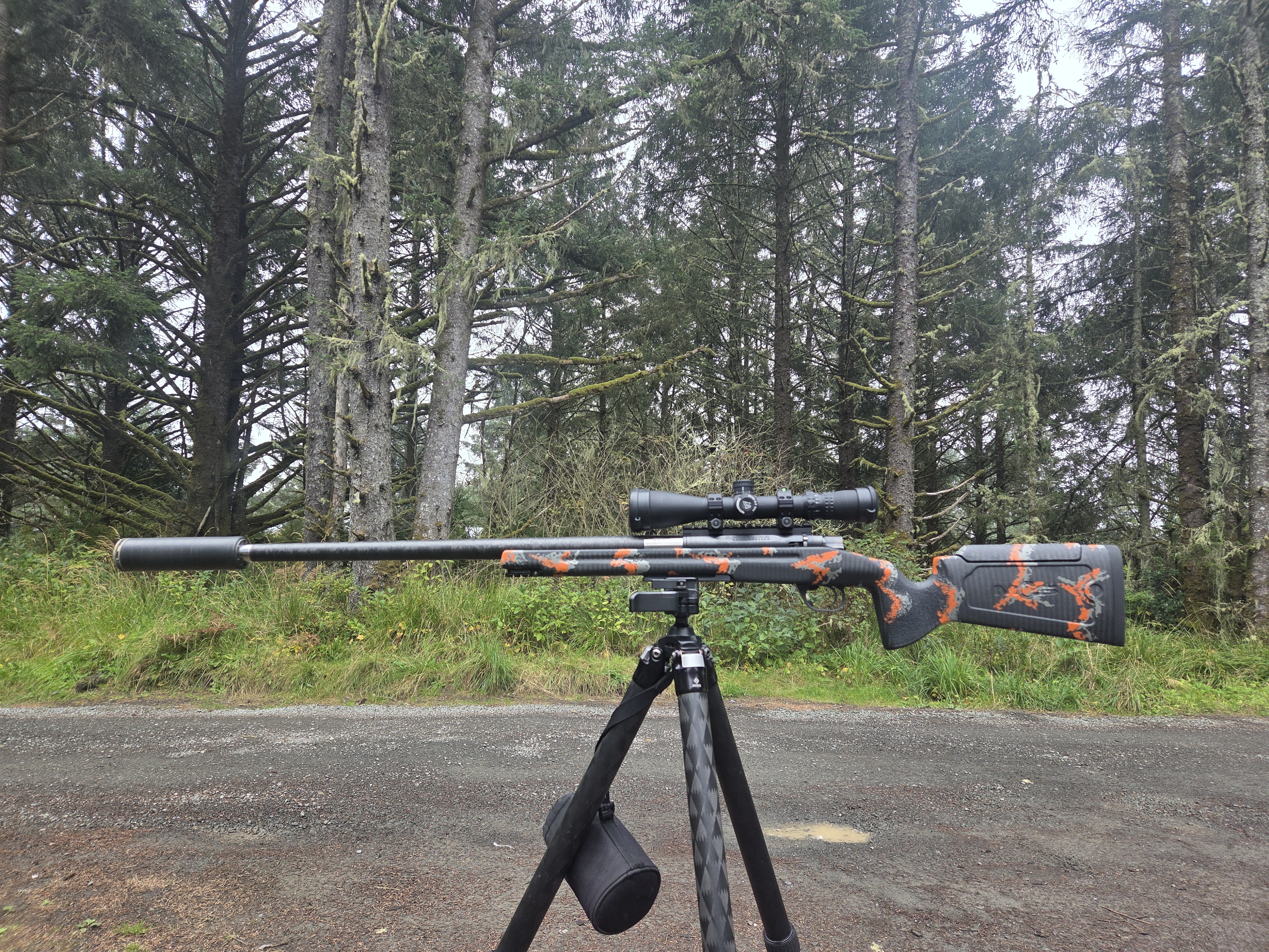

Mine is set up somewhat similar
Kelbly Nanook
Bartlein 24” #13 CFW 8 twist
Manners PH
Hawkins Hunter M5 DBM and magazine
TT special
TBAC Magnus - or Dominus if I want lighter
I went with the 24” for open country hunting, also had the builder spin me up a 20” if I want to swap and go shorter.

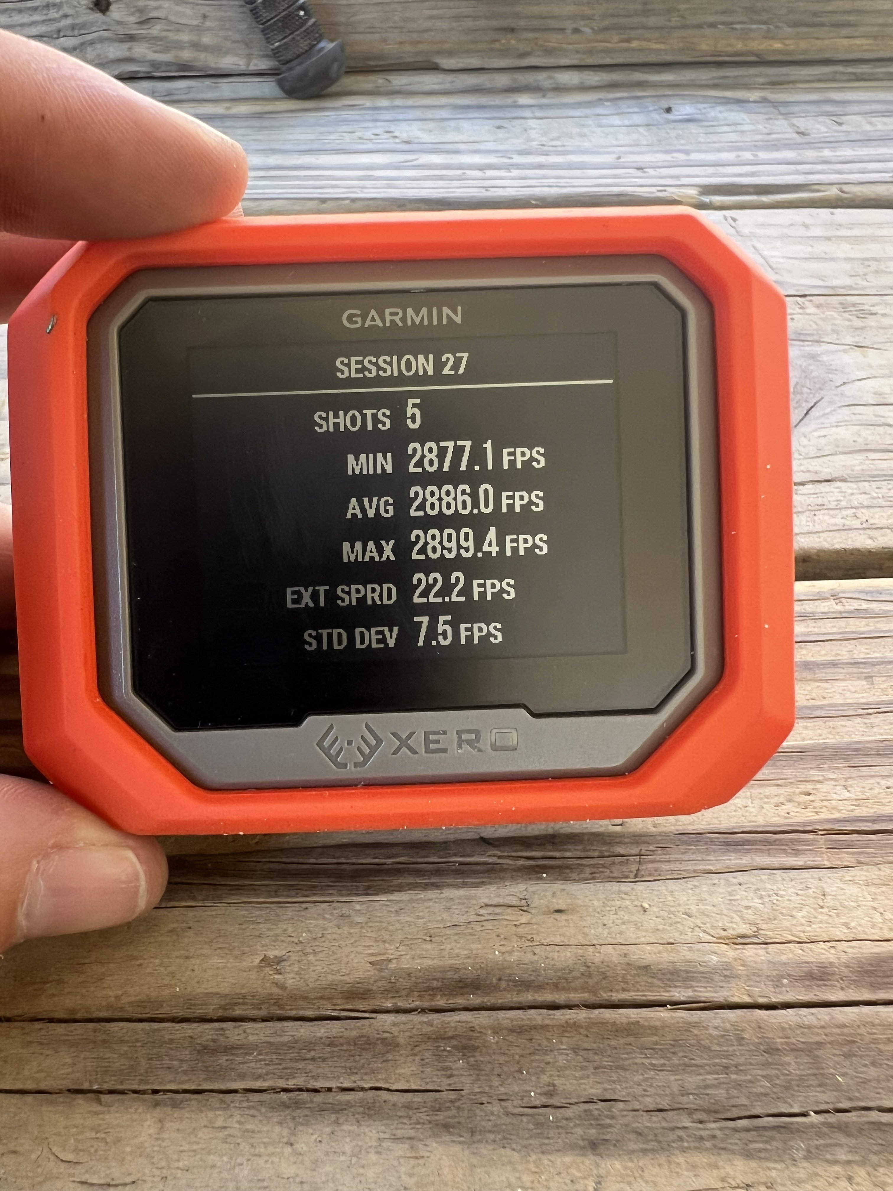

I built one last year for deer hunting. My dad ended up liking it so I built another this year. I like the shorter barrel and was getting 2950fps with federal premium that was loaded with the 175 eldx. It looks like federal stopped production of it though. I got about 2830fps with the hornady factory 175eldx loads.
First one was
Kelbly atlas lite
Pure Precision CF stock and their bottom metal
Triggertech special
Proof 22" barrel
A419 2 port hellfire when I dont have a nomad tiXC on it.
Athlon ares 3-18

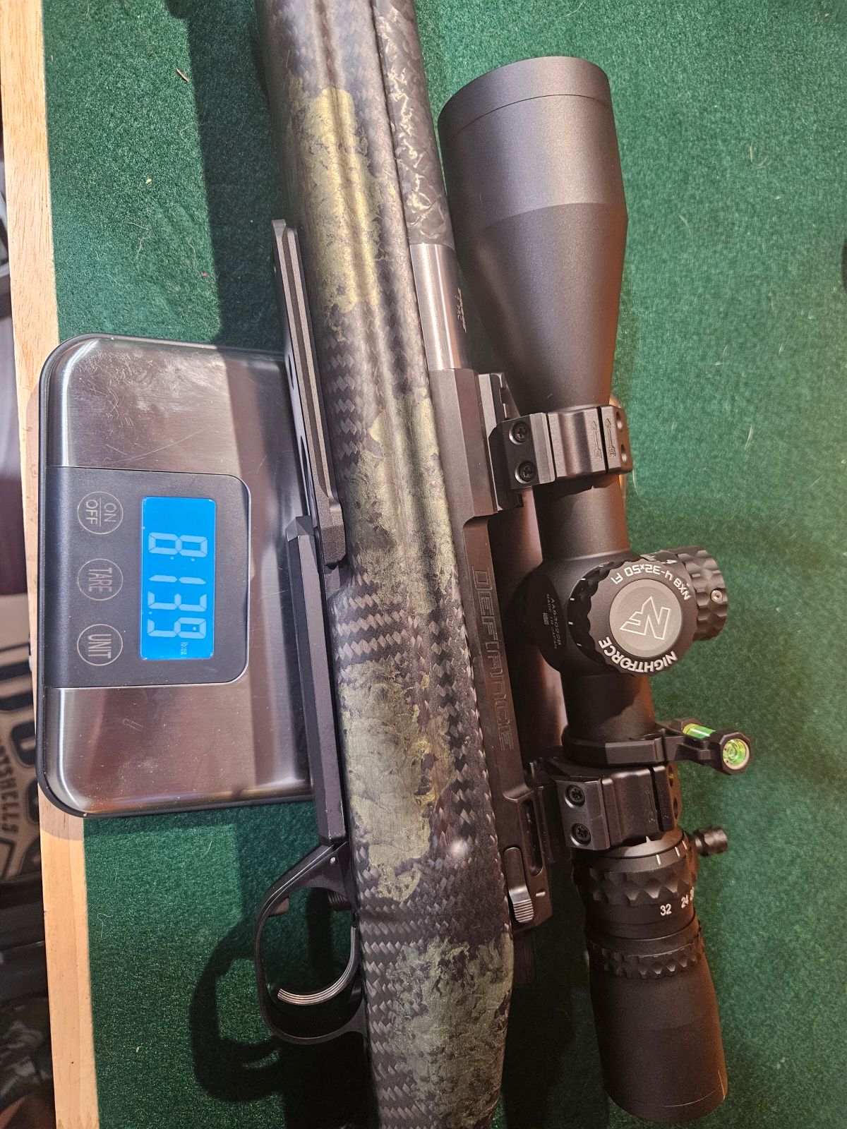

The one this year is
Kelbly nanook
Manners night stalker
Mdt hunter bottom metal
Proof 22" barrel
Triggertech special
A419 3 port hellfire when I'm not going to run a suppressor.
Nightforce nx8 2.5-20 (mounted it today and zeroing next weekend)

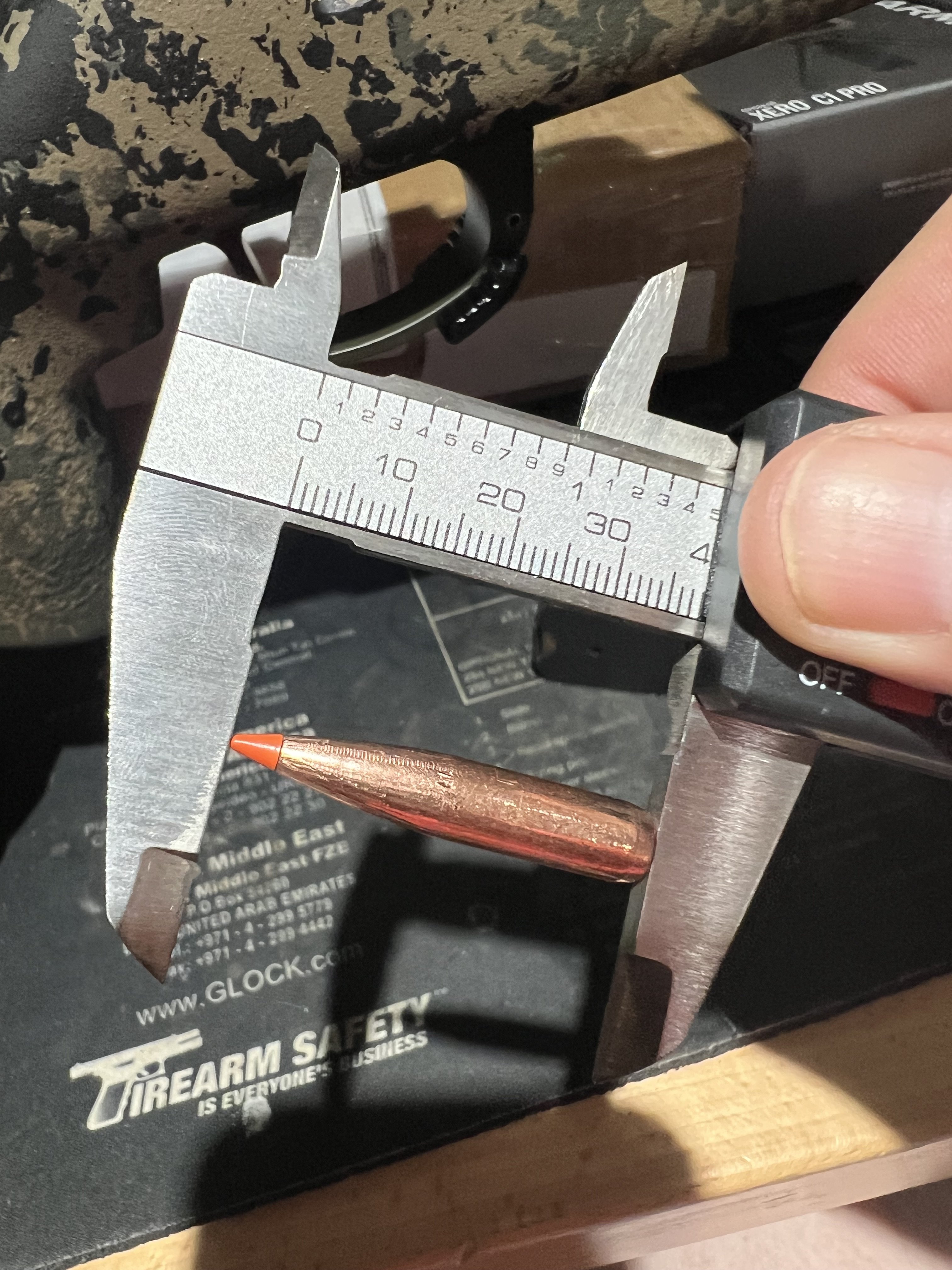

Getting good velocity from Federal 175 Tipped Fusion…there is not much out on these but they are 1.496” in length, .294 G7/.575 G1. Getting ~.8groups at 100 yards so this load should do the trick.
