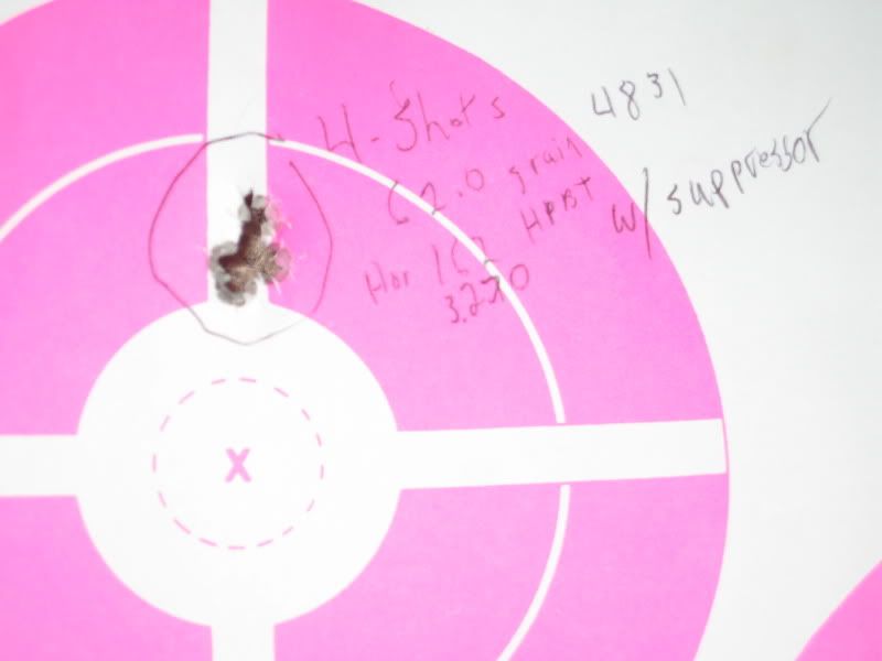

Right now I am using 4831SC Nosler custom brass and federal match rifle magnum primers. started @ 62 grains, see below chart for data but shot a .432" 4 shot group, (running short on brass), also had loads @ 62.5 (had some chrono issues no data), 63.0, 63.5, and 64.0 grains. The suppessor made very little difference in the velocity. I was getting some pretty bad accuracy, 1"-1.5". Could this been to the huge extreme spreads that I had? I am most likely the main problem. I shake like a dog shitting a peach seed.

My one nice group

There was a lot of rambling there but my main questions are why am I having the big spreads, and is the linear relation close to valid? Can I get 3000 FPS with 23" bbl w/ 162 bullets and 4831? I want to stay with a Hodgon extreme powder to stay away from the temperature extremes. I was thinking that H4350 would be too fast. I am getting very slight primer flatten @ 64 grains 4831.

Your 62 grain load does shoot very well. What kind of group did the 63.5 load do? It gave pretty good numbers. If it shot ok, I'd load up some at 63.2, 63.5, and 63.8, and see what they do. You could go over max of 64, but I wouldn't go too much past it. Try 3 or 4 rounds of 64.2 and 64.4 and look for pressure signs when shooting. If you get pressure, stop, then pull the bullets from the case. I don't think you will get 3K fps before you get to pressure. You should be able to get more velocity and it still shoot well.
