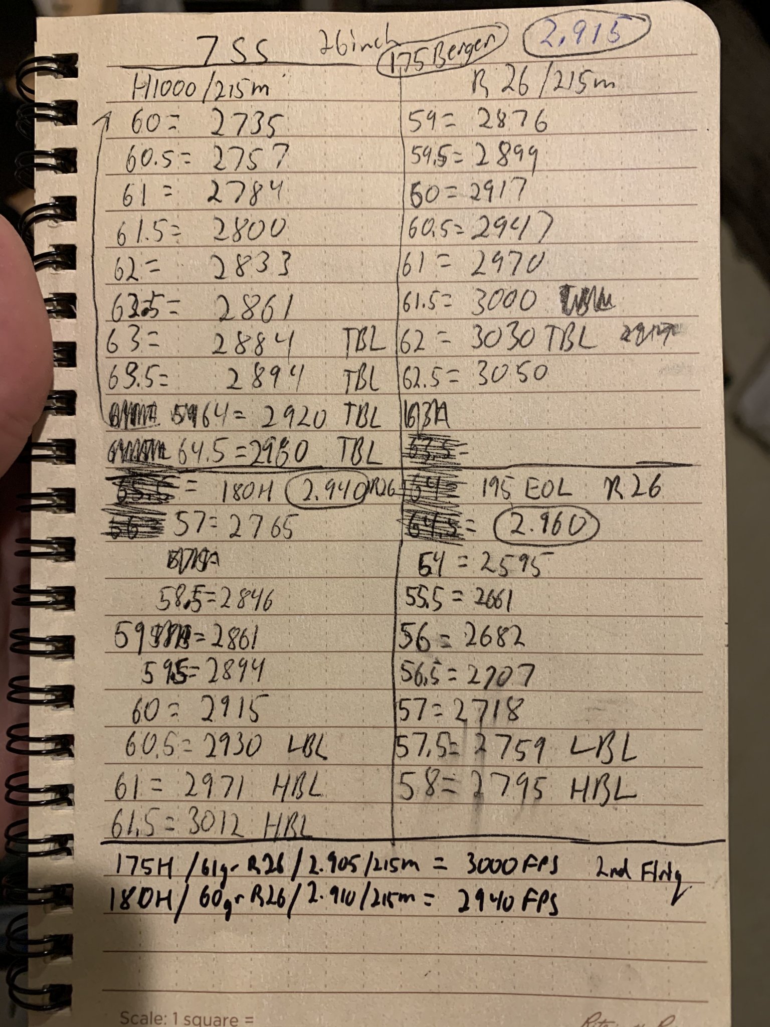

    I've done a bunch of testing with Reloader 26 and H1000 using 180 hybrids, 175 elite hunters and the 195 EOL. I'll try and post a picture of my results later today but its at home now. PM me and I can send you a picture as well so i won't forget.
    If i remember right my 175 Elite hunter load that i ended with is 215M primers, 61 grains of R26 with a coal of 2.915 (it was .020 off the lands) which was going 3000 fps and my 180 hybrid load is 60 grains of R26 with a 2.920 coal which was going 2950ish. H1000 with a similar charge weight was 75-100 fps slower
    In my 300 sherman magnum the H1000 actually got me to a higher speed than the reloader could before they started showing pressure. that gun shoots a 215 berger at 3100 fps with 83 grains of H1000 and shoots the 230 OTM at 3000 fps. both guns have 26 inch proof barrels

    I’m at 180 rounds on the 7ss and it’s speed up just a tiniest bit but here is my initial load work up
    I tried Retumbo, but it is too slow with the 180s. Didn't get anywhere close before I was compressing the charge even with a drop tube.
    I ended up getting some R33 to try with the 195s but kinda what I figured for the 180s. Seems that the H1000, R23 and the R26 powders do better with that class of bullet

    @ShermanR is the man behind the cartridges. RL 26, N565, and 4831 sc have produced the best speeds from what I've read. I'm running H1000 in mine, and @5RWill is running RL26 and he's 100 fps faster than me, both running 24" proofs. On a side note, I keep hearing of a different reamer specifically for the 195's, any truth to that @ShermanR ?
    I've got a 26 inch. with R26 I can get the 175 Elite running 3000, the 180 hybrids going 2920 but the 195s would only go to the low 2700s so gave up on them. bought some R33 to give them a try but haven't had time yet.
    I ran 60, 60.5 and 61 grains of RL 26 under 180 vlds out of a 26" Proof CF barrel. 60.5 gave me 3000 fps and no pressure signs. 61 gave me 3020ish and no pressure signs. I was at 60 grains of H1000 and it was giving me about 2970 and it was close to pressure. It was good, but didn't group nearly as nice as the RL 26 seems to.
