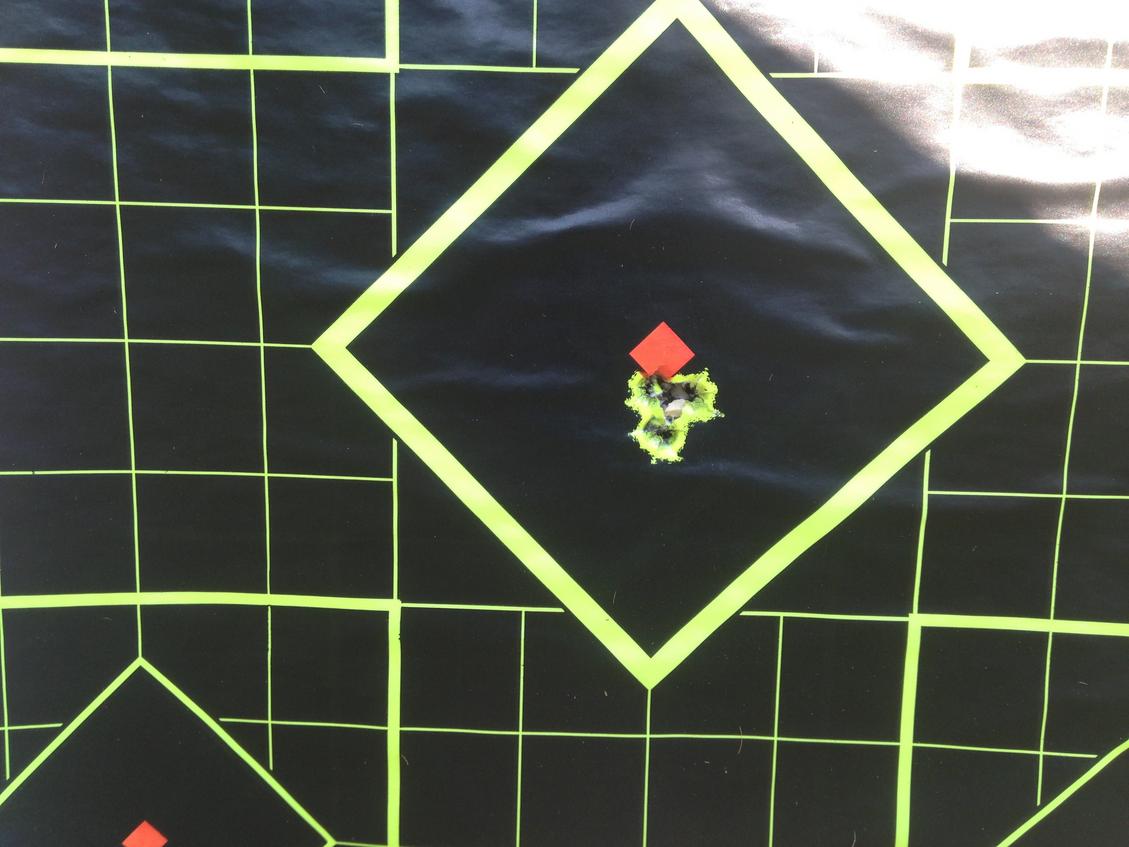

    7 WSM
    Surgeon Scalpel
    Krieger #10 26" 1-9" tw
    AI 2.0
    162 AMAX
    Winchester brass
    64.4 gr H4831SC
    Fed 215
    At 298 yds, 3 shots. Stopped at 3 for ego maintenance.

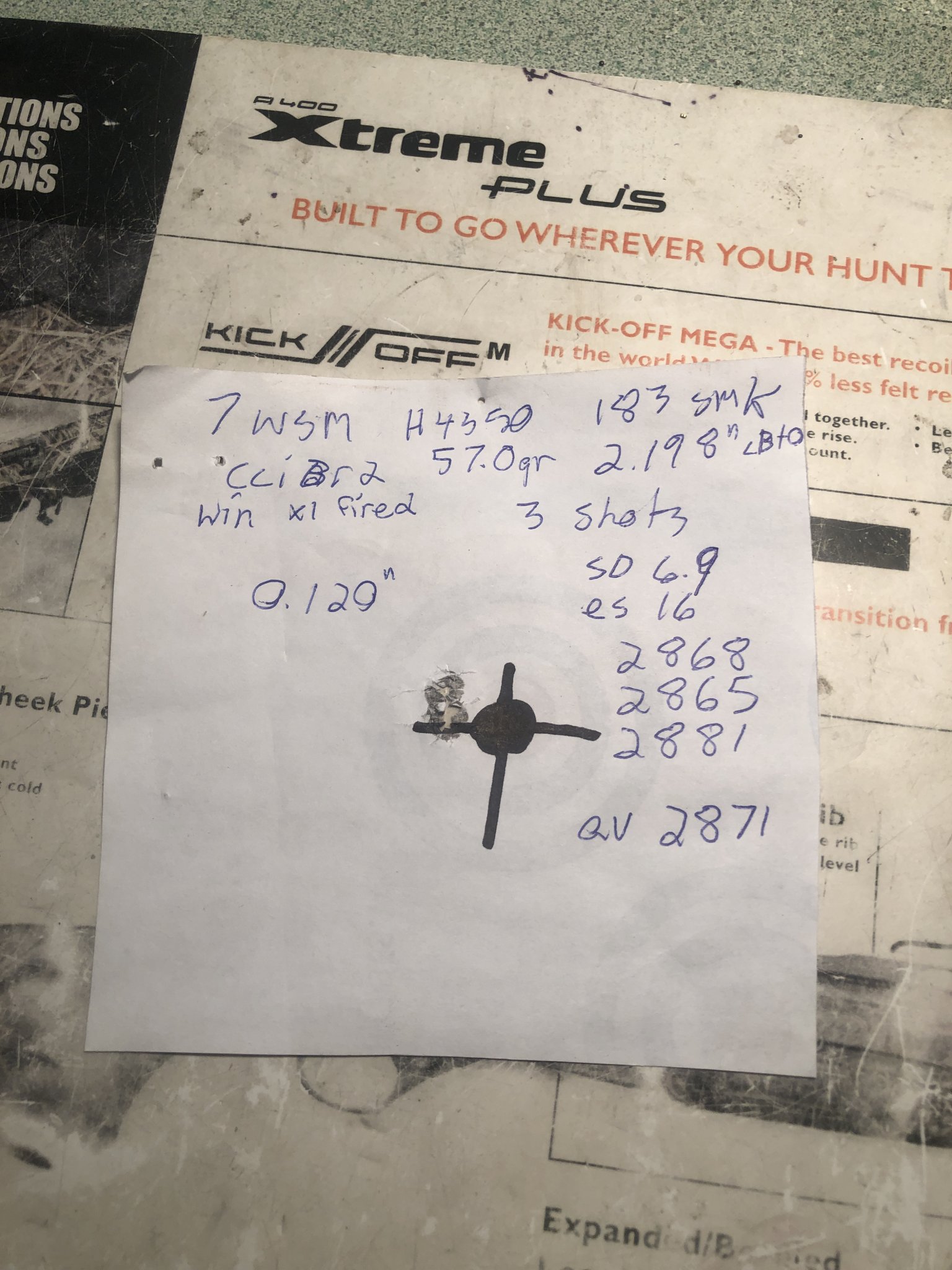

    Finally got out for a little while this weekend - elev 5880 temp 60 avg vel 2880 26" barrel suppressed 7wsm with the 180 eld-m. This was using h4350 only did 100 yrds but it was shooting great. 1/4 to 1/2 when I did my part. Will try to take to distance and see if it holds together. I see guys getting higher vel with other powders and wonder if it's worth chasing? Do you think I will be getting good use of the BC or do I need to run faster to take advantage of it. Thanks for your thoughts.
    57.0 gr of h4350
    win brass 1x fired
    cci br2
    183 smk 0.080” jump (approx)
    3.010” coal 2.198” cbto
    2867 FPS sd 6.9 es 16
    0.12” 3 shots at 100 yd.
    26” 1-8.5” ibi pipe.
