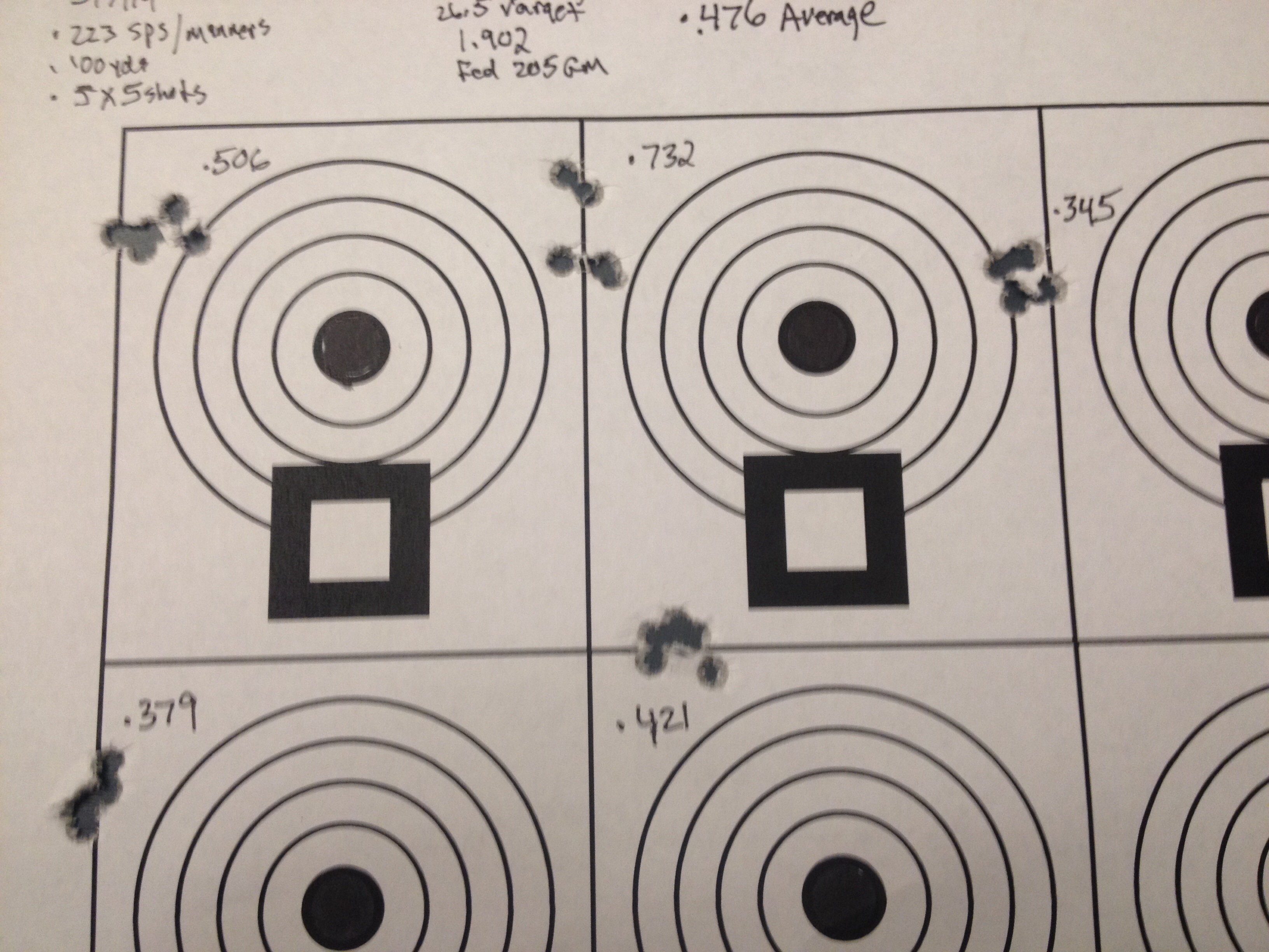

Here's a target from Friday. 5x5 at 100yds, only real upgrade was a manners stock w steel bedding. Mine wasn't consistent w heavies these are 52 smk, oh yea mine has a crooked chamber, .476 average!
