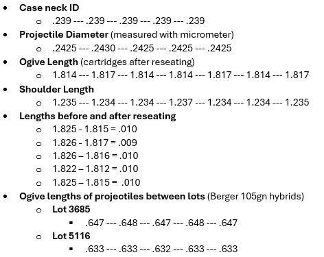

I'm about .010" off the lands according to the old school method of finding the lands via the feel of an ejector-less bolt. I started with .015" and experienced more consistent muzzle velocities at .010" and stopped there. Before my trip I shot pretty extensively without seeing any issues. I'm loading off a Dillon XL750 and the dies are on a dedicated tool head. I use the same shell holder slot to seat all my rounds. I'm using Redding type S with a micrometer seating die.

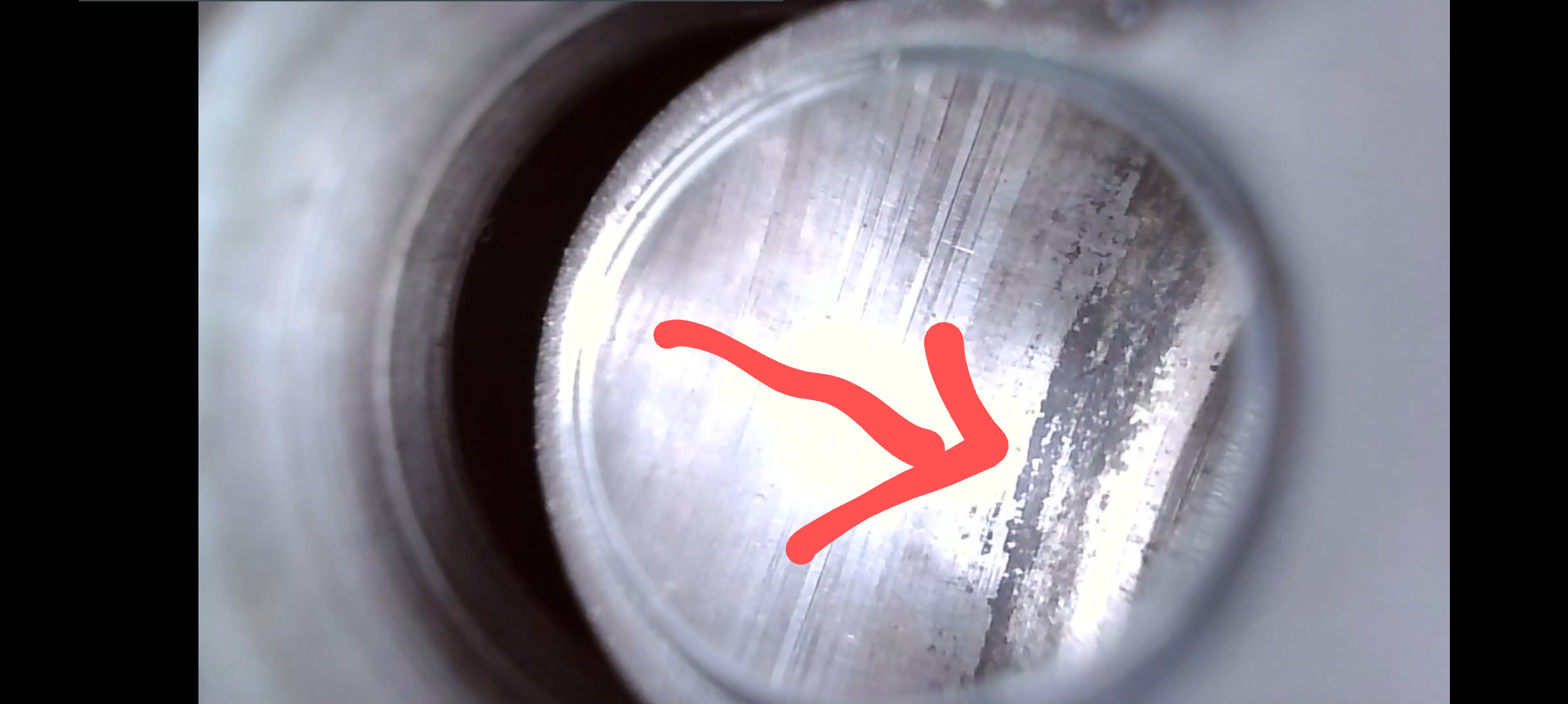

Before my trip I went out and shot 50 rounds at the range and did not clean it. About a week later was day 1 of my shoot and I shot about 50 rounds and experienced my first stuck round. I unstuck the round (very easily) with my cleaning rod and cleaned the rifle. Cartridges were entering into battery and ejected without a problem. The next day I shot about 100 without a single issue and then it popped up again. This time I unstuck the round and cleaned the powder out and put another round in with the same result. I cleared the bullet and have not cleaned it in case the community here suggests I take a look at something.
Is this carbon ring buildup or something else? Should I back off and increase my land jump?
