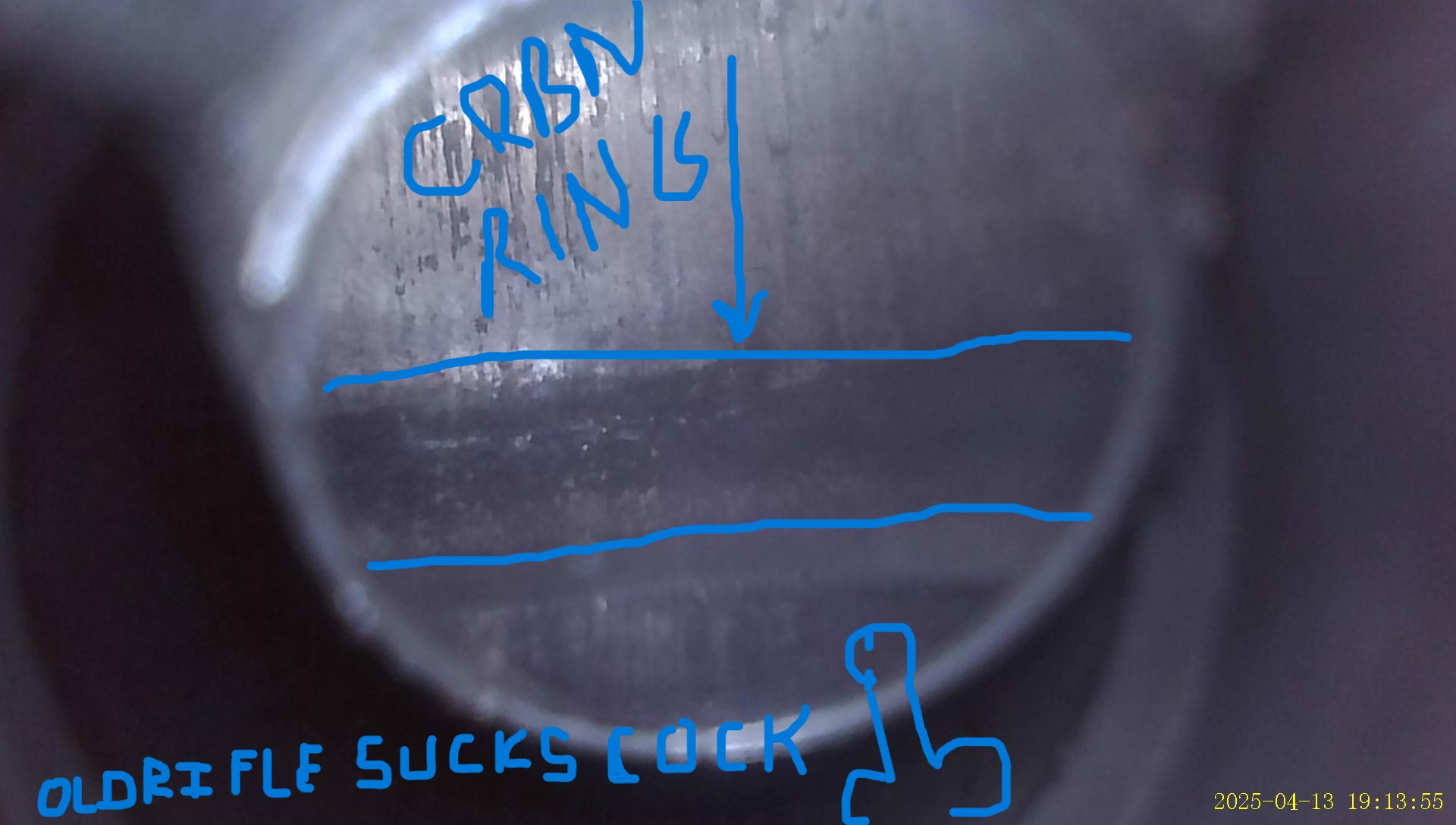

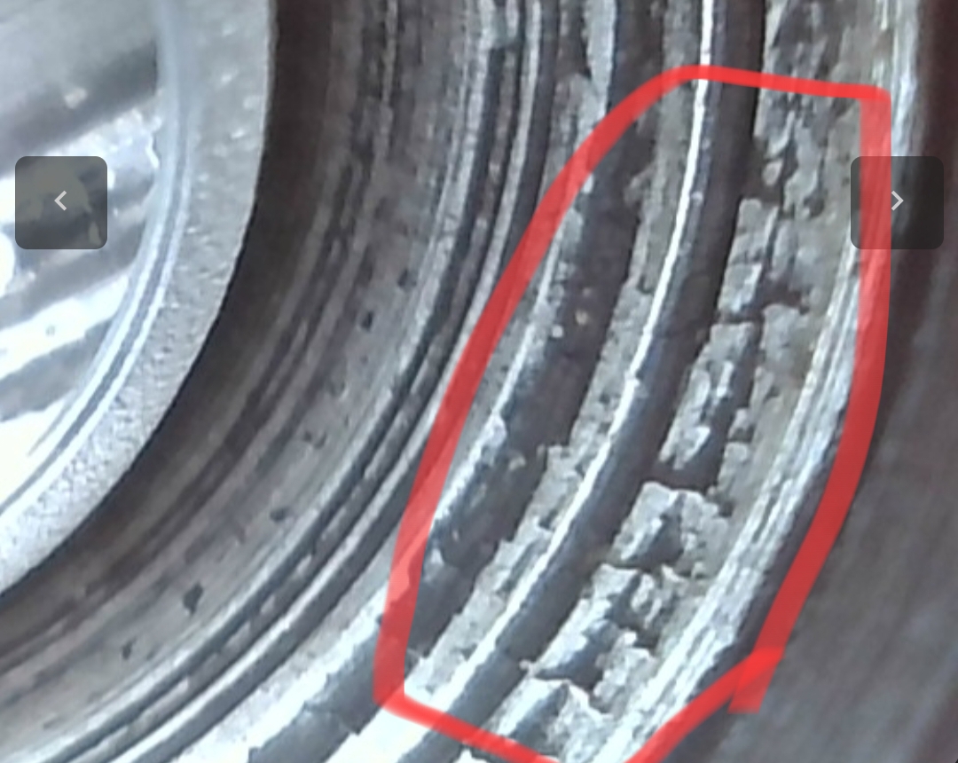

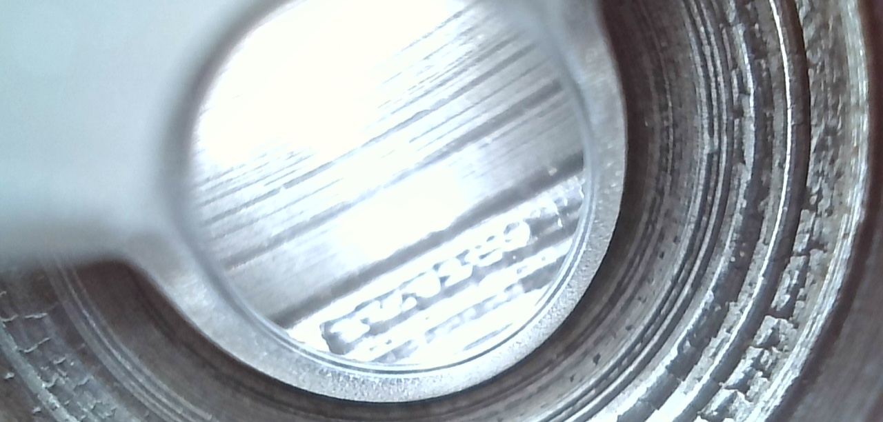

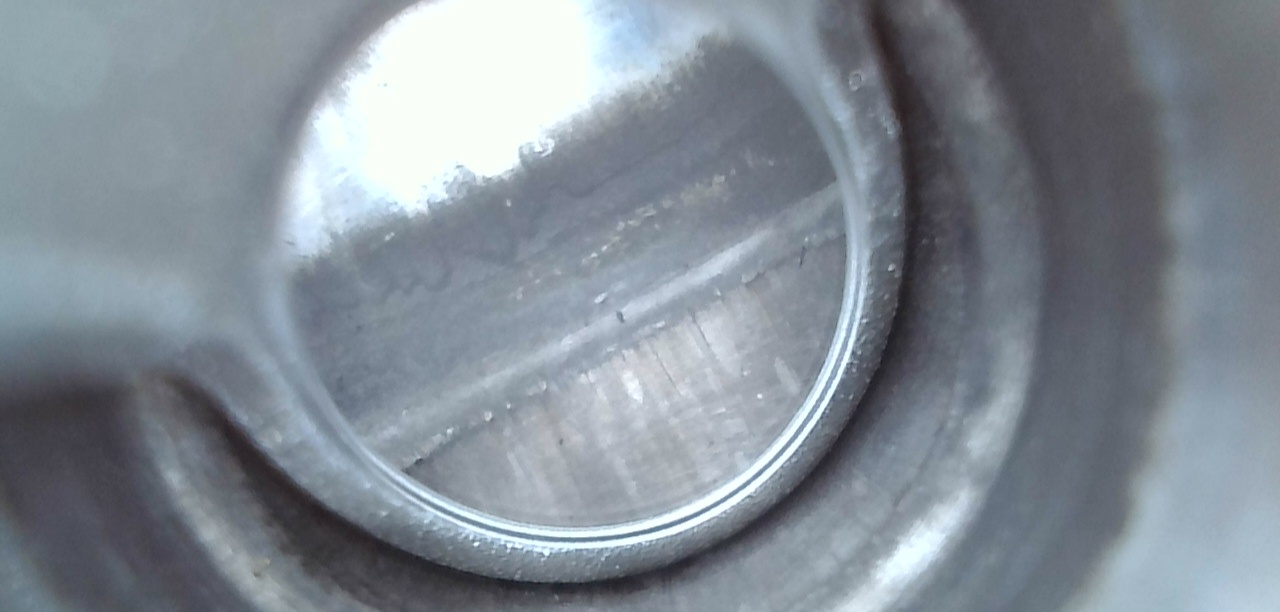

Got the borescope, heres what i see. First picture is the shoulder area inside the bore, second pic is just before the rifling, i think may be a carbon ring?

Pic 1: So you got fire cracking, which means there’s been substantial heat with history of firing. This is not something in which to be alarmed with a high volume comp rifle, but a hunting rifle it’s insane. Don’t ask a tool to do two things equally as good.
Pic 2: Yup, carbon ring.

The fire cracking probly wouldnt cause my problems, right? And im assuming the carbon ring is most likely my problem this whole time?

Considering the case neck clearance is changing at a rapid pace, as evidenced by the difference in the case necks bullet test, just focus on keeping the carbon ring in check. Your case neck clearance has got to be too little. Neck turning the brass is the only way to increase that clearance without rechambering with a reamer with larger neck diameter.

If I’m looking at pic #2 correctly, that seems like one heck of a carbon ring? I’m no expert, but my carbon rings have been waaaay more wimpy after way way more rounds.

Maybe I'm a bit dense, but I do not see any fire-cracking in pic 1. Which is good, because fire-cracking should not be present at the shoulder area.
What I do see in pic 1 is chatter and tool marks. Whoever chambered that rifle should be ashamed of himself.View attachment 8654731
Yeah, it’s like looking into an unfinished Death Star or something
Does anyone have any pics of clean chambers that don’t look like someone lit off some white phosphorus in there? I don’t have one handy.
Maybe it would help set the OP’s expectations, for his chamber looks…odd.
That’s the problem with bore scopes. Everyone sees barrels as living in a binary state. The are shiny and perfectly machined, or the are rotted/pitted/cracked which means bad. There are states in between that still allow the barrel to still shoot reasonably accurately. What they don’t show are out of bounds chambers/throats and ammo deficiencies.

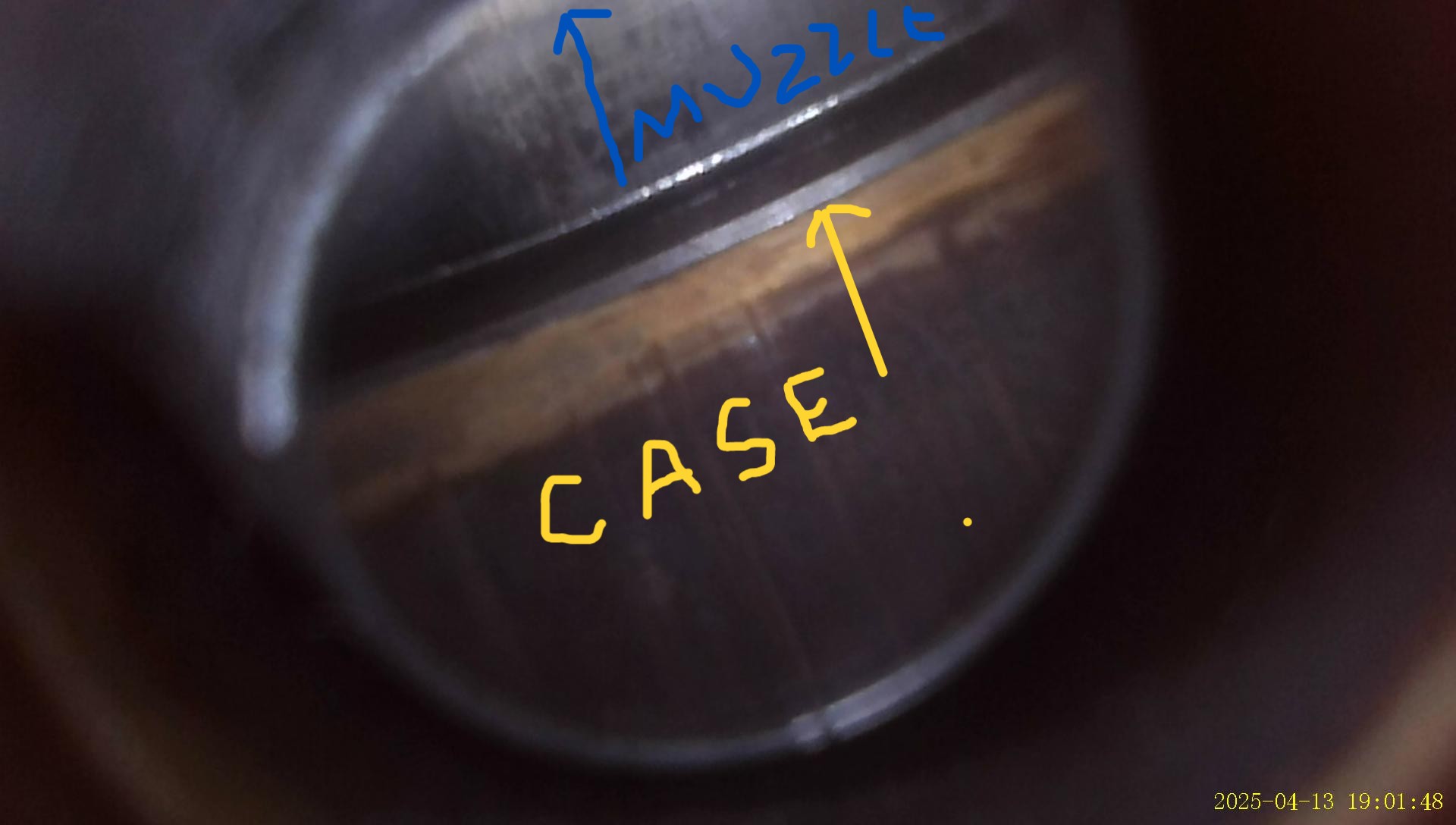

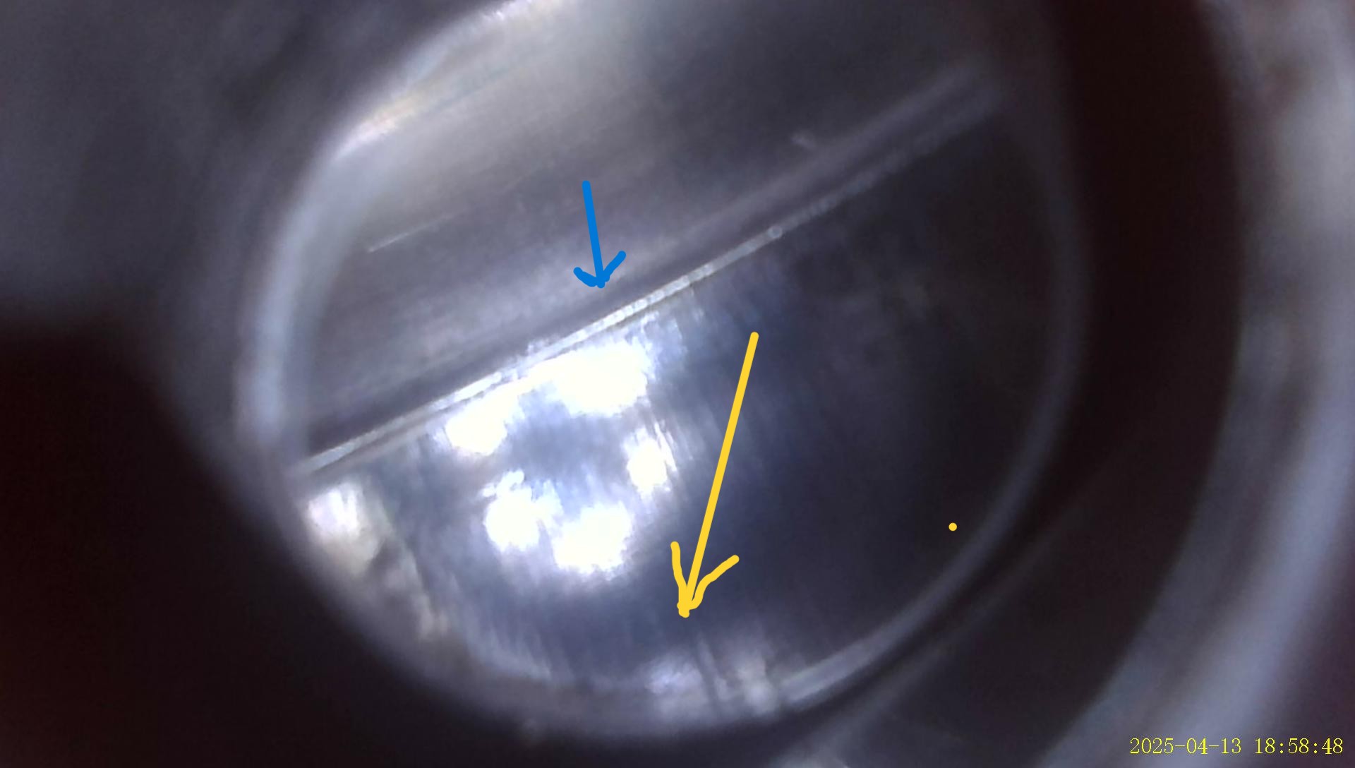

Blue arrow is where the area just prior to the chamber wall where the carbon ring forms. This is a clean barrel, of course with Thorroclean, and no ring is visible. The yellow arrow is where the lands begin, thus muzzle direction.
Directions flipped, but you see where a case its in the chamber just prior to chamber wall.
Then if the ugly black ring you see below is formed in that area where the case neck sits, it decreases the clearance, because the case neck would sit on top of the carbon ring crud.
