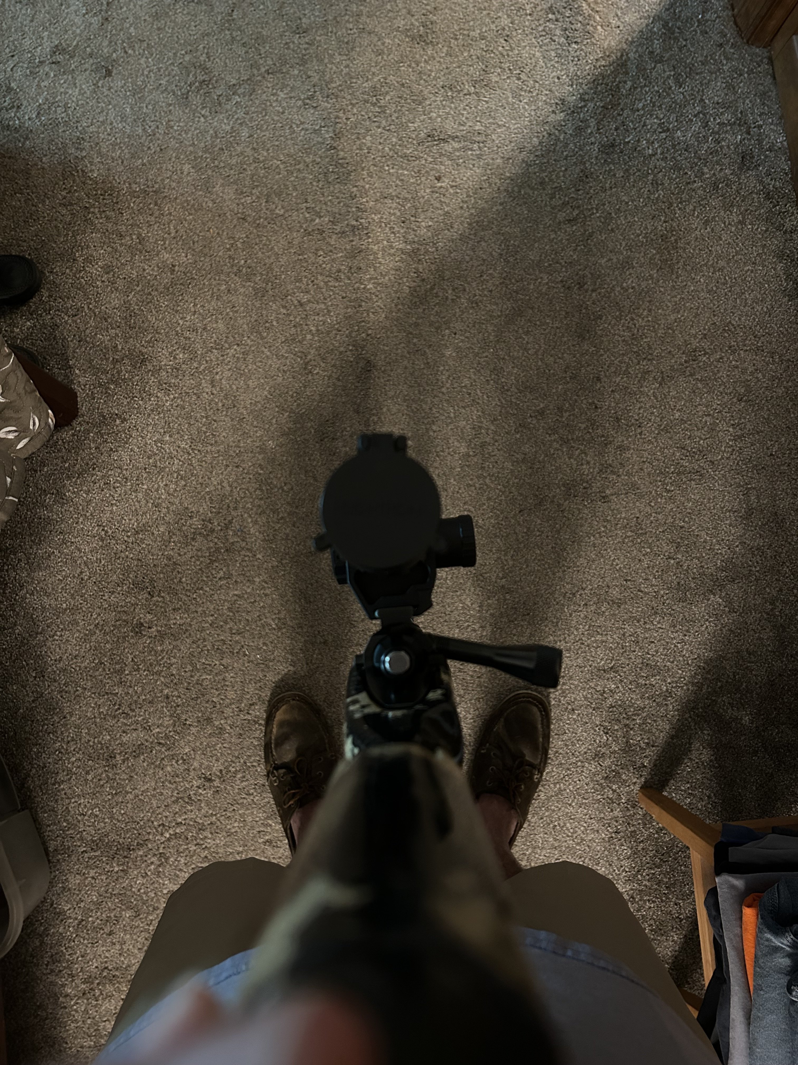

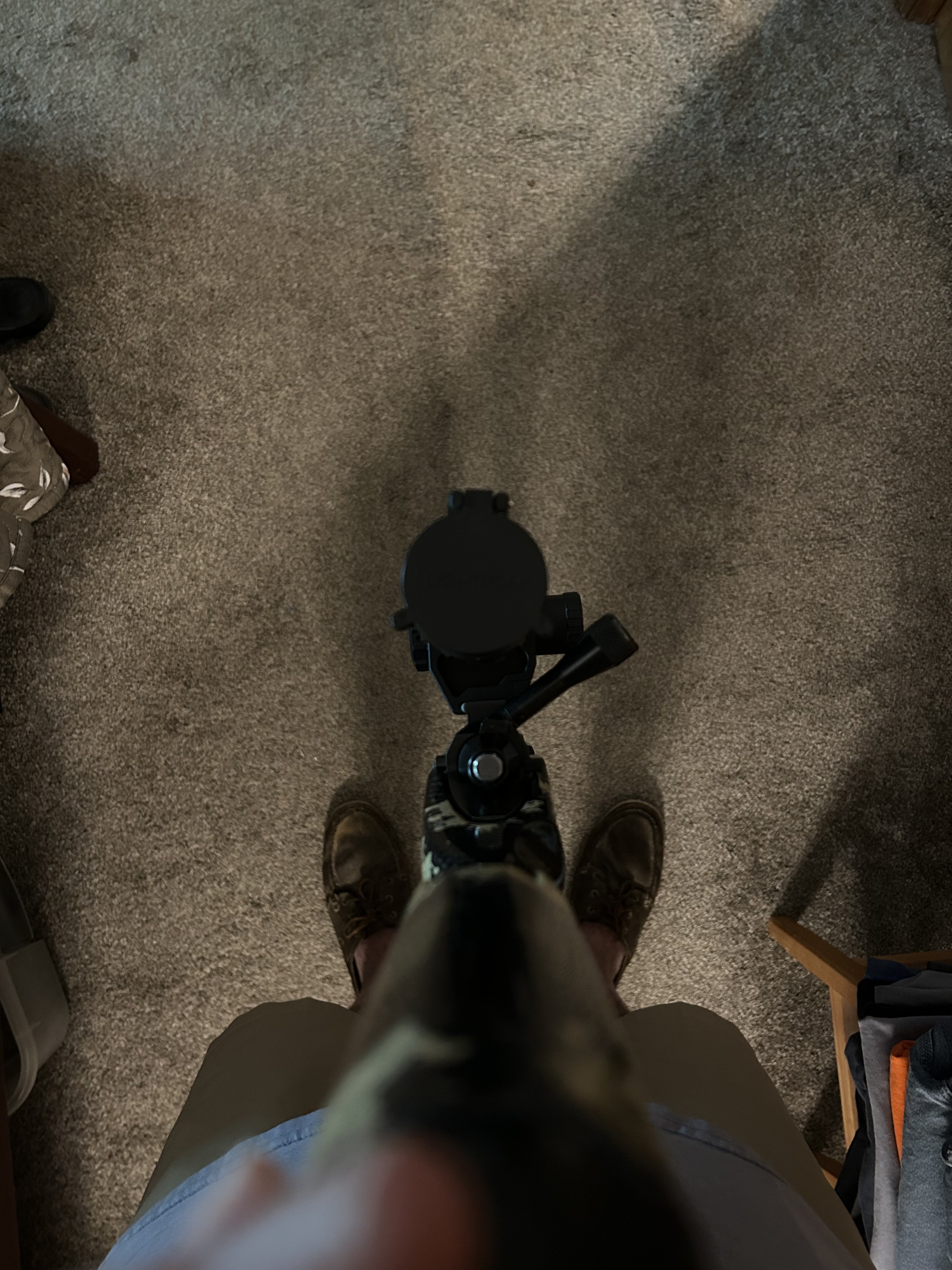

Bumping this thread, has anyone had their hands on a ruckus 75 degree action? Any feedback?
IMHO, the bolt lift difference is not much heavier than a 90, not enough to matter to me. What does take a little getting used to is where the handle is when locked up - it looks not closed. Not great pics, but it shows the range of movement anyway LOL
