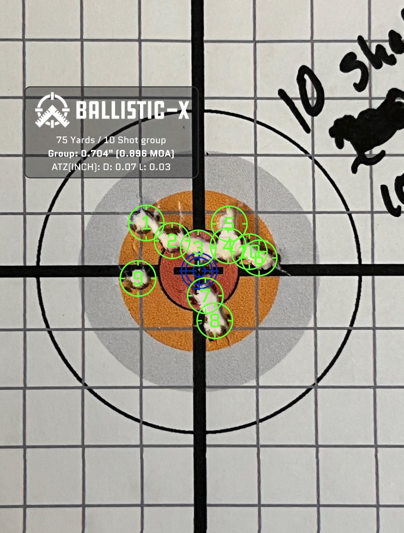

Hey gang. Running into something very curious.
Scenario:
Indoor, about 80º F, no wind
MkII FVSR Suppressed, 4.5-27x Athlon Eres BTR Gen 2, Boyd's Varmint Stock
CCI SV 1070fps 40gr
Bipod & Rear Bag
Situation:
I can consistently hit sub-moa groups at up to 80 yards indoor. However, once i get the target to 100y (i haven't tried 81-99 yards)
Below are pics of 75 yards x 10 shots and 100 yards x 5 shots (because more shots wouldn't change anything for proof of concept).
Any Idea what the issue is here? Is it ammo? Are there some recommendations you would make for better choices? Not necessarily looking for one right answer, but more of a discussion on the ballistics (of course recommendations are helpful too!).
It looks like the rounds are opening up widely at 100 yards vs 75 yards.
Thanks in advance!

75 yards x 10 shots

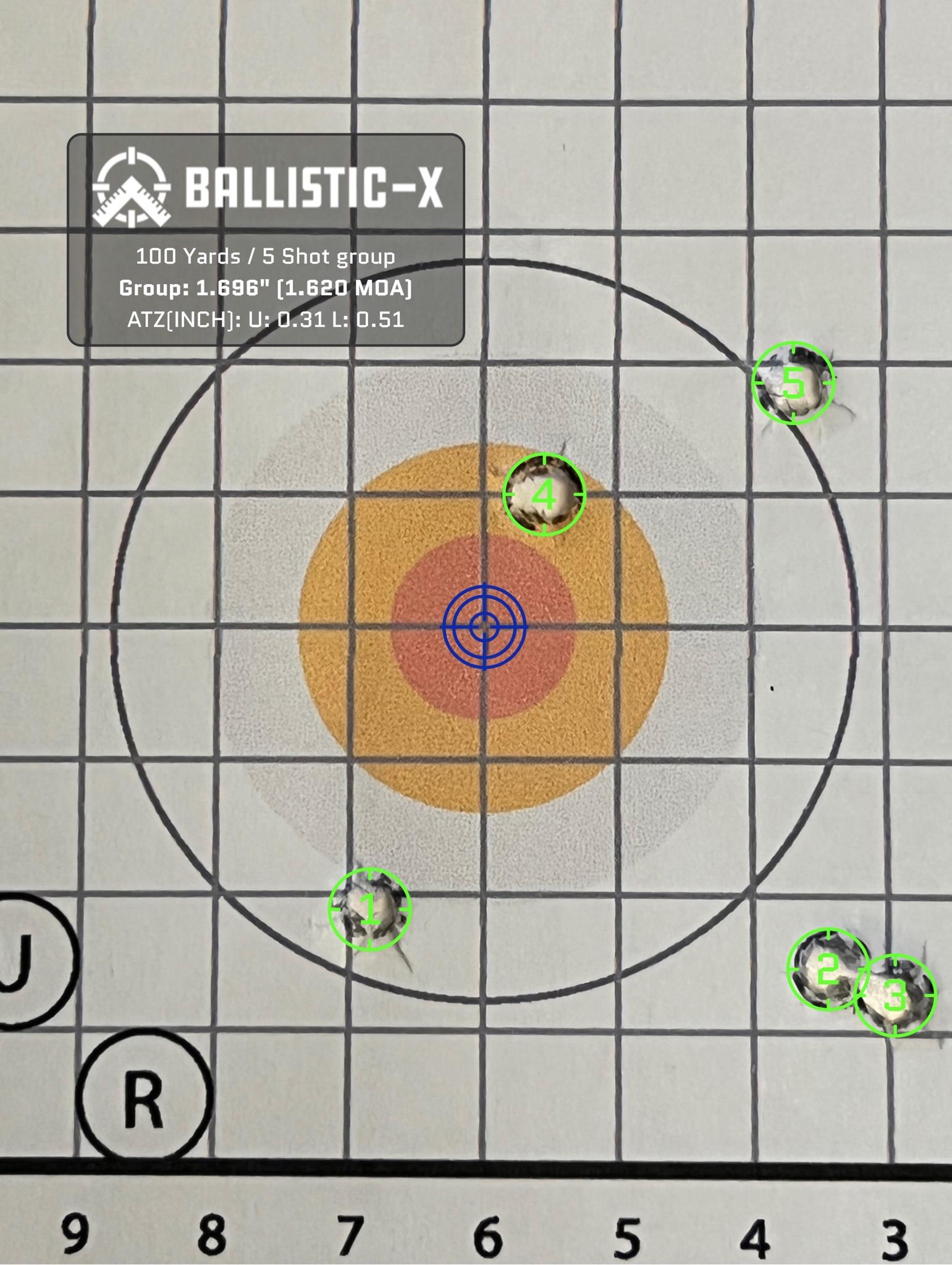

100y x 5 shots
I shoot a CZ 457 LRP and use SK Rifle Match and get 1MOA at 100m so it can be done with 22lr a lot is down to ammo choice if you are doing your bit

I wanted to add that I have seem the exact same as the OP. Accuracy looking good to about 70 yard then falling apart. For me it was ammo and gun. Same ammo could work well in another gun, and fall apart in another. Try some ammo that is likely better than CCI SV. Seems there is availability of Eley Team and Match online. Grab a couple boxes of that and see if it does away with sudden drop in accuracy at range for you. Other choices besides mid to high range Eley would work if you can get it. Then work down price points and see how it goes. Generally the $15-$20 range a box at normal prices these days seems to be reliable. You can spend less but takes lots of time to shoot It and make a selction.
i'm going to try some Eley here soon and see how it goes. It definitely _could_ be my barrel, but 75/80y, i'm consistently </= 1moa. Once i get to 100y it opens up so much more. Have been thinking about a CZ or something else, but the savage just shoots so well within 75y, it'd be hard for me to get rid of altogether.
Thank you for your thoughts!
But then again it could still be the barrel, you hear a lot of CZ owners claim at 100 yds their CZ will run with a much more expensive Vudoo but then if you look deeper into it is usually at the 150-200 yards and further that the more precision built Vudoo starts wiping the floor as compared to a CZ's accuracy.
Pretty much any decent quality .22 will shoot well with quality ammo at 50 yds.
Too an extent you generally get what you pay for and usually the trying to get a less expensive gun to run with the higher priced competitors models there is a point the difference starts becoming apparent.
1.5 MOA at 100 for a 22LR isn’t bad. Many use 5 shot groups which does not represent what the ammunition really does unless the groups are overlaid electronically after the fact. 3 groups of 10 shots each averaged are a lot better to go by, although many shooters avoid that. An average group size result from that is rarely less than 1MOA.
25yd increases are a big deal when it comes to remfire accuracy. Looks like you have proven what the stock Savage is capable of. If you want more. You'll have to spend money on the Savage or go to another level gun.
