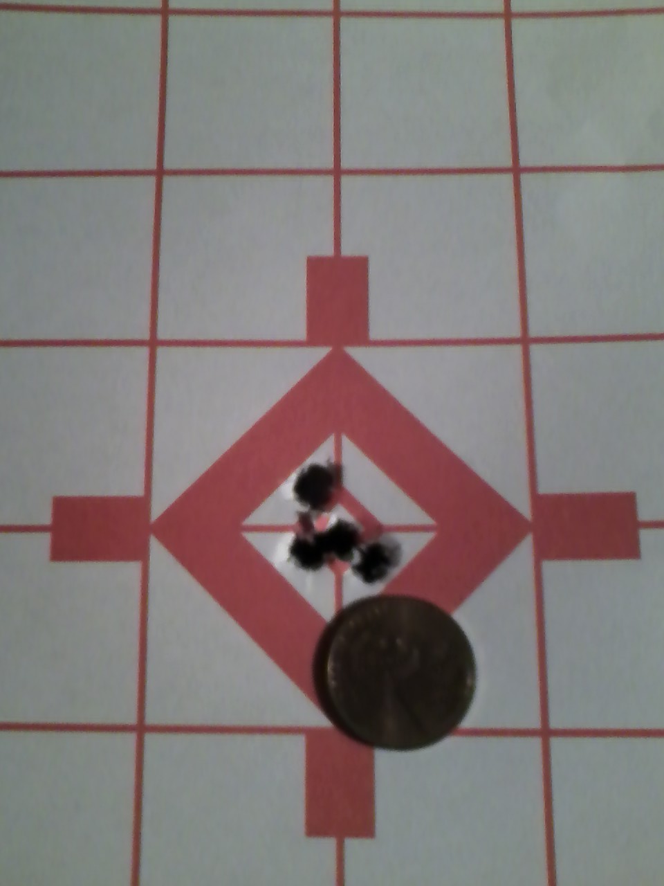

I like the Alliant Powder Pro 2000MR
My HCS MK 12 Mod 1 Likes alliant powder pro 2000mr. I used the recipe off the Alliant site.
BHA .223 match Brass
25.2 Gr Alliant PP 2000 MR
CCI #41
C.o.a.l. 2.260
Shot the 5 round group below.
