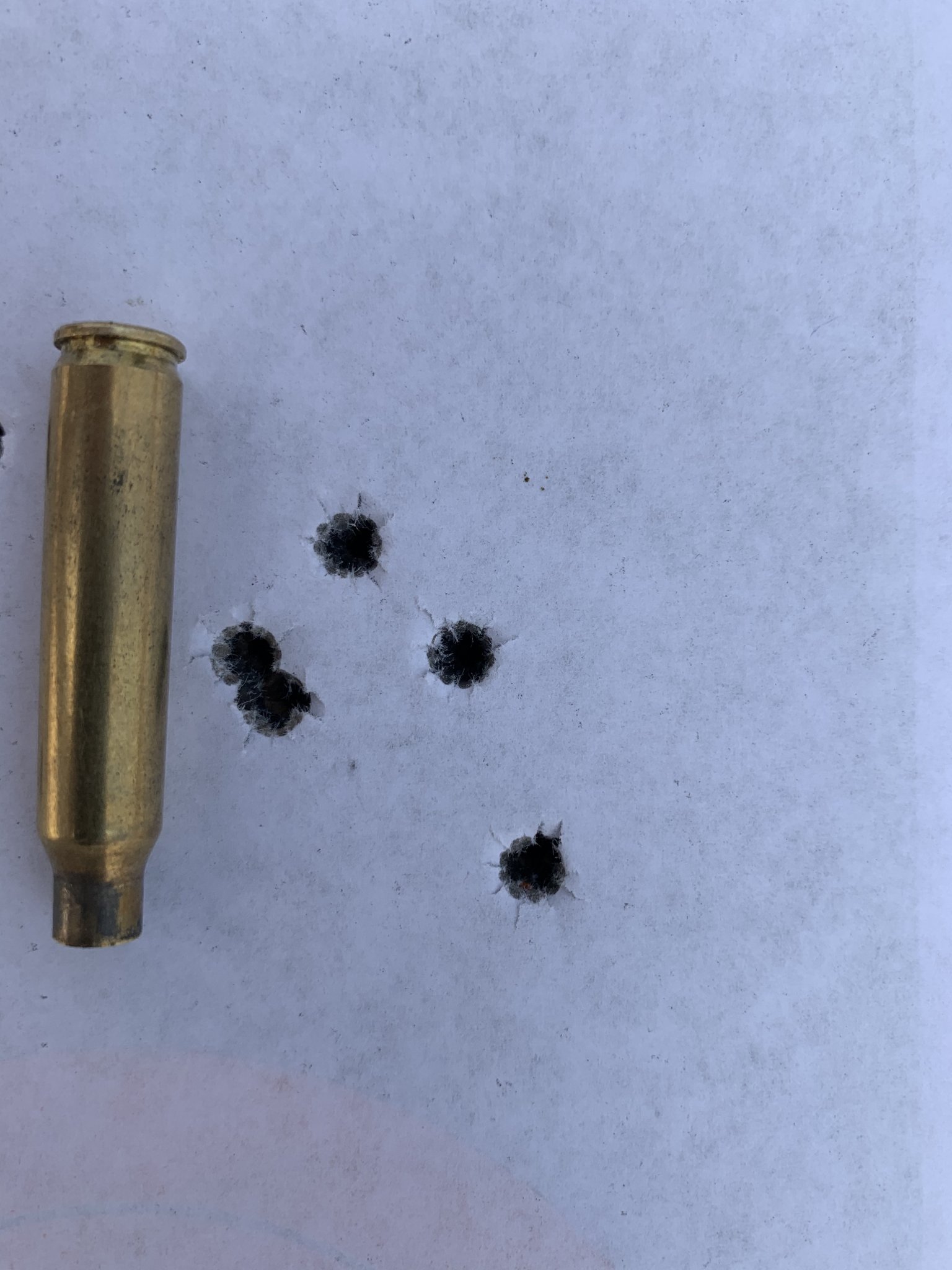

I have a really good load worked up for one of my ars, with 77gr smk. I got a new ar pistol with 11.5” barrel yesterday and went to zero it today. That being said I used the loads I had already. The 77s were averaging 2280fps. Is that going to be fast enough to fragment as keep them loaded as a sd round? It’sa really stable load in my 16” and would prefer to keep uniformity across my ammunition. It did this today at 100 yards with magpul buis pros. So the gun accuracy wise likes the load. Just wondering about terminal performance to 200-300 yards.

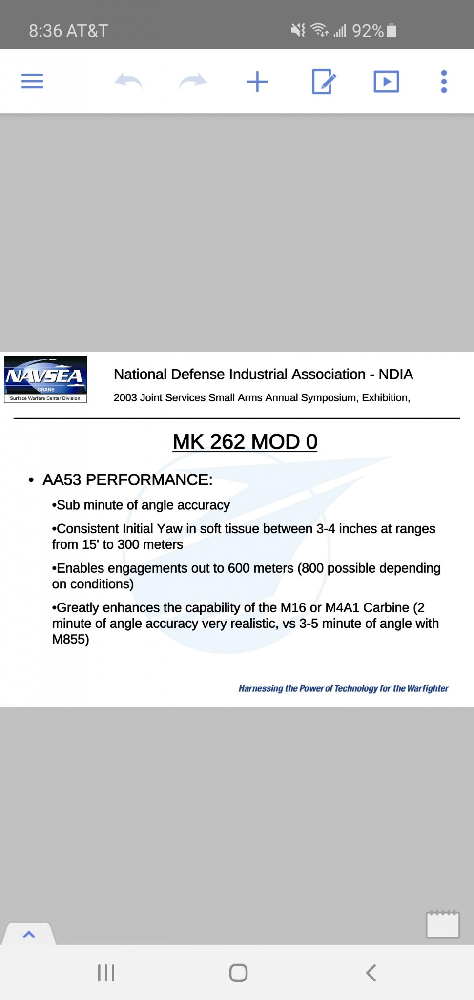

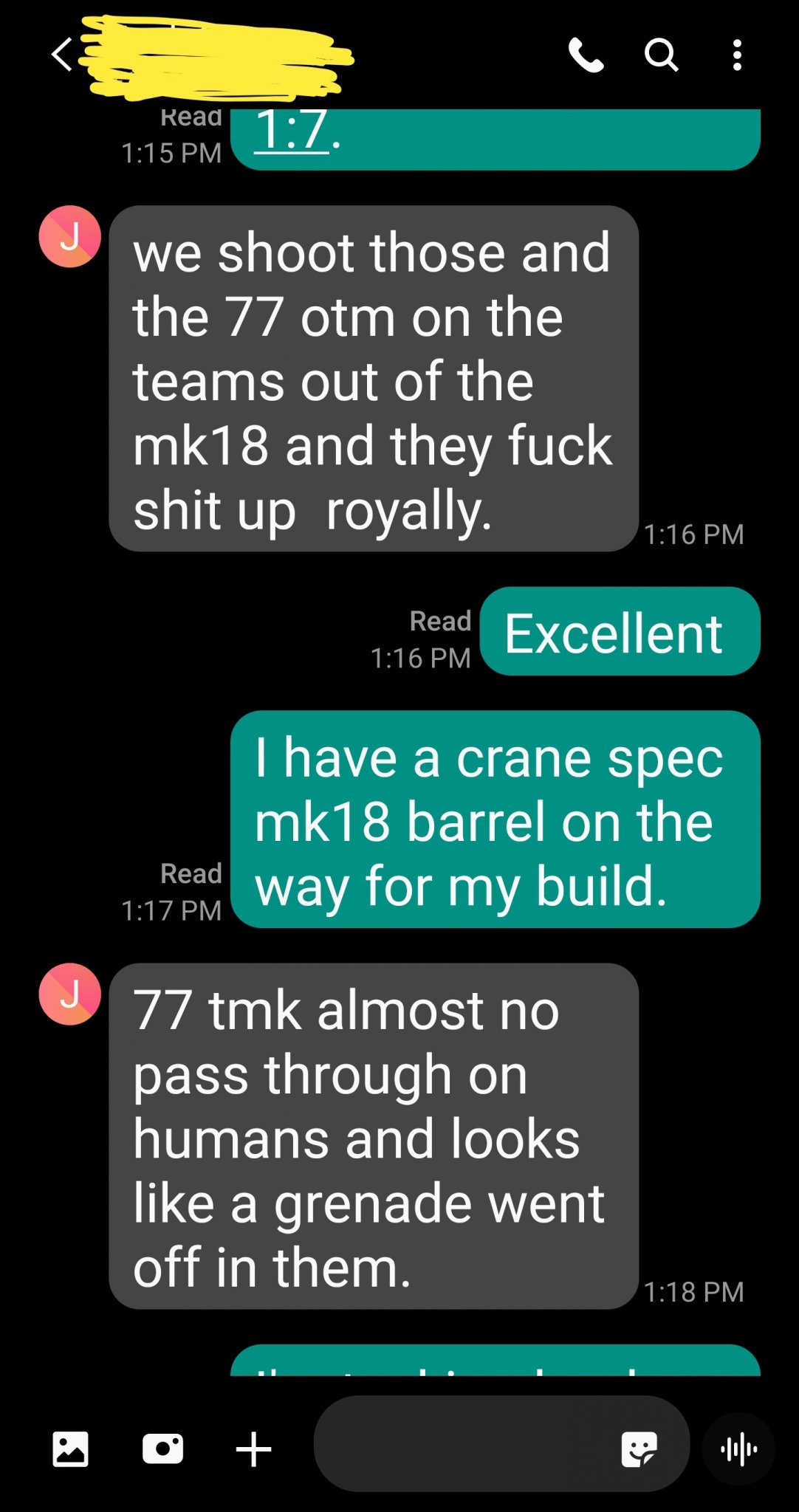

    OP, what is your velocity with the 77 out of your 16"? That grouping looks pretty good, but muzzle velocity may need to get bumped up to 2400 out of that 11.5" to get reliable expansion at 300. The 77 tends to have significant expansion within the first 6 inches of ballistic gel

    FWIW....
    This may not be a "study", but was texting one of my buddies from overseas the other day and he had some direct feedback with the 77SMK and 77TMK out of Mk18's (10.3")...
    Many people like a do it all round. That was the genius of “barrier blind”. However the thin jacket if the MK 262 77gr acts almost as a frangible or varmint grenade. If you’re not shooting through glass, walls or anything like armor the MK 262 is a devastating round. 👍
    Reactions: clcustom1911

    Here’s some data from my gun.
    12.5” BA Govt barrel
    76F 26% 29.86mmHg
    SMK 77 gr HPBT
    LC brass x 1 firing
    H4895 23.8 gr
    Fed 205M
    Ogive 1.843
    COL 1.750
    Magneto V3
    2566, 2603, 2540, 2562, 2579 fps
