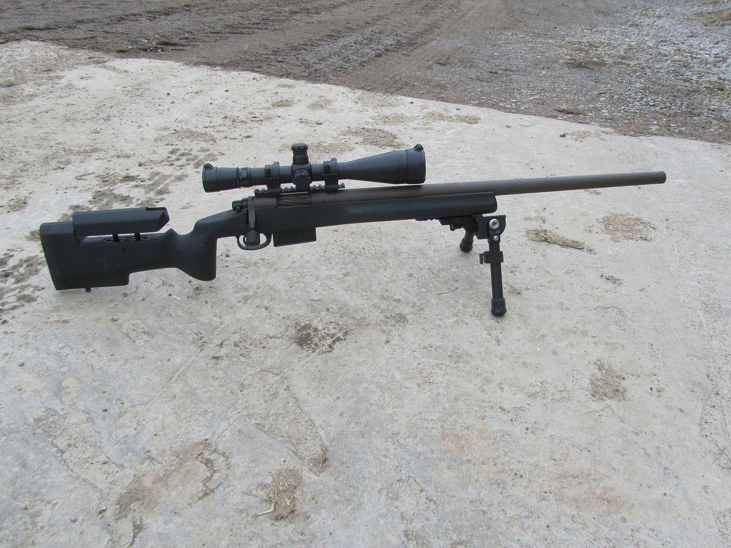

The test rifle is up for sale in the exchange. Here are the specs of the test rifle for reference. Accuracy is in the 1/4 to 1/3 MOA range with most loads. This rifle is like a mini .284 Win.
Remington 700, Short Action, Right Hand.
- Fully trued, PTG oversized bolt installed (1 piece)
- SAC Lower Bolt Clearance mod performed
- Timney 510 trigger tuned to 2.5 lbs
- Seekings 20 MOA base
- 8/40 base screw upgrade
- Side Bolt Release (gen 3)
- APA bolt knob
- Oversized recoil lug
Brux M40 7mm barrel, 1-9" twist.
- Finished at 24.9"
- Chambered in 7mm Creedmoor, SAC reamer, 2.855 touching lands with 162 A-Max
- 5/8 x 24 threads, custom thread protector.
Manners MCS-T4A, 90%, right Hand
- APA RTG bottom metal
- Full epoxy pillar bedding, with stock fitting for clean up
