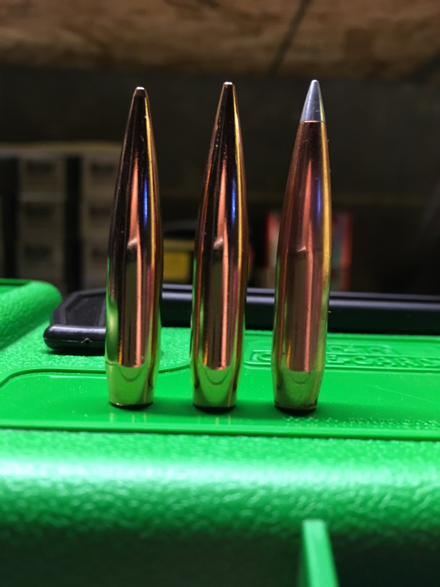

Berger 190 LRHT update
My new lot of bullets I just started shooting have hammering but have been consistently shooting high.
Checked my speeds and they are the same.
Shot in a few locations to ensure environmentals weren’t a factor and it was consistent
I played with BC till it matched my recent dope and elevations today.
A G7 of .405 was money from 530 to 2020 yards.
Reactions: BCX and jasent
Nice great bc. Are those hollow point? Be a great hunting bullet
They are not, tips are pointed. I read on another forum that someone opened the tip with a #60 wire drill bit to initiate expansion and the predicted drop did not change, however there was no info on terminal performance.
