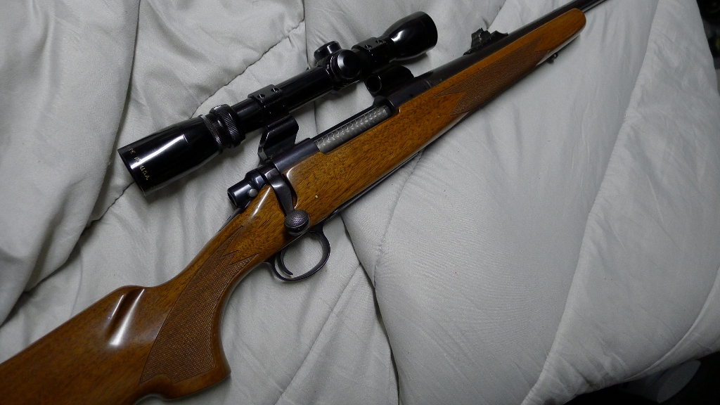

I picked up a Rem 700 in 8mm a few years back for elk but lately have been thinking of dropping it into a AI stock and modding it. However it seems from reading some other threads there is not a lot of target type bullets available for 8mm. Would I be wasting my time?

It's not a very common caliber. It's great for hunting elk, moose, etc., but other options are better suited for tactical type target shooting. If it was me, I would leave it alone. If I had to mess with it, I would rebarrel it in another caliber (e.g., 300 RUM, 300 Win Mag, or 7mm Rem Mag).
I have the same gun, but mine has a broken trigger guard. Great Gun I have a 6mm,7mm,and the 8mm. Ammo is hard to find and costly and there is not much variation on bullet weight. I say keep it stock and wear it out and then rebarrel it

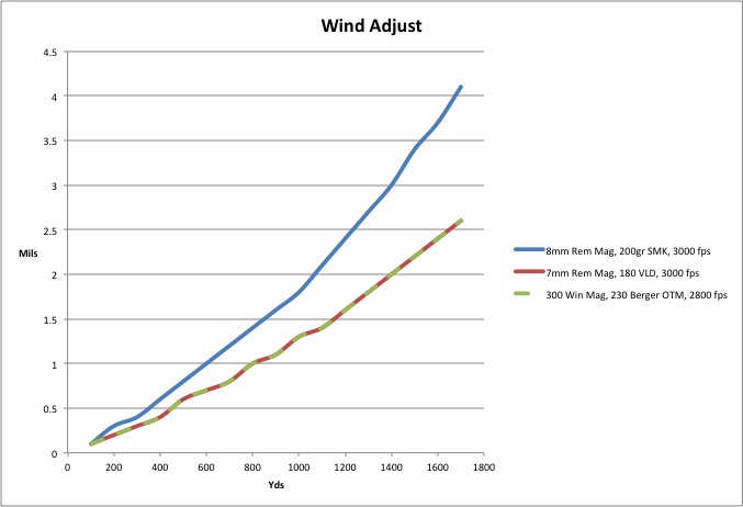

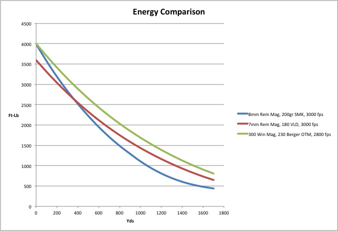

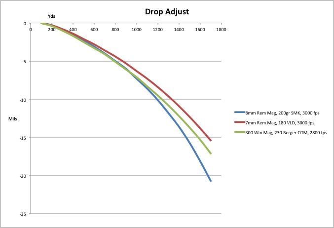

[MENTION=85282]100meterpeter[/MENTION], I'll let you take a look at some ballistics data I crunched and you can decide for yourself.
I assumed the following:
8mm Rem Mag using 200 SMKs at 3000 fps
7mm Rem Mag using 180 Berger VLDs at 3000 fps
300 Win Mag using 230 Berger OTMs at 2800 fps
(All used the same environmental data, but FWIW, I assumed 40% humidity, 40 F, 30mmHG, and 4000 ft)
I ran the numbers to just over a mile (1,700 yds)
Here are the results:
In terms of drop, 7mm is best but the divergence doesn't appreciably start until after 700 yards. The 300 Win Mag begins to outperform the 8mm after 1200 yds. After 1400 yards the 8mm begins to nose dive (5 mils of elevation difference between the 7mm and 8mm at 1700 yards).
In terms of wind, the 300 Win Mag and 7mm computed the exact same results and both outperform the 8mm. The divergence becomes noticeable at ~ 400 yards. At 800 yards, it is 0.5 mils and at 1700 yards it's 1.5 mils.
In terms of impact energy, the 300 Win Mag performs best over the entire range. If we assume that 1500 ft-lbs is needed to take down an elk, then the 800 Rem Mag is good until ~ 600 yards, the 7mm is good until ~ 900 yards, and the 300 Win Mag is good until ~ 1100 yards. The 7mm Rem Mag overtakes the 8mm after ~ 500 yards.
I didn't bother calculating felt recoil, but the 7mm should kick the least (I don't think any of them would feel good when shot from a light rifle).
Overall, the 8mm doesn't perform too badly with a 200 SMK launched at 3000 fps, especially inside 1000 yards. The data probably shows why many choose to utilize either the 7mm or 300 Win Mag if building a rig from the ground up. If you want to drop it in a chassis to make it more fun and enjoyable to shoot, go for it. Looks like George's suggestion of the 200 SMK will definitely get you in the game. When the barrel burns up, I suggest using the 7mm Rem mag with a 180 VLD (at least, that's what I would do).
Hope this helps you decide what to do.

You may want to consider before "modding" what you have. The rifle appears to be in excellent condition as is, there a few rifle loonies out there that covet exactly what you have now.
Might be better to sell it over on the 24hour campfire forums and pick yourself up a donor action if you are desiring a different chambering, I would expect you could sell what you have for $800 to $1,000.
That being said your rifle would be an easy conversion to a 7mm belted mag or the 300 WM.
Btw the 8mm Rem Mag is an absolute elk hammer with the 200 grainers.

The big problem here is not the cartridges capability. The comparison that LCDR gave you isn't really an apples to apples comparison. Then again, it is in the sense that's what you can get in each caliber. The 7mm and .30 cal run pretty close now (albeit the .30 has to add 50 gr. to keep up with the 7mm).
Super high BC bullets aren't made for the 8mm's anymore. Being that a bullet is the final component that is going to buck the wind, an inferior ballistic bullet won't do what a superior ballistic bullet can even if it leaves the muzzle a couple hundred FPS faster.
Another bullet you might try is Sierra's 220 gr. bullet. It has a slightly better BC than the 200 match.
In the end you're not fighting ability, you're fighting availability.

My comparison is to show the OP how these three big magnums stack up against each other more or less "best case." As you rightly say, the handicap the 8mm has is that there isn't much to choose from in the way of high BC bullets. (I've always thought the same for the 270 Win as well). If you're willing to shoot a magnum, 30 cal will always rule the roost in available options and the 8mm will always lose. I can go to any store and buy ammo for 300 Win Mag or 7mm Rem Mag; 8mm is pretty much the providence of hand loaders.
Please don't read me as pooh-poohing this caliber though. I wrote above that it holds it own against the other calibers with superior bullets inside 600 yards. My grandfather absolutely raved about it when he was alive and must have killed about 30 mule deer/elk/caribou/moose with one. As a hunting rifle in the hands of a hand loader, it's a wonderful rifle. For someone that is trying to do more, the 7mm or 300 Win Mag offer more flexibility and performance.
It would be interesting to see how the 8mm could stack up with a better BC bullet, e.g., something 250gr+.
