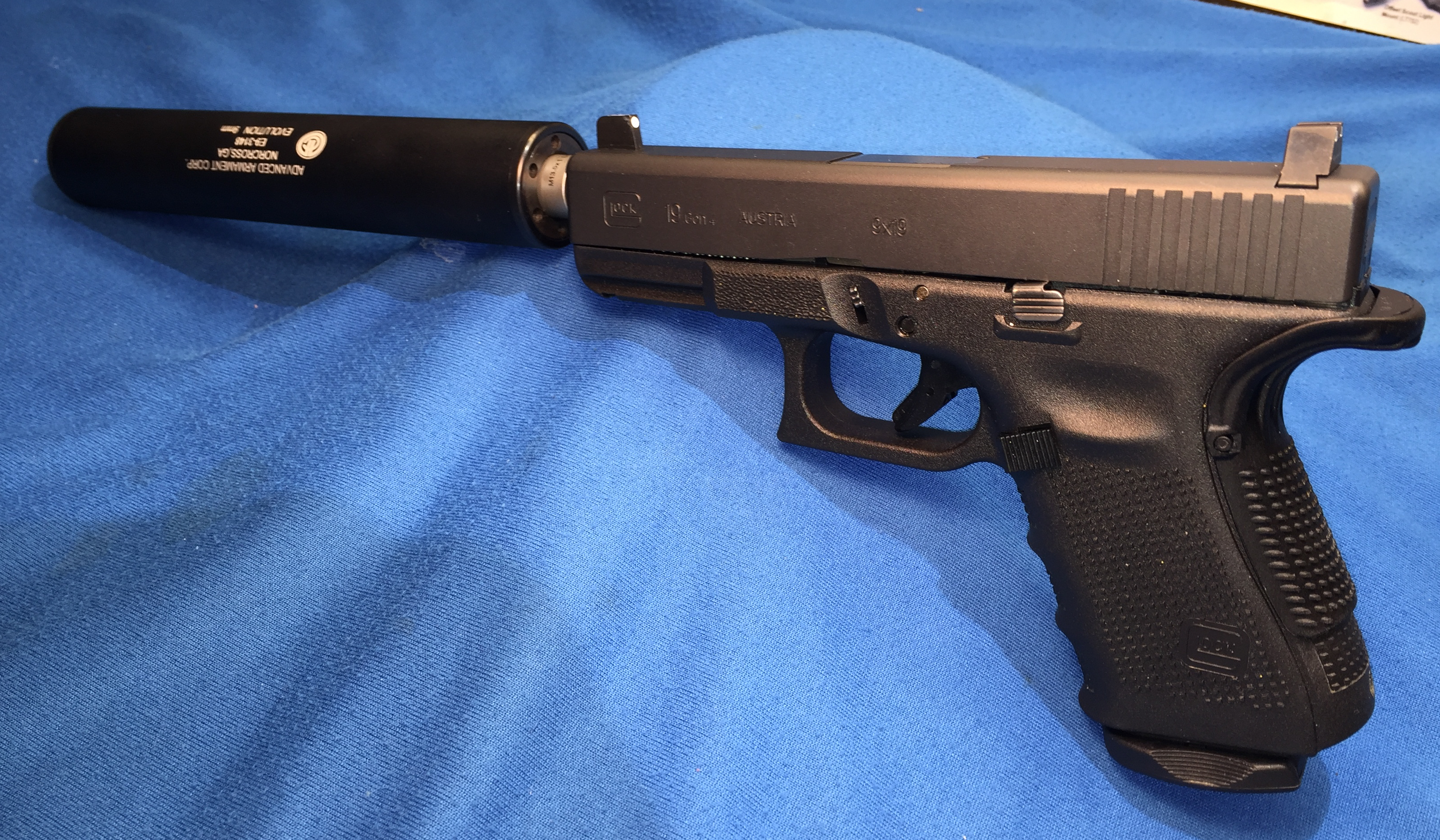

Can the suppressor I use on my Glock, with a piston due to the tilt barrel, be used without problems on my 9mm AR carbine.
Yes but you need to 'disable' the piston spring.

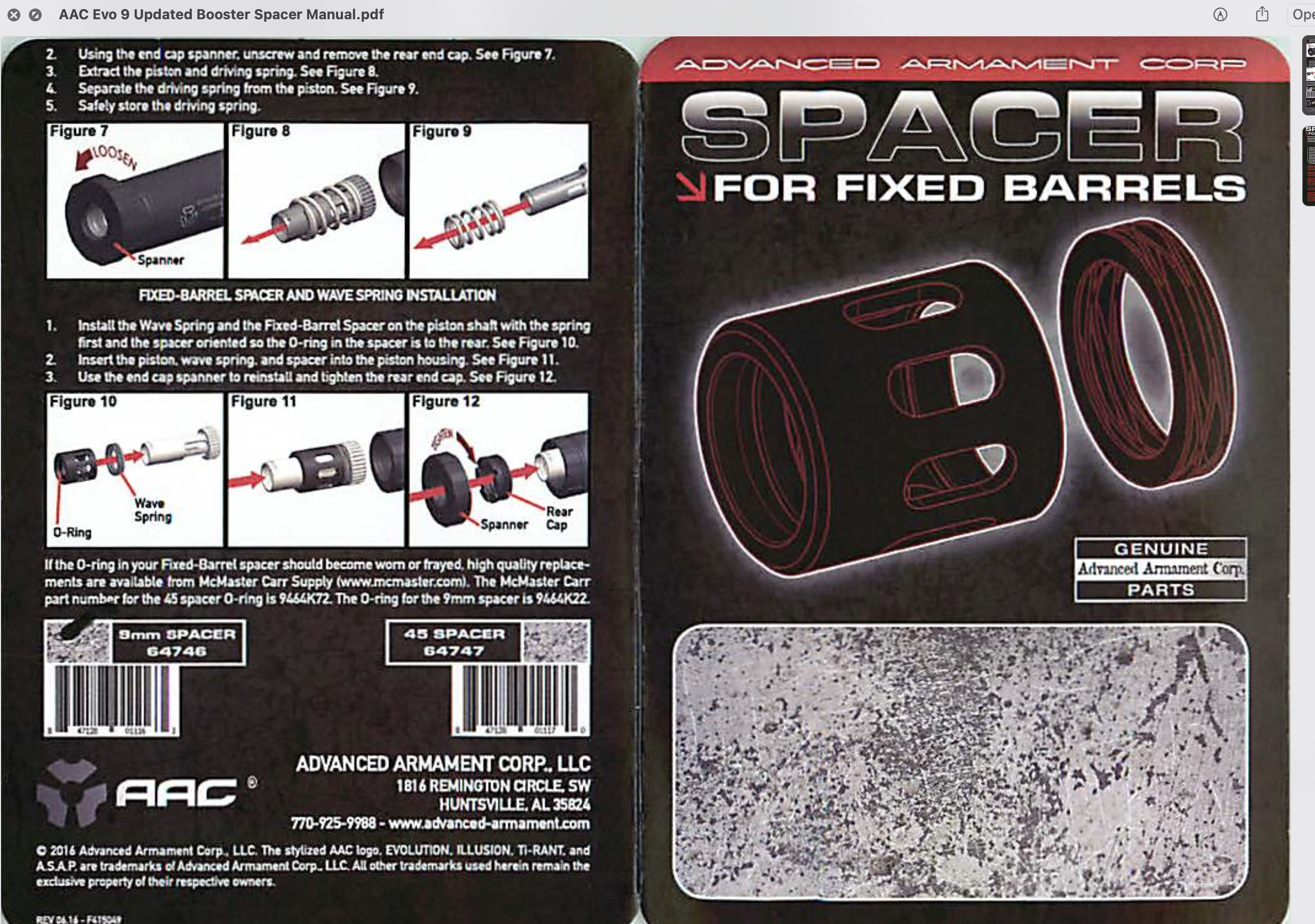

This is done either by replacing the spring with a solid spacer or by taking the booster housing assembly off and replacing it with a fixed mount.
The manufacturer of your suppressor probably makes those parts. At least mine does.

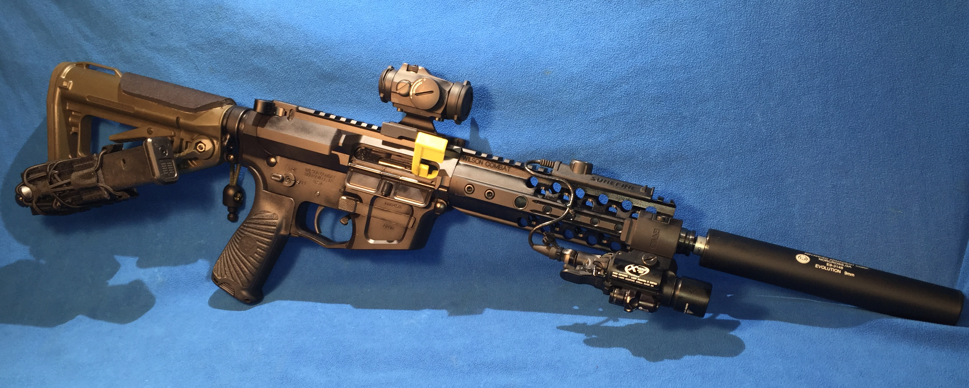

I use this AAC for Glocks and Wilson Combat AR9G (glock mags) SBR.
The fixed spacer installed when the barrel is fixed, replaces the piston spring.
