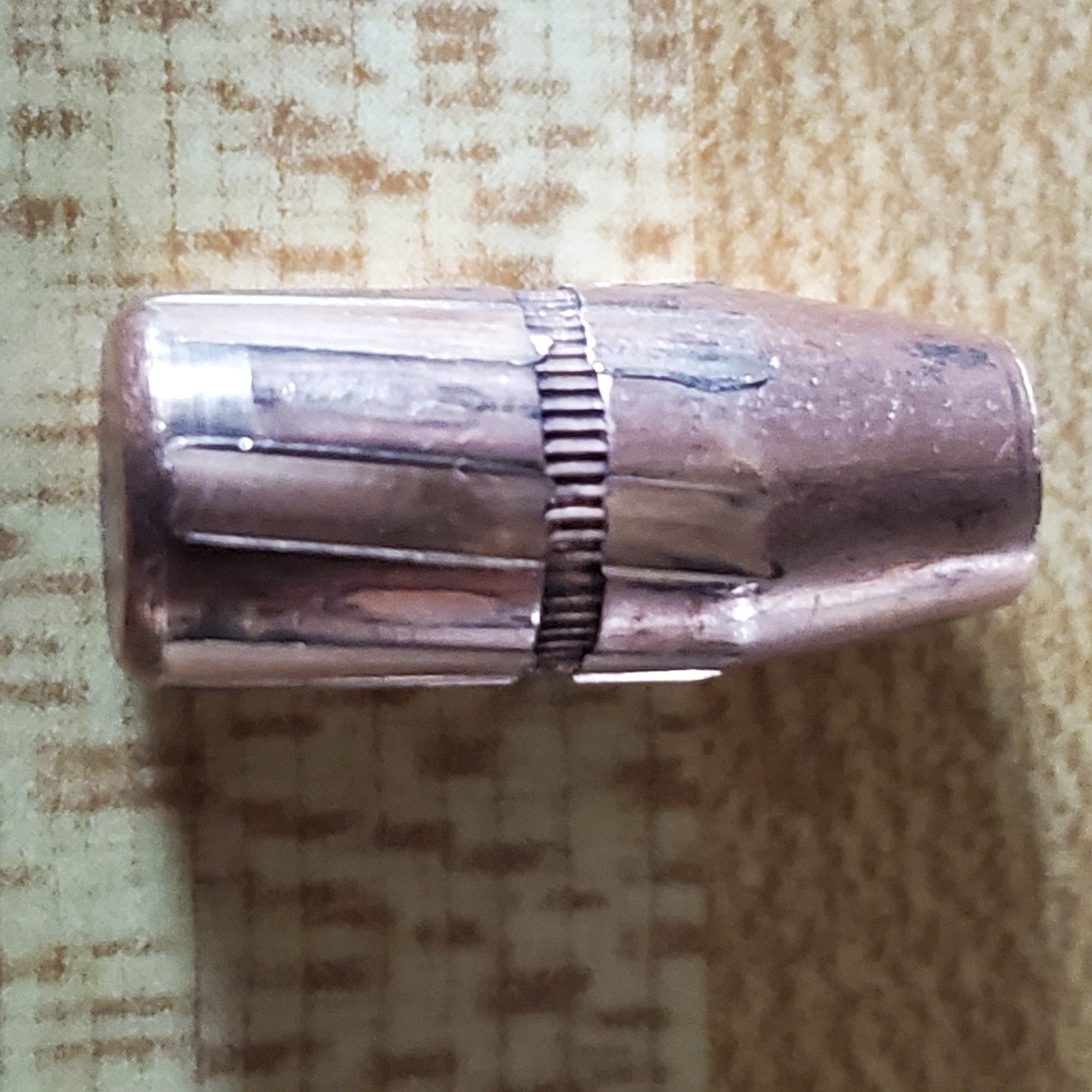

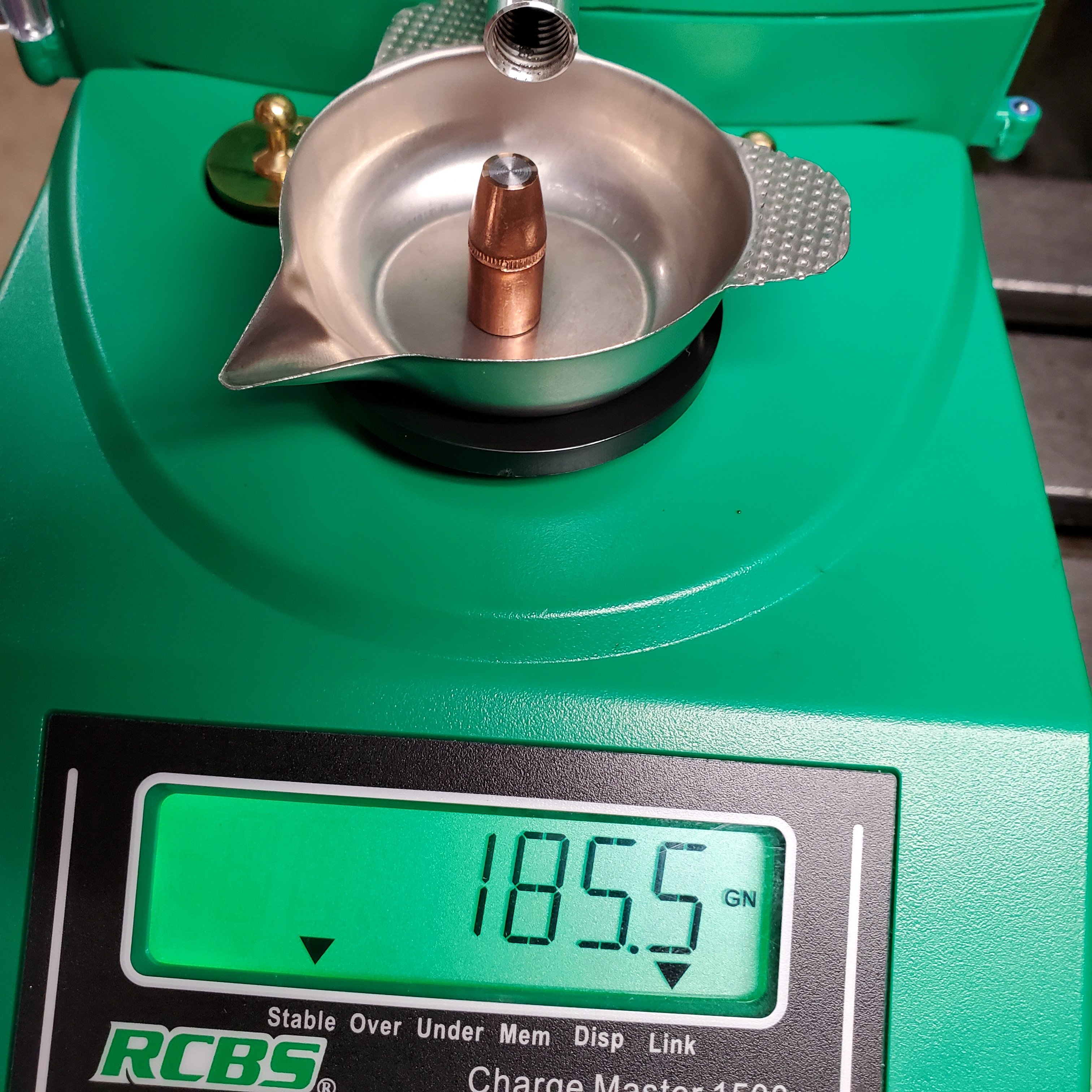

Bullets from 50 gr copper at 2640 fps to 185 gr cut down from 200 gr & resized .358 rifle bullets to .355 dia,
The thick rifle bullet jacket acted like a FMJ so it was not very useful to me.

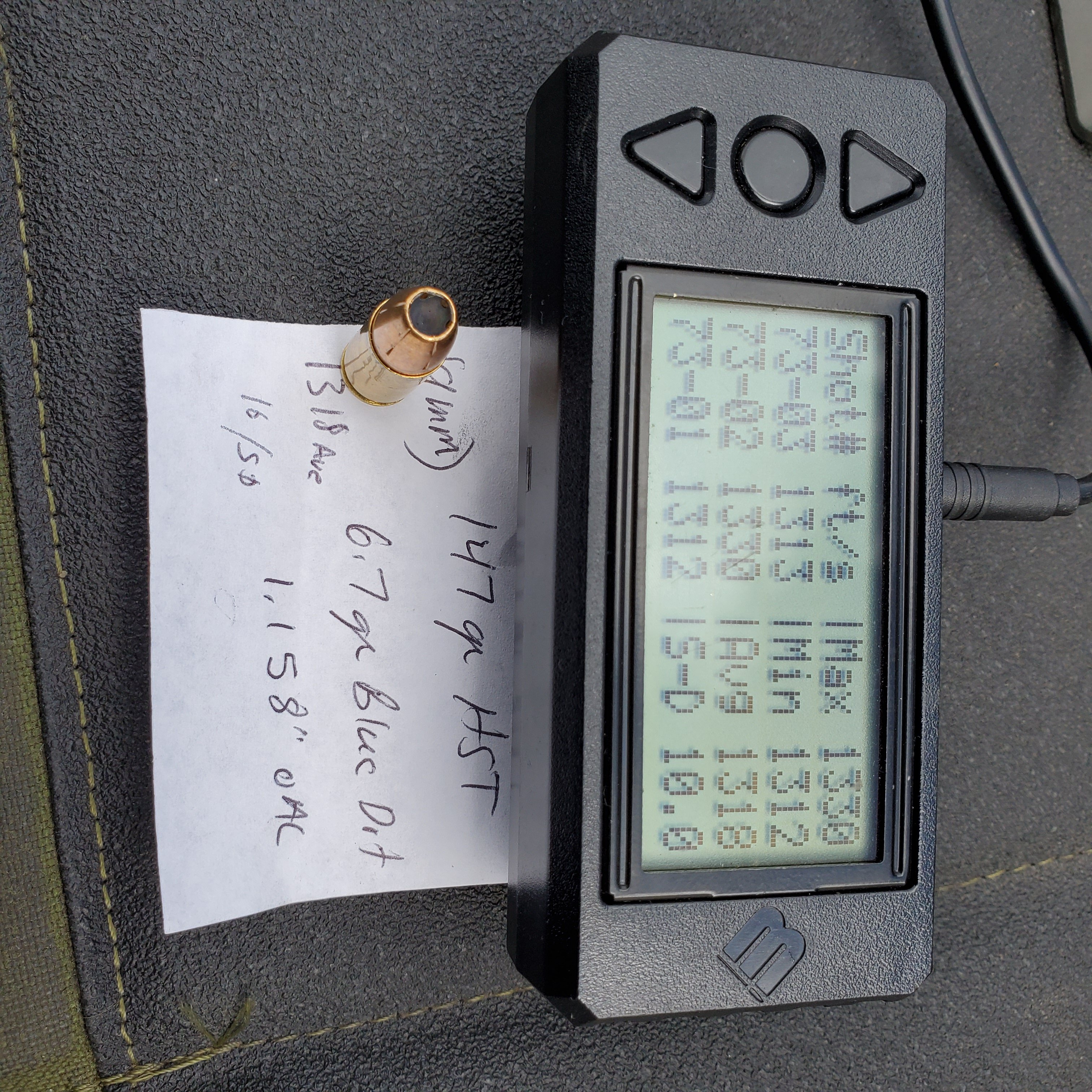

This load was fired on a 10.5" AR 15.
It's a definitely a plus P load and not for use in any other type of firearm, as I have not shot it in any other.
1300 fps with a 147 HST....observe the cartridge overall length ... a small change in COAL can be disastrous in the tiny 9 mm case, as pressures rise ridiculously fast with just a slight change in seating depth.
I would definately Not fire it in my Glock 9 mm pistol.
If you use it, work up and see if it's right for your AR type weapon only.
Use at your own risk.
