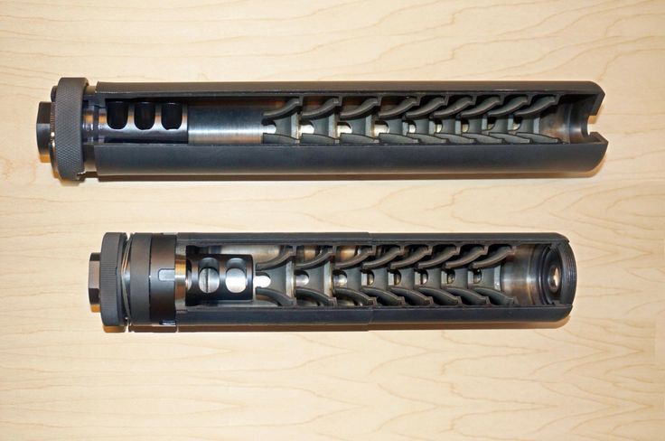

    Hey guys, still in the waiting queue for my form1 to be approved and looking at different designs to see what direction I take this can. Hindsight, probably should've form 4'd a proven design, but that wait was a deterrent. I'll probably get that form 4 started sooner than later. I'm looking to suppress my 300BLK pistol. AR platform, all AERO parts, 8.5" barrel. The suppressor will have to be 8" max length. Looking at the design of the SiCo Saker to base my build off of. I can get the Griffin brake and matching mount to attach the can. I'm reading over at silencertalk and the form1 boards, but my head is spinning a little. Does anyone have any experience with SPC's Pro storage dividers? Should I stick with 60* cones instead? Some say clip, some say don't and if so, what type of clip to use. Sounds like the Pro cups don't have enough material to clip. Can't really call these places and ask suppressor questions because the ATF will kick down all of our doors. I have filed for my Form 1 and haven't purchased any components remotely similar to a suppressor part, and will not until I have an approved tax stamp for that suppressor. Any tips or advice would be greatly appreciated so I don't throw money away.
    cutaway of the SiCo Saker:

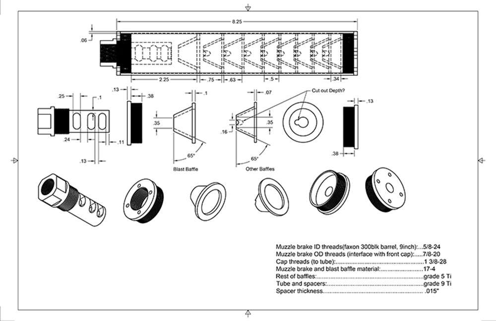

    Another design I found with a google search, not sure whose design this is, but I should be able to build something very close to this, however, I've seen mention of a smaller blast chamber being more effective. Don't know how accurate that is:
