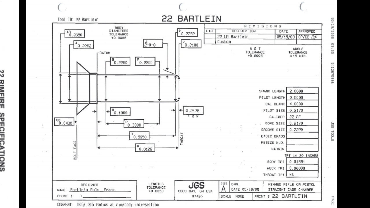

Thanks Chevy Man. I am planning on buying a Bartlein barrel. They have the SAMMI 22lr, match and sporter chambers Benz chambers and a proprietary Bartlein 22 match. As often as I would have to extract an unfired round I frankly am thinking about the Bartlein chamber.
