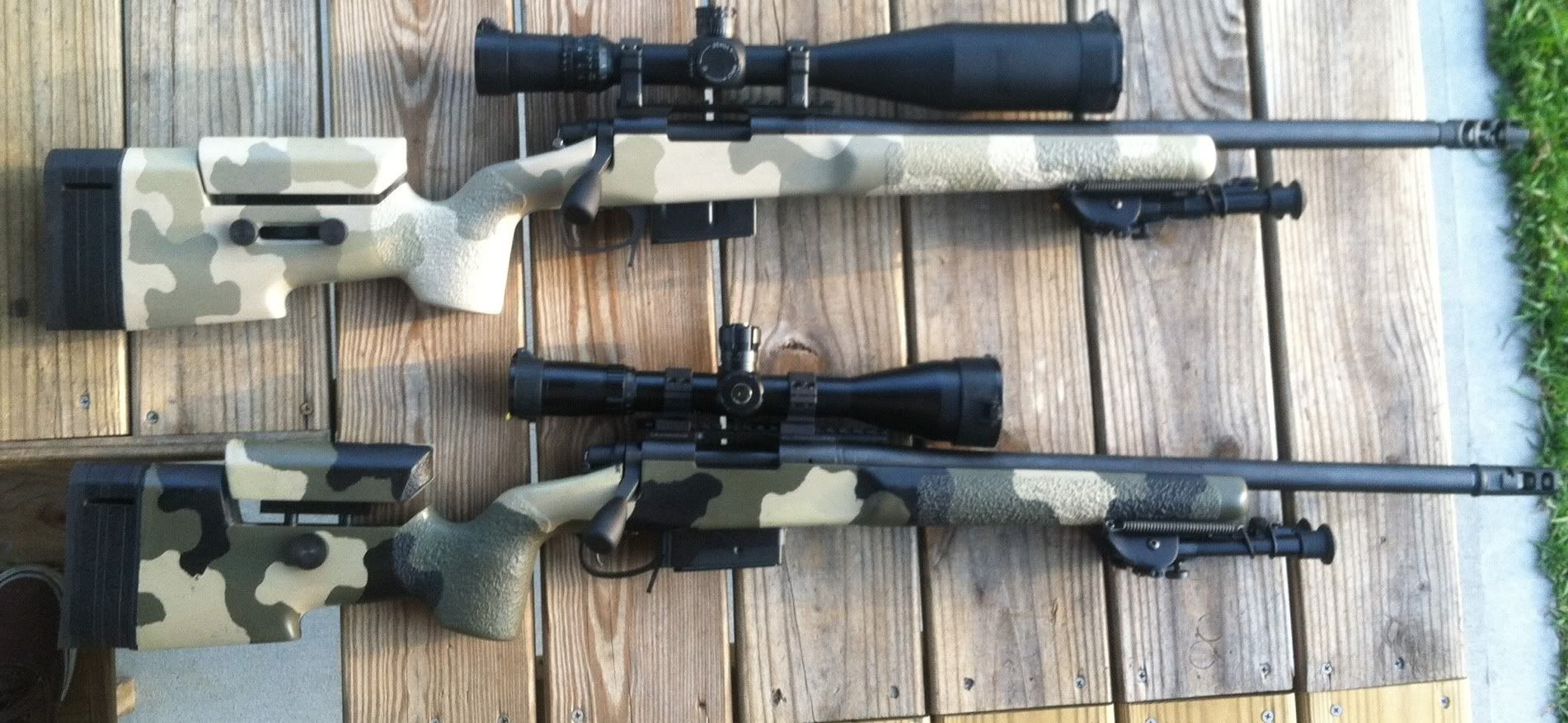

Here are two builds that I think are amazing. I know a few people on here have said that their AAC-SD 700 was not that accurate. Well here are two almost identical AAC-SD's that consistantly shoot 1/2-3/4 moa out to 400 yards (havent had a chance to go out further)The load is 42gr Varget and 168 SMK with Remington or Federal brass.
Also, did a comparison of the MB762 and a PWS FSC30 brake. Muzzle rise, blast, and pressure all seemed the exact same. From the shooter and the spotter. The felt recoil seemed exactly the same also. Here is a little video of the MB762. Never posted a video soI hope it works.

These Two look great , are they both yours or yours and a mates ? I shoot with a mate who has a 5R Rem with some nice mods and we both just laugh at the incredible groups they are shooting , yours looks a bit snazyer then ours though with the Mag kits and the adjustable stock , what brand of mag set do you have under them ?
This is my AAC-SD its a basic Build up from the Barrel/Action a HS Presision stock a Custom Break and a Rifle Basix trigger at 10oz with a spash of FDE , and SHAZAM !!!!! A ONE HOLE SHOOTER
Mine is the Gap camo one. My brother in law owns the desert one. He has Badger M5 DBM and I have the Stockys M5 DBM. Both are almost identical and have the same footprint and take AI mags. Only real difference is the extended mag well on the stockys M5. I like it better personally, it help's guide the new mag in a little better for me when prone and not wanting to move your face from the rifle. But they both are amazing. I would highly reccomend either one
