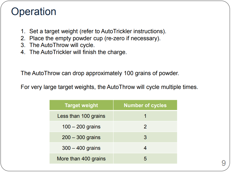

    I'm now loading for .375 Cheytac. My charge weight is 132 grains. How are you guys loading for the super magnums throwing these big loads? The only way I can get it to work is throw and trickle two charges of 66 grains. Am I missing something, or is this how it has to be done?

    Have you tried scooping your powder with a teaspoon or something? Or the Lee Powder Scoops. If the Lee Powder dispenser can't handle loads that big you're basically stuck throwing them manually and letting the unit trickle up.
    I haven't tried but I think the auto throw can throw two (or more) smaller charges and then trickle up to 132.
    It will throw twice in one operation? I guess thats why it pauses for that brief second? To see if its possible to double up the thrown weight without going over?
    Edit: Son of a well would you look at that. http://www.autotrickler.com/uploads/6/3/4/4/63444023/printable_a_d_throw.pdf
    Set it to throw two 65 gr dumps and trickle the rest and youre golden.
