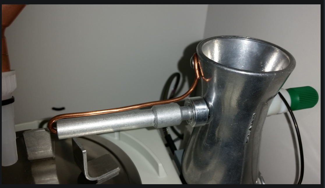

I have a A419 base so i set it so as the powder has to go "uphill". it'll still overthrow sometimes, but not as bad. there's another thread, where one fella put a copper wire on the trickler and ran it towards the end of the trickler tube. the copper wire is bent back "U-Turn" in to the tube hole...this is suppose to help de-clump the powder.
