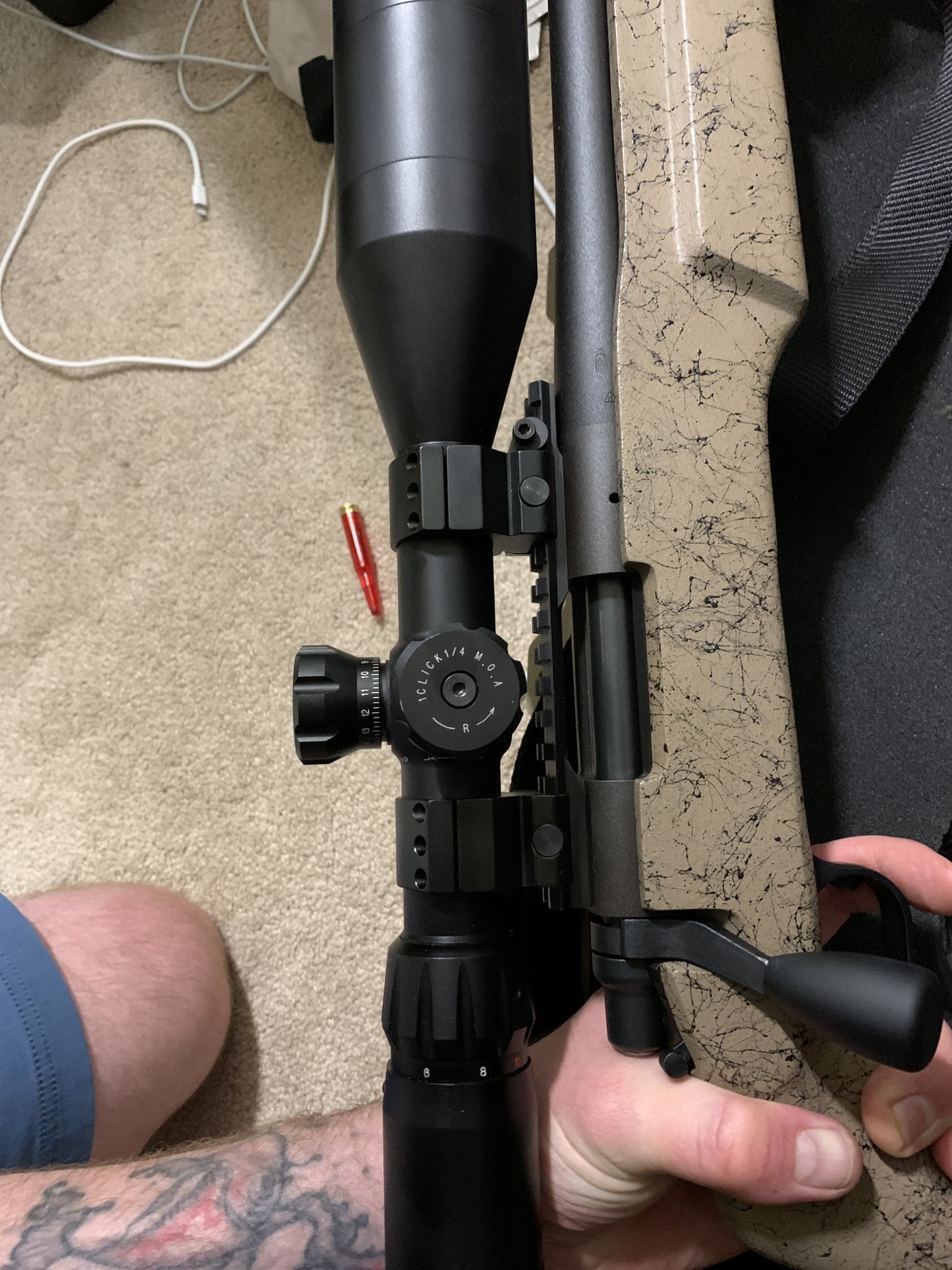

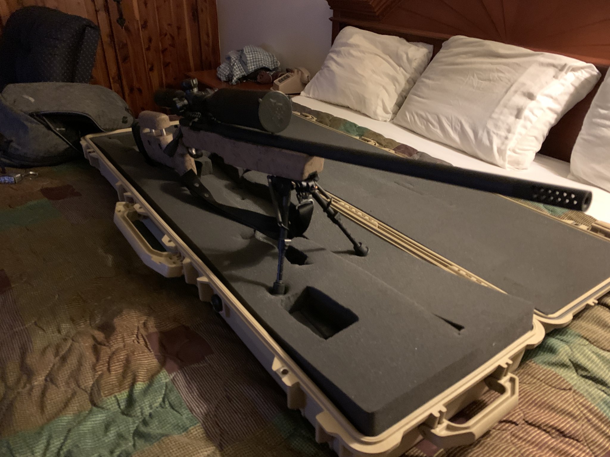

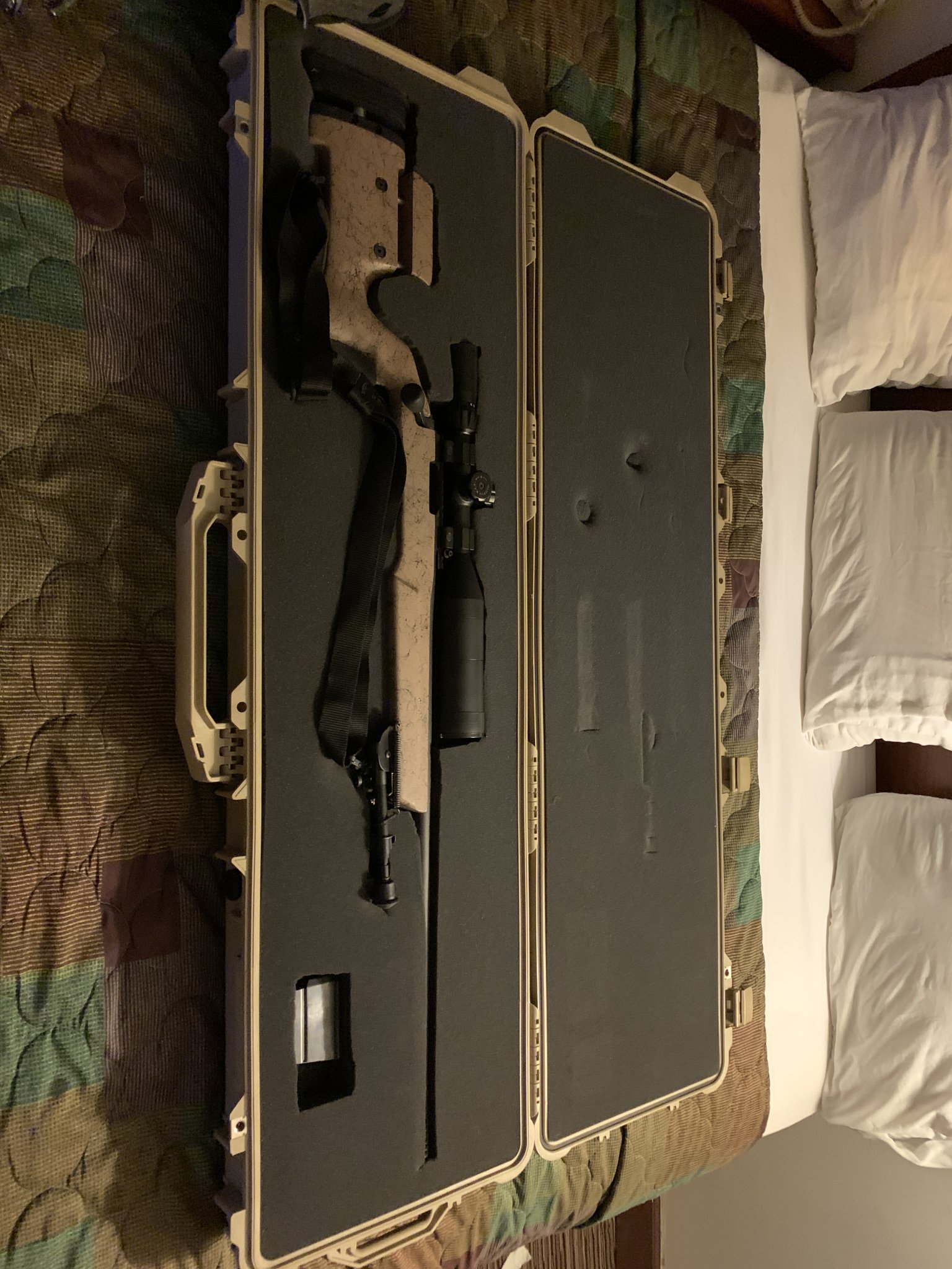

Good morning all,
The post title says “NEW GUN” but it’s only new to me. It was assembled for a law enforcement unit three years ago and sold at a police auction when the unit was downsized.
I am entirely new to this forum and this is my first forum post. I used to shoot years ago and put it down for school and jobs and sports. Now that I have an established career with some flexibility, I am picking it back up. To do that I have purchased a heavily customized Remington 700 from a dealer who purchased it from a law enforcement unit out of OR. I have also signed up for a two day course in June where I will be taught more about ballistics, use of a ballistics computer, proper use of a shot log book, zeroing at different yardages, engagement of targets out to 1320yards, etc etc. Two 10 hour days of shooting back to back. Over 100 rounds a day during the course.
Now for the reason I am posting, I am having a hard time identifying a lot of the gear on this rifle. There are not any branding visible on the optic except for a serial number on the bottom which when entered into google gets me absolutely zero hits. The bipod has no branding. Nothing has a manufacturer’s label anywhere on it except the barrel stamped with Remington 700 .308.
I have taken it to some gun smiths and shops in VA and they don’t have any idea or the time to really search it out. I am wondering if it might be possible to post some pictures of this piece and gather information on what the components are.
What I know:
The mag and trigger guard assembly are from Wyatt’s Outdoor Inc in OR. Figuring that out took me weeks and a few $100 of incorrect mags because retailers on line seem hell bent on not providing critical dimensions for their offerings.. Maddening process but completed. You’ll see why this was a pain in the ass in the photos, it’s a tactical assembly with a proprietary (from what i can tell) mag profile and design.
The stock has been fiberglass packed.
The rifle was professionally assembled and was touted as 1/4 MOA.
It was used for certifications and continued education by the SWAT team who owned it before me but was only used once a year for a few days in this capacity.
Scope is incredibly powerful, has glowing cross hairs (green/red) that run on a small battery that i cant figure out how to access, a reflection screen, and bubble level.
If anyone is willing to help me figure out some of these unknowns it will help me a great deal in operation and proper use/maintenance of this weapon. I also need to know more about the scope specifically before the 13th of June so that I can hopefully get my hands on a manual somewhere before the class.
Much appreciated.
EG

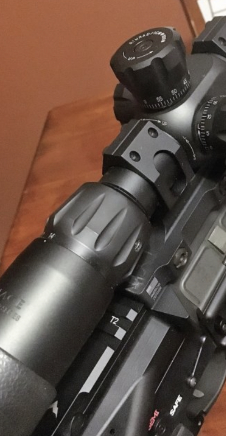

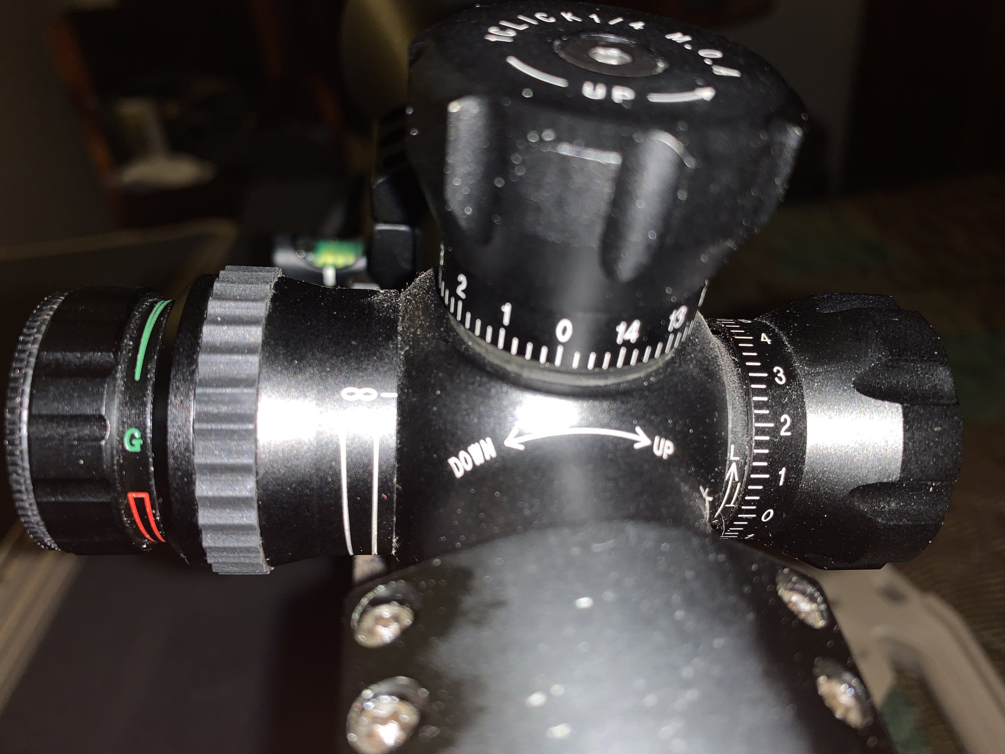

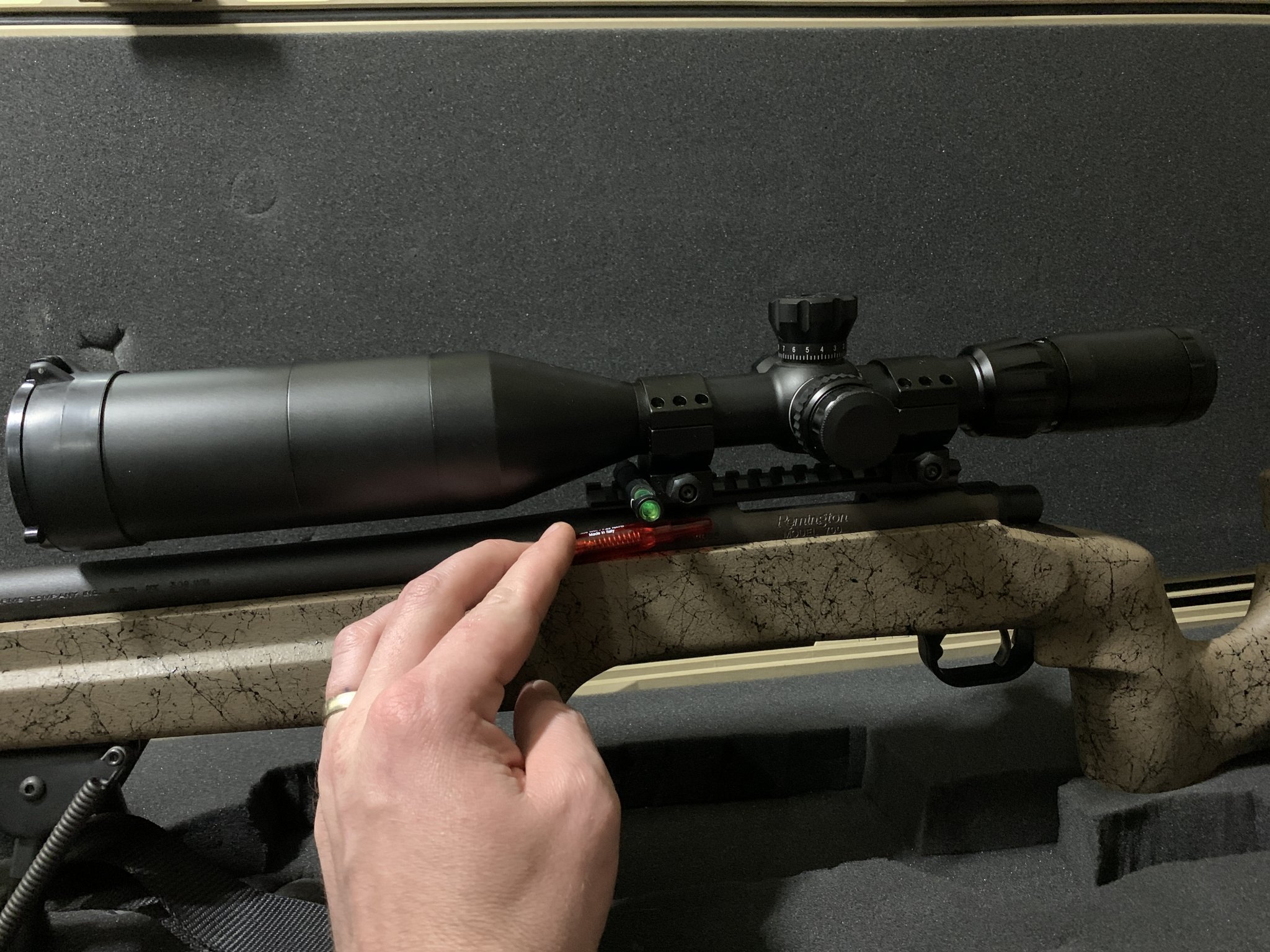

Is there a logo on the battery cap on the left side of the scope that controls parallax?
(My guess since there is no obvious branding its a cheap sub $200 scope.)
I’m a little surprised at the optic one there, would of thought a LE rifle would have better glass unless they pulled the good stuff before it went out the door.
As mentioned above, stock looks to be a bell and carlson.
Aside from that is hard to be very certain of any more specifics from the photos.
A suggestion to the op, if the class you are preparing for has much value to you, (cost or time) get a better quality bipod, and at least zero another scope for your rifle and bring it with you.
a Harris Sbrm bipod Can be found for around 100.00 and is a solid bipod to get going. For a back up or new primary scope a swfa fixed 10 or 12x should be around 300.00 and will at least be dead reliable.

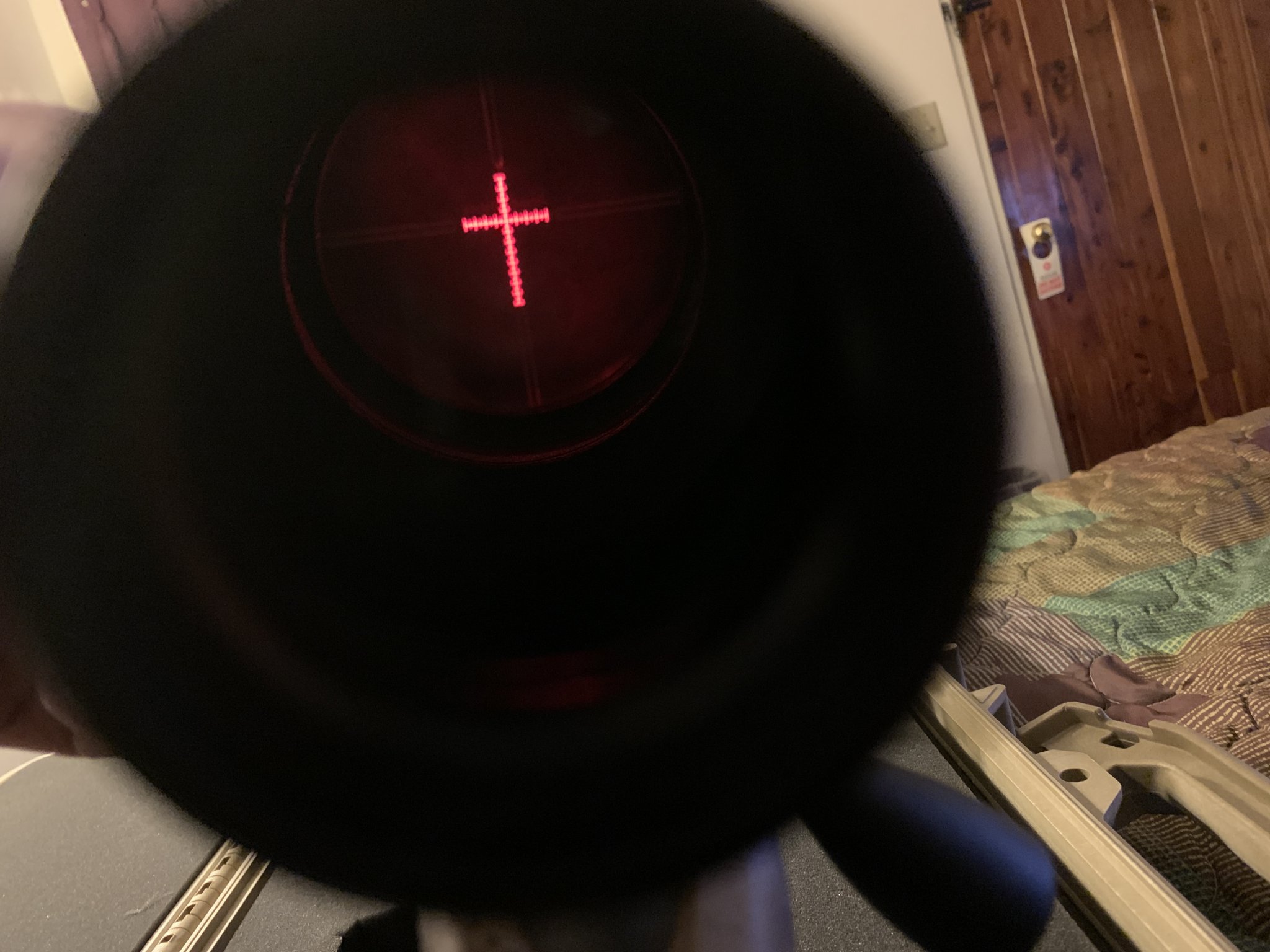

That's great advice from 264win. I cannot think of a quality scope with a illuminated reticle that switches between red and green. Lack of any branding seems to point to an incredibly cheap scope.
We aren't saying you have a bad rifle. As long as the barreled action fits in the stock like it should, and the barrel is good. The optic/rings and bipod are what we are most concerned about.

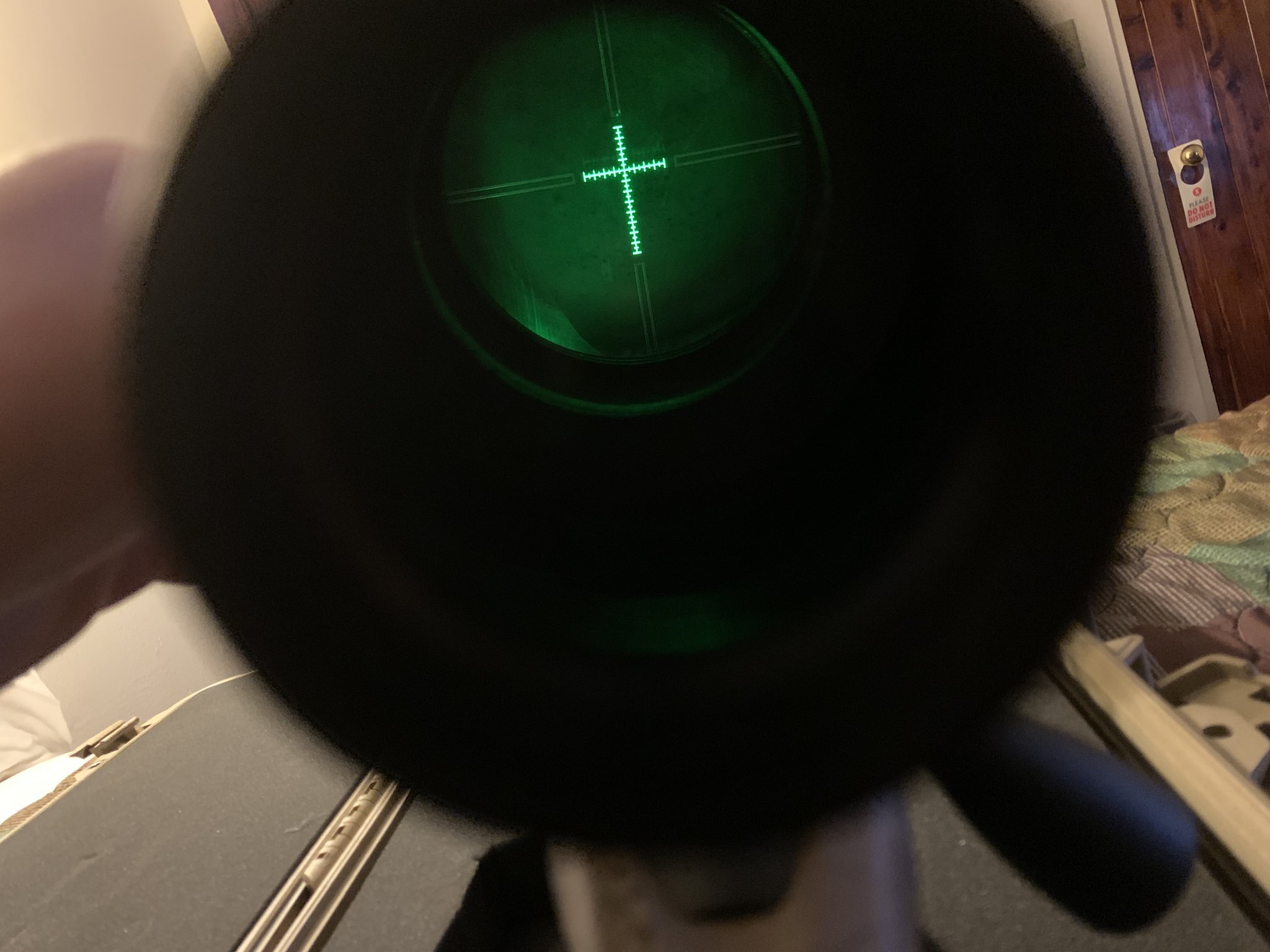

Downtown is right about red/green illumination. It's either found in cheap scopes, or really high end. Not really a thing in moderately priced scopes in the $450-$1200 range. Those are all usually red.

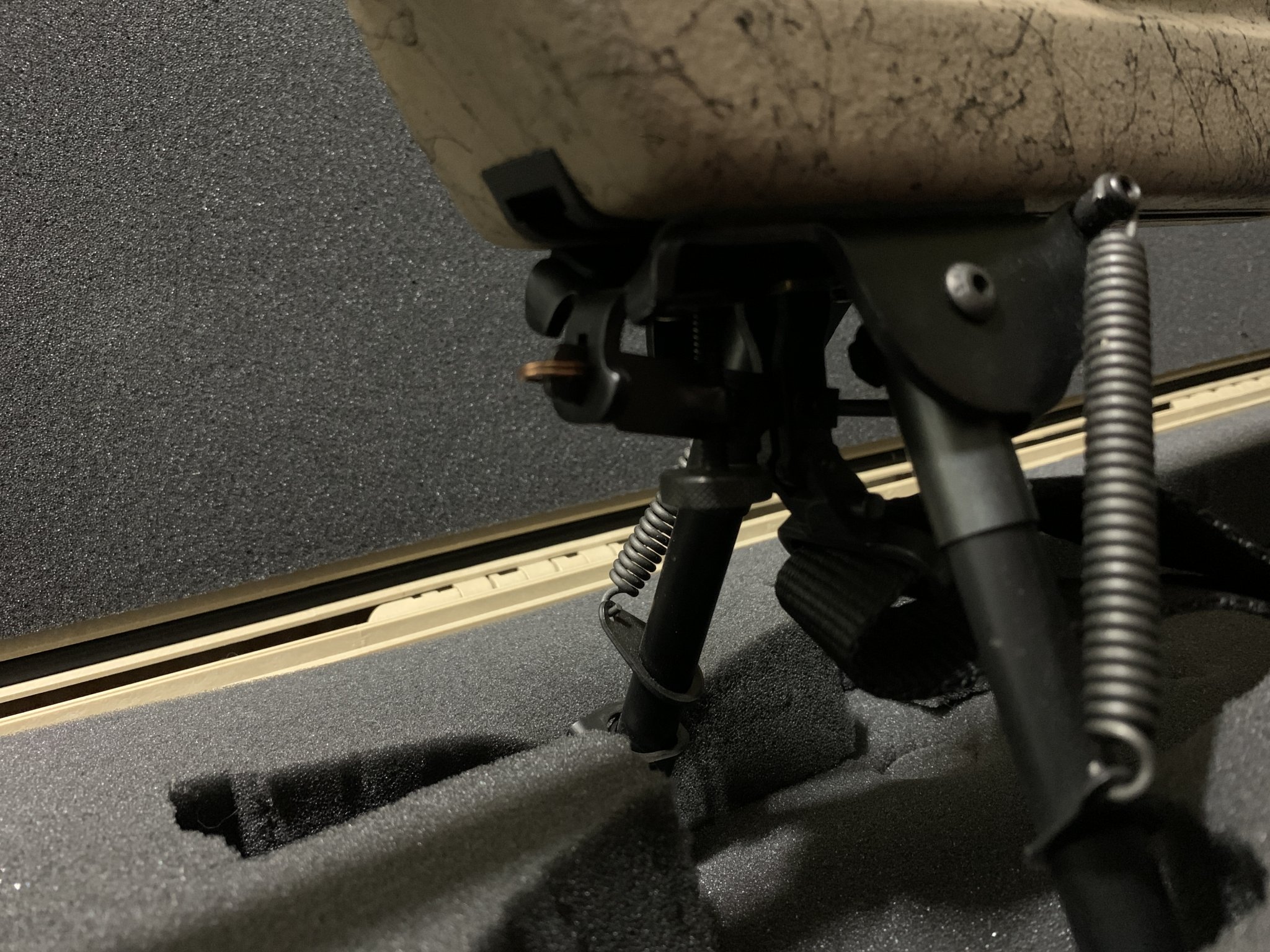

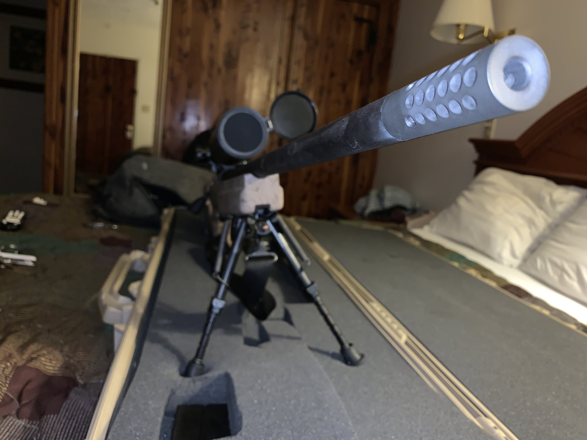

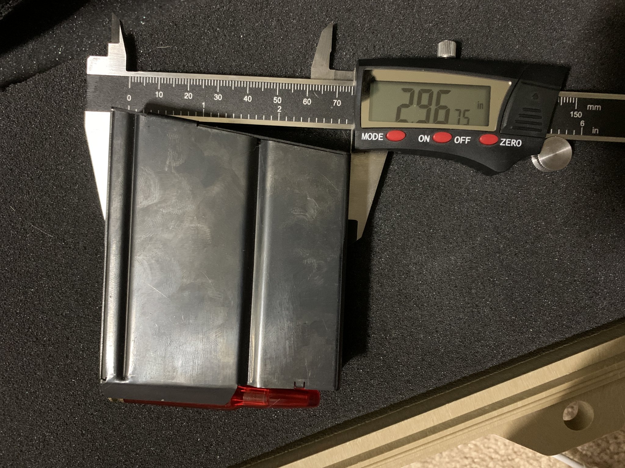

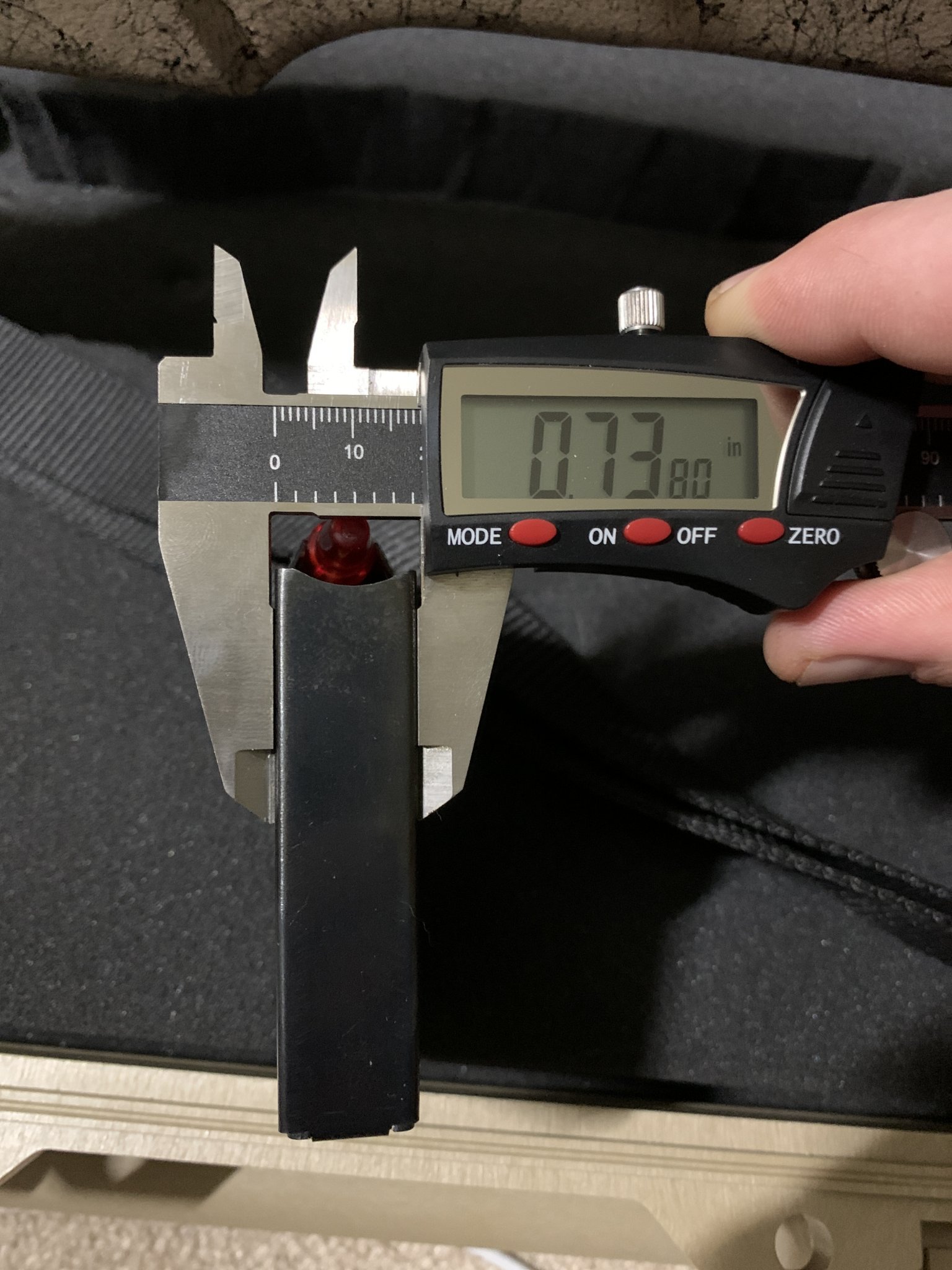

Please post some better detail pictures of the bipod. Also, what mags did you end up having to buy to fit that bottom metal?
Interesting input I received today. Thank you all for your comments. Gives me much to think about. As most of the comments were negatively positioned, I’m feeling pretty discouraged about what was not a cheap purchase from a previously trusted source.. Really disappointed with the general regard of this thing... Maybe some more information will help?

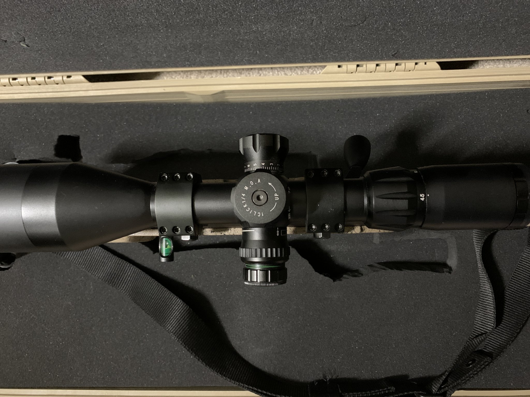

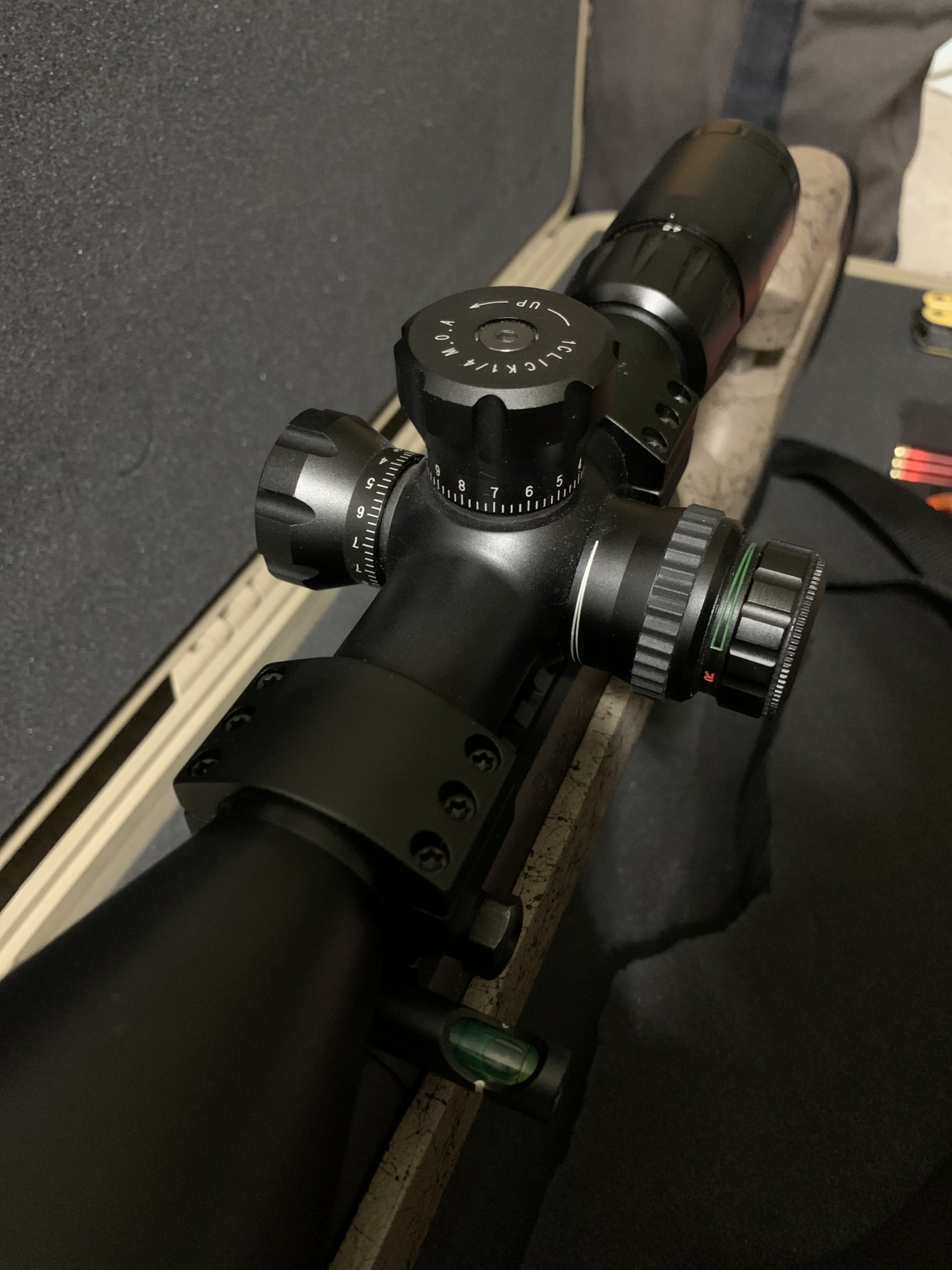

Attached are a few photos in more detail that might help with figuring this thing out.
Took a few improved shots of the scope (which I assure you is not cheap.. it just rings of it but I could be wrong I guess) and some detailed shots of the mag. Was able to purchase more of them yesterday and should be all set for the class. That’s an odd one though. Had a REALLY hard time narrowing that down.

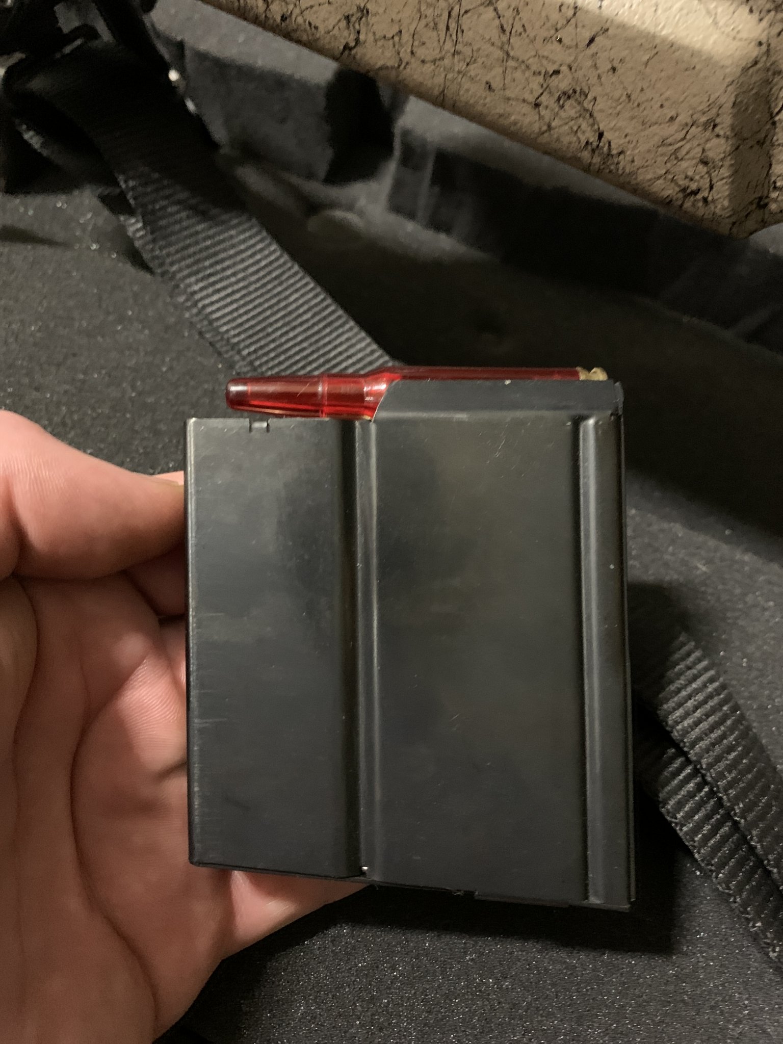

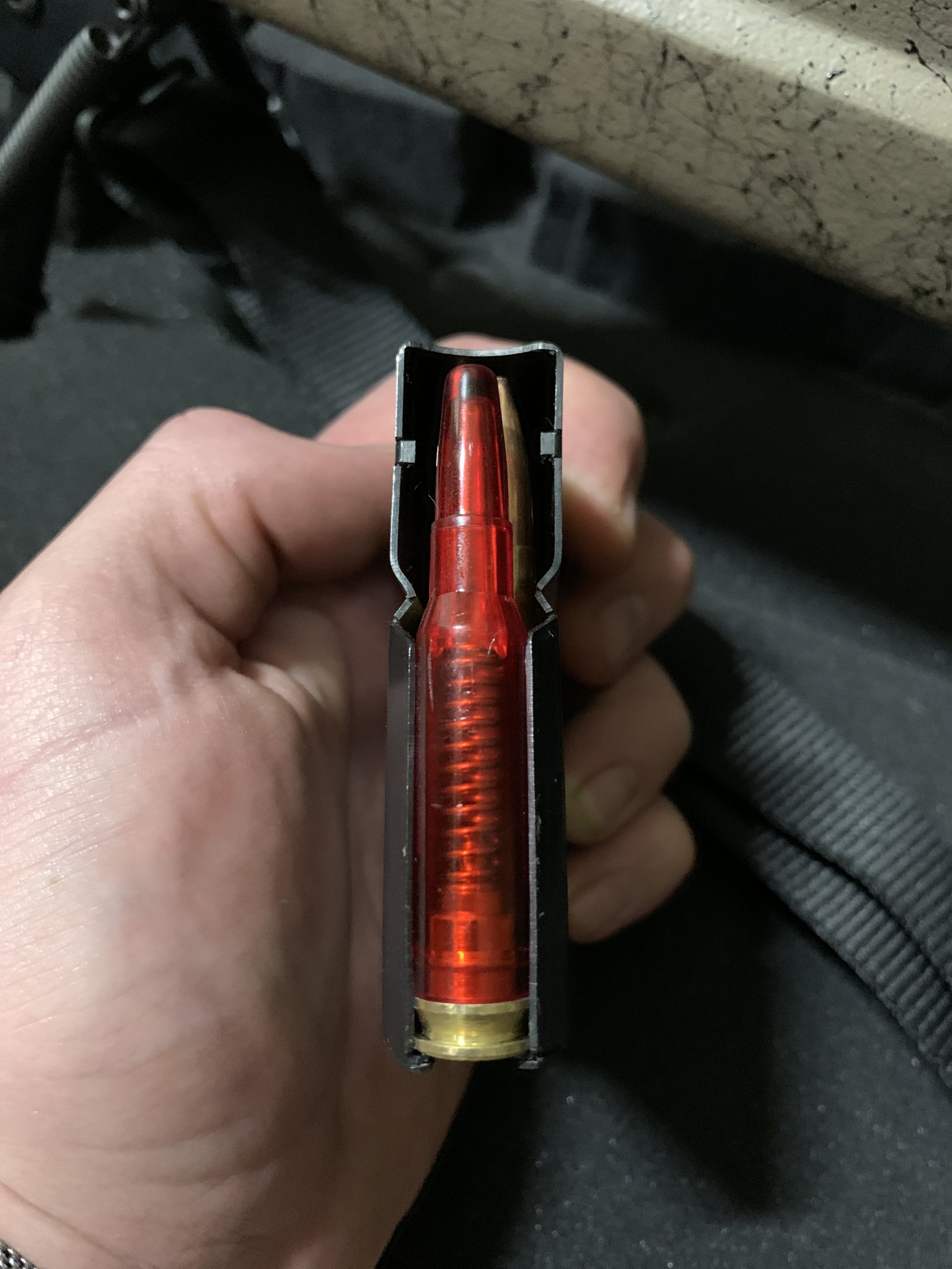

What brand are those mags?

It’s definitely a falcon scope. Now that I have the brand narrowed down I’m trying to figure out the model. It has more features than the one previously mentioned (YouTube has its flaws but is still a boon as a resource) which I haven’t been able to find yet.

The mags are by Wyatts Outdoor INC and are like nothing else. They are not AICS or any other variant. They’re single stack, extremely low profile and dense. There’s no movement of rounds inside them at all but somehow they feed perfectly and the mags are metal. Which is its inherent flaws but so far, chambering a round is like as effortless as buttering toast.

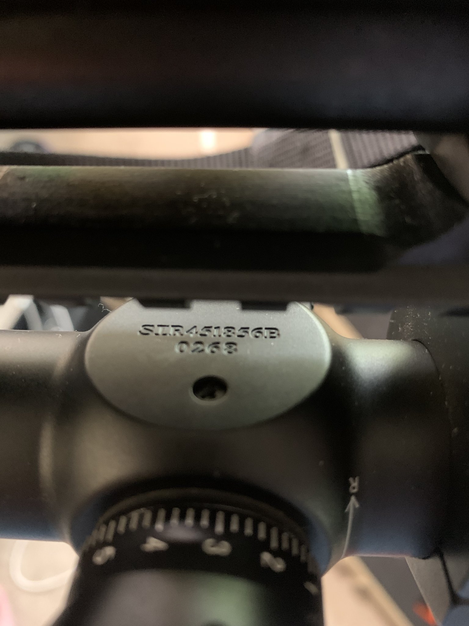

Can you see any stamping or marking on the bottom of the scope just above the ejection port?
What's the magnification range on the scope? Looks like 4.5 to something.i think i see a red 10 on there so I'm guessing this is a second focal plane scope? Also what is the scope tube diameter and objective diameter? That should help narrow you down on what the scope is
Excellent ideas. It is a second focal plane. I know it’s a Falcon. Zoom goes to 18. Tube diameter is 1.176”. Objective diameter is 2.521”.

Found out what that number is on the bottom of the scope 451856.... 4.5-18 56mm objective.. No clue what the sir or b is.the 4 digit under is the serial for that model. Does look like an old falcon menace from the videos and an old snipers hide post from 2008. Might be worth contacting them for info
That’s excellent information! I’ll email them now. You rock man. Thank you. I’ve been fighting that for weeks and just kept going down the wrong turn I guess. Many high fives! Thank you!
So it appears to be a Falcon Menace 4.5-18x56IR. Not a knockoff but their budget option for the LE market. Which would also explain the lack of branding elsewhere. Most things sold to the LE community are not branded when it comes to accessories for say, a sniper rifle. At least that’s what someone on another forum posted.. I emailed falcon about this and we will see what they say.
Go to the falcon optics site.. The b in that number is the reticle..they call it the b 20 or something. Look for the M18 user manual.. It's not your exact scope obviously but it's very close and can explain the reticle gradients, battery replacement, and all that stuff you might want info on. Just realize the m18 is first focal plane and yours is second so your reticle is only going to be true on 10 power i think. See if the 10 is the odd number out.. None of the other numbers have a dot over them, all the other numbers are white and 10 is the only red.. Should mean 10x is where your reticle works without extra complex math.
The slr might be skeleton long range. Go to the site below.
Thank you. Yes the the 10is red. I will follow this through. I really appreciate this.

Bipod looks like a Harris or knockoff.. Maybe a utg or caldwell. Does it hangs any making at all on the bipod? Stock maybe a bell and Carlson?

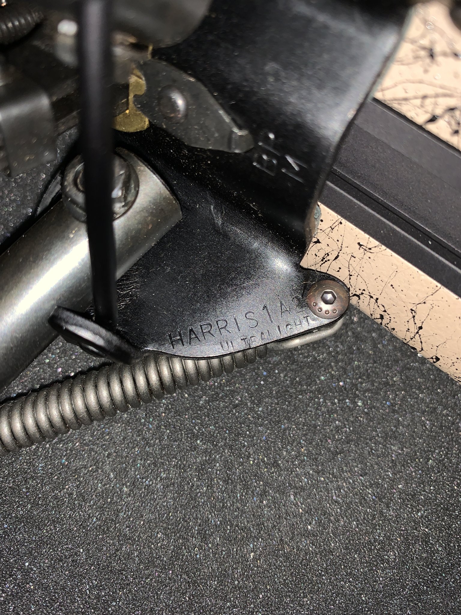

Here are some more pics of the bipod. Didn’t see this before and it says Harris on it. Searching now.

Guess that’s solved. ~$70-90 bipod depending where you go. Never saw the markings until the camera flashed them out. Sorry guys.. not very good of me.

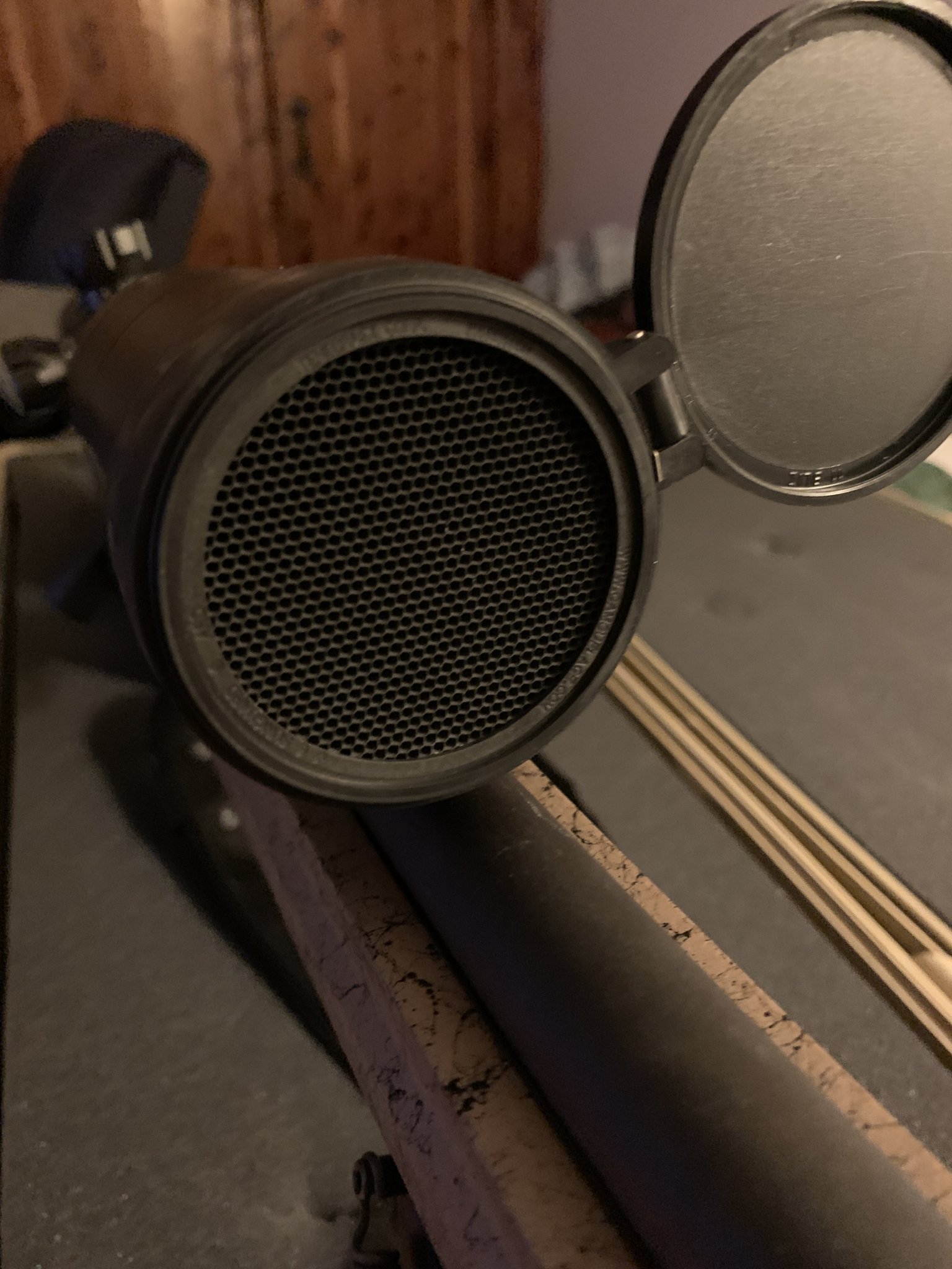

Did you ever pull off the sunshade? Some scopes etch their data on the inside of the bell.
I thought that it looked like a Harris, which is why I suggested a closer look. That’s good news for you. This is not the SBRM that many here use, which just means that it doesn’t adjust for rifle cant (Swivel) on uneven surfaces. Ultimately, if you get really sucked into long range shooting, you will upgrade to something else, but this will get you started.
My thoughts on the scope: the reticle is fine for now and will do until you have an idea of what different you might want. Many people have shot the crap out of long range targets using this same type of reticle with 1/2 mil hash marks. One thing that you’ll find out is that there are all kinds of reticles and all kinds of people who think that only the one that they like is any good.
There are things that make some reticles more useful for different uses, but it takes a little time to find out what you find more useful for your purposes. You’ll find out that for everyone that hates a specific reticle, there is another that likes that same one. It’s one of the reasons that the optics section is filled with so many threads wherein people argue about why one reticle is better than another. It does make for entertaining reading though.

@ElbanGold
There is something that concerns me about your scope which would send me to go get another one and use your Falcon as the back up. Is your reticle in Mils or MOA? Your turrets are MOA. I read something on your scope a few minutes ago that stated that it had moa turrets and a mil reticle. Me being relatively new to long range shooting this would present a math problem for me. Just something to think about and research. I’ll try to find the link.
If what Jaron said is true, you are going to be an irritated student, with a silently agravated instuctor, who may or may not use your scope as a lesson of what not to do.
Reason being, you use your reticle to measure your impact to make a correction, and it's in mils, you then needs to do math and convert that to MOA.
Where if it was in MIL/MIL or MOA/MOA (Reticle/Turrets) you just measure say 12 mils, and move 12 clicks. But now, you needs to figure out how many clicks in MOA is 12 mils.
MOA is converted to Mils by dividing it by 3.43.
Mils is converted to MOA by multiplying by 3.43
Reactions: lash
Something else to think about: 10x, which is where your reticle works, might not be enough magnification for 1320 yards. If I were you I’d be getting a FFP mil/mil scope tomorrow. Bass Pro should have some good options for you.
That’s an extra step that requires a calculator, at least for me it does, that will only lead to frustration for a newer shooter on the firing line being instructed. What if he has a spotter calling out his corrections. It just seems like it could turn into a bad experience.
Reactions: Ravenworks
12 clicks don’t equal 12 mils just saying
