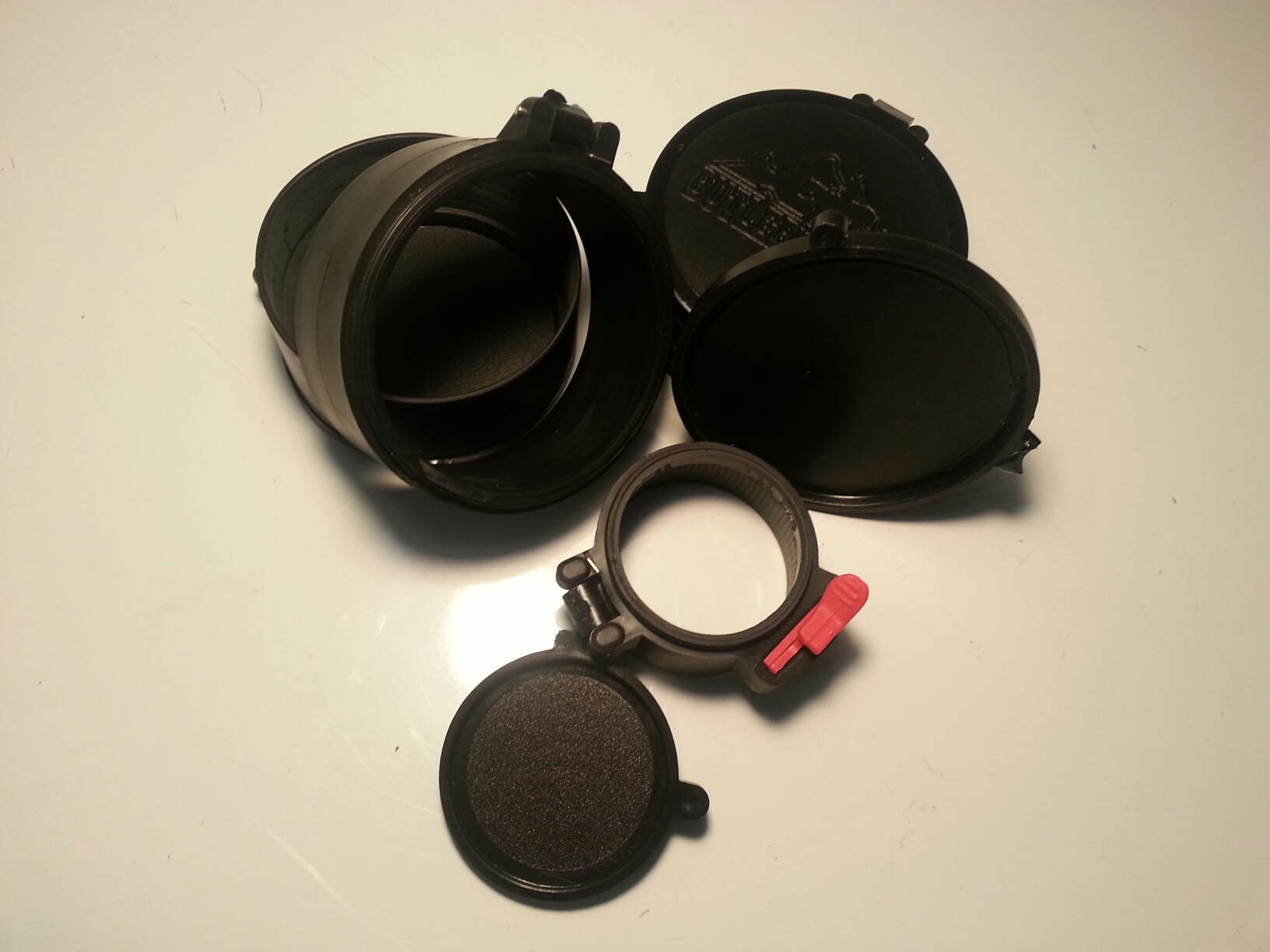

SO why not just use B&C's? After all they are cheaper. Because in the photo below there are a multitude of broken B&C's. This is just for the last six months, and does not include three eyepiece caps that got tossed in the field. Now I have gone through three eye piece and two objectives in six months, so that is $40 and lets say $10 for shipping so $50 in blown flip caps or about the cost of a objective for a set of AADMOUNT's and the AADMOUNT's have a life time warranty.

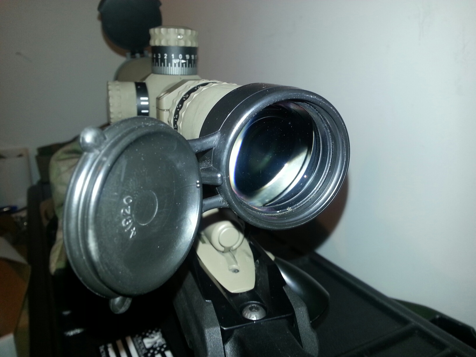

After the last eyepiece broke I ordered one of the new B&C tactical caps. It is more sturdy but a much softer plastic and I had a new set of issues. First the plastic does not like to stay closed all the time and pops open on its own. Next is that it does not flip and retract out of the way. When you rotate the power ring the ocular end rotates too, NightForce scopes 101 I know, but the B&C stays in the way. Not a huge hassle but not perfect. Photo two shows the tactical and how it folds. This was actually how it was when I took it out of the case, it just popped open as it tends to do.

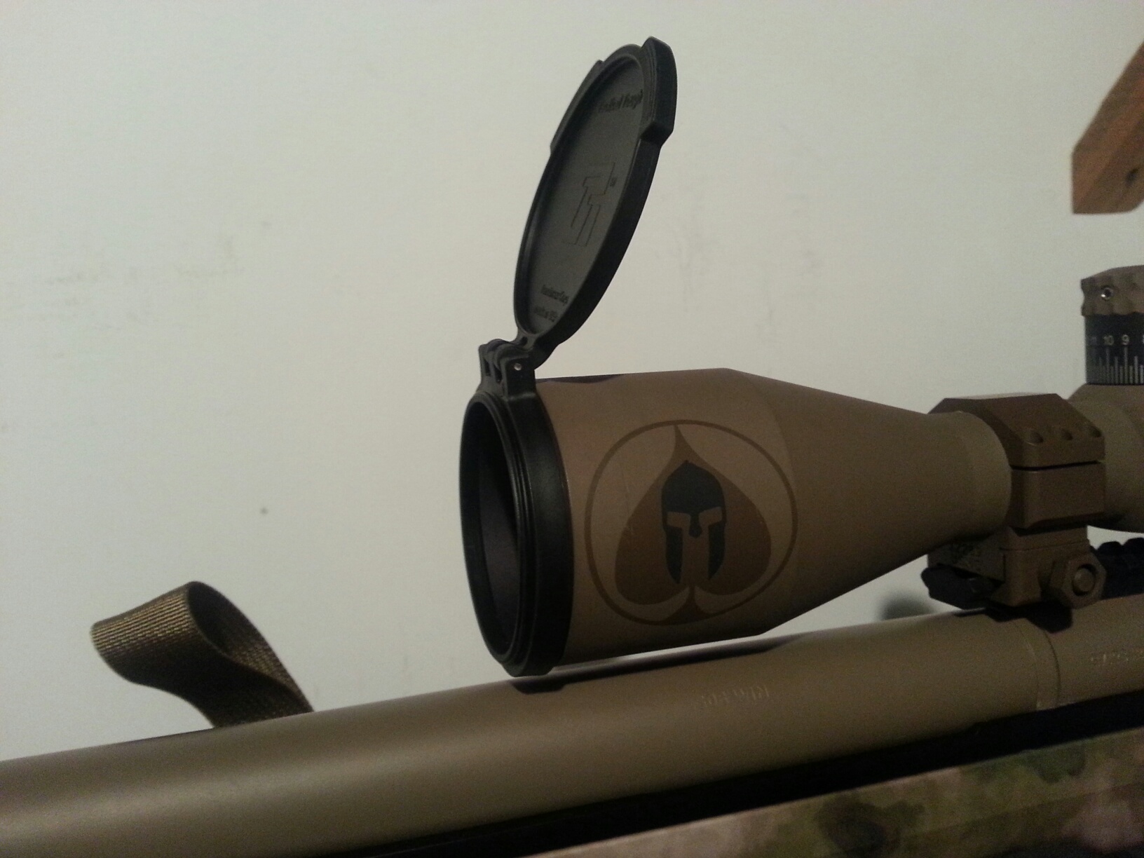

Now I also ordered a set of the Tenebraex covers for the ATACR. The objective came in.... still waiting on the ocular. The objective requires the adapter and goes for $27 and then cover goes for $25 so add shipping and it comes out more then the AADMOUNT. The ocular is $38 so a tick cheaper then the AADMOUNT but as I said I am still waiting for it to come out. Now the Tenebraex seemed like a good solid solution, except it also has a set of inherent problems. The darn thing does not flip all the way back. It sits high and presents a big black circle that says "here I am" as well as snagging on anything in the area. Again, not an issue for some but for $55 I want something that flips out of the way. See photo three.

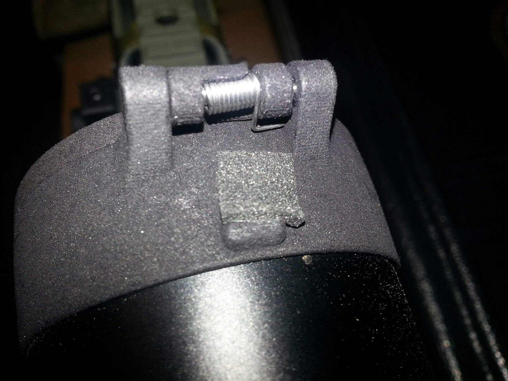

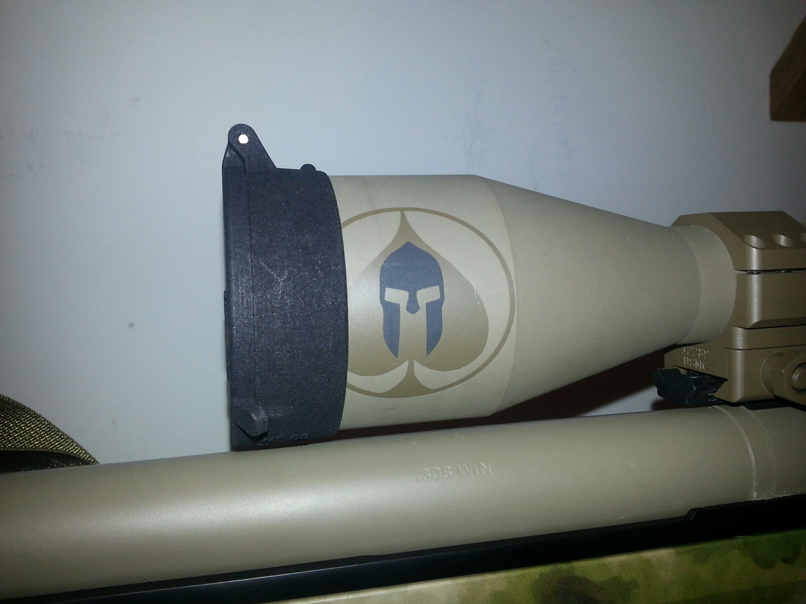

So we covered the competition lets look at the AADMOUNT's. First they are STRONG! I am not sure what they are made of but I think it came from the planet Krypton. The springs are very solid and the hinge area is reinforced. The units seal tight and stay closed but at the same time you don't need to be a power lifting champion to flip them open. A nice push with the finger and flip! Open! See photo four for the hinge area. Something else that was well though out was the audible "click" that comes from Kryptonian plastic hitting together. Well Jon sends a little patch of some furry non-animal substance to attach to the cover. This way when it flips open there is no sound. See photo five.

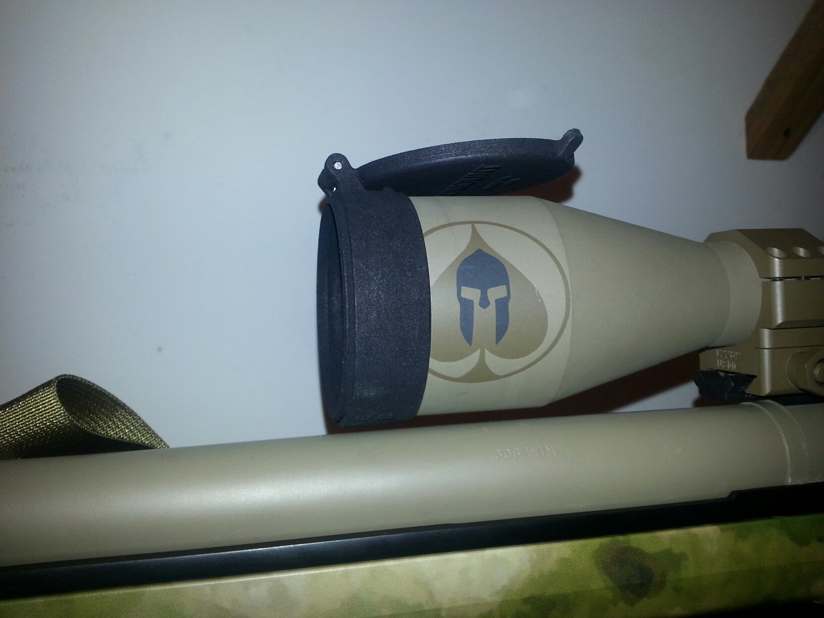

Now the AADMONT caps secure tightly and flipe all the way open, see next two photos. They also secure quite well. Due to the blizzard where I am at today it will be a few days before I can get to the range, but I have over 200 rounds through the SS 5-20 and the caps never moved. That was another problem I had with the B&C, sometimes the caps were not tight and they would go flying off at the range. I was sure I ordered the right size, just seems the fit was off.
