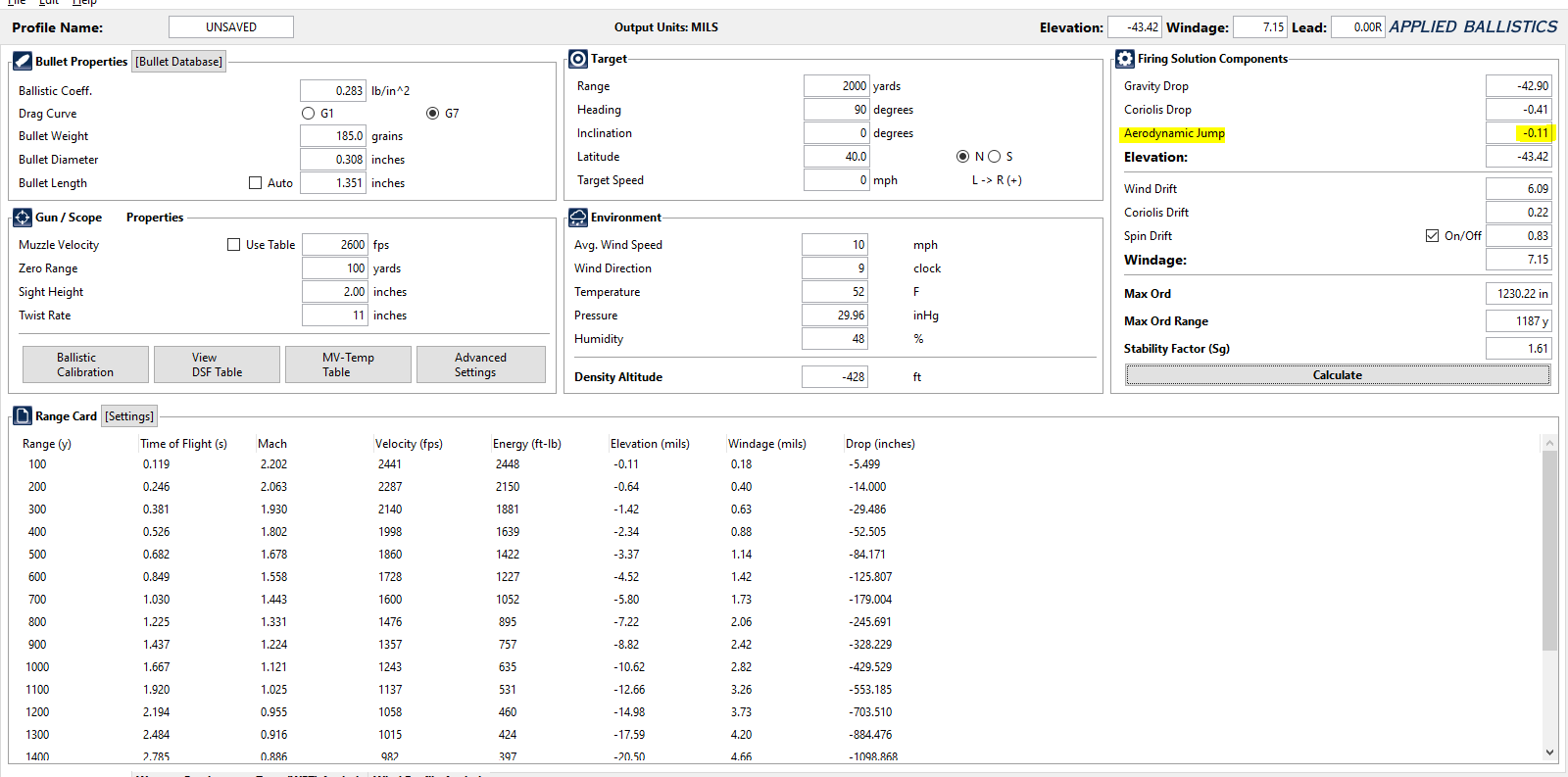

Using AB Analytics predicting the trajectory of an 185gr juggernaut
1:11 twist 10mph wind adds .11 mils of aerodynamic jump vs 0mph wind
1:8 twist 10mph wind adds .15 mils of aerodynamic jump vs 0mph
Not really sure if that's what you're asking. What does your AB Analytics show in that block when you add wind?

Resting the AB Mobile fixed the Aerodynamic jump issue. AB Mobile is now computing different ADJ levels for different SGs when a full value crosswind is applied.
