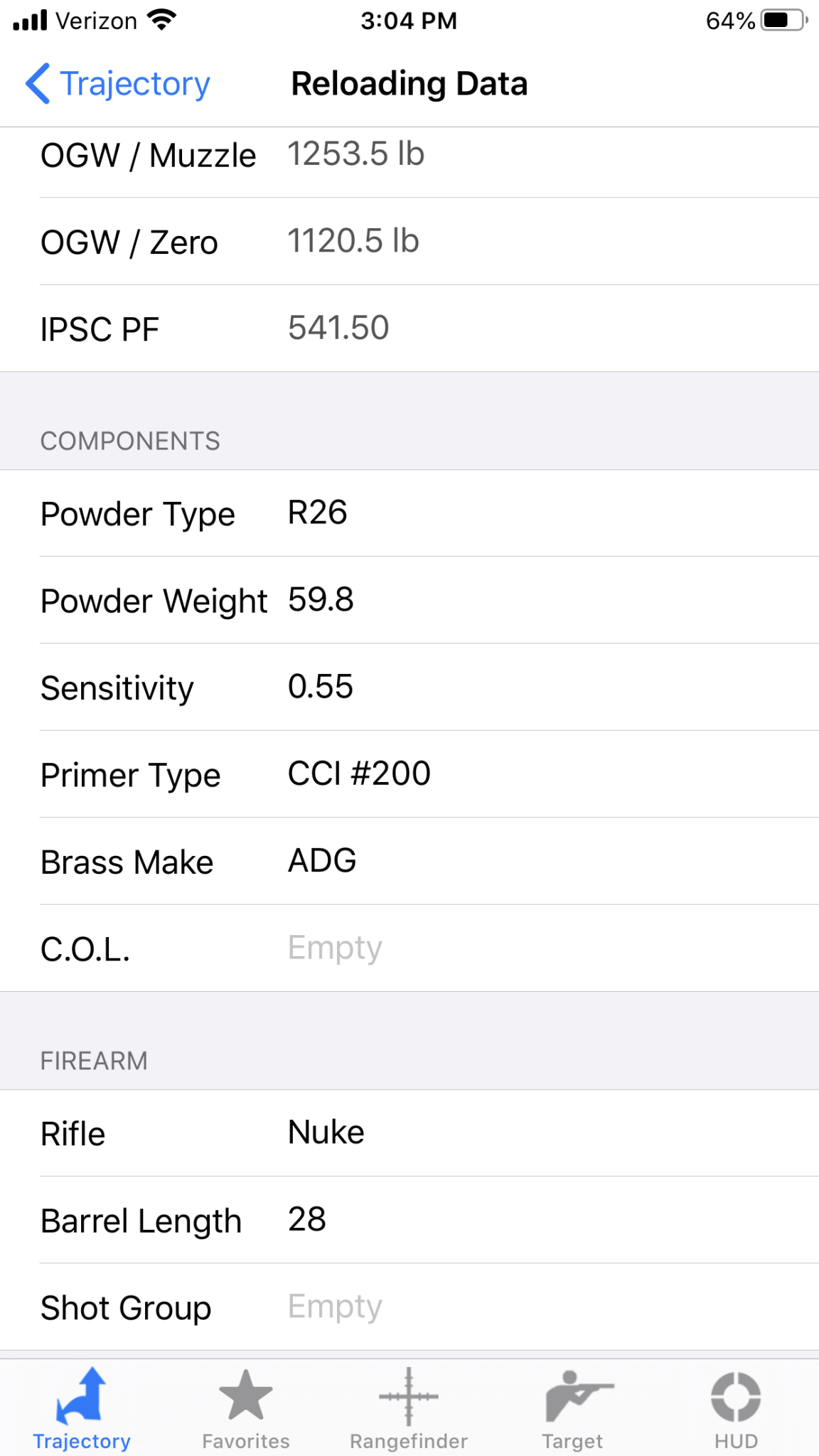

Temp correction is in the reloading area of the data inputs area.

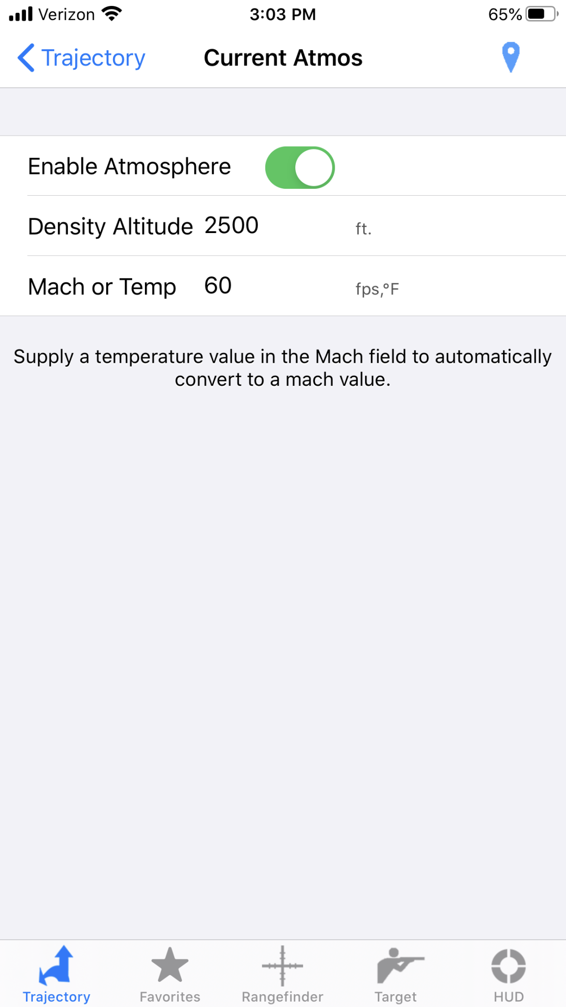

Da is set in settings then in the atmosphere input area.
