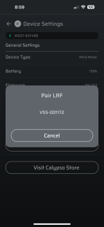

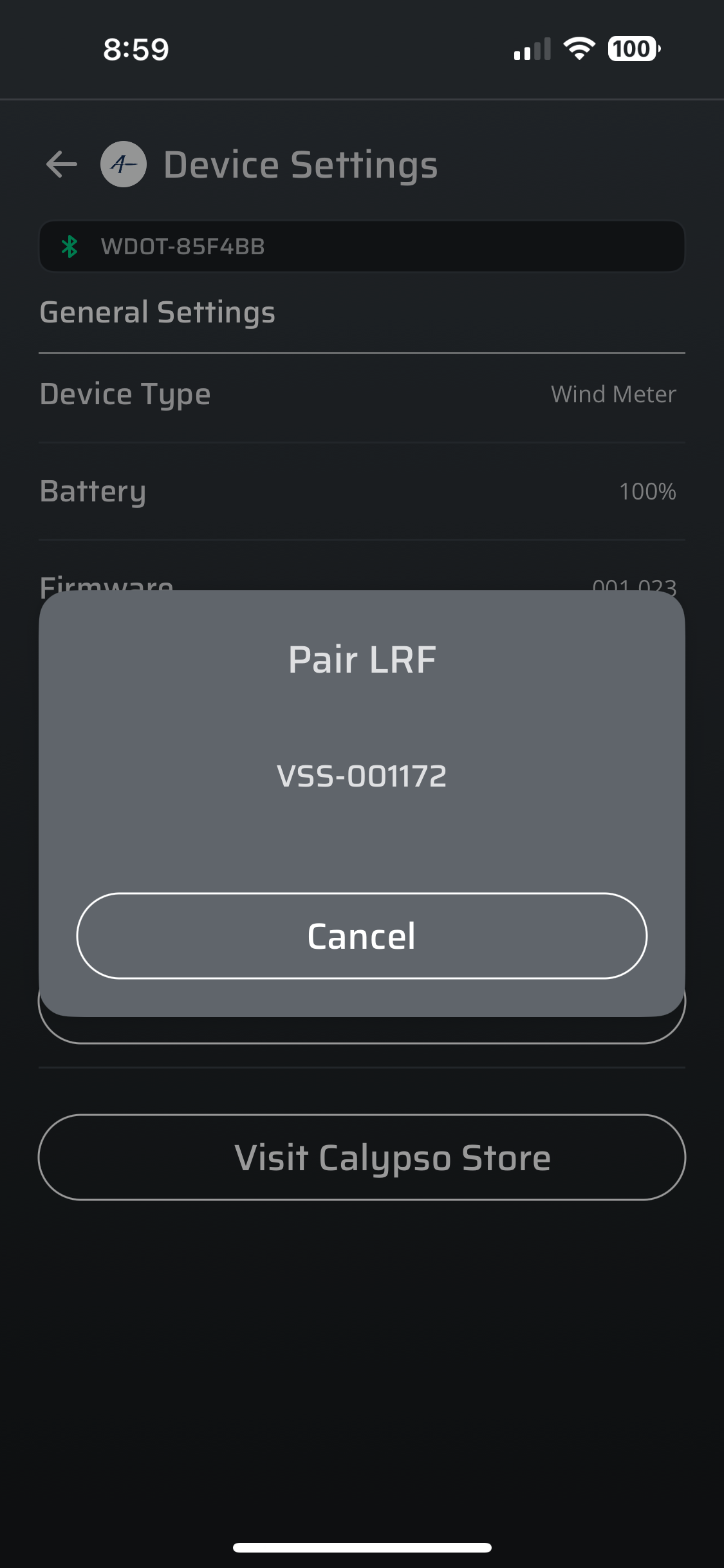

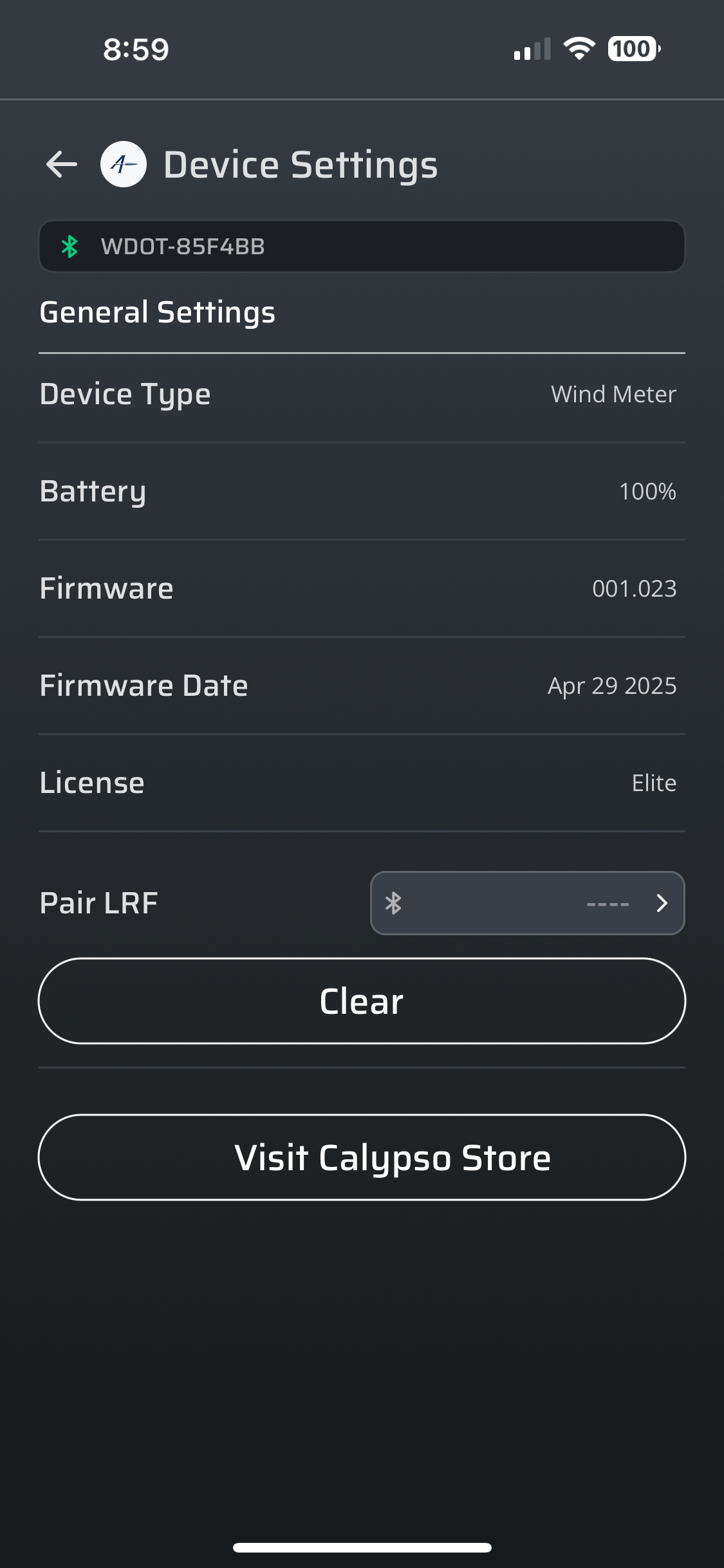

Still unable to pair Calypso with Vector. The option is there but pair takes forever. Hopefully this can be working soon
